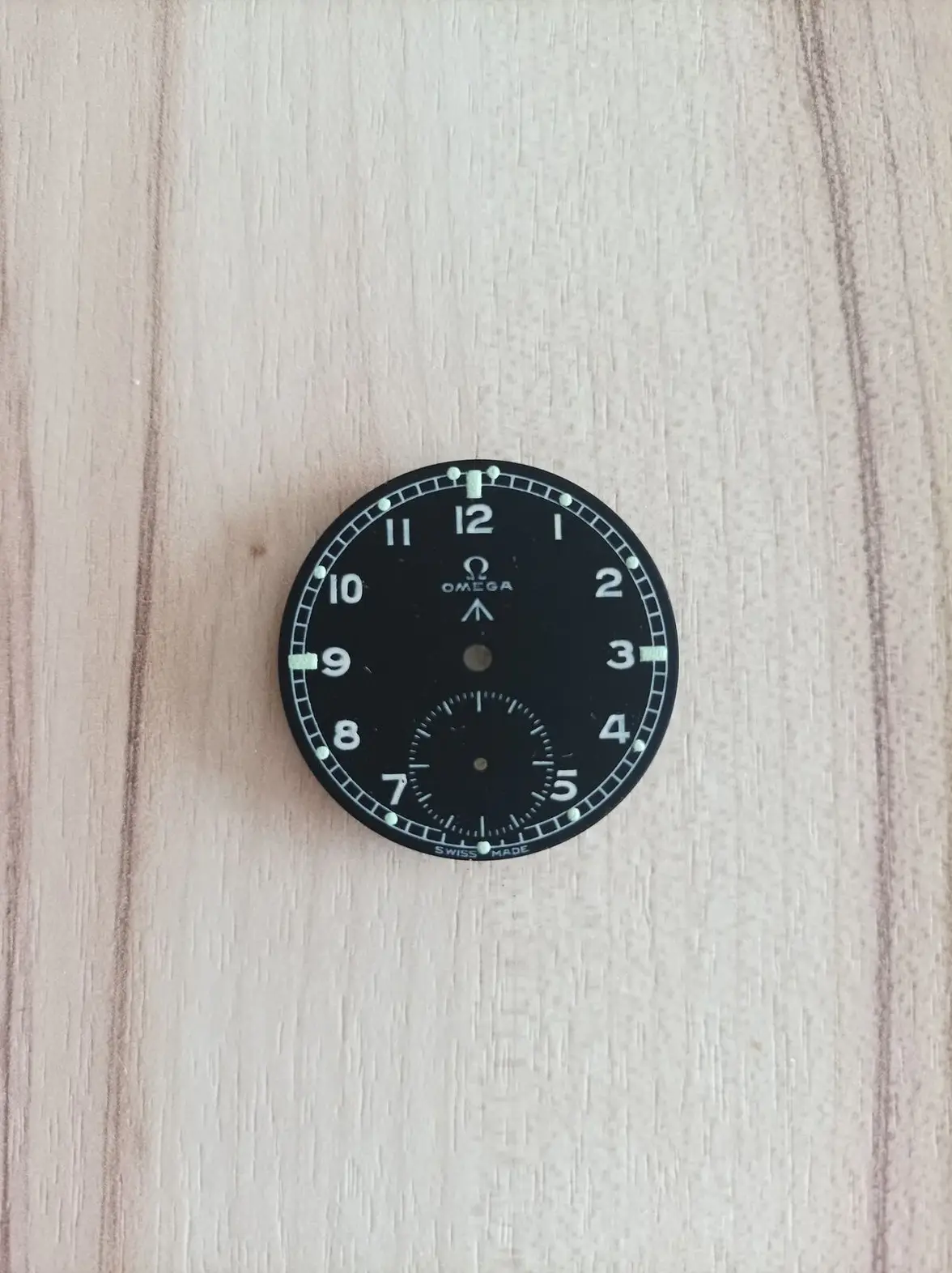

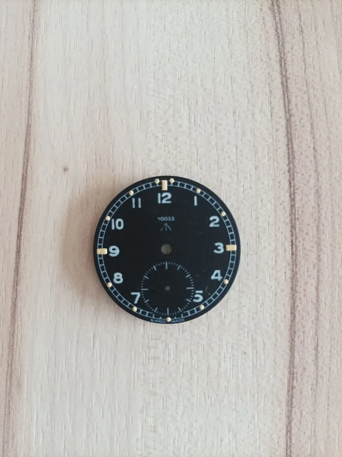

Hi guys,
Please, get look at attached dials - are they ok?
Sorry for low quality pictures - that all I have.. 馃檨
Thank you in advance..

I am not an expert, but having said that, both dials have been refinished, and it would therefore be difficult, if not impossible to authenticate them as having been original to military watches.
I would never buy them, or a purported vintage military watch with such dials.

As you probably know, the MOD refinished dials after removing the radium, but IIRC, those generally have a T on the dial. So the second one, with the green lume and no T, seems unlikely to me. But that is without studying it closely, and the poor quality of the photos would make authentication difficult anyway.
In principle, the first might be an original radium dial, or a fake. You will need to get sharp photos and make careful comparisons with correct examples. Geiger counter readings and UV shots would also be helpful. Good luck.

I like them. All the markers are aligned, all clear, the same font on both dials which looks legit. Lume markers look good..
So are these dials genuine?

Both dials are ok in my opinion, both MoD dials, second one is the most often seen MoD dial.

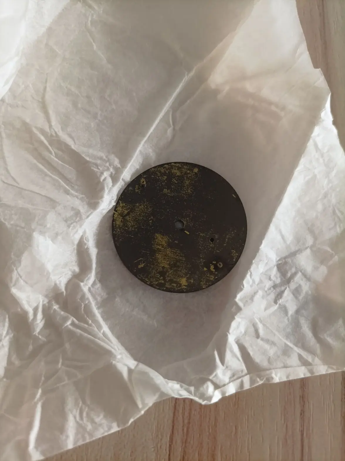

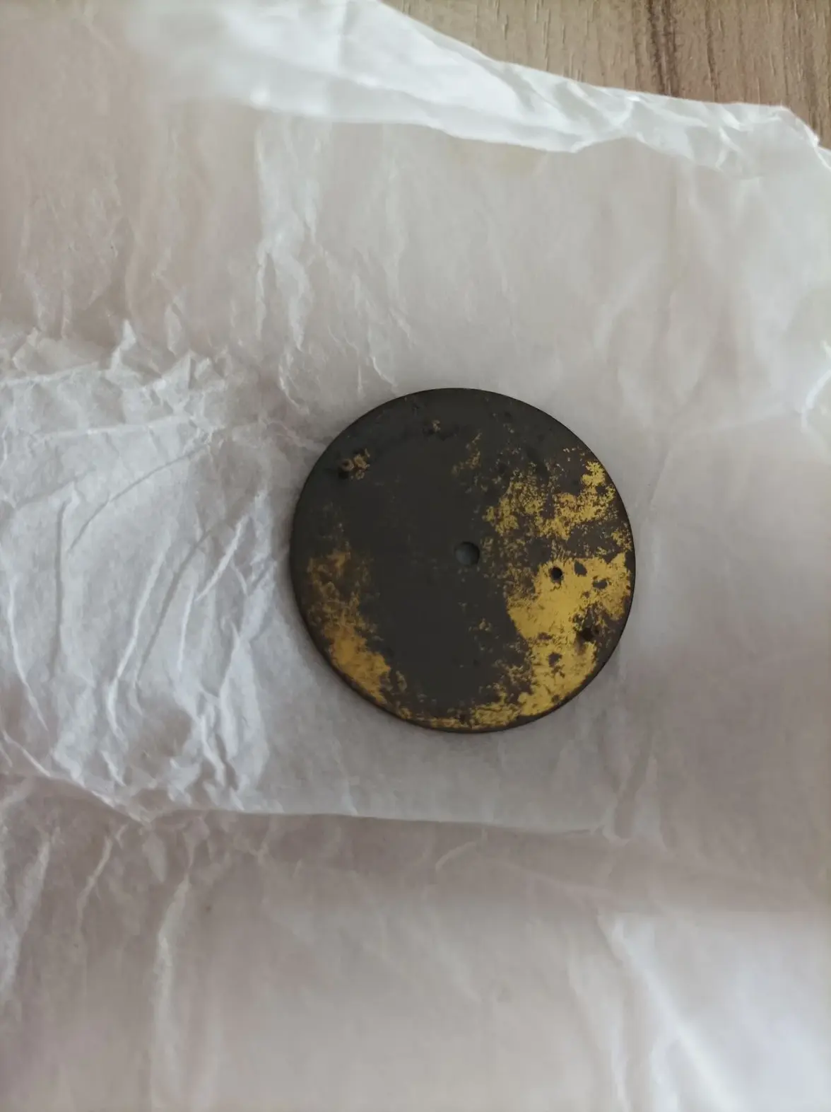

Judging by the backs of both dials , they could be 1960`s replacement MoD Dials. Re Printed in the UK. ( When a seller says, they are Original Dials : He does not really lie , because they are the original Omega dial Blancs ... ) The 10033 one seems ok in all Aspects. The 2. One I`m not so sure. The Lume on the second one , which will approach 60 years now, i still too pristine Greenish . That`s not the way, Tritium ages. And something else : Ask the seller, to include the little storage Bag piece as well ! We bought so many different Brand military dials over the 1990`s from Government Auctions and most of them came in these storage bags . Mostly 3 dials in one. Even when just one was left . So, keeping these bags and put newly repaints in them, does not make them more Original ...
282
64
