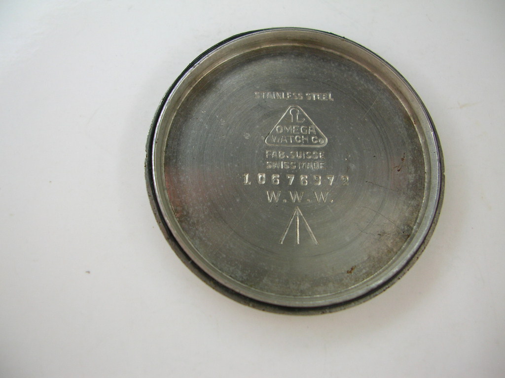

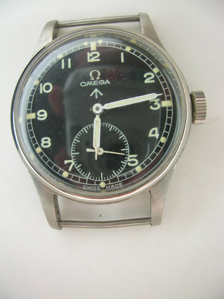

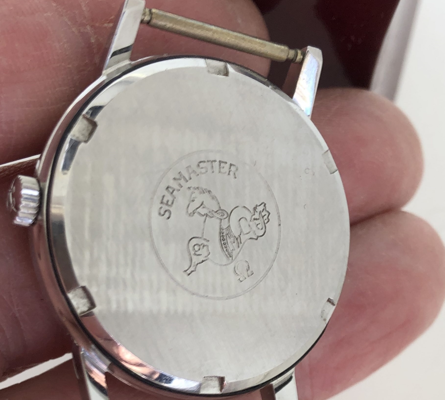

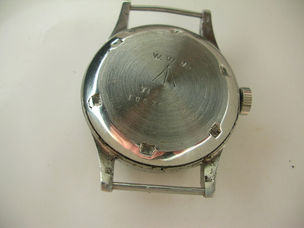

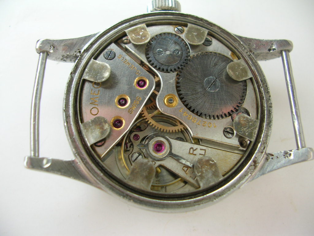

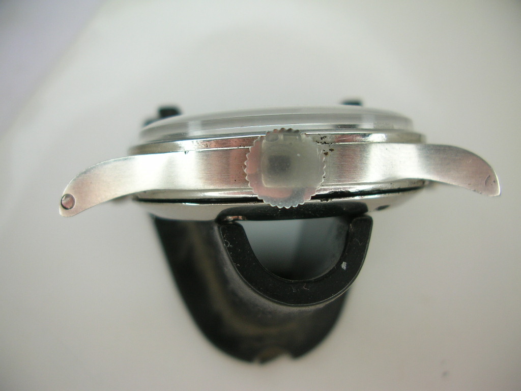

Hi, I'm new to this forum and to Omega watches, but I suspect I'm about to fall down the rabbit hole. 😀
I'm considering buying either a copy of the Dirty Dozen watch (which would join my A-11 as part of a growing militaria collection) or a slightly more modern (mid-60s) Seamaster 600. That said, I know there are a lot of fakes out there and even though I've spent some time reviewing the forums here, I'm not confident in my ability to spot the differences between authentic and inauthentic Omegas. I'm hoping some of the folks here might weigh in--? Thanks in advance, in any case.
Pictures included: sorry not to have more of the 135.011 but I can definitely inquire if needed. (Probably need more, right?) The Dirty Dozen has had the dial repainted and hands re-lumed, but I don't think I mind that. I notice a mismatch in the ref #s on the Dirty Dozen between caseback & the mechanism, but that seems normal from other examples I've seen online.
I'm also open to suggestions for other FS Omegas in either style that definitely _are_ authentic. As you can probably gather, I like the simplicity of the (relatively) clean black dial and steel case. Such gorgeous watches!

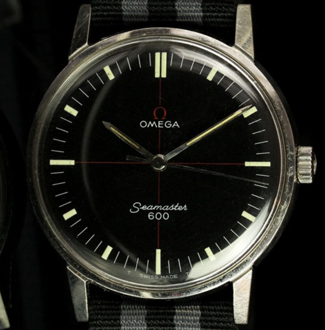

Can't tell you anything about the DD, but the 600 looks just fine (based on the supplied photos), although the back shows NATO rash.

I think you will eventually be sorry if you buy the WWW, just my opinion. If you appreciate actual military items, you definitely don't want a crappy re-dial with incorrect hands. Just wait until you're prepared to buy a legit example.

That's a very good point. ...Does the price for the 600 seem reasonable?

I think the 600 is overpriced to the tune of about $400-$500. I can't say for sure, but the lume color looks a little suspicious to me. Possible relume. Then again, it could be the photo. I would expect the lume color to be creamier, not so green.

On the forum we typically see the 135.011 selling well under $1000 USD. Of course, the black dial seems less common, but $1,400 still seems anomalously high to me. This is basically the entry-level Seamaster in many ways, hand-winding, no-date, painted logo.

I would expect the lume to be more like this example.

I've seen these with very good original lume as on OPs example, however I agree with the previous replies that this is more like a $900-1000 watch, although serviced (with proof) from a dealer it would not be completely outrageous at $1400.

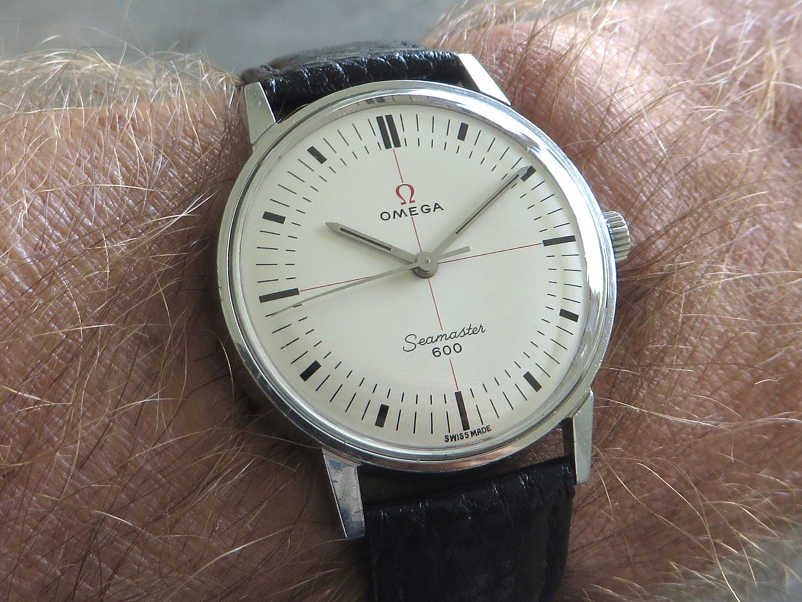

My white one says hello.
These are know a "technical dial".

I think the 600 looks original, lume and all.

For the military watch you should look up the military watch ressource forum. I don’t mean to disappoint but that WWW really looks bad.
The under part of the lugs also look like they’ve been worked on, case back repolished, and you should avoid mismatching parts if you can.
Military watch collectors value watches which have had a rugged life but there’s no reason to rush to buy a deeply flawed watch.

That's a horrible over-polished turd, I'd never buy from them, 95% of their watches are simply shiny resale crap.
