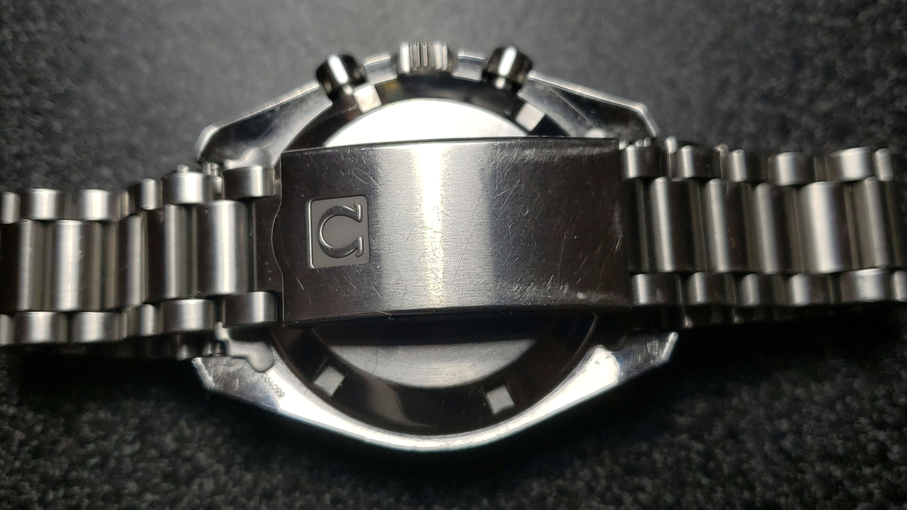

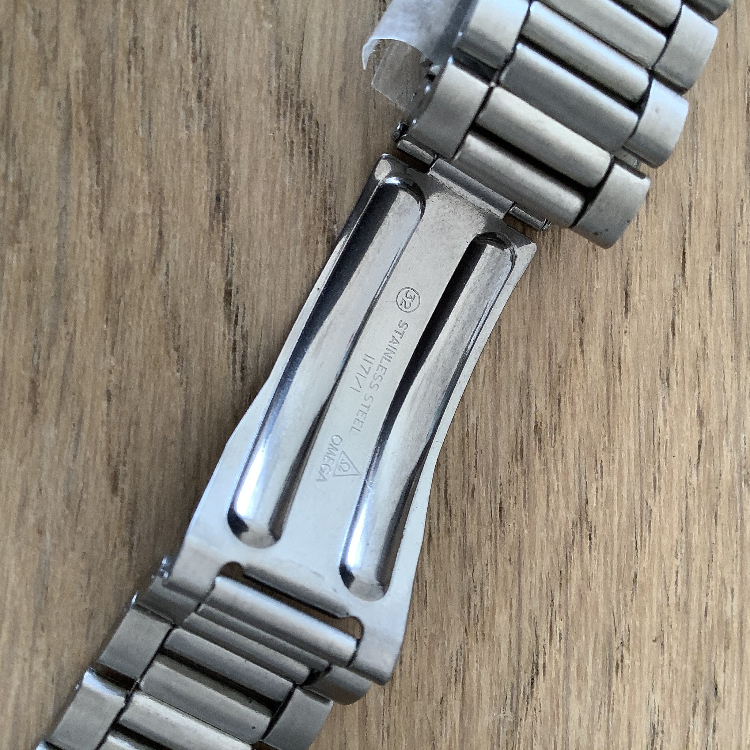

Here’s my 1171/1 stamped. Sorry the pictures are a bit rubbish.
134
133

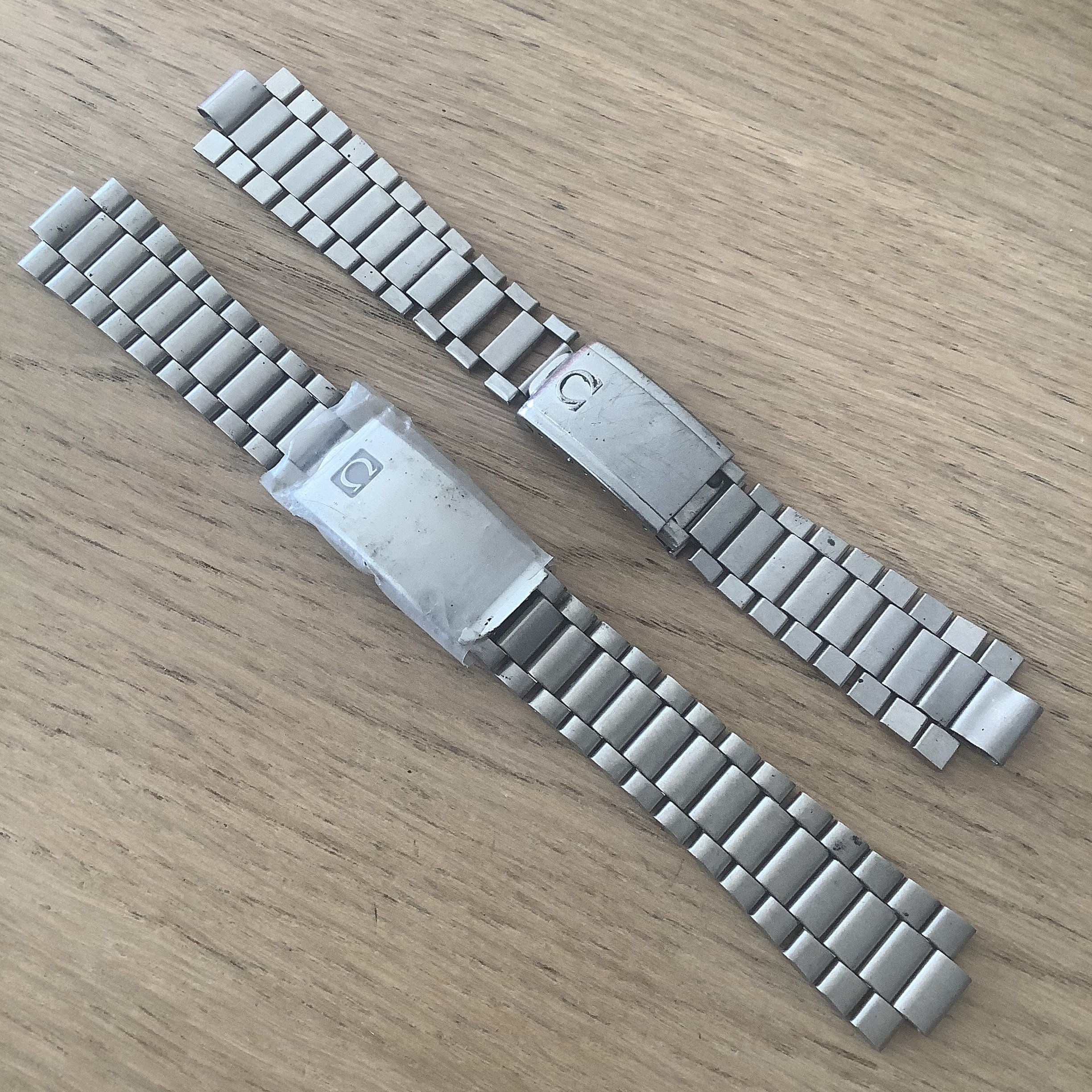

@paddymoran have been researching today, and all the circle 30s I could find across different bracelet types have the pre-1969 omega logo in the triangle with the close together feet, similar to the applied logo on the 145.012 dial and crowns. This would seem to place the 30 buckle design before 1969.
For the 1116 bracelet, there seems to be an even mix between the 30 clasps and the 11 clasps. This may indicate a transitional period during the making of that bracelet.
Most 1171s feature 11. Also the circle 11 has an extra point of friction, where as the 30 relys on the top edges of the clasp cover for all its friction. Circle 11 seems to be used throughout the 70s on the trapazoid version.
Suspect the circle 30 was used in early 1171 and 1116 bracelets, while the 11 was the later more advanced clasp that saw use into the 1970s.

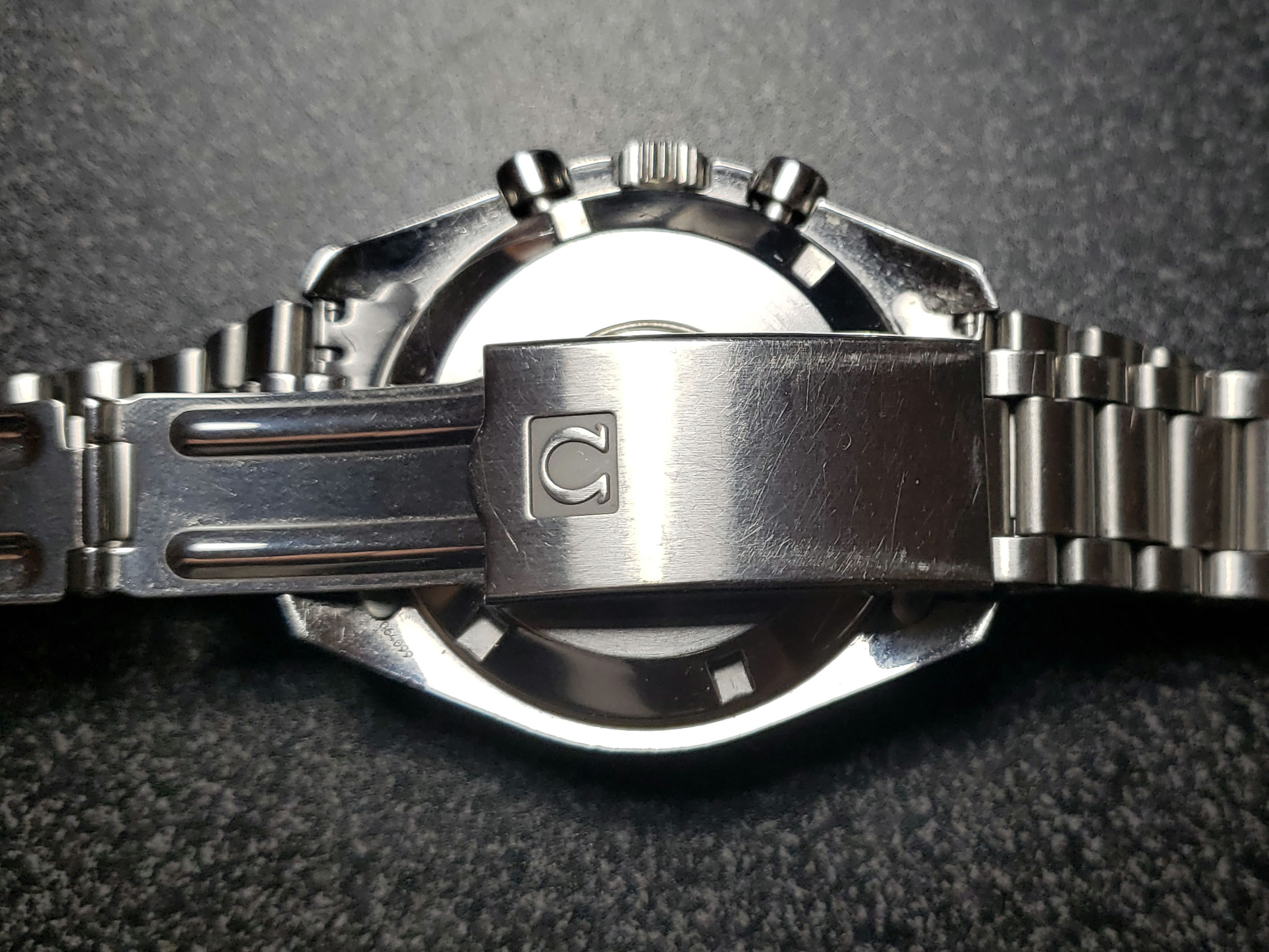

Here's a 30 from a 1116 that was original to a 69st from 1970. This bracelet was only made until 1971, which the means the 30s were at least around at the same time as the 11. Has there been a 30 found on a Trapazoid 1171?

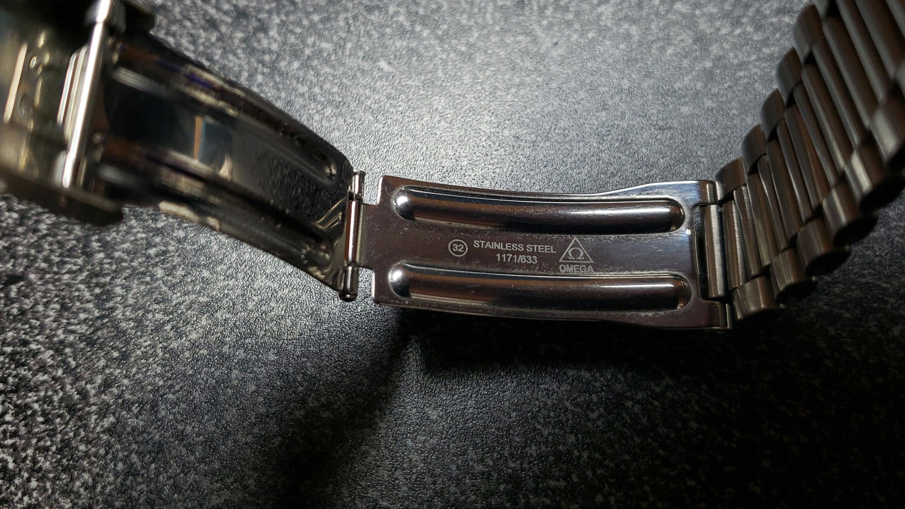

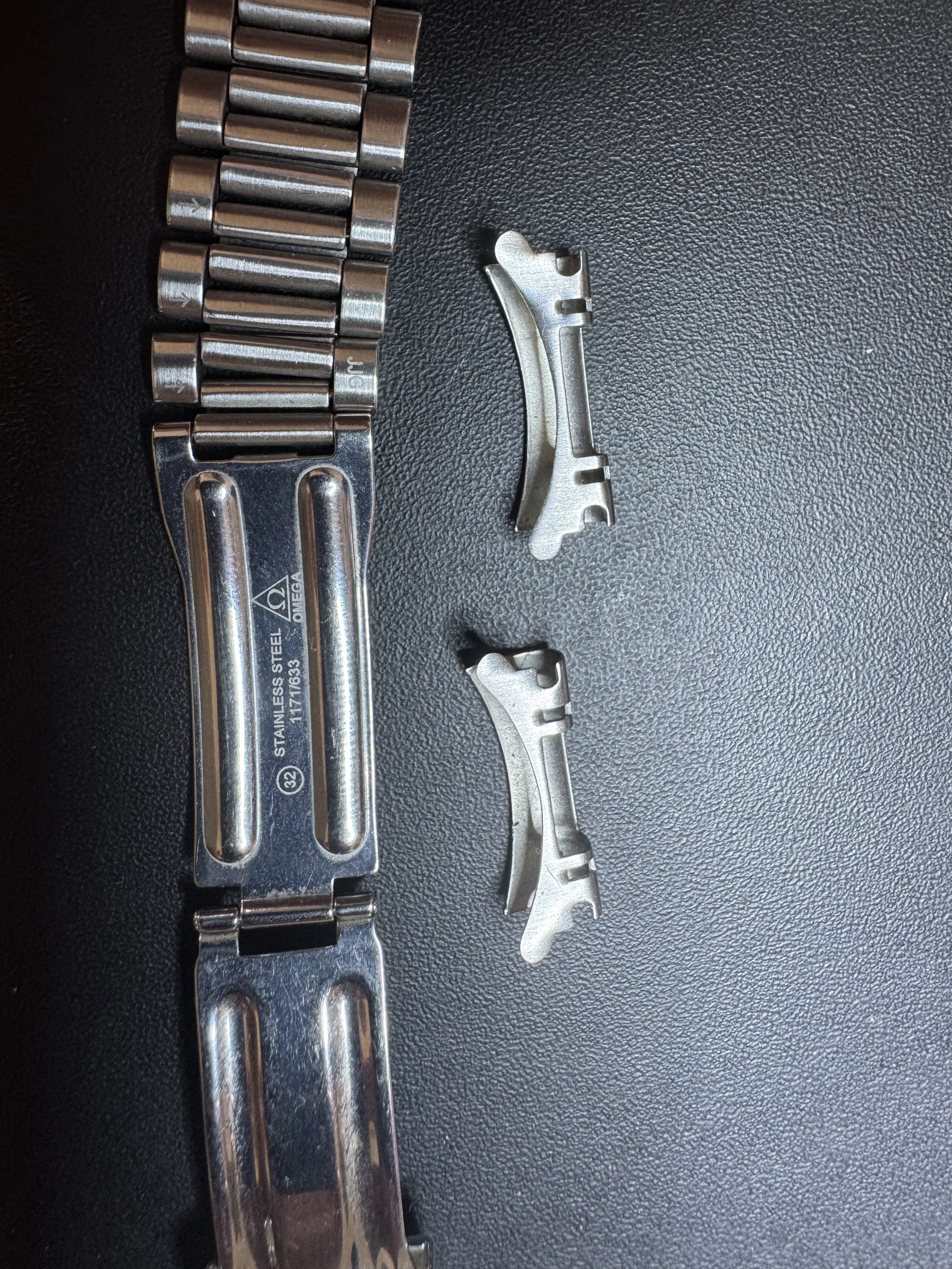

1171/633 with circle 32 and stamped square logo. Purchased new from Ofrei for my SM300 project in 2012 or 2013.
Hi

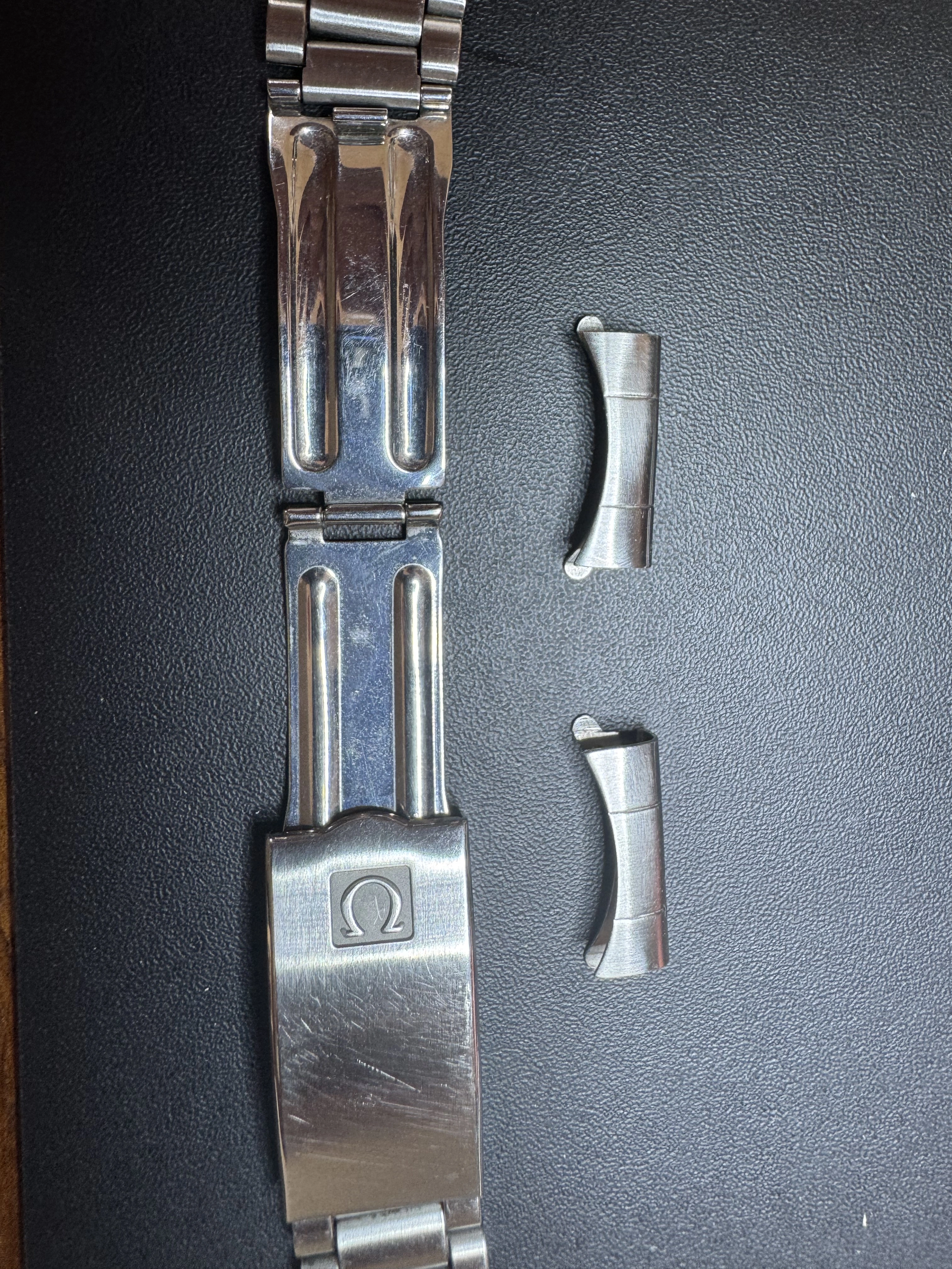

Digging up this old thread, so recently got a similar 1171/633 bracelet. Are the matching endlinks supposed to be unmarked? What was this bracelet designed for?
Thanks!
1,479
3,006
The 1171/1 is a service replacement bracelet intended for a few older watches. Mine aren't marked.

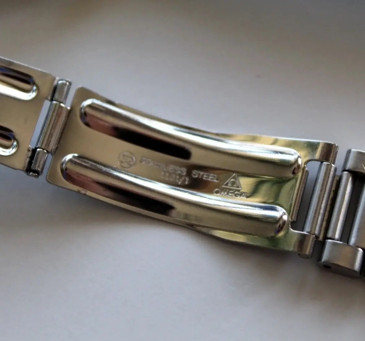

l got another question :
anyone know what era a 1171/1 with stamped marking would be? I have mostly seen laser etched.
They've been stamped before, sometimes engraved, could be again, who knows what era. Only Omega would know and there's not enoguh examples to know for sure otherwise and I'm not sure why it truly matters.
