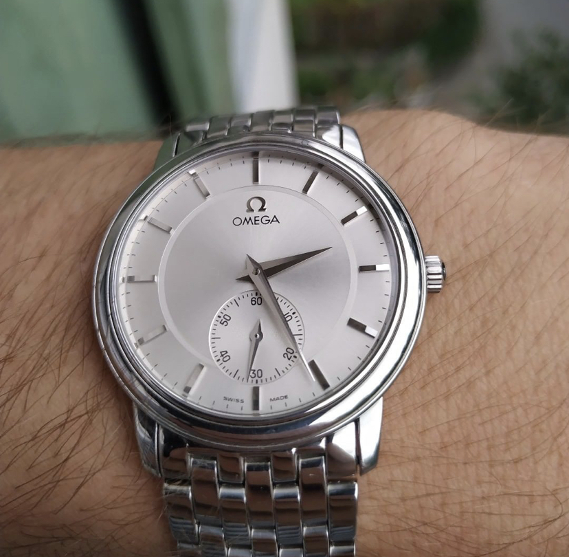

The 45203100 originally came on a bracelet - that's the only difference.
Bracelet is 020ST1507834, and is still available from Omega.

Wonderful, thank you! That makes sense, after seeing several similar watches with the same reference on bracelets.
