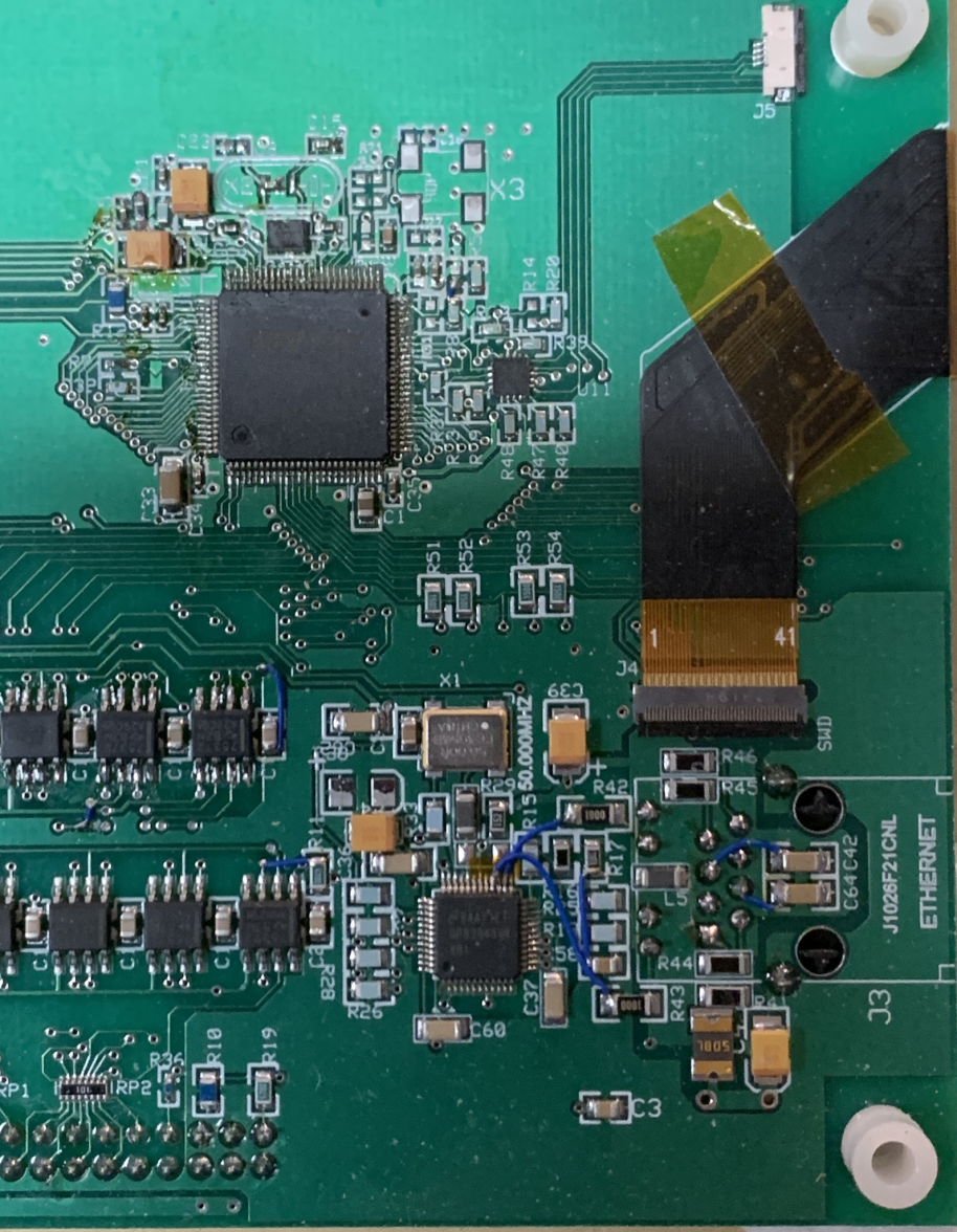

So I work with microlectronics on the pipe organs. I make boards like this.

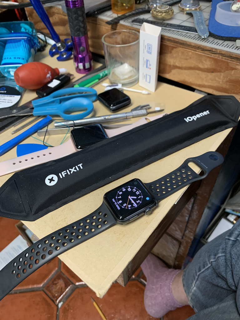

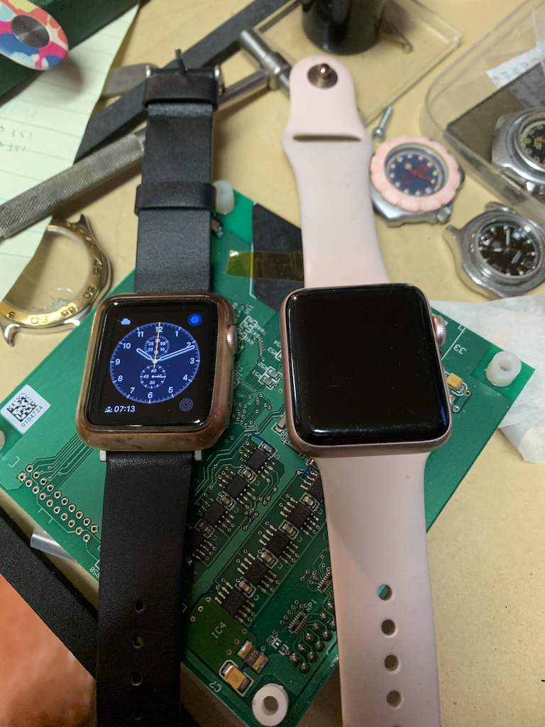

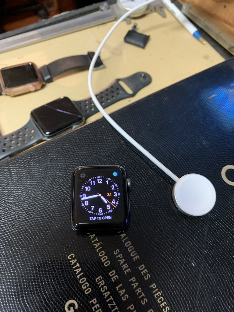

Still I have been seeing Apple Watches on Goodwill going for around 17USD. So I bid that on a couple of them. To my surprise I won them. These showed up along with all the chronograph case parts yesterday.
I had to go out and get a charger puck, which cost more than the watches. One of the watches had a torn band so I splurged on a leather band with traditonal lugs for more than I paid for the watch.

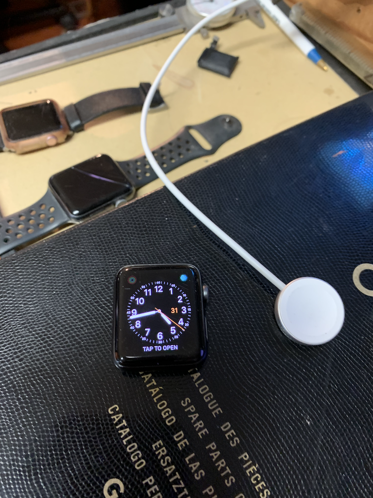

Took all day to update the firmware on the Series 1 watch. It actually synced to the phone and looks to be somewhat useable. The other watch has a cracked screen diagonally across it.
That watch will boot, but it does not pair to the phone. It seems who ever gave it to the goodwill (charity shop.) did not remove the activation lock.
I actually got these to take apart. I was sort of thinking A fun waste of time would be to see if there was a way to put a mechanical movement into the case. I have many of the tools needed for the disassembly.

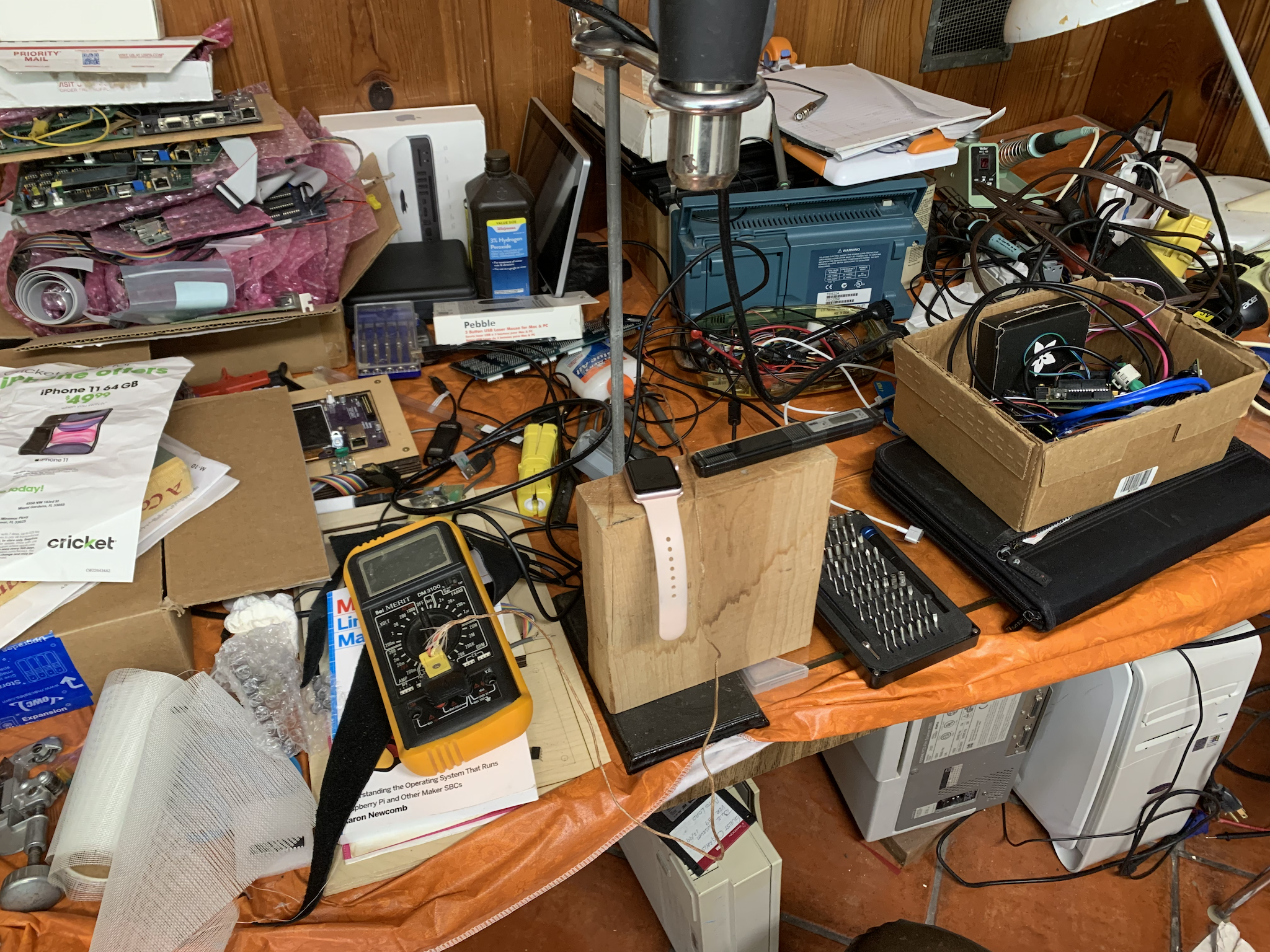

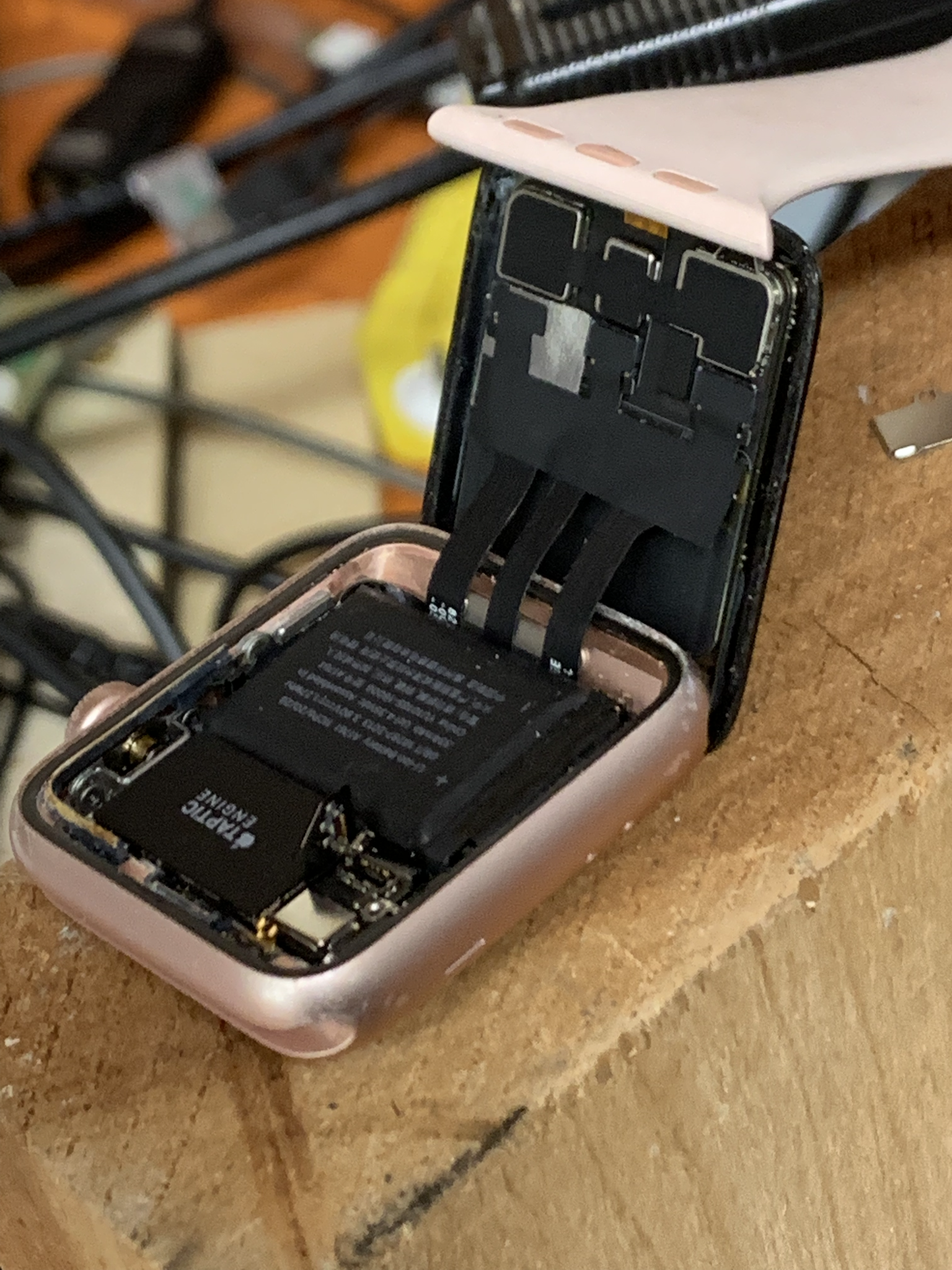

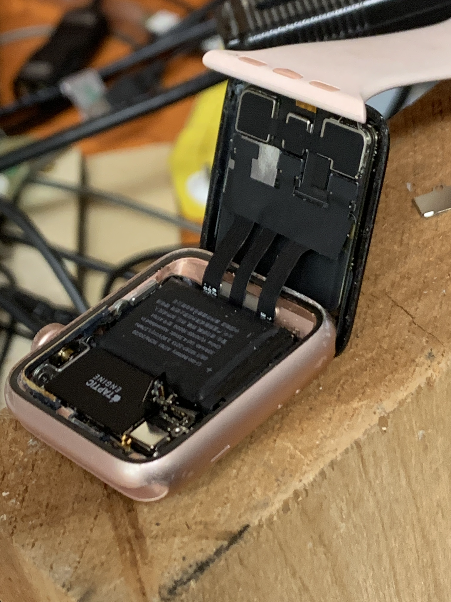

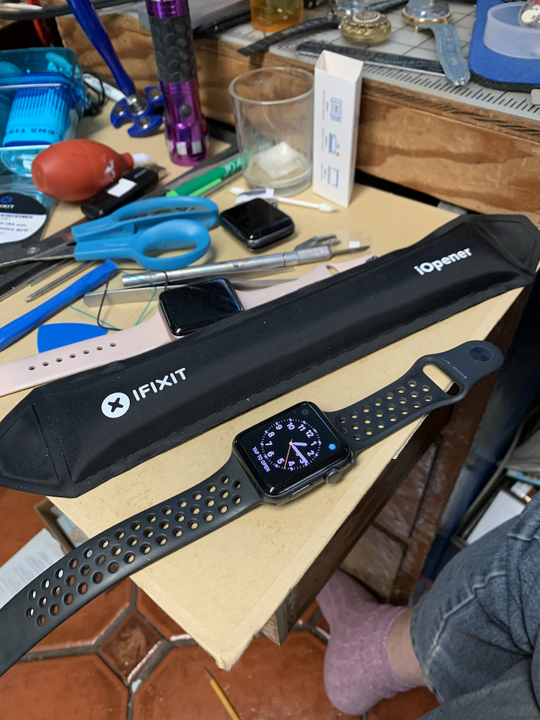

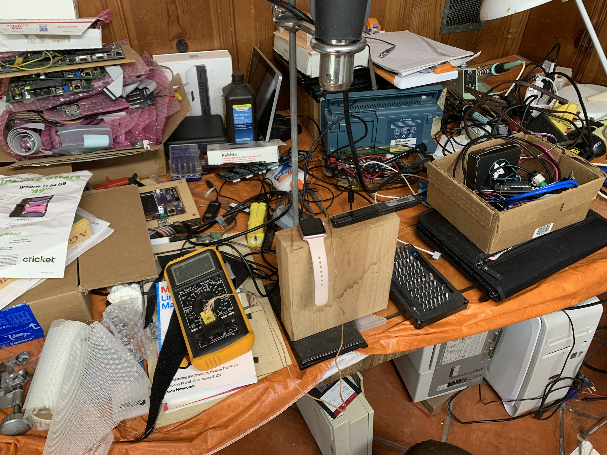

The electronics bench is even more of a mess than the optical bench. The question was, how easy are these things to open. There was not much pont getting a thermal opener when I already had a heat gun. I found the multimeter that has the thermocouple (left over from the 3D printer projects decades ago.) Heated the brick up to about 160F and
Got the thing opened. I had the special triwing in the iFixit kit. The driver is magnetic, which is a bit of an abhorition. Interesting working on electronics and seeing a watch screw fall onto the deck. At least it did not bounce.
put the PoS back together and

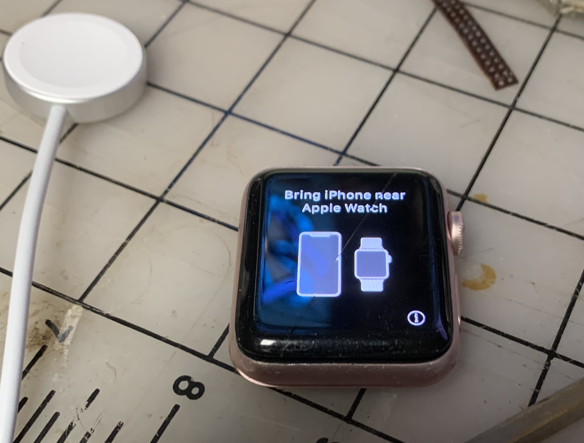

It still lights up. Cracked screen and all.
Of course it is still a brick as it is locked. I tried the iPhone 6 that does not have a sim card.(connects to wifi to check in with big brother.) Curiously there was an updated for the 6. Must have not been much of an update. Fastest I have ever seen a phone update. Tried to update the watch but there was an error screen that was too short to fully read. Something about something being out of date. The iPhoneX prompts at this point for the prior user's password.

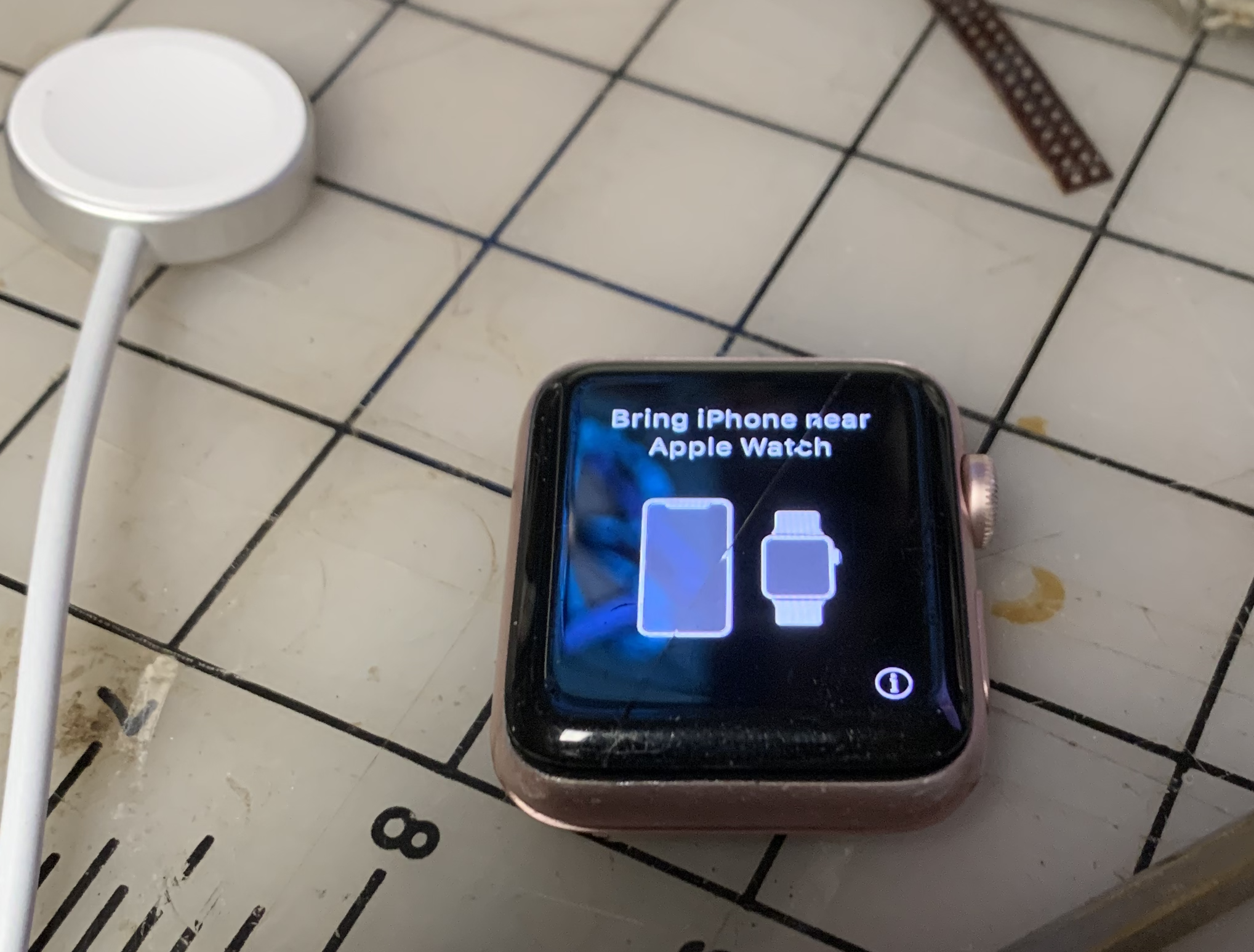

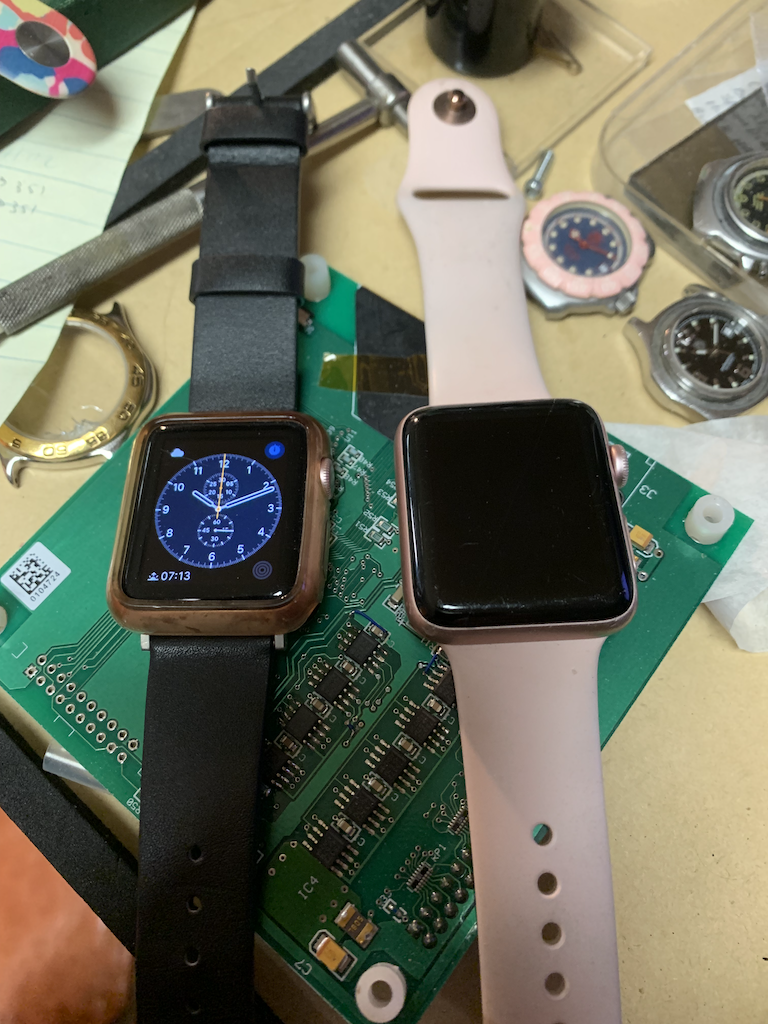

How to really waste time:
So a while back I got some apple watches to play with. Cracked screens are the main issue.
I got a watch for a screen and it wound up with some scrap swatch watches. Did a battery swap and the damn thing pairs. Well after a three hour software update.
Now I need to get the tape gasket to put it back together.
Downside is this was supposed to be a parts watch. So I still have the one with the cracked screen.

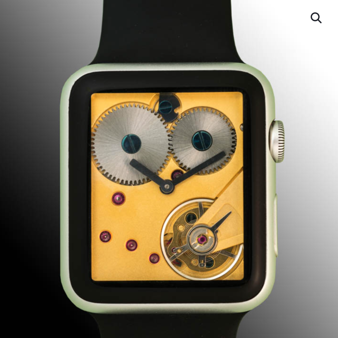

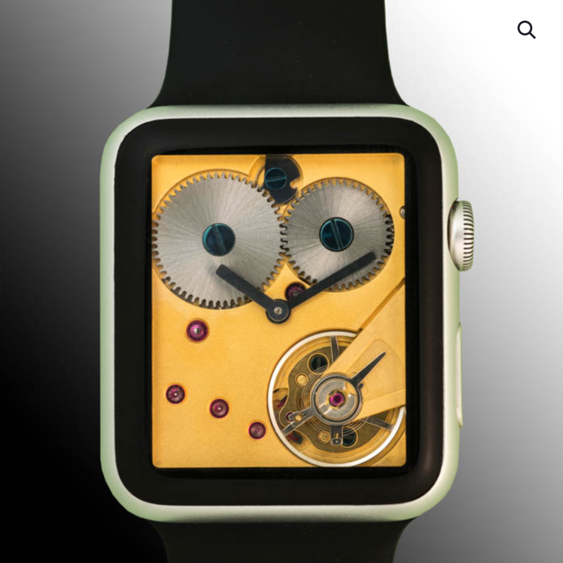

"What is the point in making reliable of hardware, if you use software to disable it? There really needs to be a better way to recycle these things."
https://lottermann-uhren.de/produkt/lottermann-konzeptuhr-upcycling/
This is meant as an aside, as it's clearly off the topic of electronics, but Till Lottermann in Mannheim, Germany makes these (very) upcycled watches to order. It's part of a wider range of watches which you can see on their website. You can also learn how to build/assemble your own watch through their sister brand Blancier. I did it a few years back when Till visited London, and it was great fun. Anyway, with regard to the upcycled Apple Watch, it's a pretty remarkable and very well made movement, and a watch with a lot of strap options.
