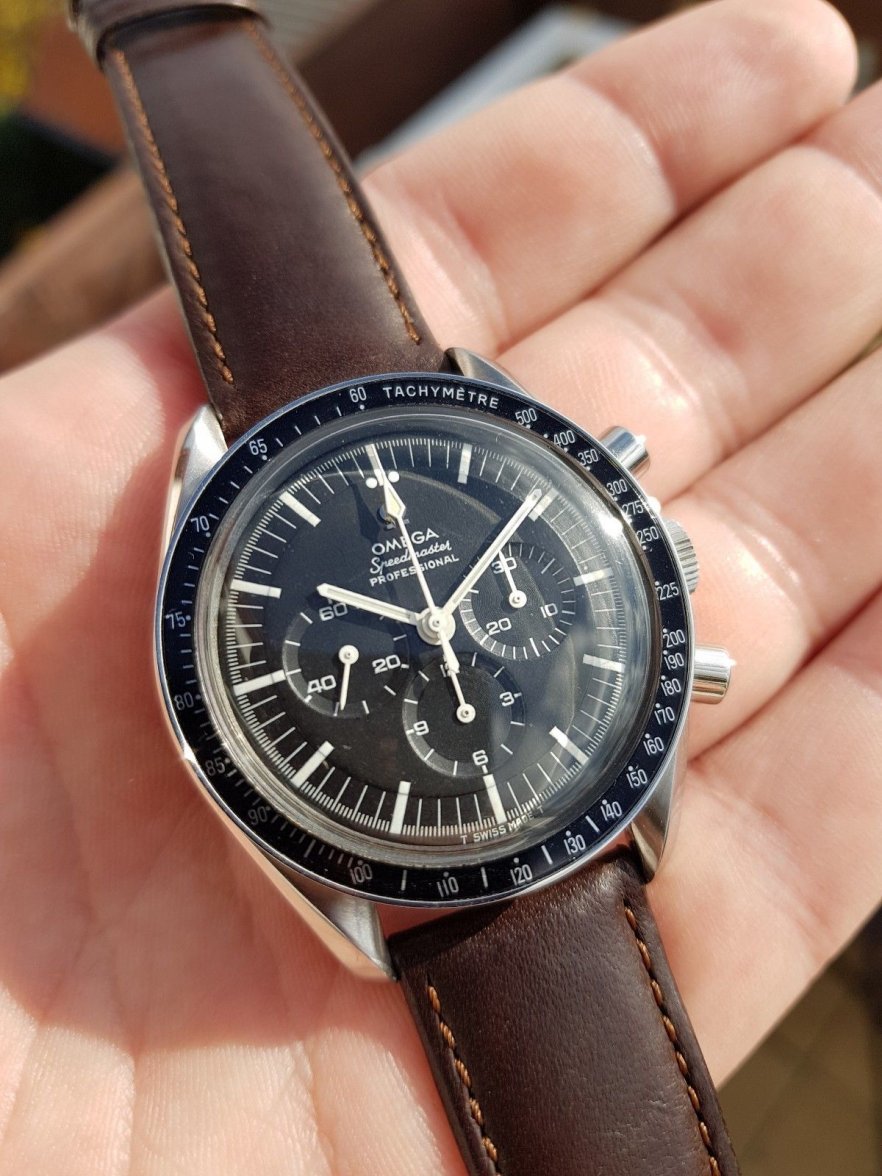

    Did anybody here get lucky?
  2. kov Trüffelschwein. Nov 7, 2018
    4,113
    16,085
    The photographs are made to hide all the things that don’t work imo. To me it was far away from a bargain, even if you consider buying for parts. :thumbsdown:
    chronoboy64, padders, Davidt and 3 others like this.
  3. GIGI321 Nov 7, 2018
    64
    65
    guess I still have a lot to learn ...
  4. Waxtactic Nov 7, 2018
    335
    1,025
    @kov - I'd love your insight on this. What stuck out to you that maybe an Omega n00b like me missed? Any thoughts/education would be appreciated. Cheers.
  5. padders Oooo subtitles! Nov 7, 2018
    8,996
    13,941
    Replacement hands and bezel, washed dial, polished case. Possible replaced crown, not a 24 tooth at least. Not a terrible price but not a collector watch.

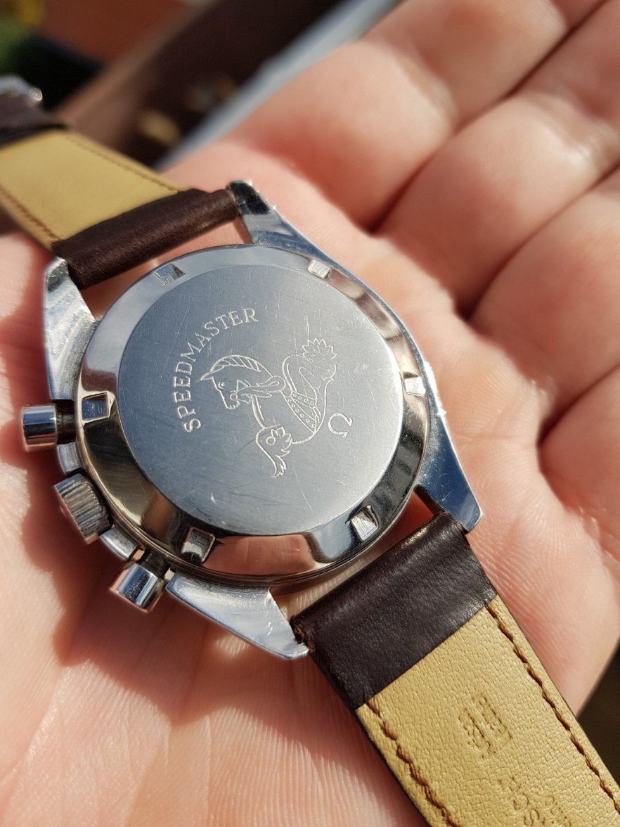

  6. kov Trüffelschwein. Nov 7, 2018
    4,113
    16,085
    :thumbsup:
    And a service caseback ? :)
  7. Dan S Nov 7, 2018
    18,822
    43,269
    Less of a bargain after you buy a nice DON.
    BenBagbag and kov like this.
  8. padders Oooo subtitles! Nov 7, 2018
    8,996
    13,941
    To be honest I wasn’t 100% on the back. It’s obv been polished but didn’t consider it had been replaced. My expertise is on the -68, well that’s my excuse lol :)
    kov likes this.
  9. kov Trüffelschwein. Nov 7, 2018
    4,113
    16,085
    I am not 100% too, but it catches my eye so I raise a question mark ;)
    padders likes this.
  10. mr_yossarian Nov 7, 2018
    2,418
    4,572
    Thought so too. The large slots clearly indicate that. But there is also a pic of the inside with correct engravings..but this might not be on the watch when it arrives.
    Mark020 likes this.
  11. Davidt Nov 7, 2018
    10,424
    18,130
    I think the case back is period.
    Agree about the rest though. Washed dial, new hands, new bezel. I'll bet his was in pretty poor condition until relatively recently and it's had a dealer spruce up so from a distance it appears a nice example.
    Spacefruit and padders like this.
  12. tomvox1 Nov 7, 2018
    1,206
    1,232
    Well spotted and was also going to mention the washed, no-lume dial, which can be tricky to discern from those kind of photos. :thumbsup:

  13. Tubber Nov 7, 2018
    1,926
    6,893
    So we can see what the thread is about when the link goes dead.
    The discussed case-back.

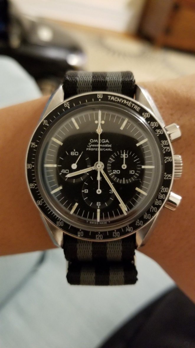

  14. Waxtactic Nov 13, 2018
    335
    1,025
    @padders @kov - thank you for the education gents. So, when comparing it to a legit one, how does this one compare? I see that the bezel has the tach numbers partially cut off at the top (not to mention the accent over the "e" and the dot above the 90), the lume looks more worn (hence older hands), some grime or "patina" on the hour markers and dings on the lugs (hence not polished). How'd I do? Again, just looking to learn with real life examples since this thread is alive and kicking.
    One other thing, I didn't understand what DON meant. Can you give me the quick definition? Sorry, been more of a Seiko junkie recently.
  15. gdupree Nov 13, 2018
    902
    1,560
    DON = dot over ninety
    DNN = dot next to ninety
    Looks nice. That is a pristine DON you have there. The bezel certainly puts it in a different category than the watch in the OP, value-wise. Is the dial missing most of it's lume, or is it just the photo?
    Waxtactic and padders like this.
  16. padders Oooo subtitles! Nov 13, 2018
    8,996
    13,941
    Yes I agree with Garron above. That one is a lot nicer and a lot more honest. The lume is spotty though and there is maybe a bit of dial damage across 'Professional' that warrants a closer look before parting with cash though as that is a bad spot to have a scratch etc.
    Waxtactic likes this.

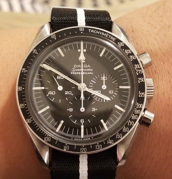

  17. Waxtactic Nov 13, 2018
    335
    1,025
    @padders @gdupree - thanks again gents. Padders - your eagle eye is spot on, there does appear to be a scratch across "Professional". In this other shot here, the lume on the dial appears to be better than the previous shot, although you can still see discoloration at 7 o'clock.
