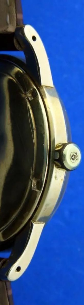

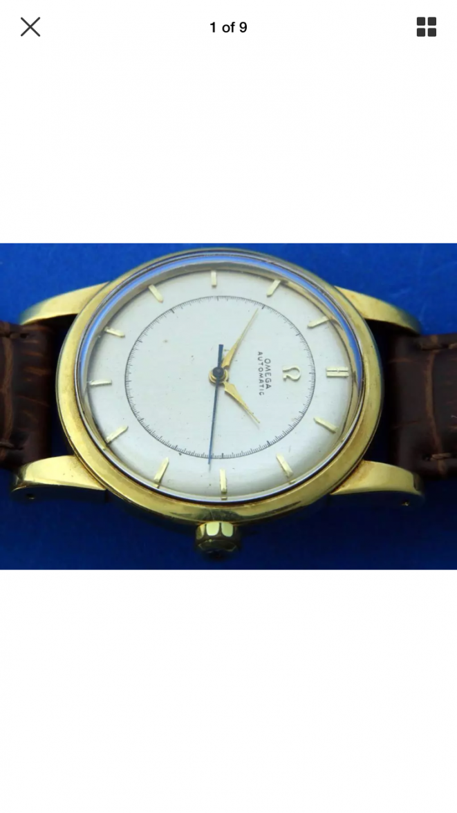

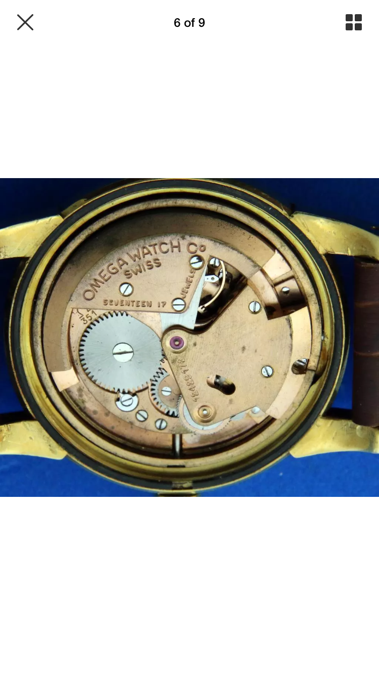

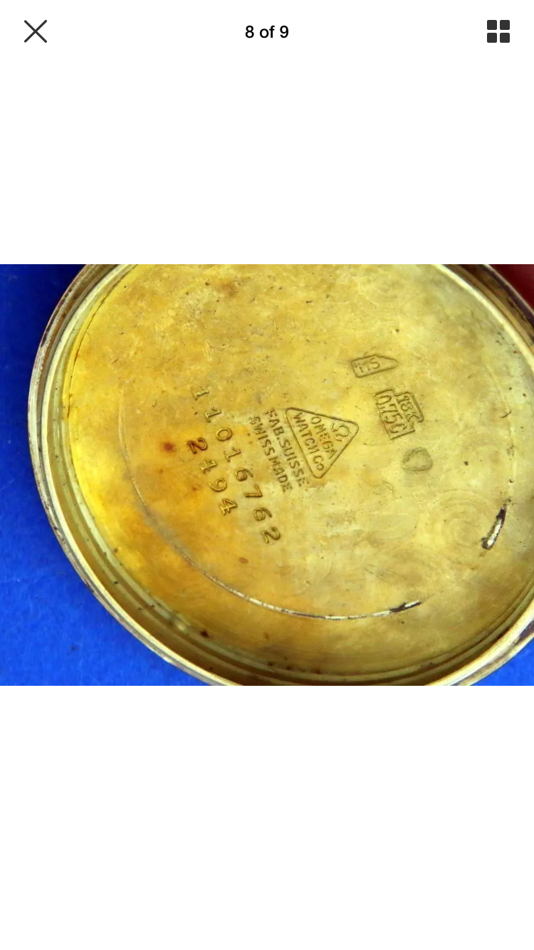

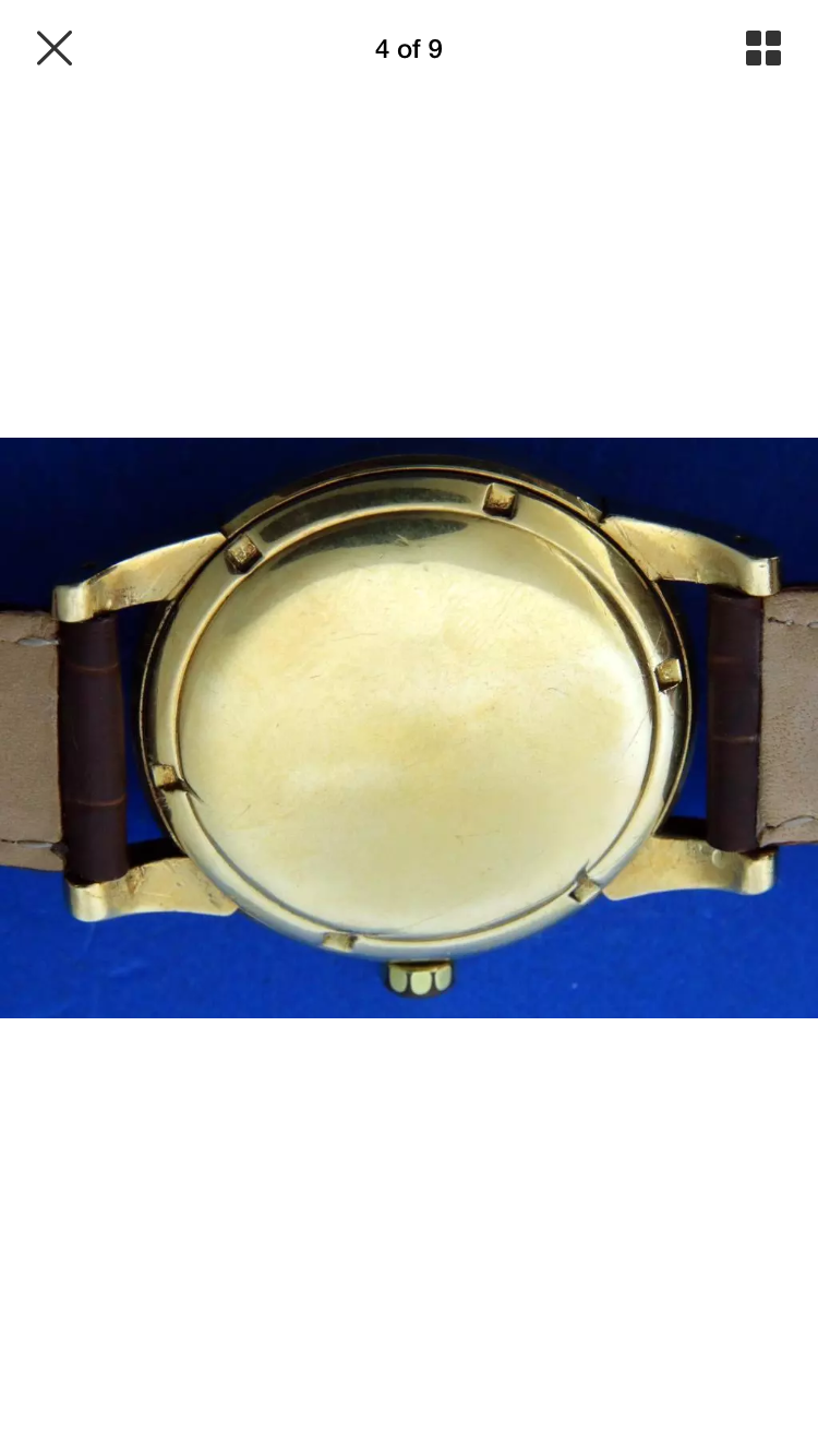

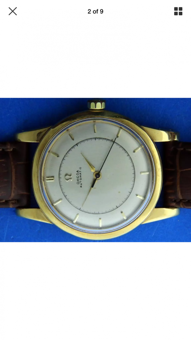

    I’ve been after an original solid gold Omega for a while. I wasn’t looking for a high end collector piece, just a solid original watch to use as a daily work watch. I recently won this and I’m excited to get it in
    36mm (excluding the crown) solid 18k 351 bumper movement. Description says that it is running well
    Case does show normal wear and movement can use a cleaning, but otherwise it’s exactly what I was after.
    I won the auction at $699
    Did I do decent ?
    Thank you

    Sorry, no you didn't.
    Badly refinished dial, incorrect (not Omega) hands, ugly movement, I'll stop there.

    Agree with all of the above, but I do really like the crown.

    With next one check that markers are properly alligned. Main marker "3" must be alligned with center of the crown. Inner markers must be alligned with main ones, look at yours at "9"...

    I see exactly what you are talking about. Thank you for the eduction, I really appreciate it.
