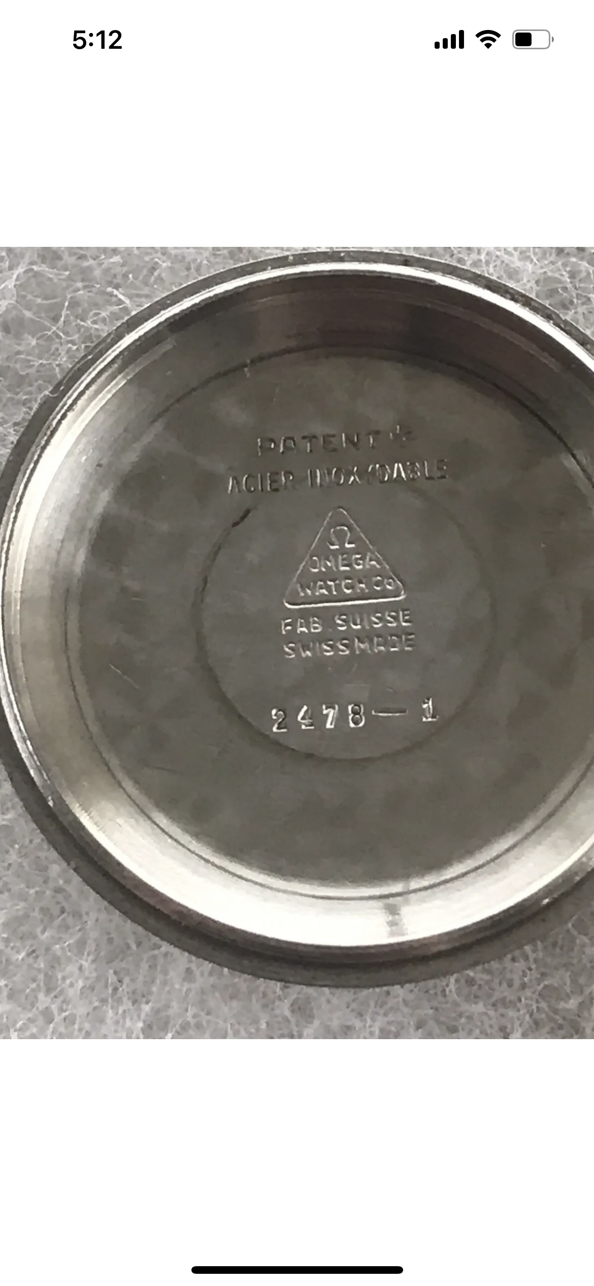

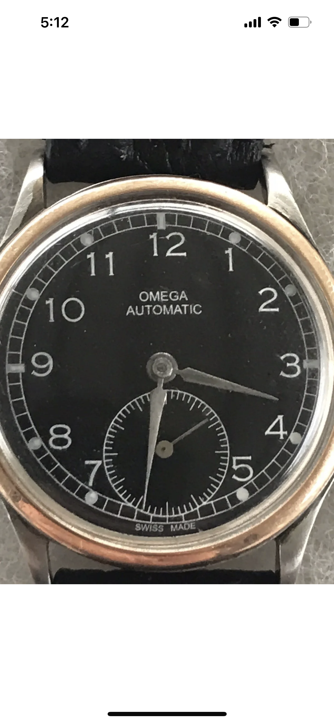

Bought on eBay. A search of the serial number on the movement comes up as 1944. The fact it has no Omega symbol on the dial has me concerned. Any input? See pics below

Redial / refinished. Welcome btw…

I think some pictures will help here. "Redial" it's the best option..worse will be to have a "Franken" watch.

Lazy redial, didn't even bother with the logo. Not unattractive but not an original look.

One suggestion for the OP, actually look at a few known original Omega watches here on this Forum. Any reference. Note the beauty/elegance of each.

Thanks I'm learning but it looks like what I expect a 80 year old watch to look

The reference number 2478 inside the case back should be entered into a search engine and then compare known originals to the one you are looking to buy. Train your eye to known originals as you seek cool watches.

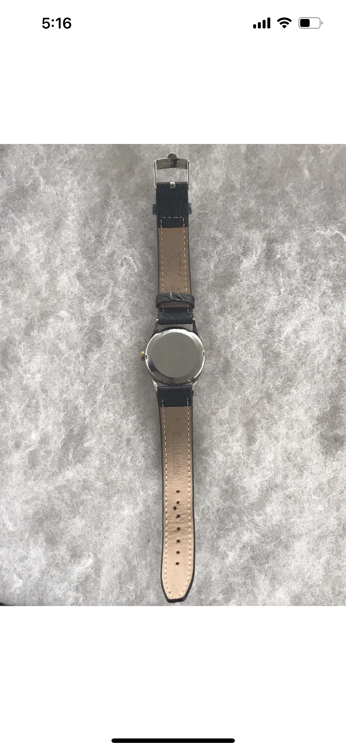

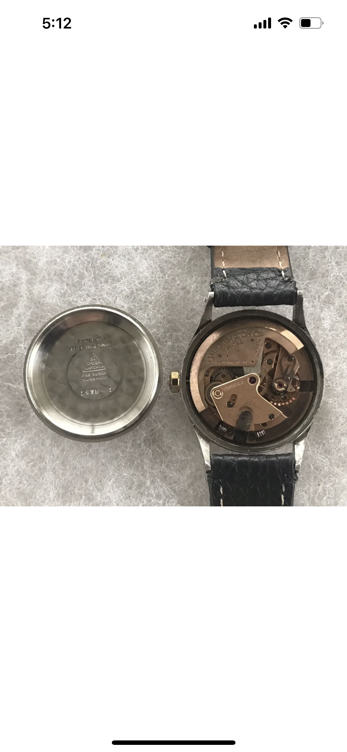

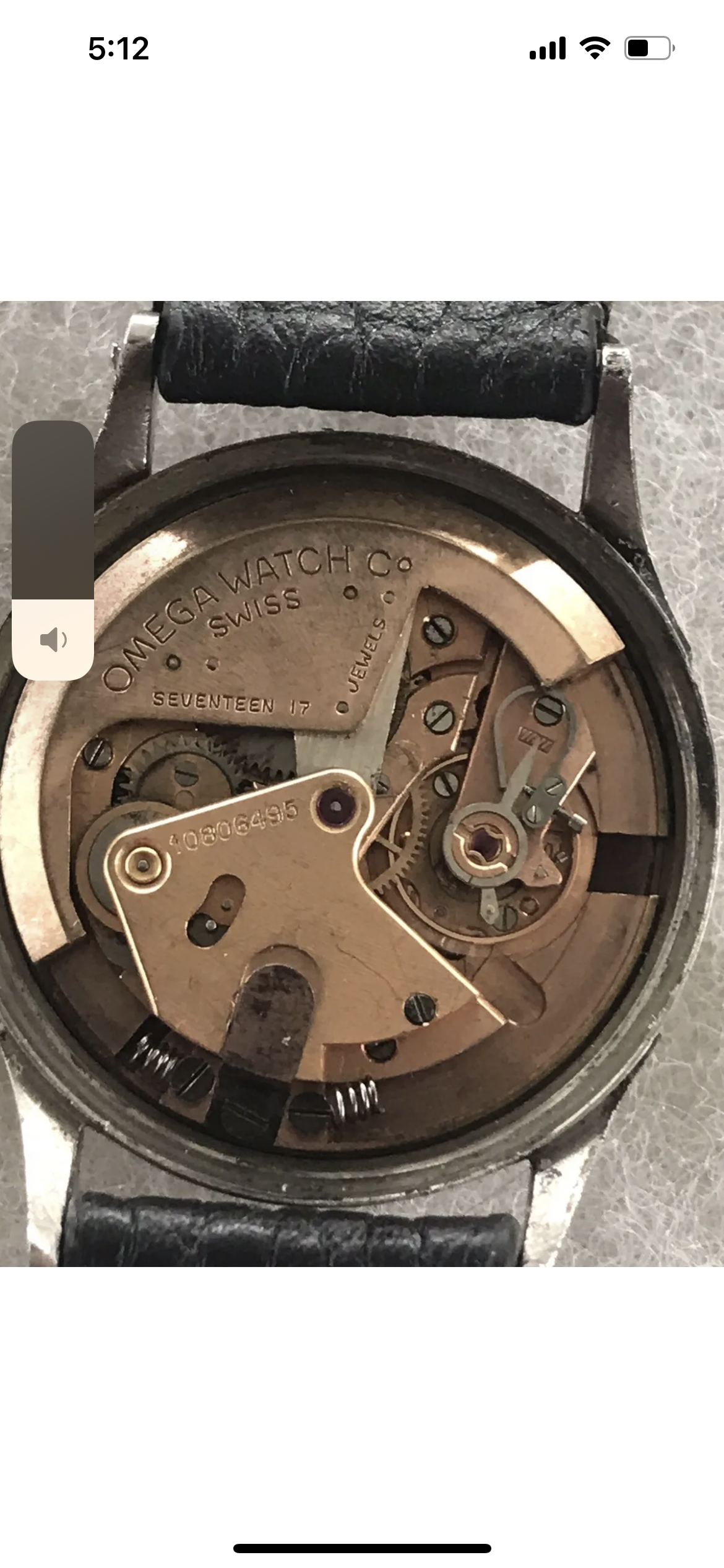

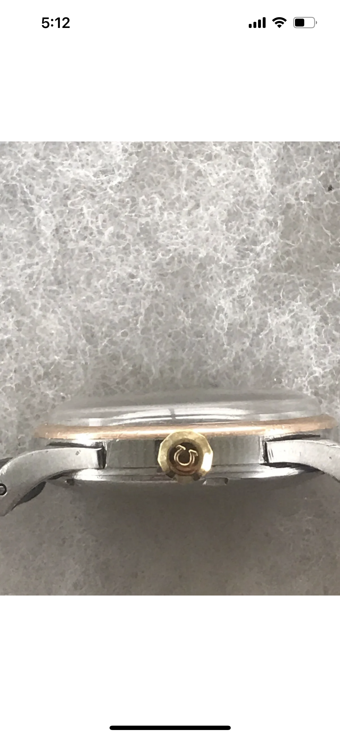

Here are some pics. Like they a say a sucker is born everyday and It was probably my day...Oh well live a learn
I posted the pictures above..... x1569016-9ec5ba3146f530aeaa458e5b971d1ebb.jpg.pagespeed.ic.0QQRqnMpeB.webp x1569020-92d7d9560a31248478908b7f0e5813d7.jpg.pagespeed.ic.LZr2rbWw0c.webp x1569018-94fc9f901a3aba47fd2a305e35ad8487.jpg.pagespeed.ic.VLjYJp87NA.webp x1569019-740fc234b032f86e7be54bf81c9e903f.jpg.pagespeed.ic.Vb6X1iQstO.webp

This is a Collectors Forum, so generally collectors want "original".....as in, How the watch left the factory.
