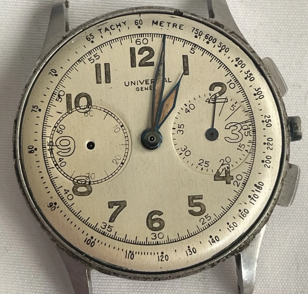

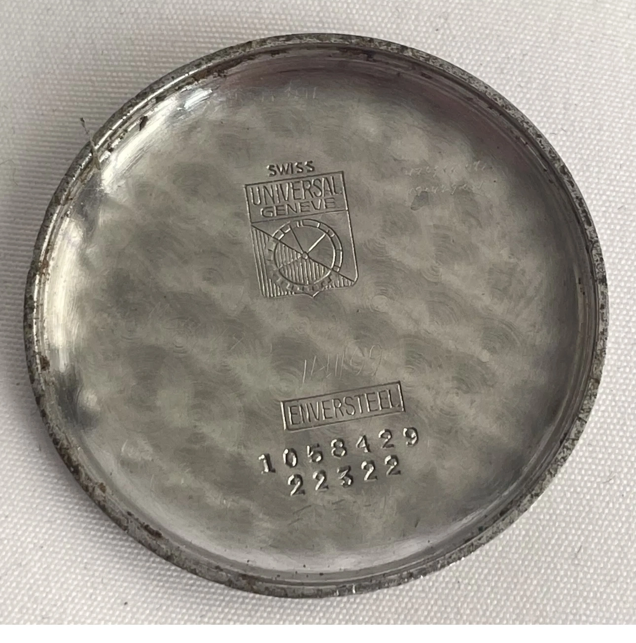

Hello. Can anyone help me identify this model? The ref number 22322 matches with a compur that I found online, so my guess would be that. But nothing on the dial. Cal. Is 283.
Can anyone help me understand if this dial is reprinted or not?

The dial is certainly reprinted and not very well.
Should I walk away? Don’t think it’s easy to get a original dial.

Hands case and movement have parts value. I swear we’ve seen this dial before. It’s memorably awful.

Any of the hands deliberately aligned in front of the A in UNIVERSAL is a red flag. Re-dialers don't tend to reproduce the flat top to the A very well.
