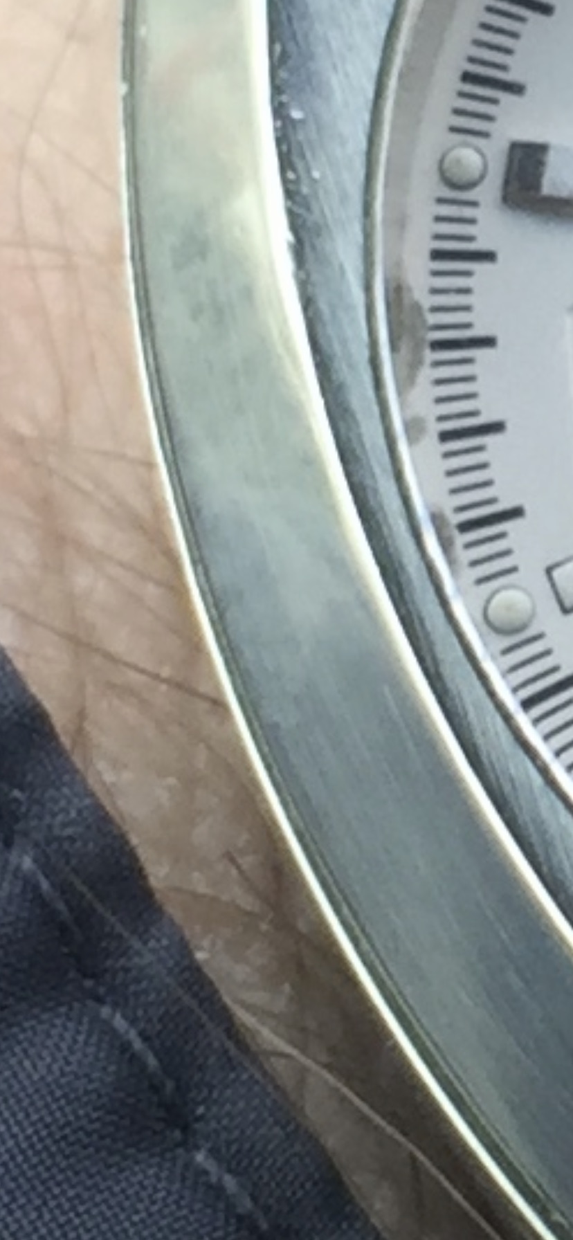

What do you suppose happened here?
Perhaps the watchmaker put it in the case a little rough?
That would be my first thought indeed. Pity.

This detachment is the result of exposure to moisture in the watch .
the end of the dial is not protected by anything and in case of possible moisture ingress

The edge of the dial is where deterioration is most likely to start. This sort of damage is common on dials, and isn’t related to installation. It could be from moisture, although that isn’t always the case.
On vintage dials, Omega will test the finish at the edge of the dial to see if it is lifting, and if it is, they will require a new dial, or a dial refinish.

Thanks for all the answers everyone.
Do you know roughly how much a new dial is from Omega? Are we talking like $300 or $1000
I'll probably have the dial replaced next overhaul in a few years, though I'm wondering if this dial would be available then. This one was apparently overhauled a few months ago.
The dial is currently closer to $300, then $1000. What it will cost at some alter date is difficult to say. If this was overhauled recently, I suspect it wasn't done by Omega, or the dial would have been replaced.

Yup - not done by Omega, and somebody left a fingerprint on the moon in the moonphase! I'll definitely take a look at the movement when it arrives. Seems amateur for a watchmaker to leave fingerprints on anything
