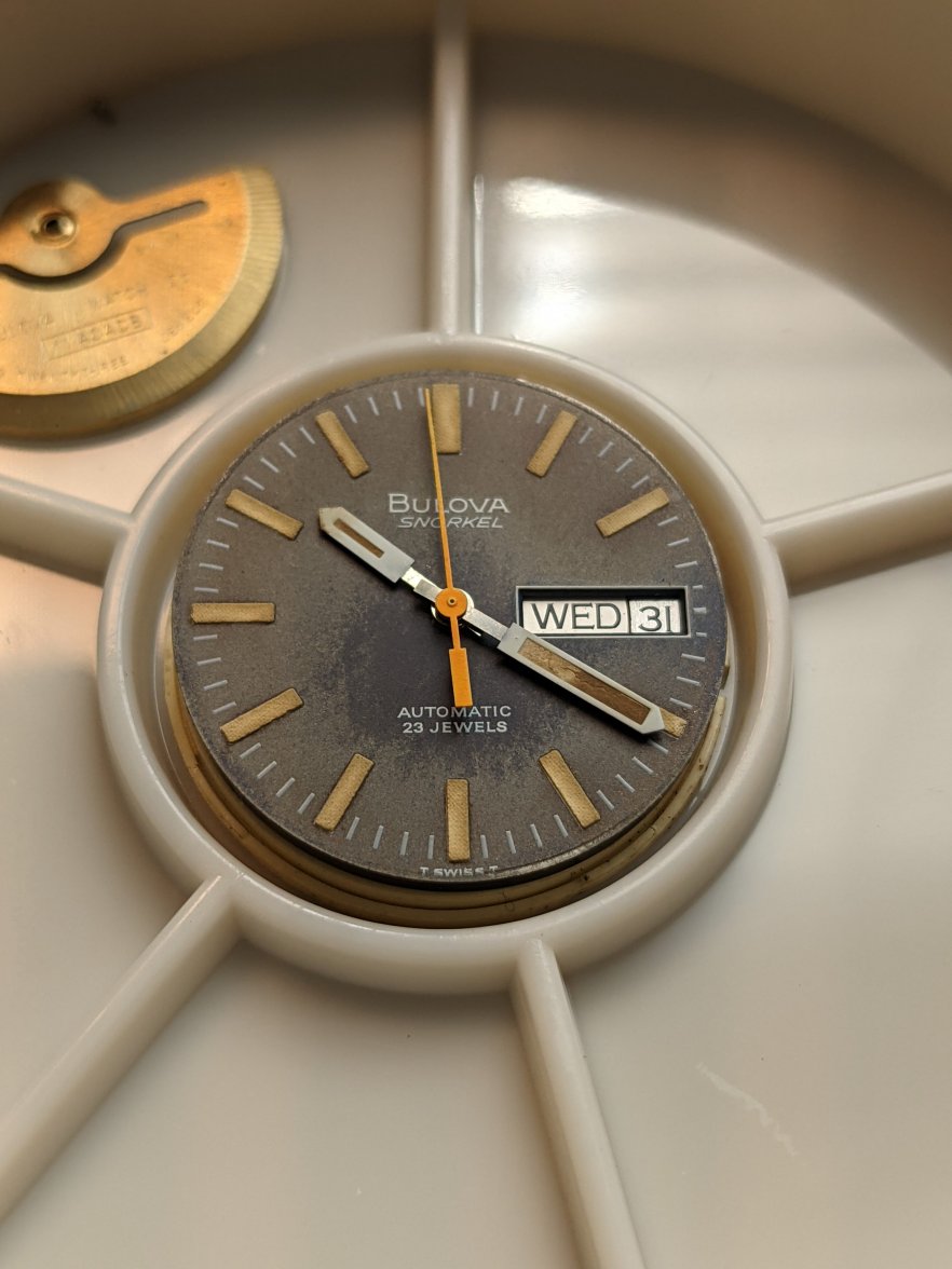

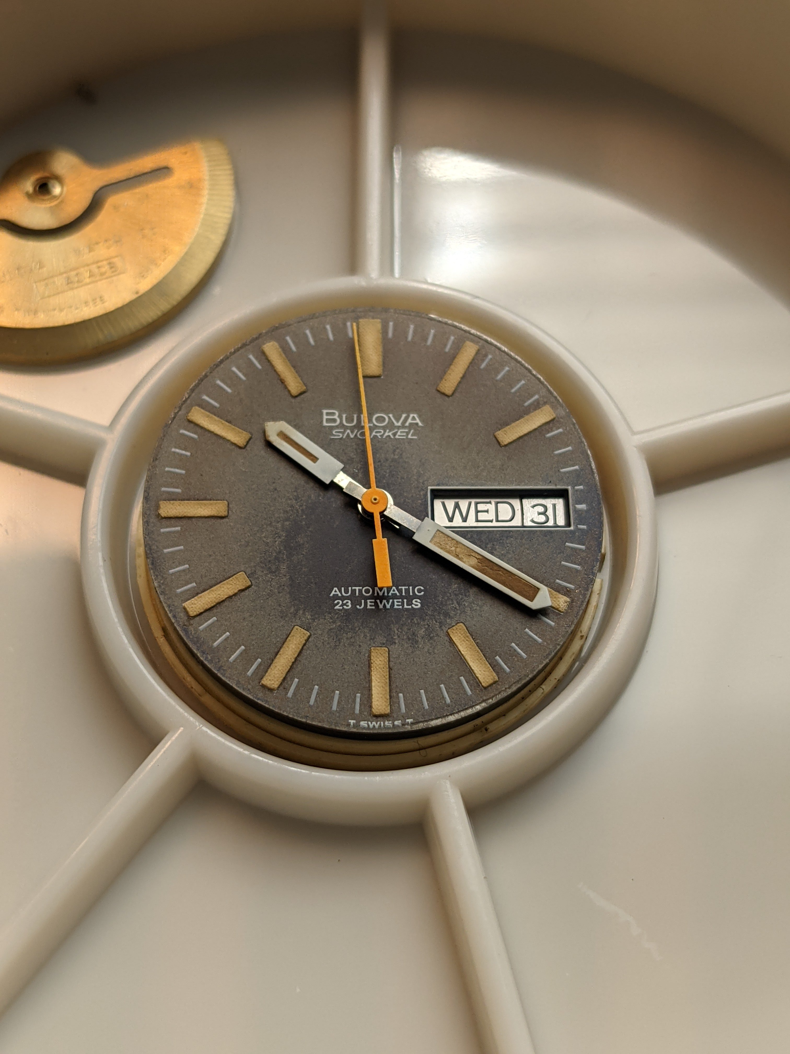

I guess the first question would be do I just leave it alone? (like I wish I'd done to the bezel..... damn sonic tank!)
But if there's a safe(ish?) way to clean this dial up, I'd love to hear them.... I've seen suggestions of lemon juice before but was curious as to other possible solutions? Thanks all!
Complete and total destruction of the dial finish is always a possible outcome when cleaning. It is best only attempted when the dial is intolerably bad (which this one is not).

As stated ^^^.
Vintage dials are not “cleanable”. Unless you’re prepared to destroy them.

If the patina/condition of the dial is something you don't like, you would be better off selling it. Otherwise, you would take a massive hit in value and enjoyment of the piece by destroying the dial.

As stated ^^^.
That is why I find the old ceramic dials so interesting. These can clean up like new. Downside is so many develop hairline cracks over the decades.
Even then there are methods of filling in and making such cracks nearly invisible.

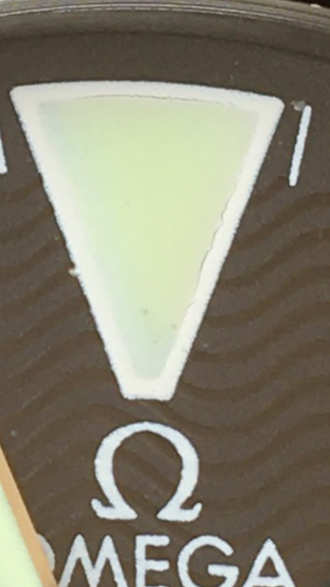

Can someone advise on my 2254, please? I thought it would be better to post in here rather than post a new thread. I’m not sure if this has always been there, only now I am noticing it.
Is the lume known to be inconsistent?
Or, Is the lume known to ‘degrade’ or the nicer word ‘patina’ - knowing these are printed dials, would that affect the ageing of the watch?
There are two issues I see - one is a few darker spots in the lume near the sharp point of it, and the other is the cracks around the perimeter of the lume. The cracks are likely age related, or due to some sort of damage like a dropped watch or something like that. I've seen much worse - cracked dials of this type...like so...
The dark spots I've seen before, and sometimes they are on the surface, but I've also had them buried in the lume. Hard to tell without looking at it in person.
Just looking again and maybe there is a third issue - the left side of the lume plot seems a slightly different shade of colour maybe - not sure if it's just lighting.

Thank you for your reply! Much appreciated!
thankfully, the third issue is my camera skills. The lume is even, it’s just the angle I used to take the picture.
I don’t mind the degrading lume as such, just glad it’s not just mine and there are other examples of it happening.
The watch is daily used. It’s been all around the world in all different types of heat and humidities - character is something I don’t mind building, just wanted some reassurance it’s not just my ‘non tritium’ dial watch that potentially shouldn’t be changing.

That looks water damaged to me, not dirty, so I don’t expect cleaning to be successful.
