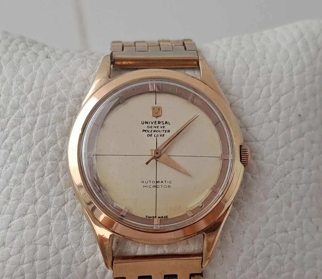

Por favor, me ayudan a descifrar la inscripción en la caja de mi reloj Universal Gèneve Polerouter. Gracias.
18,840
39,184
It could simply be a national hallmark for a 10 carat gold case, but as we have no other information it'll be hard to give a valid answer.
Where are you located?
Is the case a "national production" case (i.e.: not made in Switzerland)?
Have you researched gold hallmarks used in your country?

Thank you. What I'm trying to find out specifically is whether the number "10" means that the box is 10 carat gold or if it indicates a 10 micron gold bath. Is there any way to know from this stamp?

1.The dial has been repainted. Not a very good job.
2. I have never seen that kind of hallmark before. Maybe you can get a picture of the inside of the caseback.

The watch appears to have a stainless steel case back. My guess is that it is not Karat gold. Possible 10 micron gold filled.

Muchas gracias. Así es la tapa es de metal. También sospecho que es enchapado, solo que nunca he visto esa impresión en una caja suiza. Saludos.
