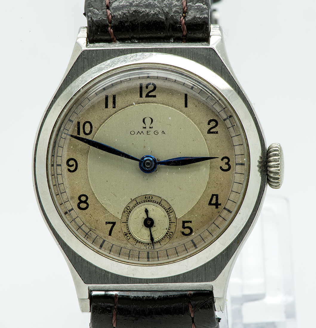

New lens has arrived and with the 1.7 extender seems to work admirably
Scan is D800 105 f2.8 + 1.7 at f40 MU at 1/30sec
15,047
24,042
Works well enough to acquaint you with a new nemesis , dust bunnies. 😁
