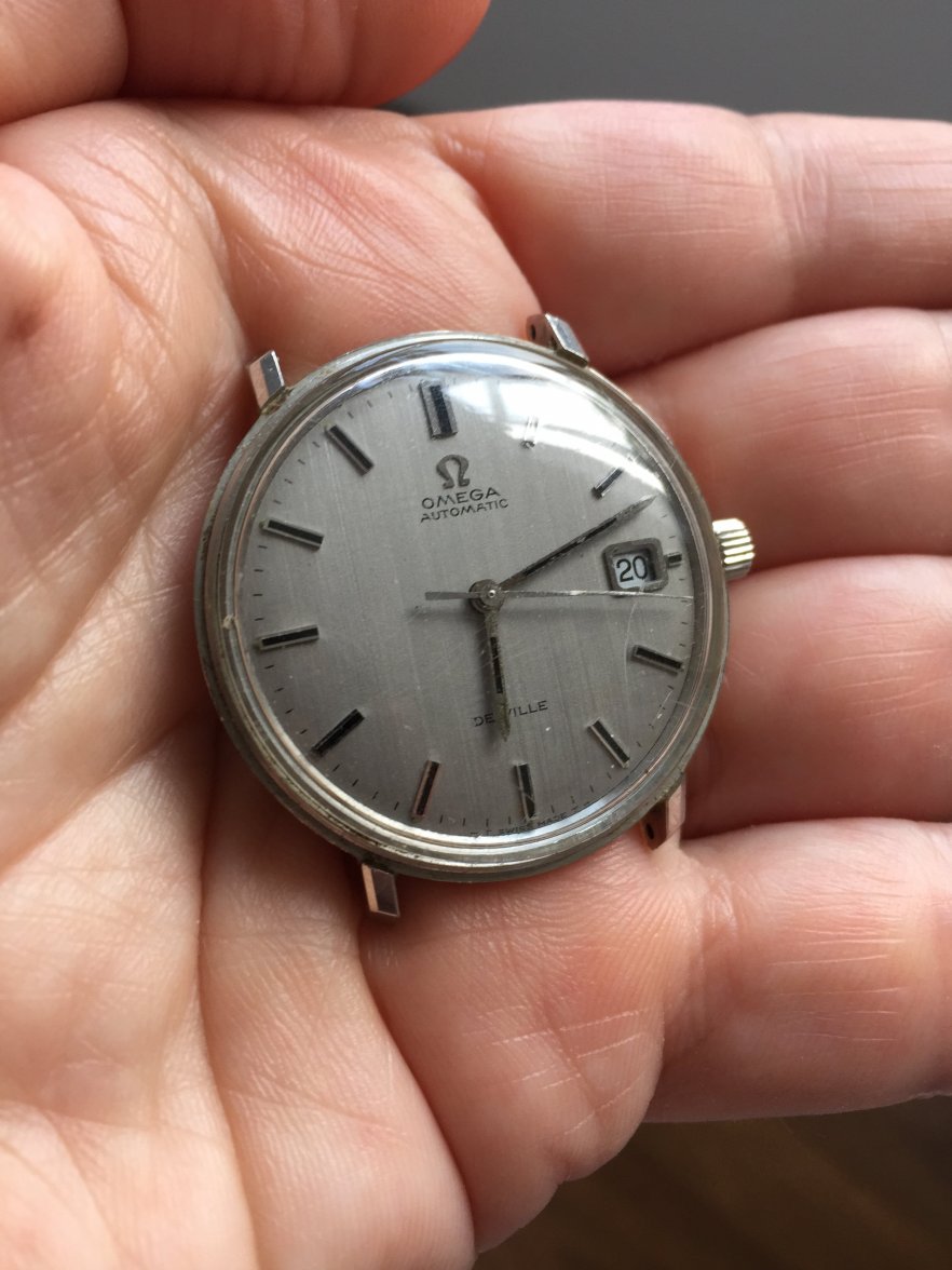

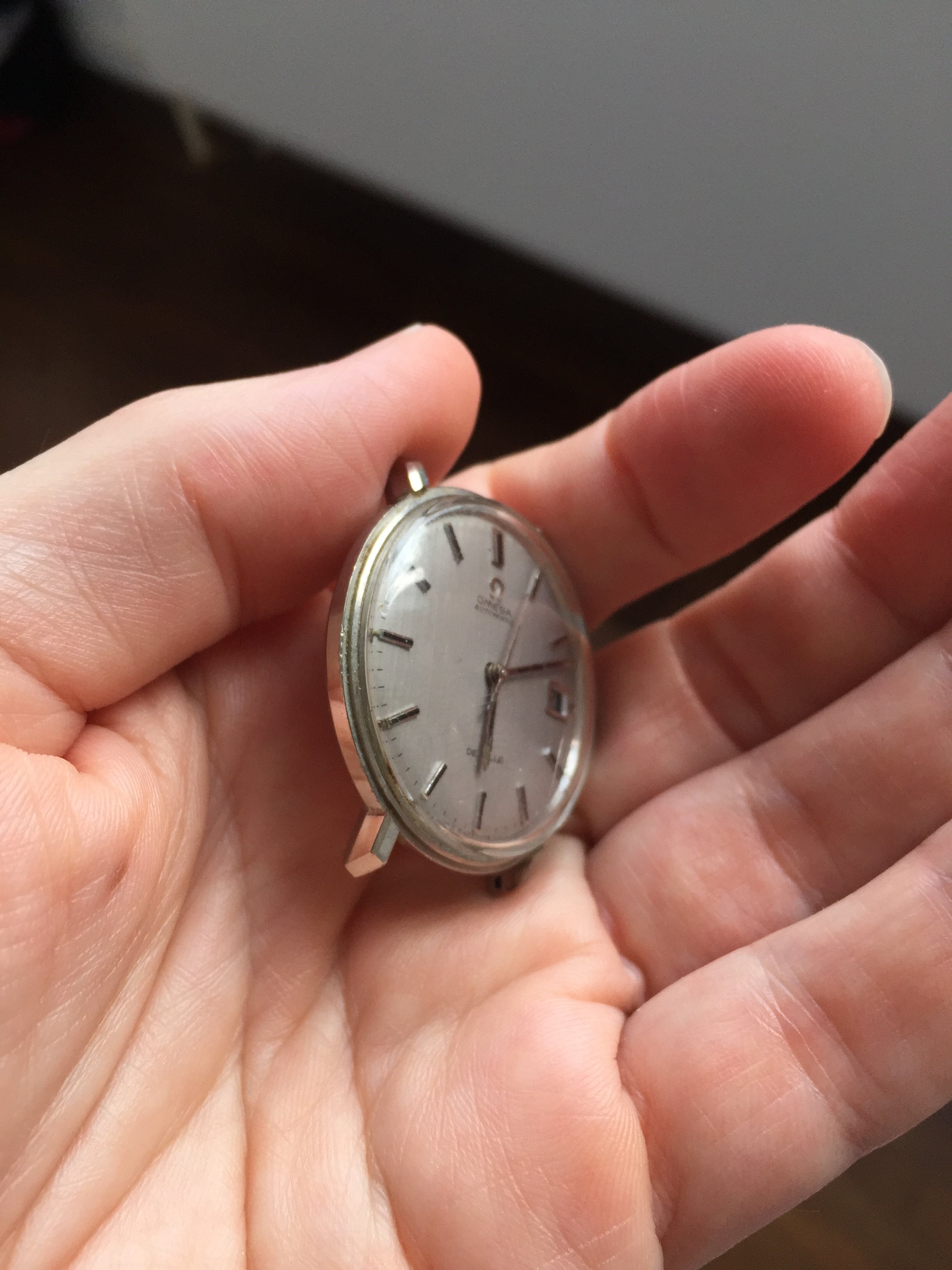

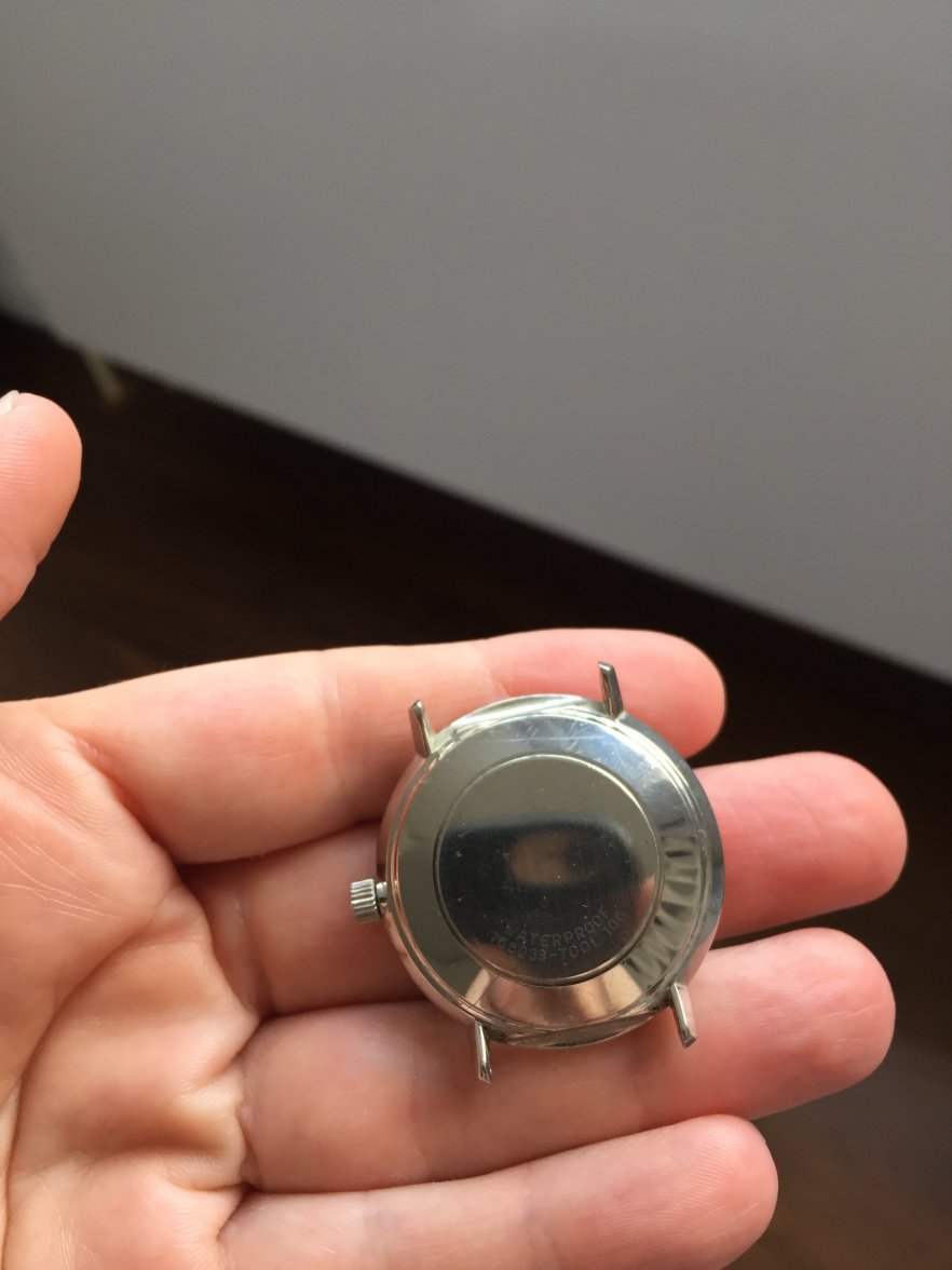

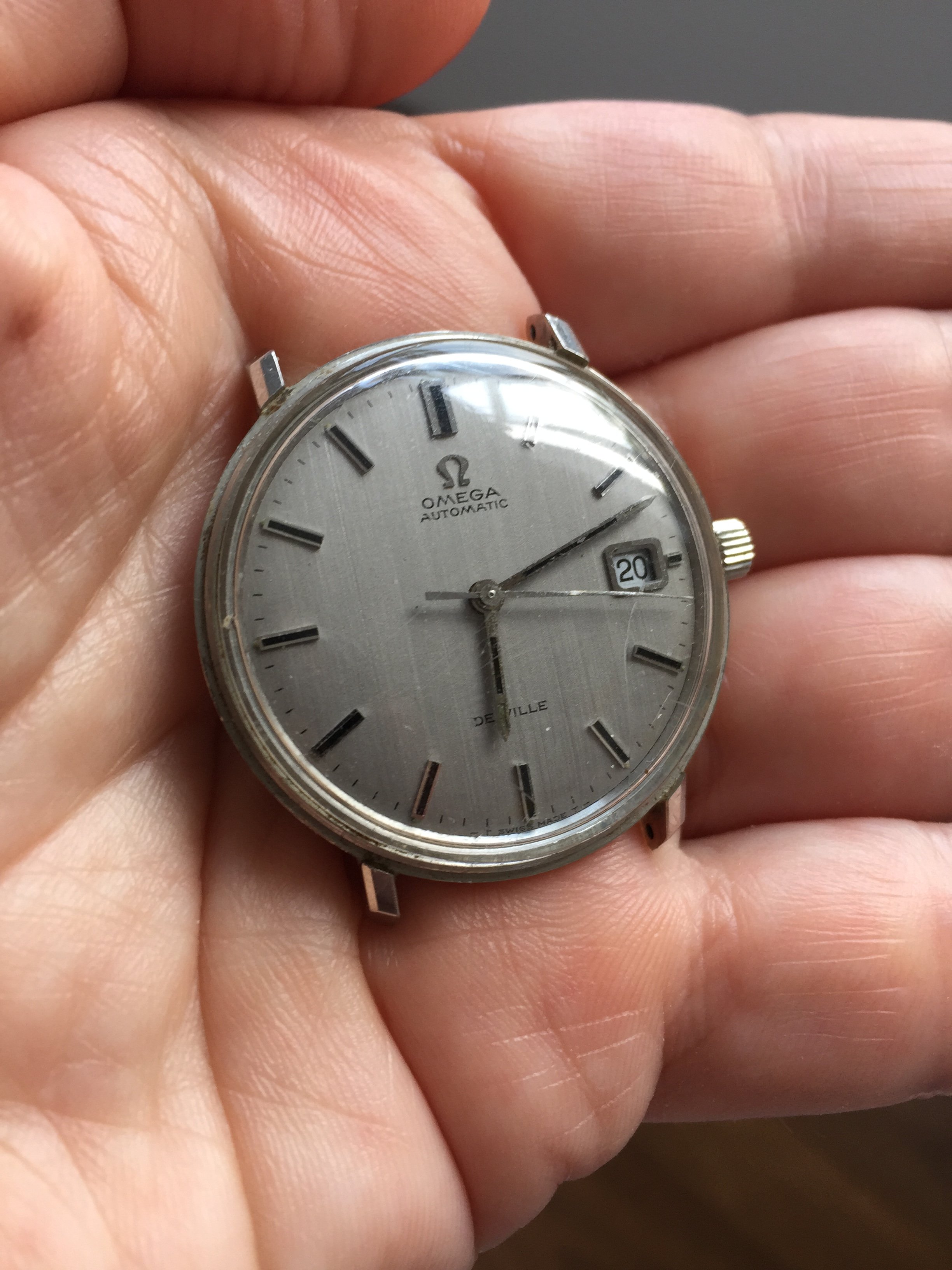

I’ve had the below watch for some time now, it came as part as lot and is missing a bezel.
However I have no idea how to open the case.
It doesn’t look like the back screws off and I can’t see any joins - the case looks like it’s one piece.
Im assuming you have to remove the crystal and crown and do it from the front?
Any ideas what model it is and if I can source a bezel from omega?
Thanks in advance
13,555
23,503
Yes the crystal needs to come off, then the crown end of the split stem is pulled off, the dial/movement rotated and then it will tip out.

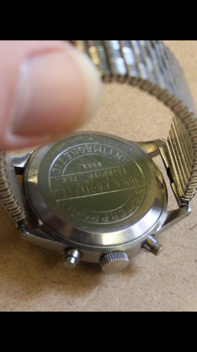

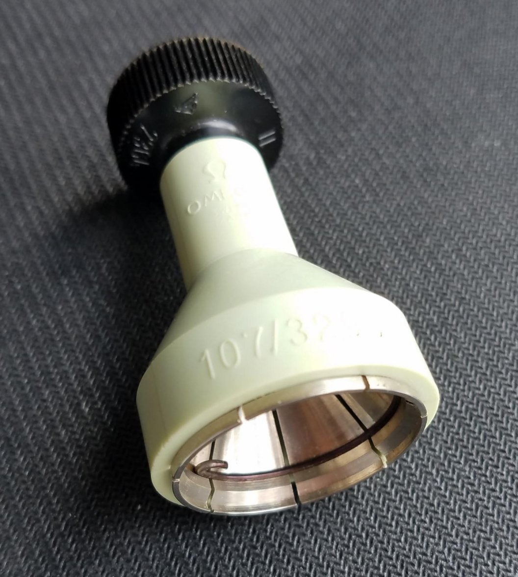

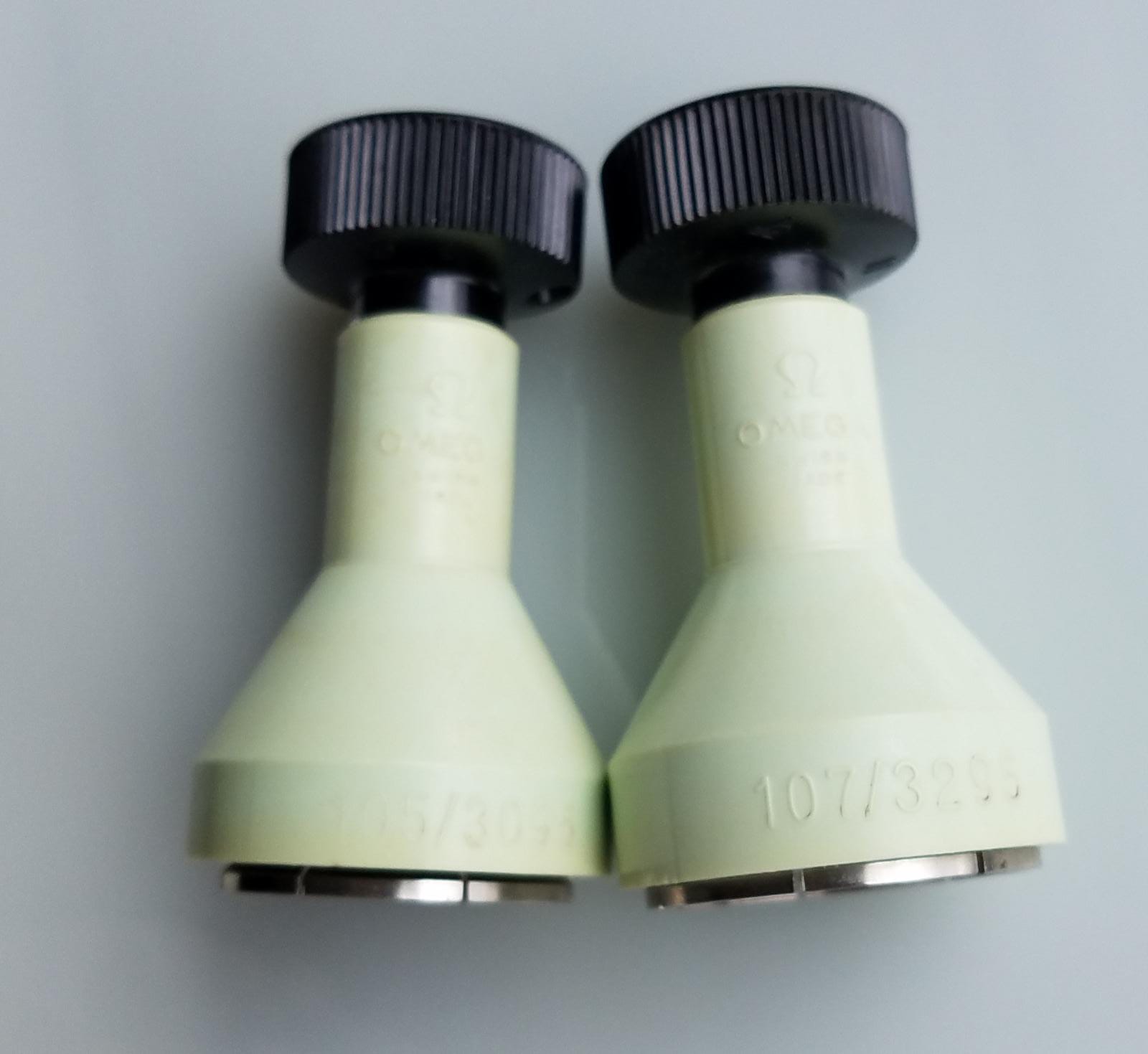

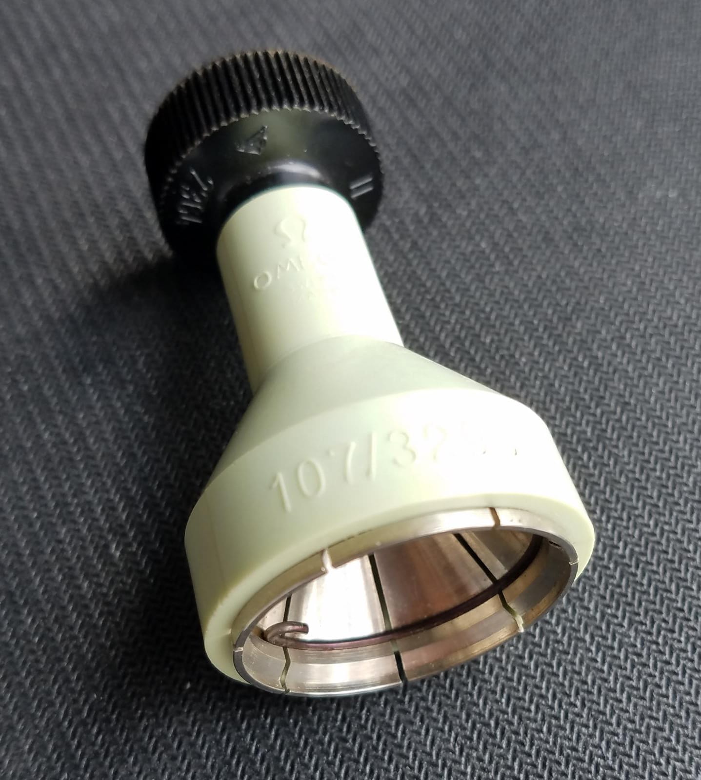

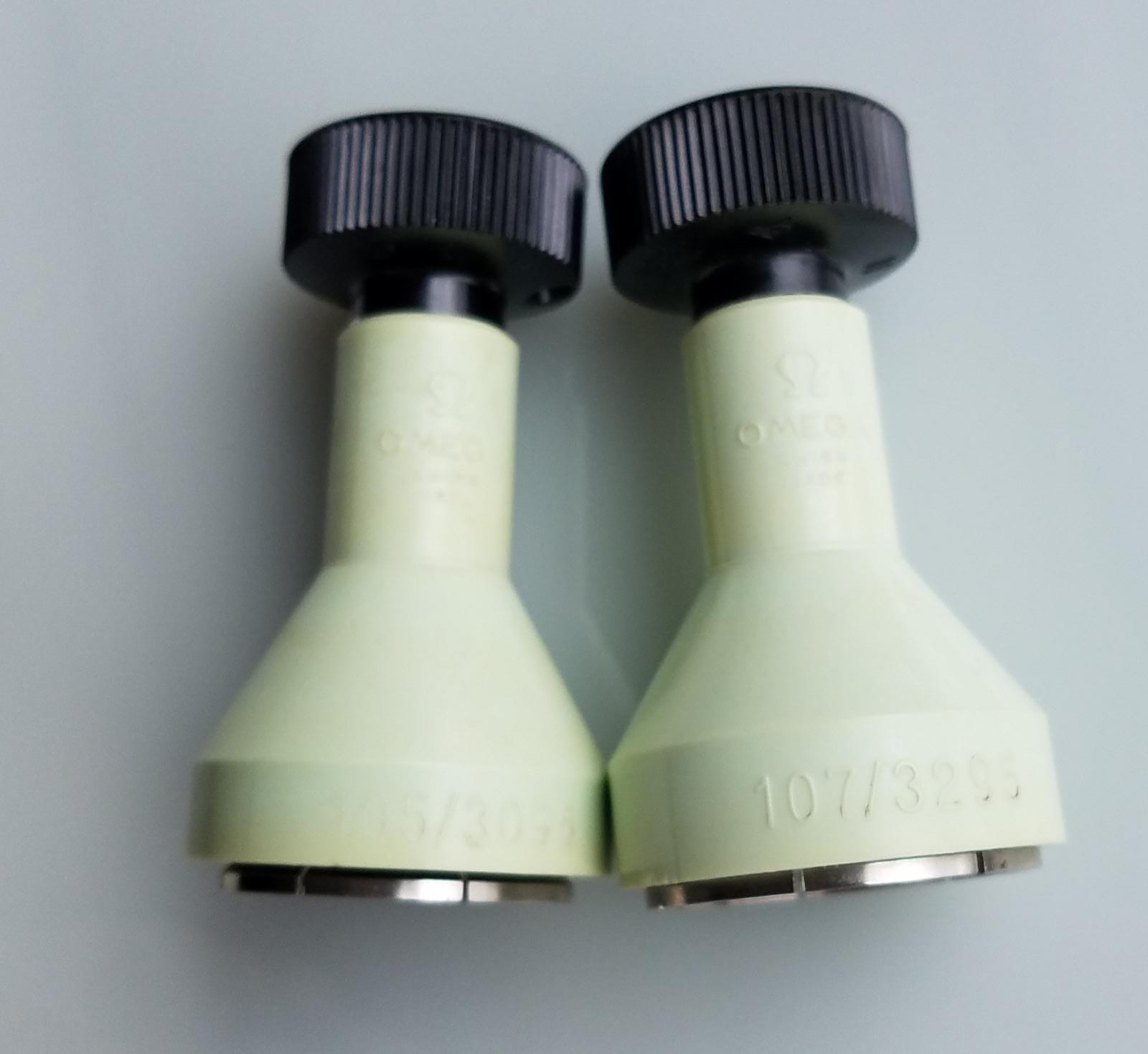

As per the script on the back of your watch, you need a crystal extractor TOOL 106. Example of 107 as shown below. Sorry, I don't have 106.

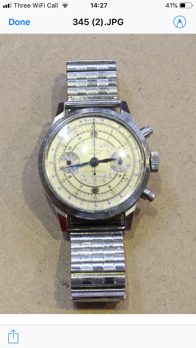

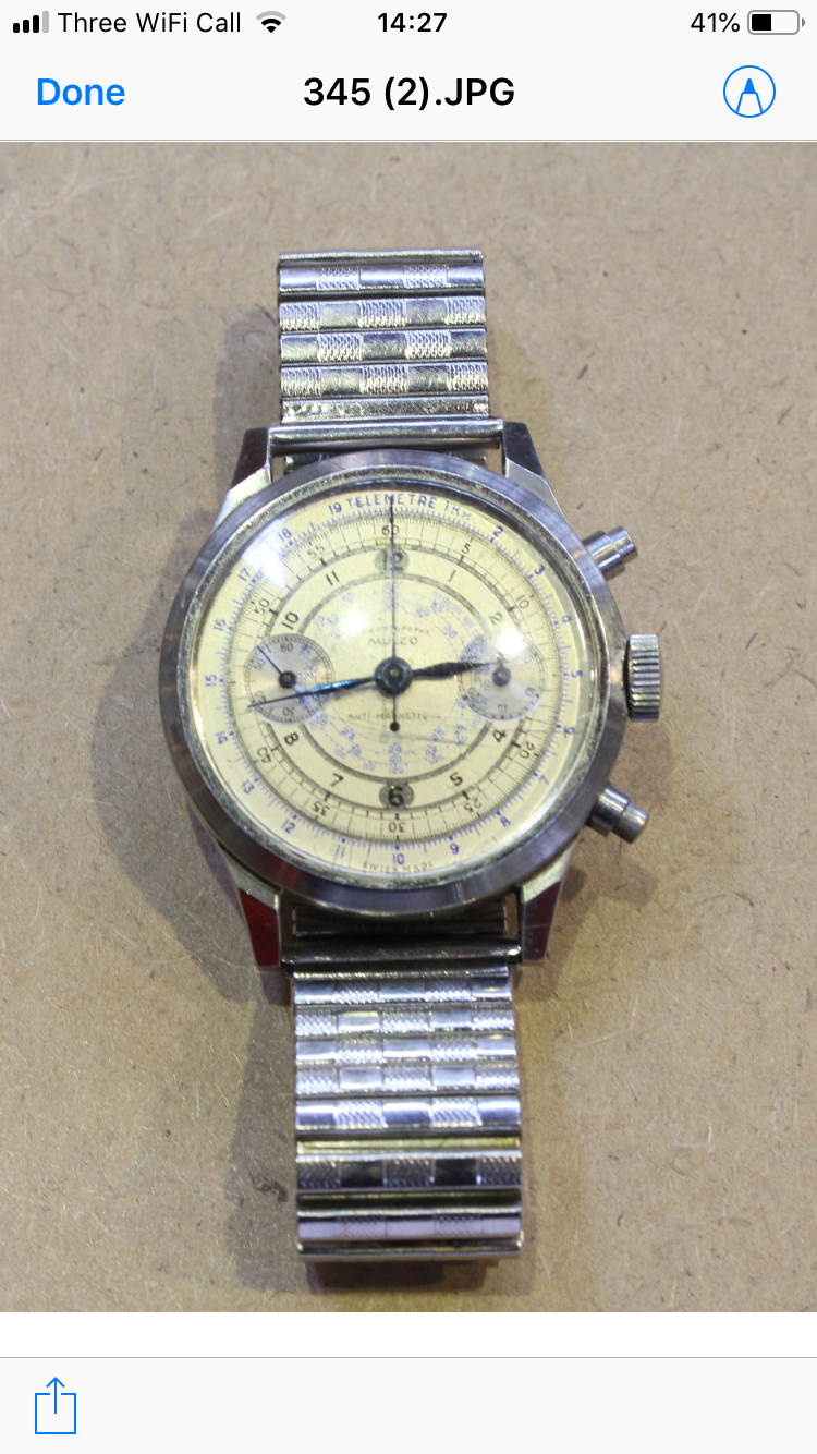

Yeah got it as part of 3 watch lot, although the auction had the omega as the main part of the lot. But for me it was the below (auction house photos 😀 )
