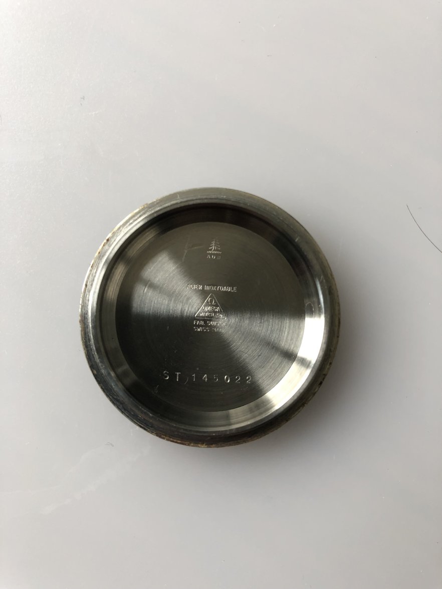

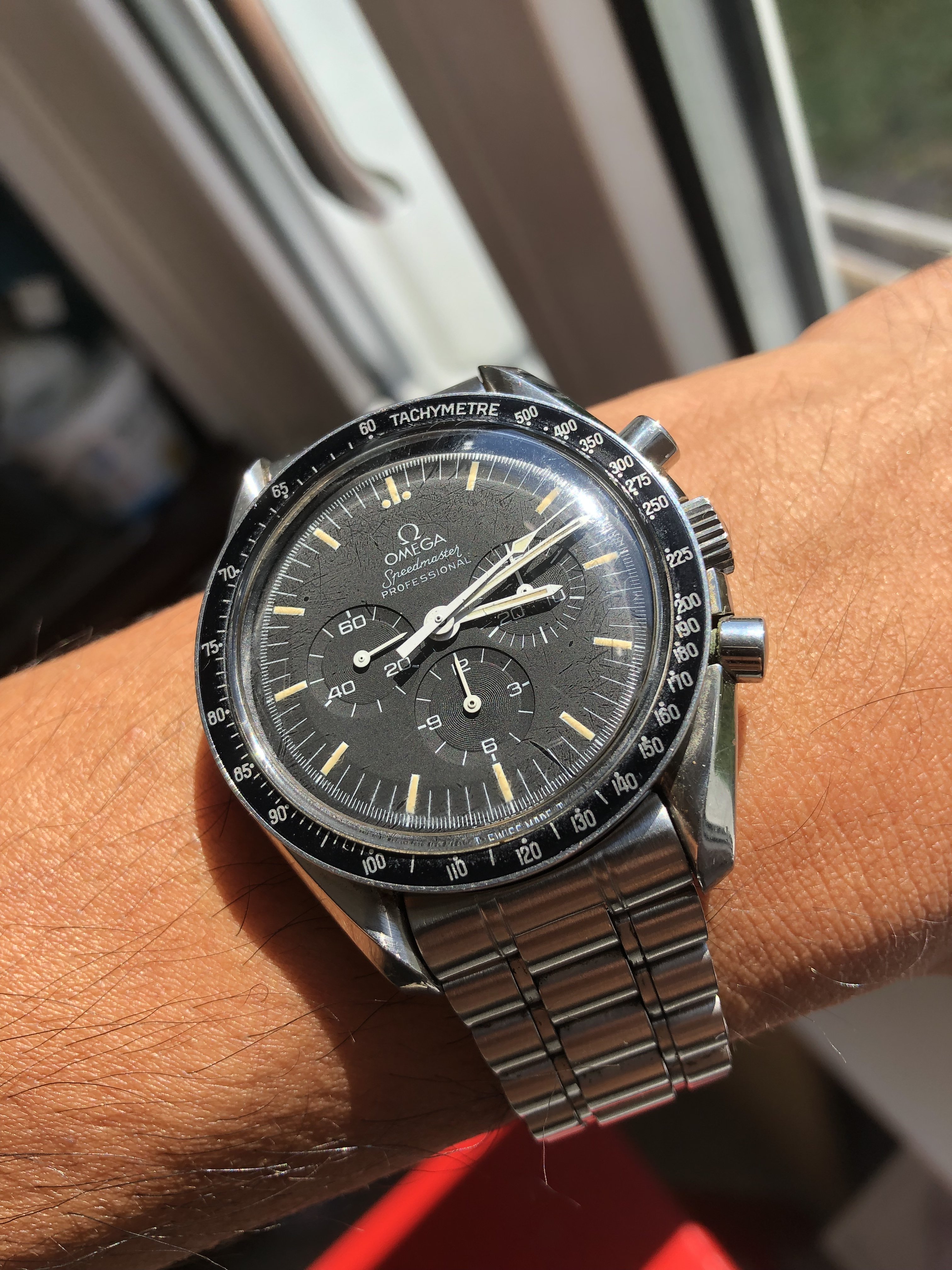

Was interested in purchasing this ST 145.022 Speedy, with a 4823XXXX serial listed as a 1990. From my research (and sifting through many conflicting sources) I believe this is likely from 1987. Also believe that a 1990 would be a ref 3590.50, and not the ST145.022 (but again have seen conflicting information) Since this is a birth year piece for me, I would really like to get it right.

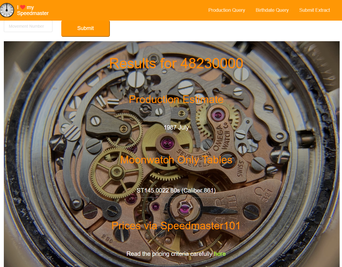

Hello and welcome to the forum! I'm no expert or even too experienced with Speedmasters, but I believe https://www.ilovemyspeedmaster.com/productiondateprediction/ would be a good resource for you search. Just did a search with a generic 4823000 serial number and got the below.

Dial and bezel are consistent with 1987 production.

the watch in question is attractive, but not without issues - the lugs look soft to me, the minute hand needs stabilising (lume cracking), and the minute track should be looked at closely ( of course, it could just be the crystal needs replacing, as its scratched etc).
A 3590.50 would still have ST145.022 stamped on the inner case back as the case ref remained 145.022.

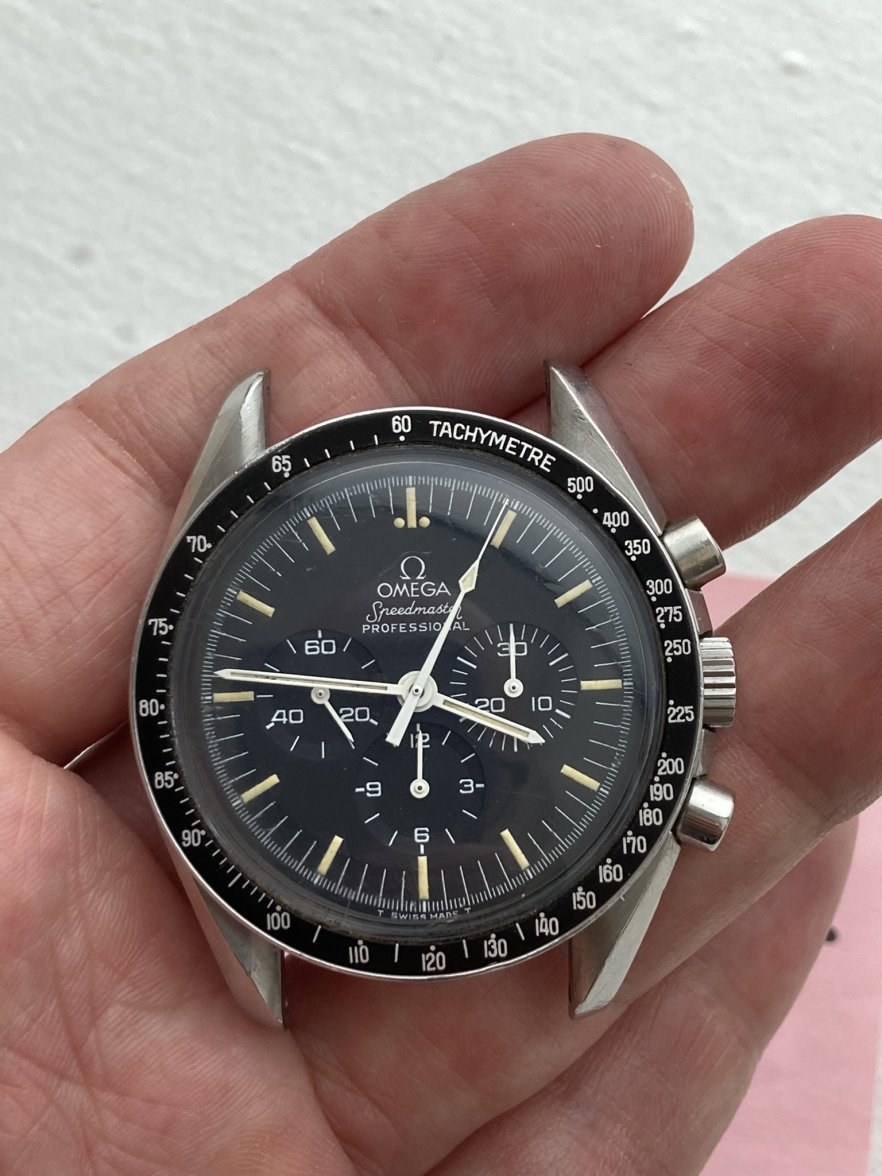

Here is mine from 1990 (sorry already promised to another member)

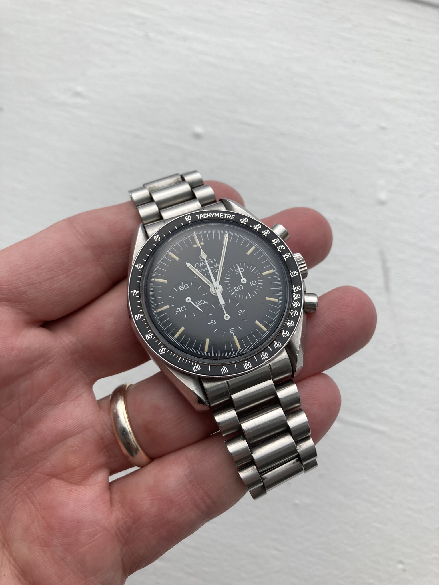

At a price of $4000 incl. 1450 bracelet I think it’s a great deal regardless of the production year.
Beautiful piece! If it falls through for any reason, please let me know!
