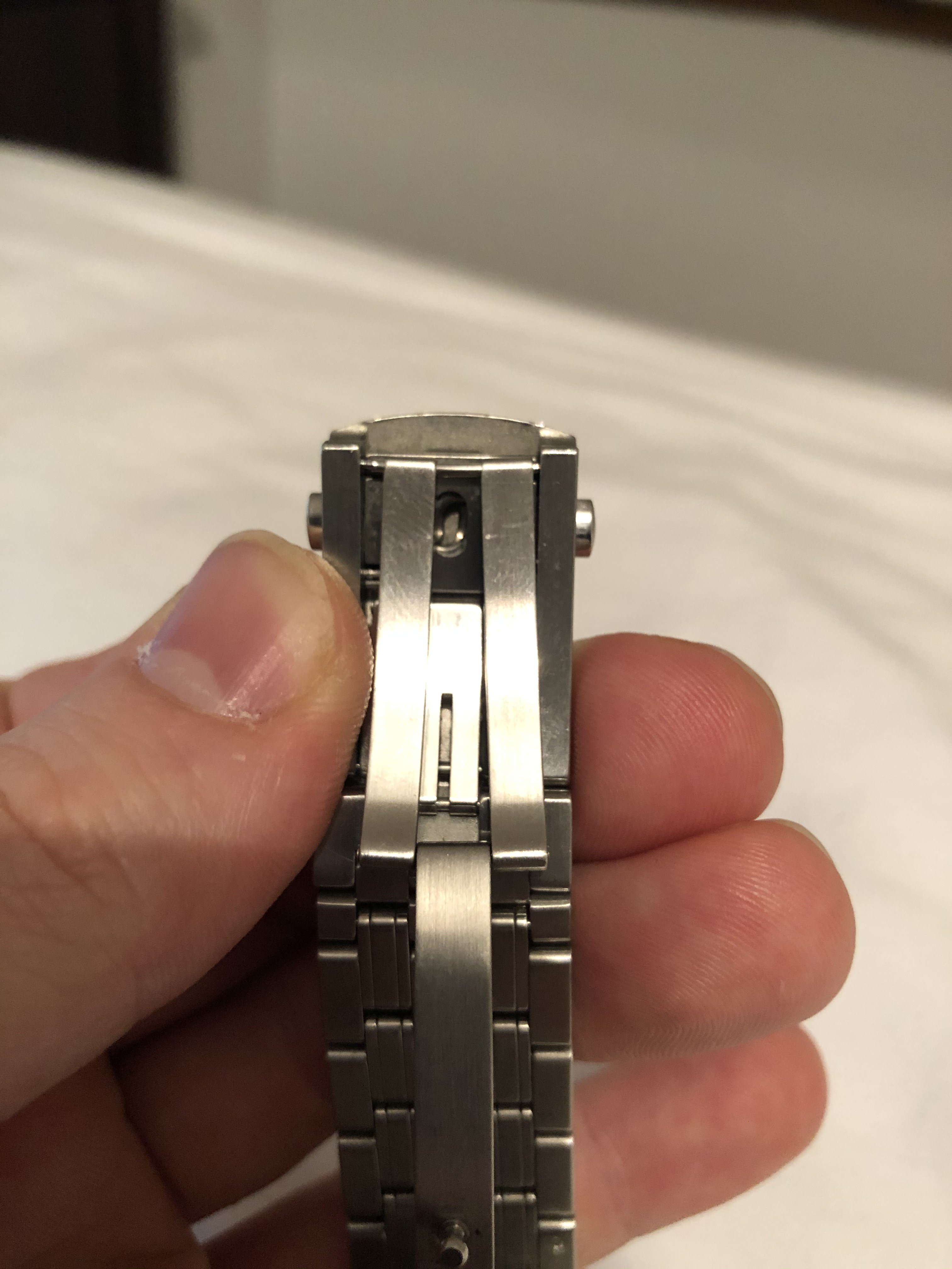

Sorry for the poor description, but I have somehow managed to damage / lose part of my clasp. Its now loose and bends in. Does anyone know what part I'd need to repair this?
The watch can still be worn but I'd like to get it fixed. See image below.

What happened to the tube the goes between? How does that happen while the spring bar is still holding on?
6
Im guessing theres supposed to be a tube that sits between to keep the two bars from bending in?
408
355
Yep. As per @Meme-Dweller 's question, where did the little tube spacer go?
6
I honestly have no idea whats happened to it. The watch was passed down to me though & was in this state when I received it.

I can’t quite see from the pics but there should be a metal collar between the two legs, is it missing? You should be able to buy just the clasp half rather than the full item, I’ve seen them on eBay. Alternatively on my clasp that same pin that goes all the way through the legs, collar and side clasps has screws both sides so likely you can replace just that.
EDIT: Sorry just took a closer look at my clasp. The screws in the side don’t line up with that pin, so I think the clasp top replacement would be the better route,

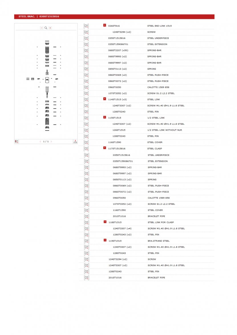

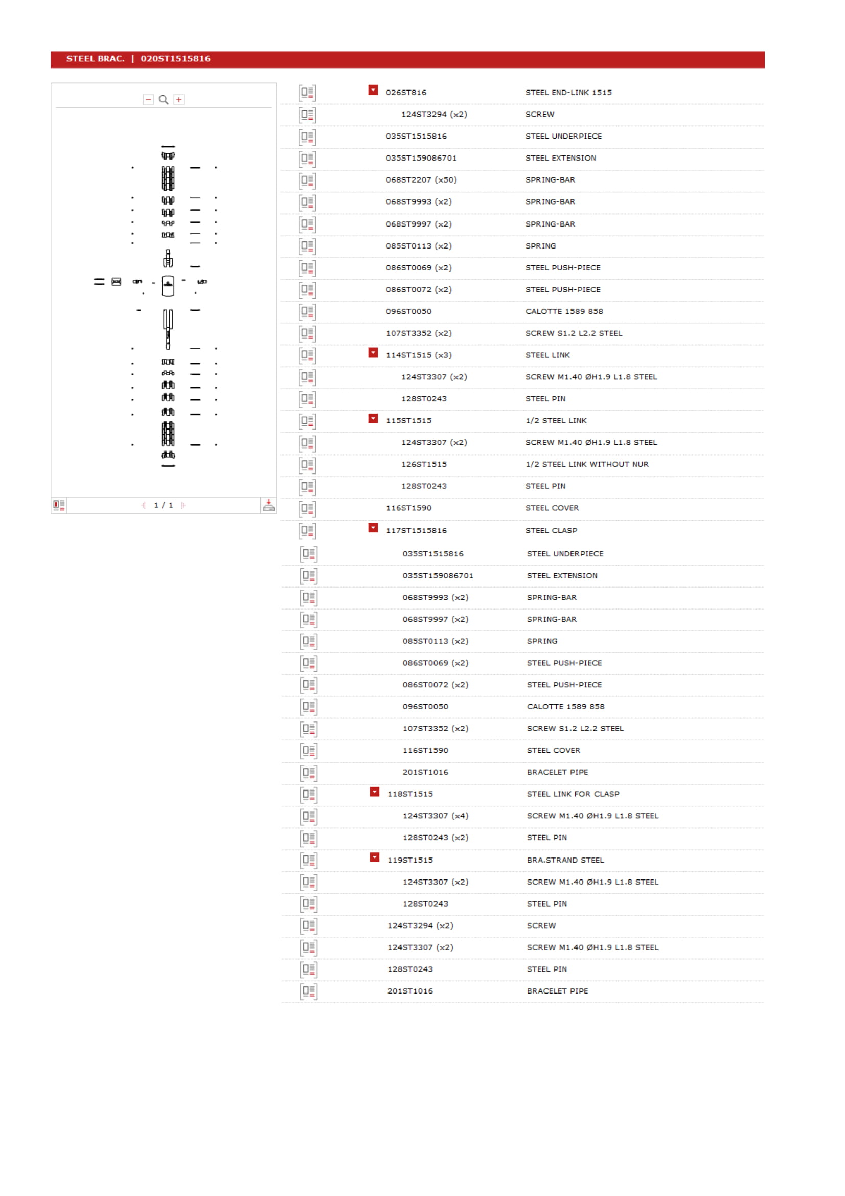

If your watch is not a chronograph, then your bracelet is 1515-816 and I guess you need a new "bracelet pipe".

and also replace the whole bar while you're at it since it is clearly bent
