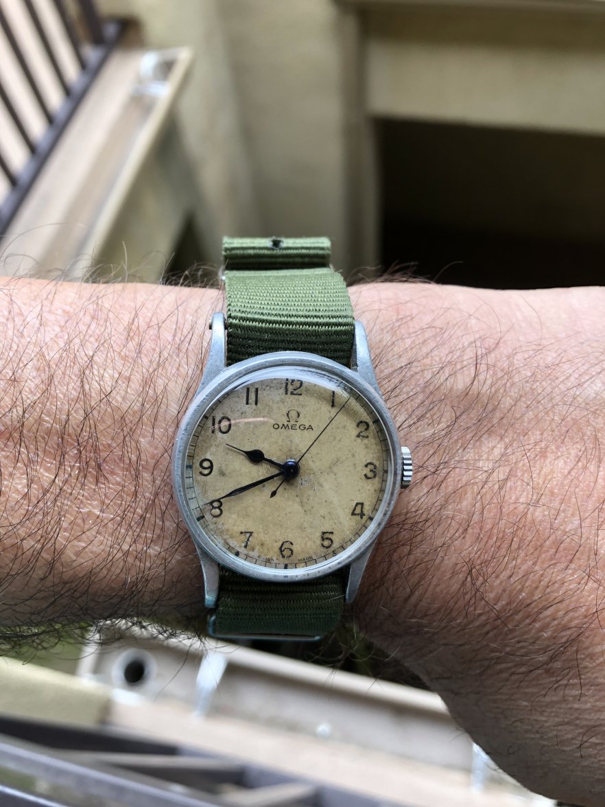

Greetings,
I am new to the world of watches, but not to the world of collecting. I have been collecting antique military arms for several years but have recently become interested in watches. I have been doing some research and read about some watches issued to the RAF during the Second World War. After looking through past posts on here related to them, and have learned a lot. I like the Omega 2292 and other war time issue ones the most. But the few I have seen on E-bay seem to be over priced or are not in a correct state. Does anyone have advice when it comes to finding or buying one? What to look for? Anything I should know?
Thanks.

Look very closely to the lengths of the lugs. They have fixed bars. Some got decommissioned by cutting off/shortening the lugs of that alloy middle case. That alloy middle is prone to fatigue. All the rest is no problem. Kind regards. Achim

One aspect to be aware of is the distinction between steel case (CK2292) and alloy case (UK2292) versions. If memory serves correct, steel cases are less common, which explains why they tend to be more costly. If you see a wide spread between 2292s for sale, there may be a case metal difference between them.

Fakes? Don't think so. Lousy alloy cases, damaged and therefore shortened lugs, re applied engravings. Yes, but that's it. The RAAF had steel cases. Propably leftover from the RAF shipped inside the Commonwealth. The 1956 steel case version done by the MoD are correct in their own right. I prefer them, because these are daily wearers. Not the Alloy cases.....make sure, all hands are blued and correct. The center second hand has to be long and with the correct counter weight. Very hard to find.... Kind regards. Achim
