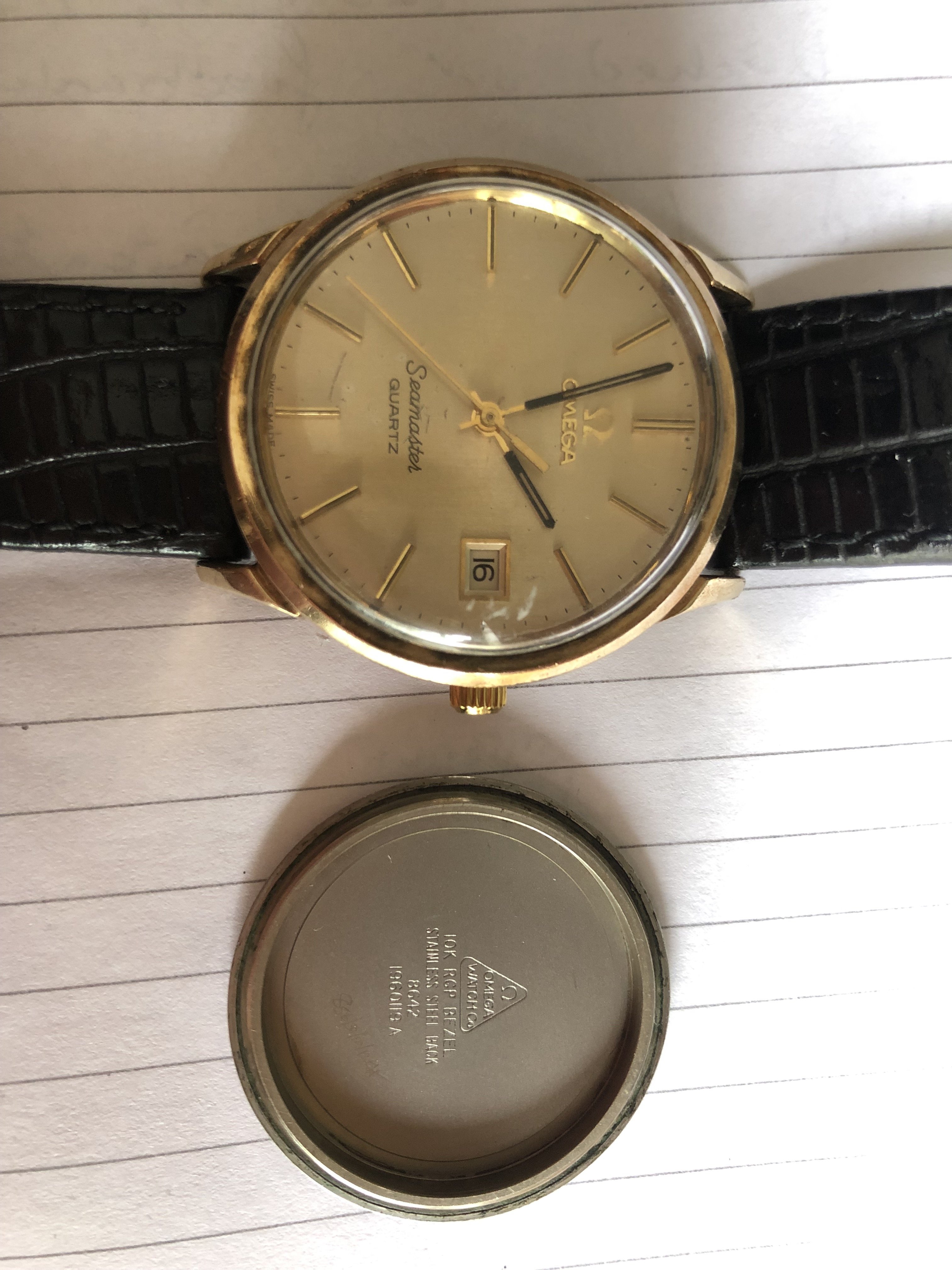

Can anyone tell me if there is a generic crystal that will fit this watch?
Name: Omega Seamaster Quartz

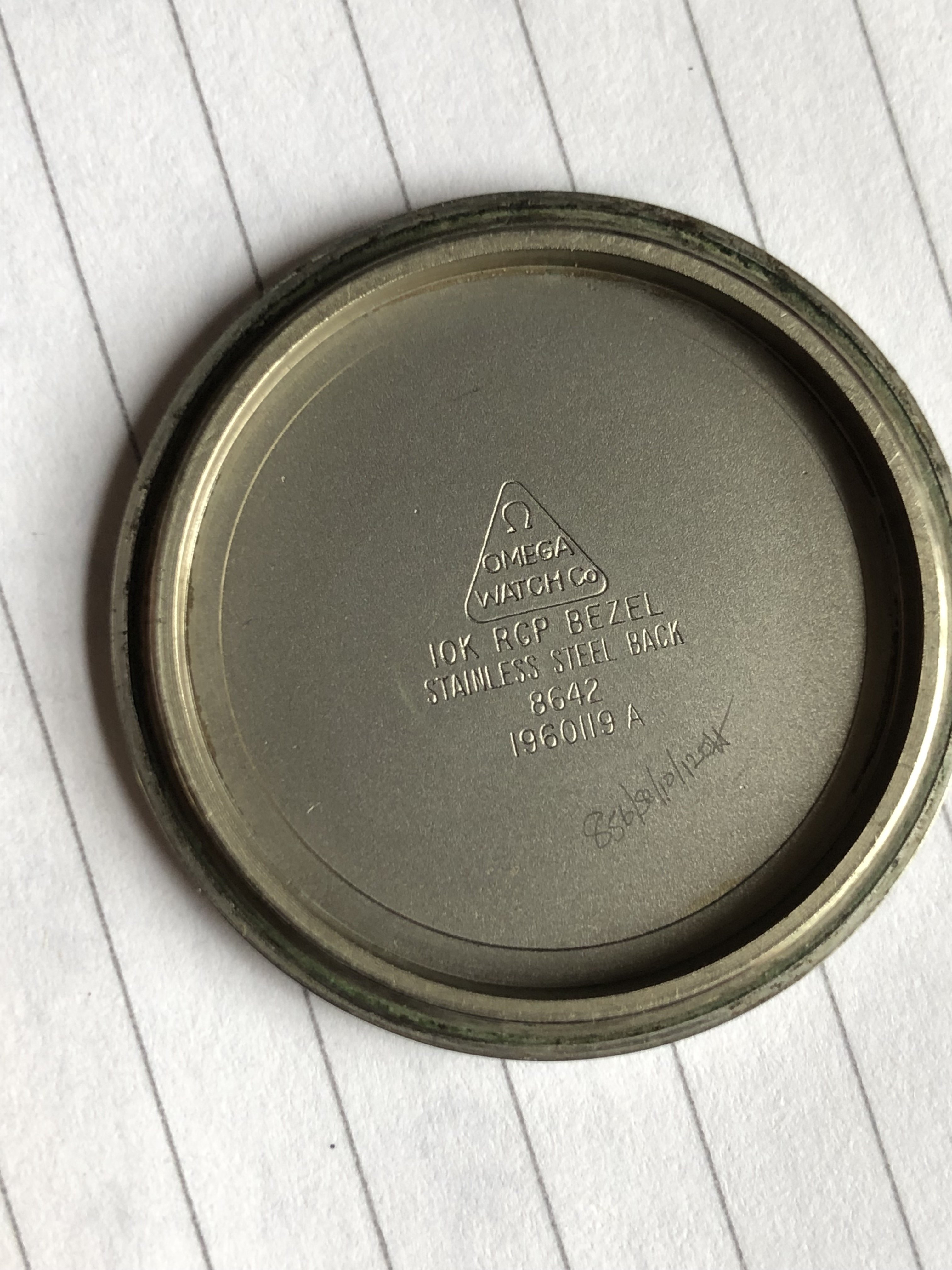

Model (back of case back): 1960119
Caliber: 1370
Back of case: 10k RGP Bezel
Stainless Steel Back
Just wondering if e.g. Sternkreuz do one or if it has to be a signed and genuine Omega plexi?
Thanks
29,917
77,362
The Omega crystal for this is 063PX5131.
