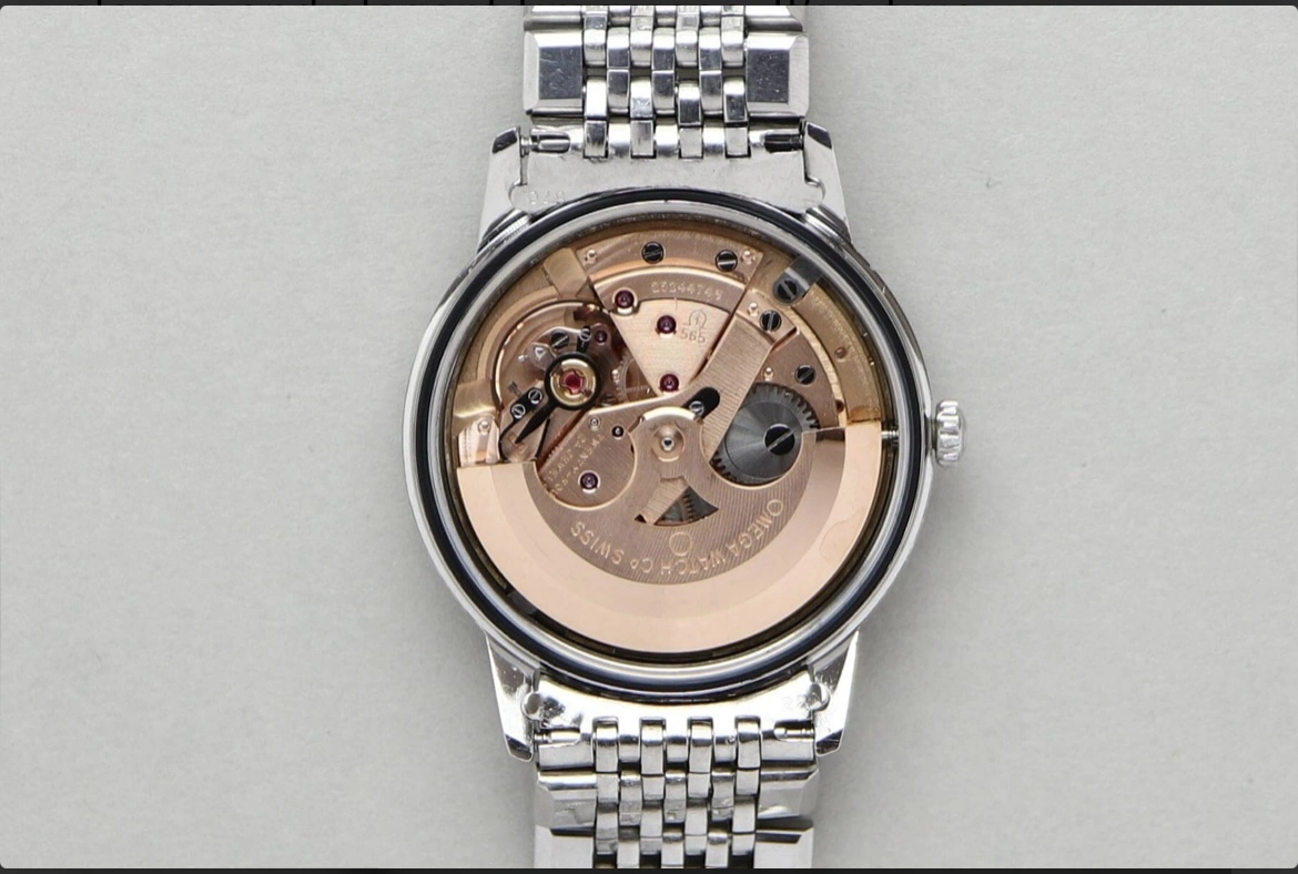

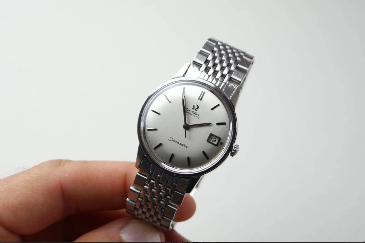

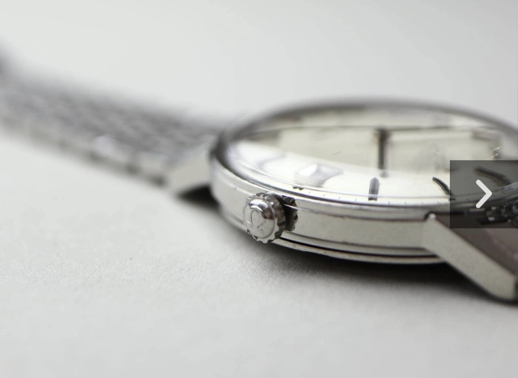

So I just got my first vintage Omega. Super excited, but of course it has to come with a twist after I purchase it… “full serviced” supposedly. All original parts still I believe. After shipment the dealer tells me “hey be careful pulling the crown too hard. It does come off if pulled too hard. Because it is vintage, it is delicate and the crown can come off” I asked is it crown and stem or just crown. They stated just the crown.
Is this common for vintage omegas or is this sketchy and something I should take to be checked. Cause I’m assuming a crown coming off a “fully serviced” watch should not be a problem. Photos attached

Seller is bullshitting to you.
Crown and/or stem should remain with the watch with normal use and not "come off".
I have many vintage Omegas and can pull the crown quite hard when setting time. They never "come off".

Total bullshit. This is an unethical seller and if this detail wasn't disclosed to you prior to purchase, that's a problem. Of course this can be fixed and it's not a major repair, but the larger question is WHAT ELSE wasn't disclosed. I would think seriously about returning the watch and insisting upon a full refund with the seller also paying for return shipping and insurance.

“the watch is recently serviced and runs perfect and it is not coming out if you treat it normally…it is just something I mention if someone buys its first vintage watch since it happened before with clients that pulled it strong at it at first” idk, I guess when I get the watch today, I should tug a little on the crown?

Sounds like the seller is also the watchmaker and he had that problem with this watch.

Nah. He’s knowingly passing on a fault as a quirk of vintage to an suspecting buyer as a way to insure he keeps his money. This dishonest dealer talk directly translates to “it’s your problem now.” Return it, recoup your funds, and make them figure it out on their own time & dime.

No, don’t do anything but initiate a return. Worst case scenario you pull the crown and it falls off. You then message the seller this and request a return/refund. They deny you and/or give you a horrible run around stating they fairly warned you. As I said above, let them deal with this on their own time & dime. Return it and work with a more trustworthy seller. You’ll find plenty of them on this forum.

The crown coming off by pulling hard sounds like something that could possibly happen if this model was using a split winding stem (like with a front loaded case). But that's not the case here.
Maybe the seller had this problem with a similar looking Omega front loaded watch and he's just confusing things.

I'd be interested in knowing what the OP paid for this watch. Watchcharts.com currently has the average market price at $732. In this case, I would say a couple hundred more for the BOR bracelet assuming that it's genuine Omega.

Endlinks are stamped 670 so at least that’s correct for the reference- length is always questionable but links are out there.
I would agree that the seller was warning about a split stem front loader for a new-to-vintage owner (I have pulled aggressively before with a weak split stem and had it come out), but the OP asked specifically if it was stem or crown and seller said crown which punts it back into stripped threads on stem and crown comes off easily.
OP, give it a few standard pulls and if it comes off then you know you are going to have to eat a couple hundred bucks for a watchmaker to figure out if it’s the stem or crown and know that these crowns are not available from omega anymore. The replacement crowns look different- which is fine if that doesn’t matter to you and you actually want your watch to be waterproof. But short of that you may be trying to hunt down another crown.

I would sell Seamasters with BoR bracelets for $1k all day long. If the OP paid that much, he can easily buy another without problems. I would certainly call BS on the idea that it is serviced.
