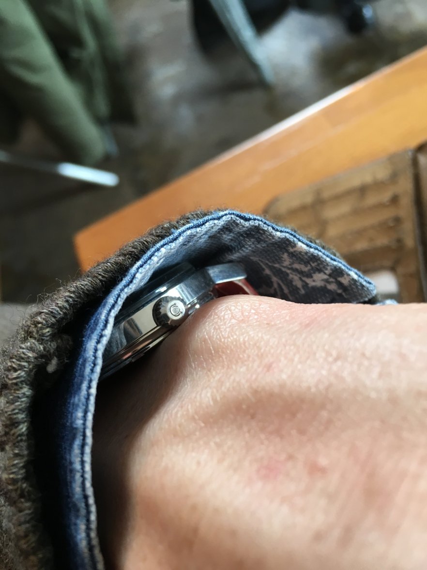

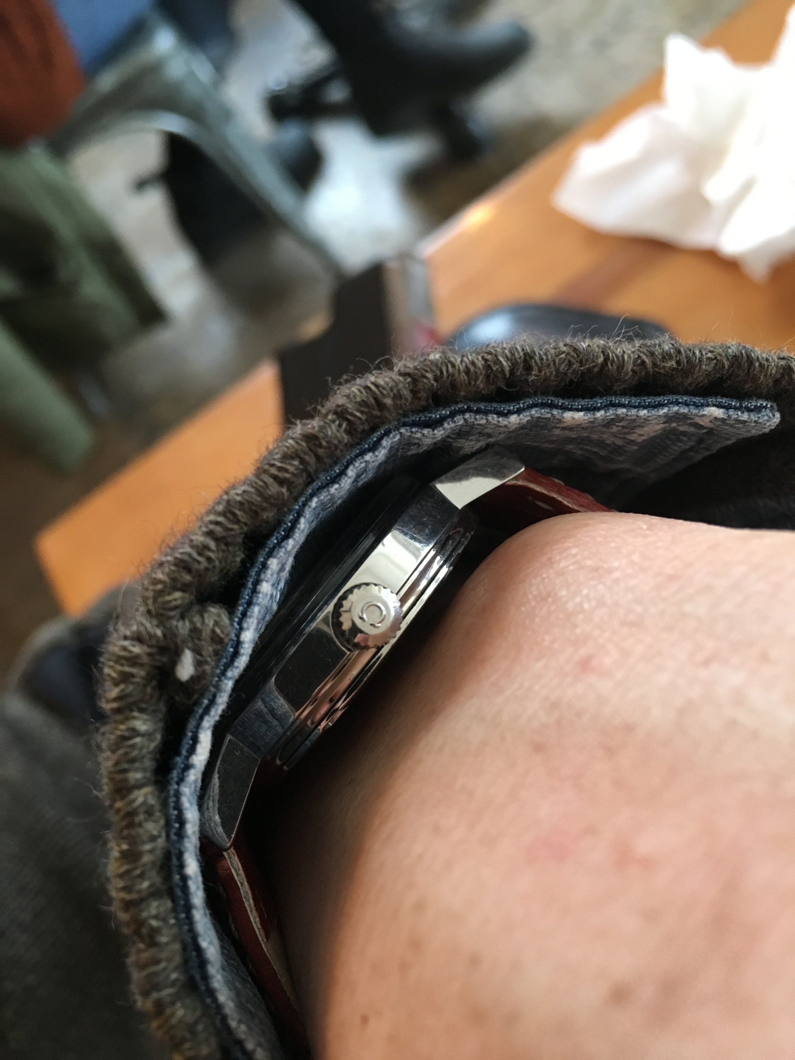

    I just discovered a neat little thing on my cal 613 Geneve.
    The crown rotates on its own throughout the day, this 1/2 turn is 1 1/2 hours apart after full wound this morning.
    I guess it's normal?

    it is conceivable that the crown might turn counter clockwise during wear, after winding is complete. This likely would happen only by the crown being very loose on the case tube, allowing it to turn from rubbing on shirt cuffs, etc. Normal running of the watch can not cause the crown to turn.

    I think I've found the problem, the crown does not rotate on its own but its light to touch anti clockwise, I must have inadvertently move it during wear.
