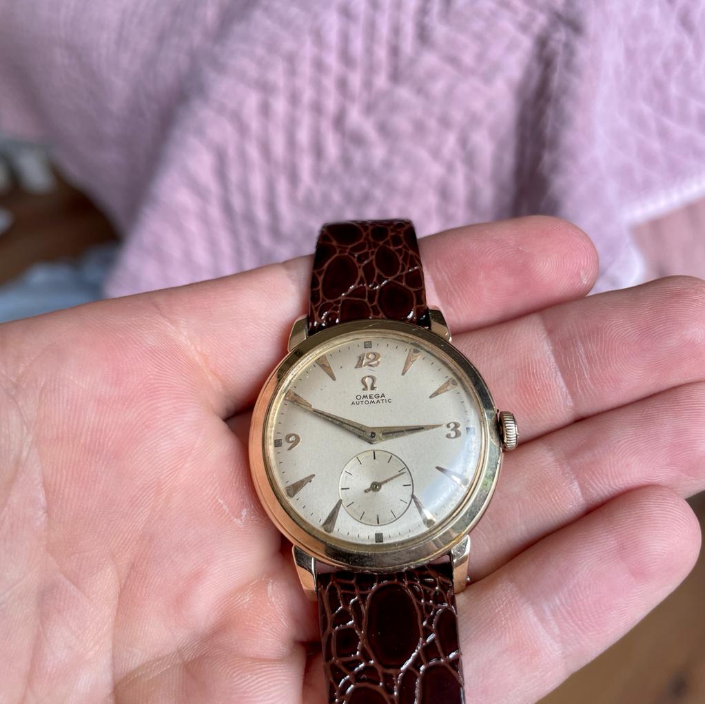

Good afternoon,
I recently purchased this gold Omega watch, and I am pleased with the way it looks.

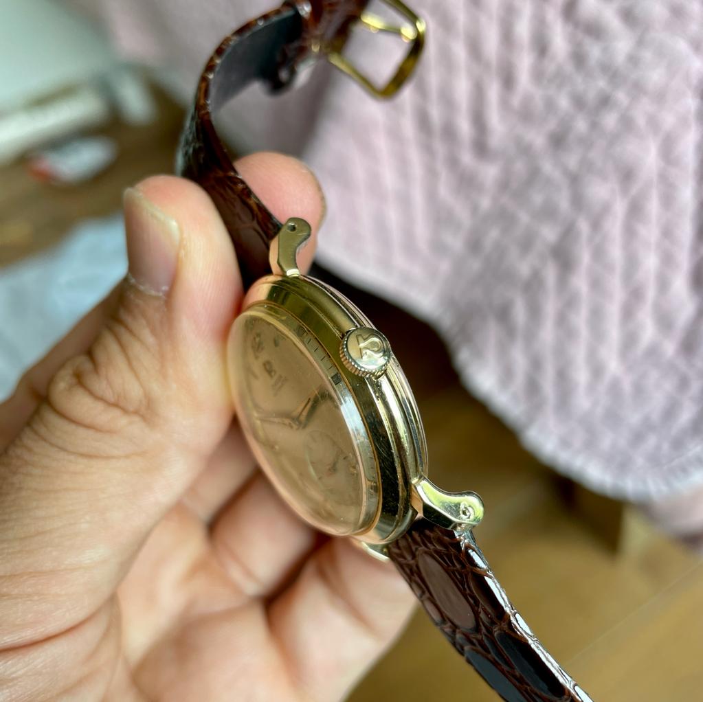

however, I cannot wind it up. When I turn the crown, the hands only adjust. Even when the crown is pushed in to the maximum. Does this mean the stem is too short? Or can there be something else? Once in a while when I turn the crown it winds, but just for one or two turns. My apologies for my english, hope I made myself clear.
Thanks in advance.

You need a service including a new mainspring.
30,289
78,178
Yes, very possible that the stem is too short.
666
1,642
The mainspring seems fine, because once in a few times it clicks in and turns the spring.
666
1,642
How/where can I find the right size stem?
30,289
78,178
You buy a stem for the movement and cut it to the correct length.
368
1,840
For start. Take it to watchmaker. There can be few things and it is better that somebody take look at it before you start to buy parts
666
1,642
Thank you. I will just search for a stem that fits on the caliber, or will ask a watchmaker to take a look.
2,346
1,475
Little trick a watchmaker showed me was. Take foil from a cig. pack. Little pieces rolled into a ball and drop down the crown tube and use stem to compact it and test fit.
Add whats needed until the crown sits out far enough
Other choice as mentioned is buy another stem.
Buy based on the caliber number
