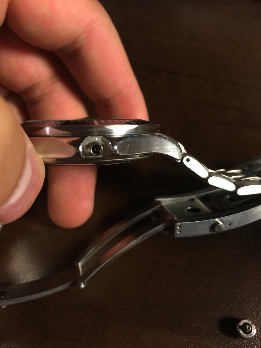

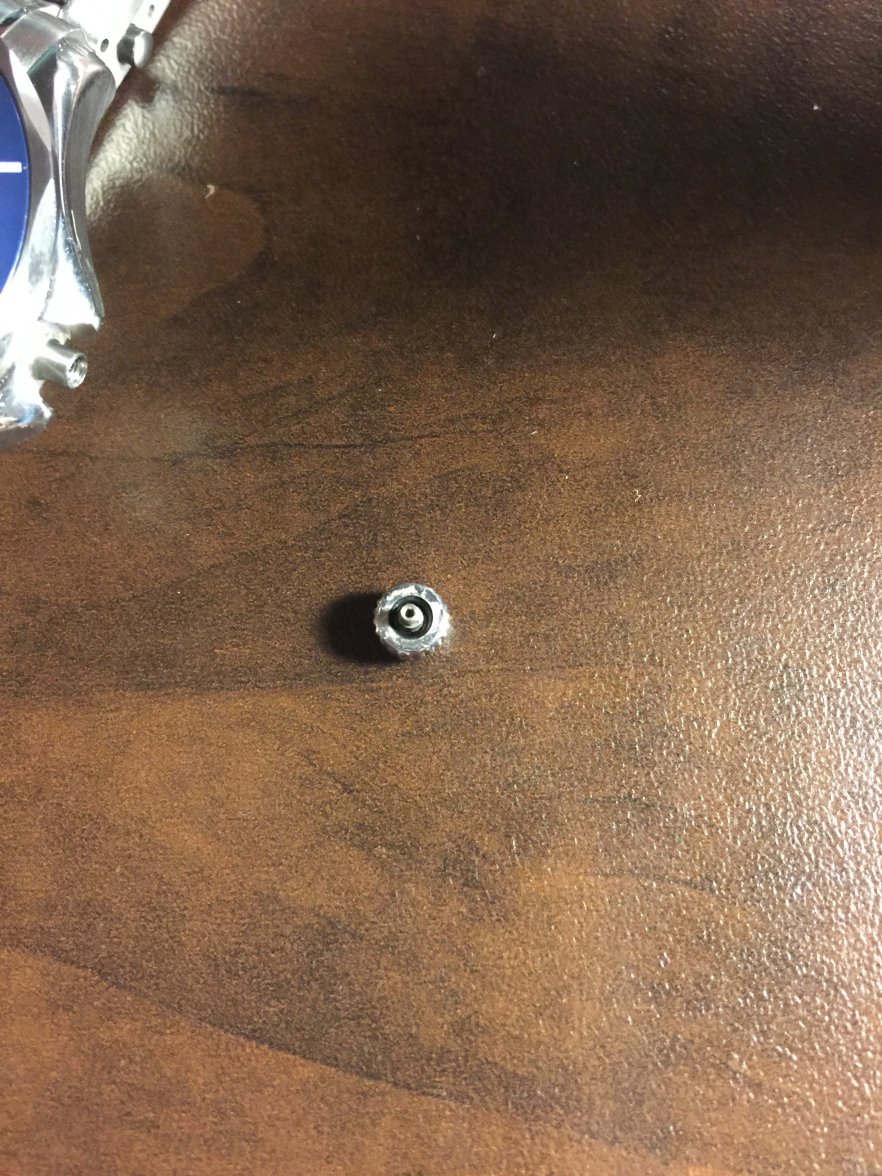

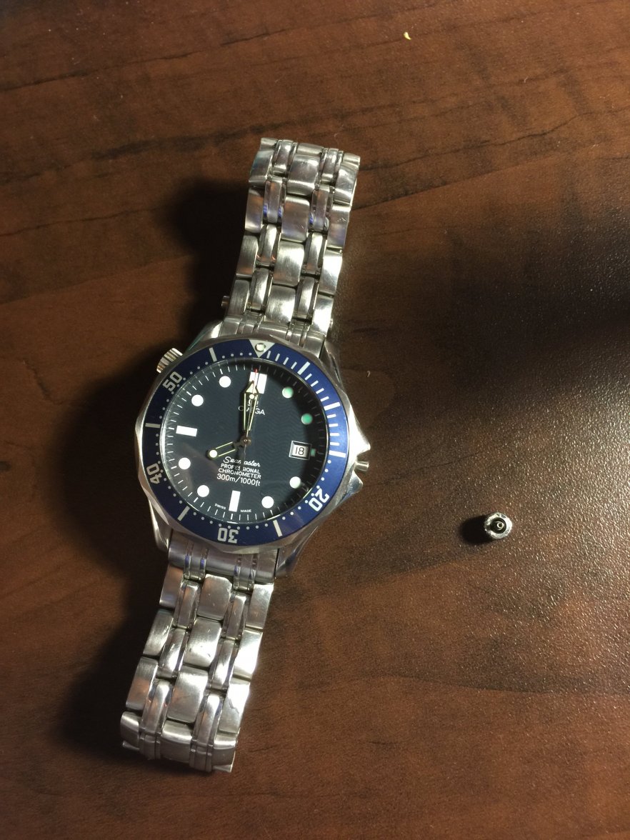

    image.jpeg image.jpeg image.jpeg So I was setting the time of my watch after about of week of not wearing it and the crown came off when i was setting the time.

    If the watch is otherwise fine, it's a simple fix for any independent watchmaker...

    Off topic, but it's pretty cool how the lume has lit up because of the shadow in the first picture! That's some powerful stuff!

    The problem shown by the OP is simply that the crown has come unscrewed from the stem thread. Many will say Loctite is needed on the stem, but it's rare that I use it (usually only for very thin quartz stems). If the cut end of the stem is prepared properly, Loctitie is not needed in most cases. This doesn't have anything to do with how the crown is pulled out from the case.
    I do understand what you are saying, but I don't think it's a concern really, or relevant to the OP's problem.
