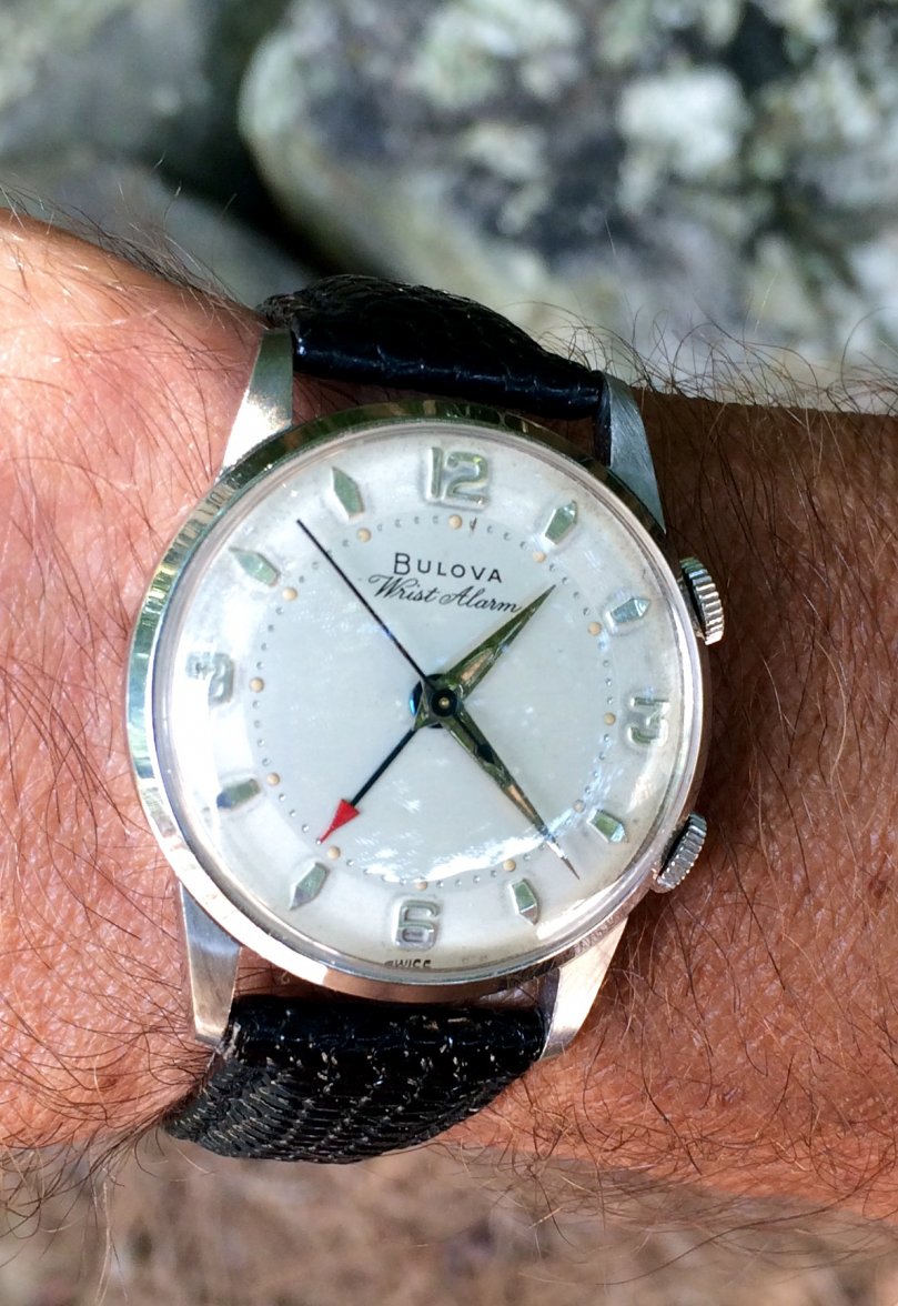

    My watch-maker broke the crown trying to close the back on my Bulova Wrist Alarm with cal. 11AERC. He has yet to find a replacement crown. Nothing on eBay so far in 6 months (other than a full watch)...
    Here's a pic of my watch before the 'accident':

    The dial on that one appears identical, but the crowns appear 'shallower'. There's also another one on eBay in nicer condition here:
    http://www.ebay.com/itm/BULOVA-Wris...l-Manual-SUPER-CLEAN-Stainless-/182117798138?Purchases made through these links may earn this site a commission from the eBay Partner Network
    I've asked the seller if he happens to have clues as to a replacement crown...

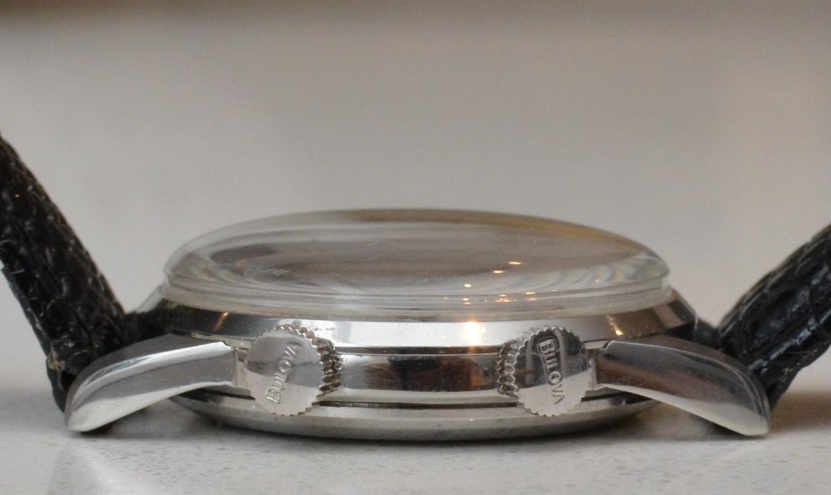

    Part Number for Alarm Crown is Bulova 706.
    Part Number for Winding Crown is Bulova 306 (Water Resist is 313S).
    Don't know if it helps but it might be useful for hunting for the right one.

  10. JimInOz Melbourne Australia Oct 20, 2016
    15,507
    32,407
