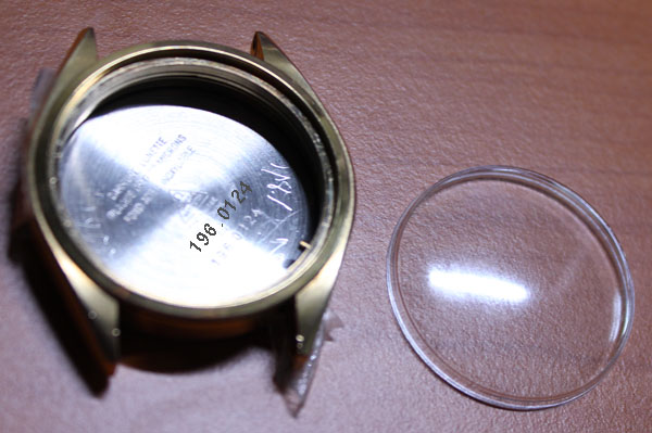

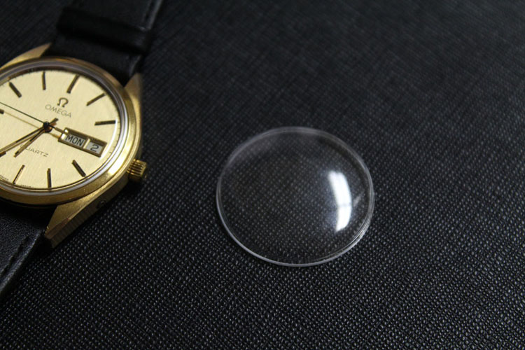

    Hi.
    The watch is omega vintage quartz watch.
    The case number is 196.0124 .
    i bought this a few days ago at ebay.
    but the glass fixed with only glue without yellow tension ring.
    There is a gap between dial and watch case or glass. and What is the nonsense glass?
    First i thought the omega vintage watch is usually like that. but i am wrong.
    There must be a yellow tension ring. and handsome glass.
    i found omega ref number compitible my watch.
    the number is PX5229 but, i couldn't buy PX5229.
    Where i can buy PX5229 with yellow tension ring?
    i didn't find it at ofrei, julesborel with my case number(196.0124 or PX5229).
    this watch is compitible with glass? (http://www.ebay.com/itm/111036553518?ssPageName=STRK:MEWAX:IT&_trksid=p3984.m1423.l2649Purchases made through these links may earn this site a commission from the eBay Partner Network)
    Thanks for reading.

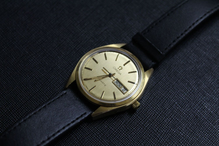

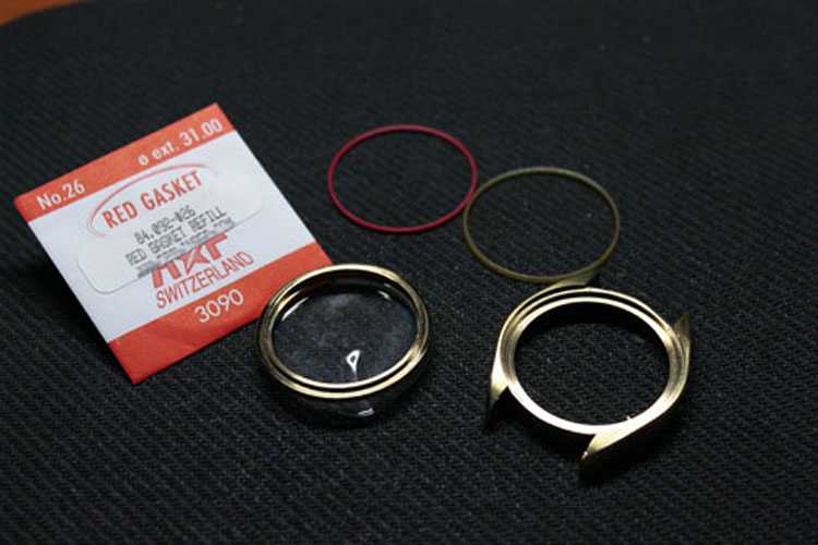

  4. minho Sep 2, 2013
    4
    Hi prostie1200
    First Thanks a lot. If you helped me, i don't overhaul my omega watch.
    This watch had a problems. The case gasket was worn. i changed case gasket.
    It took a long time to change parts.
    The glass put on the case with glue slightly. -_-;
