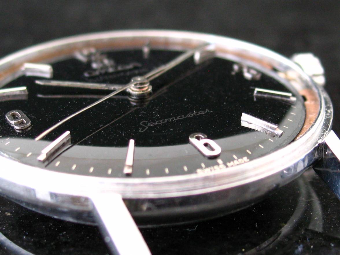

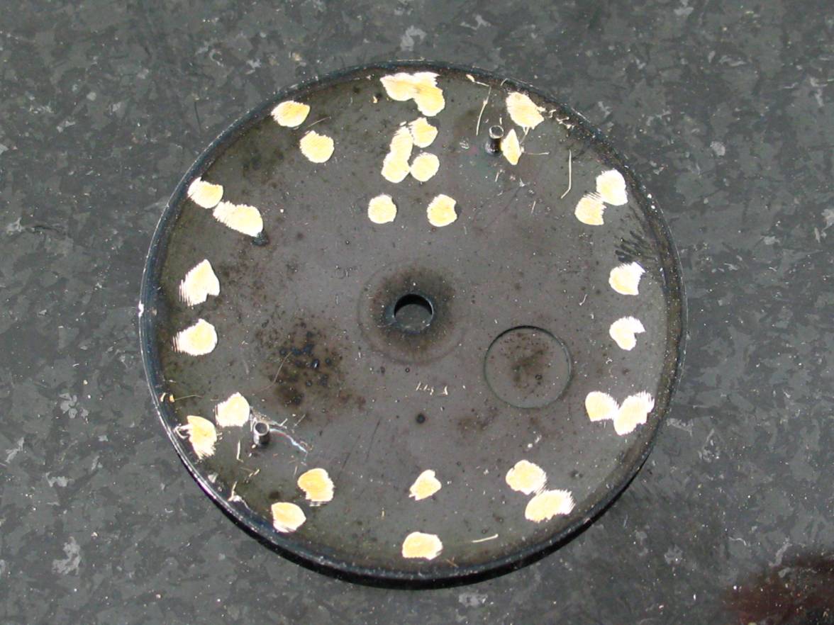

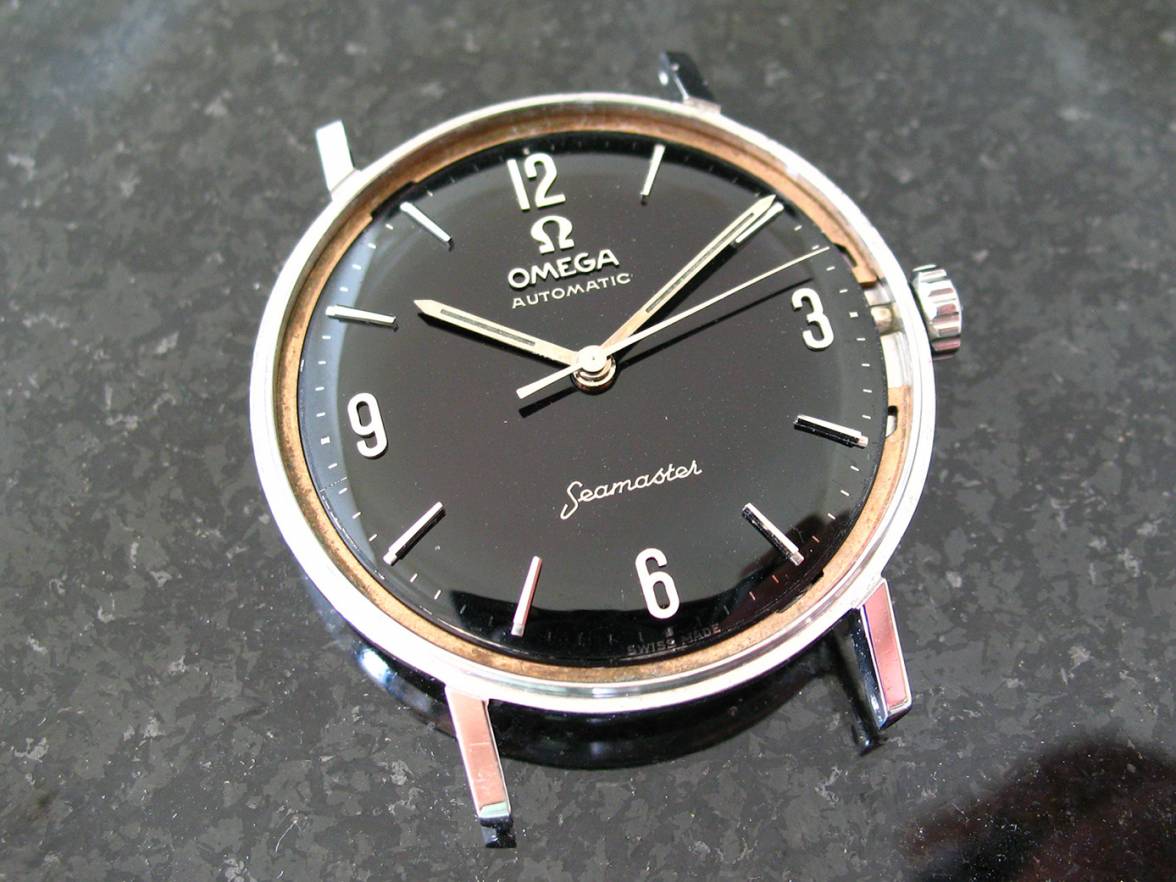

    On this type of dial the silver (or gold) was the base finish on the dial and the black was some sort of plating done over the base layer.
    The printing appears perfectly smooth and flush with the surface of the dial since the top plating is only a couple microns thick.
    Here are some shots of a 14765 Seamaster from 1961.
    IMG_4261.JPG IMG_4264.JPG IMG_4265.JPG IMG_4266.JPG IMG_4267.JPG IMG_4155.JPG

    Great explanation! Thanks.
    I think I see it on the minute hashes
    but looking at Seamaster it's hard to
    tell. I guess you need to see it in 3-D
