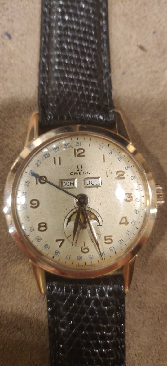

  • Because it is a Seamaster Cosmic Triple Date the chances of it being redialed are almost 100%, the thing is I don't see it. Also, I haven't found this dial variation online. The helpful but not very knowledgeable lady in the shop said it's not a redial.

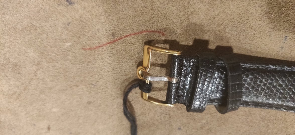

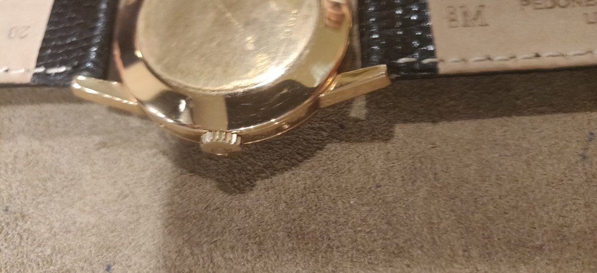

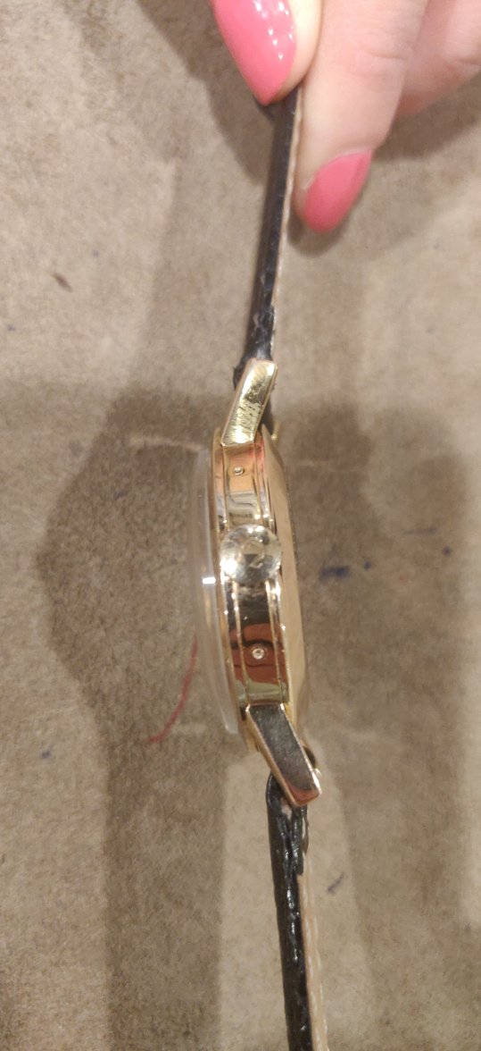

  • It looks like the crown is not original for this watch although it is an omega crown.

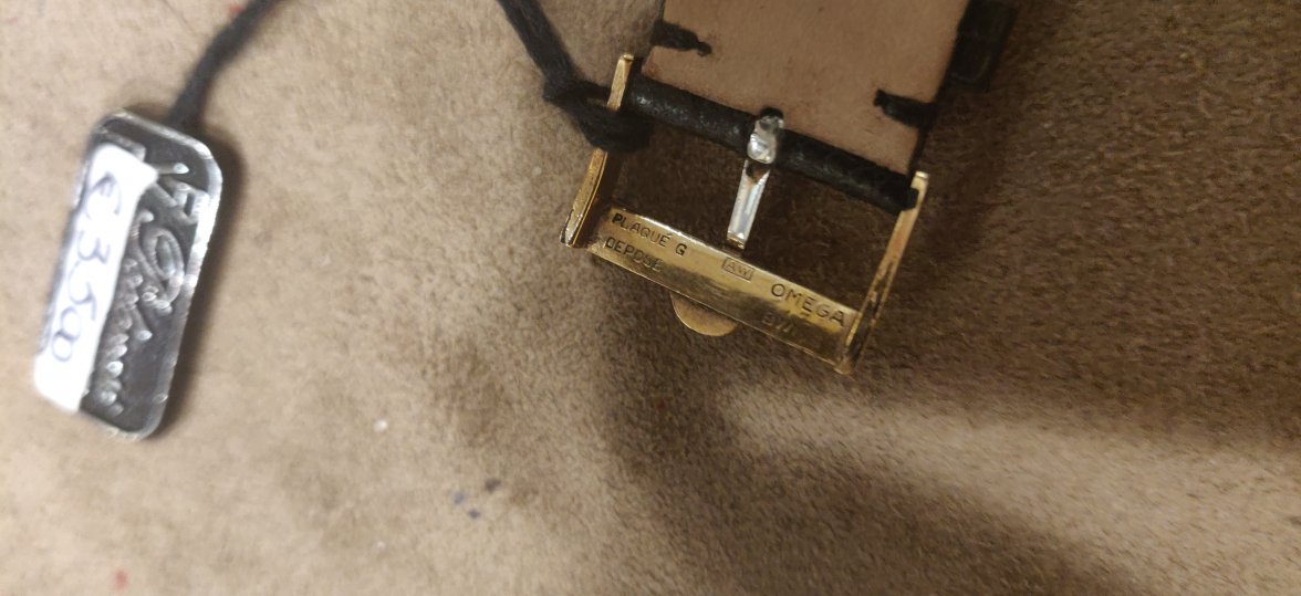

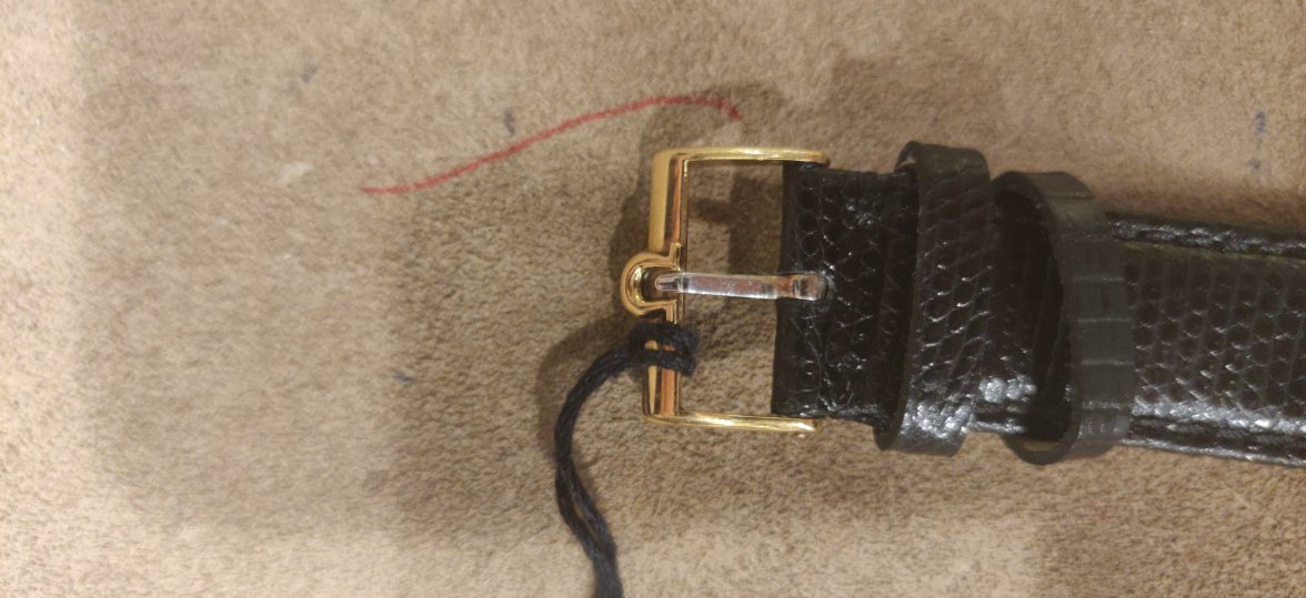

  • There is an omega buckle on the strap. Is this time correct?
  • And than the most important thing. Asking price is 3500€. Would you pay this for a cosmic triple date, let alone this watch? By coincidence they also had a 1 year old Seamaster trilogy with box and papers for 6k, says something about their pricing I think.

The dial looks good to me at first glance. Shame about the scratch, but as you mentioned, these are quite difficult to find in original condition and the overall look is very appealing. The price isn't out of bounds in general, although the case seems like it might be a bit soft (hard to tell from the photos).

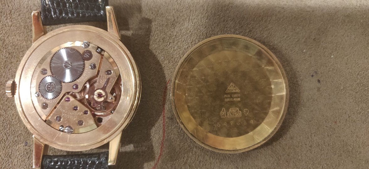

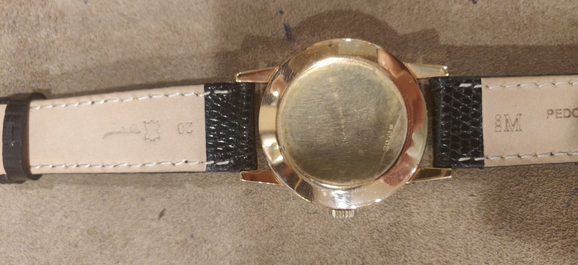

Hello,original dial,but missing the reference on the case back...strange..

FAB SWISS suggests to me that it might be a locally-cased watch.
300
1,255
Yes,I agree,National case...
6
4

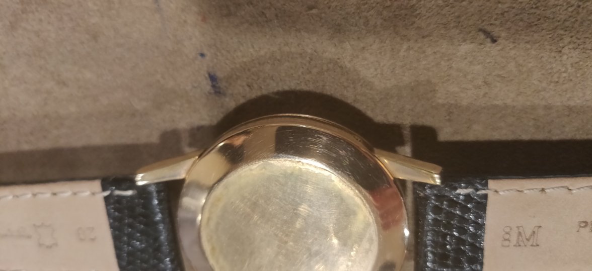

Might that be the reason the reference number is on the case back is missing? And what does locally cased watch mean? The mechanics I side are Swiss and the case is Italian?
24,836
55,256
Historically, some Omega watches were shipped un-cased to various countries where they were assembled into locally manufactured cases. This may have been in order to avoid certain import duties. Often, those watches did not have standard Omega reference numbers. Dennison-cased Omegas in the UK are a prominent example. I know nothing about Italian-cased Omega watches, that is new to me, but I'm sure there are experts on the forum who can comment.

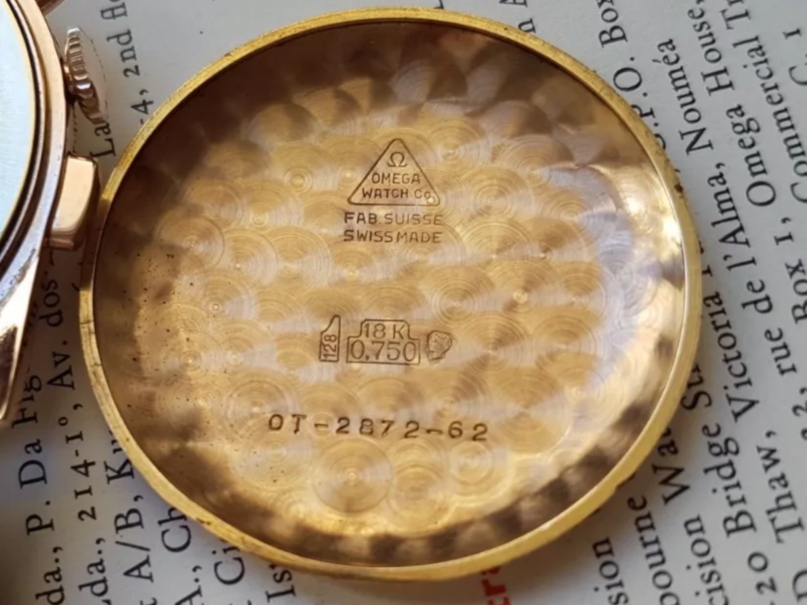

Definitely an Italian cased piece here’s the case back from my 320 has An Italian gold hallmark and papers for being sold in Rome
No, it is not an Italian case - it is Swiss made
What are you telling here? I can´t see any Italian gold mark... the hallmark is the correct Swiss hallmark for 18K gold.

There is quite some strange speculation in this thread about the origin of the case.
The case is definitely a swiss made case.
There are Swiss gold hallmarks (head + 750) and the hallmark with hammer head for the casemaker.
The number 132 in the hammer head indicates the casemaker Eric Monnier from La Chaux-de-Fonds (Switzerland), registered 21.07.1934
The lack of a reference number is quite common on (gold) watches of this era and is absolutely no reason for concern nor a proof for a non Swiss case production.
However the only 6 digit case serial# is the uncommon feature on this watch but is sometimes seen on original Swiss cased watches from the 50ies (i.e. Constellations, Seamasters,..).
This case is also Swiss made by the casemaker Jung & Cie La Chaux-de-Fonds, registered 21.07.1934, indicated by the number 128 in the hammer head hallmark for the casemaker.
And it has all correct Swiss gold hallmarks.

What do you think about the dial Erich? My first impression is good for a jumbo variant, but there's something about the Omega text and printed logo, they seem very small to me
3,653
7,770
IMHO it is original but I am not an expert on the cosmic dials - my comments were solely about the case.
@MSNWatch is one of the experts on these dials - hope he will chime in.

Thanks for the new info I stand corrected nice to know I have a complete Swiss piece

Agree with @mac_omega about the case and to me the dial looks correct for a "jumbo" cosmic TDMP.
