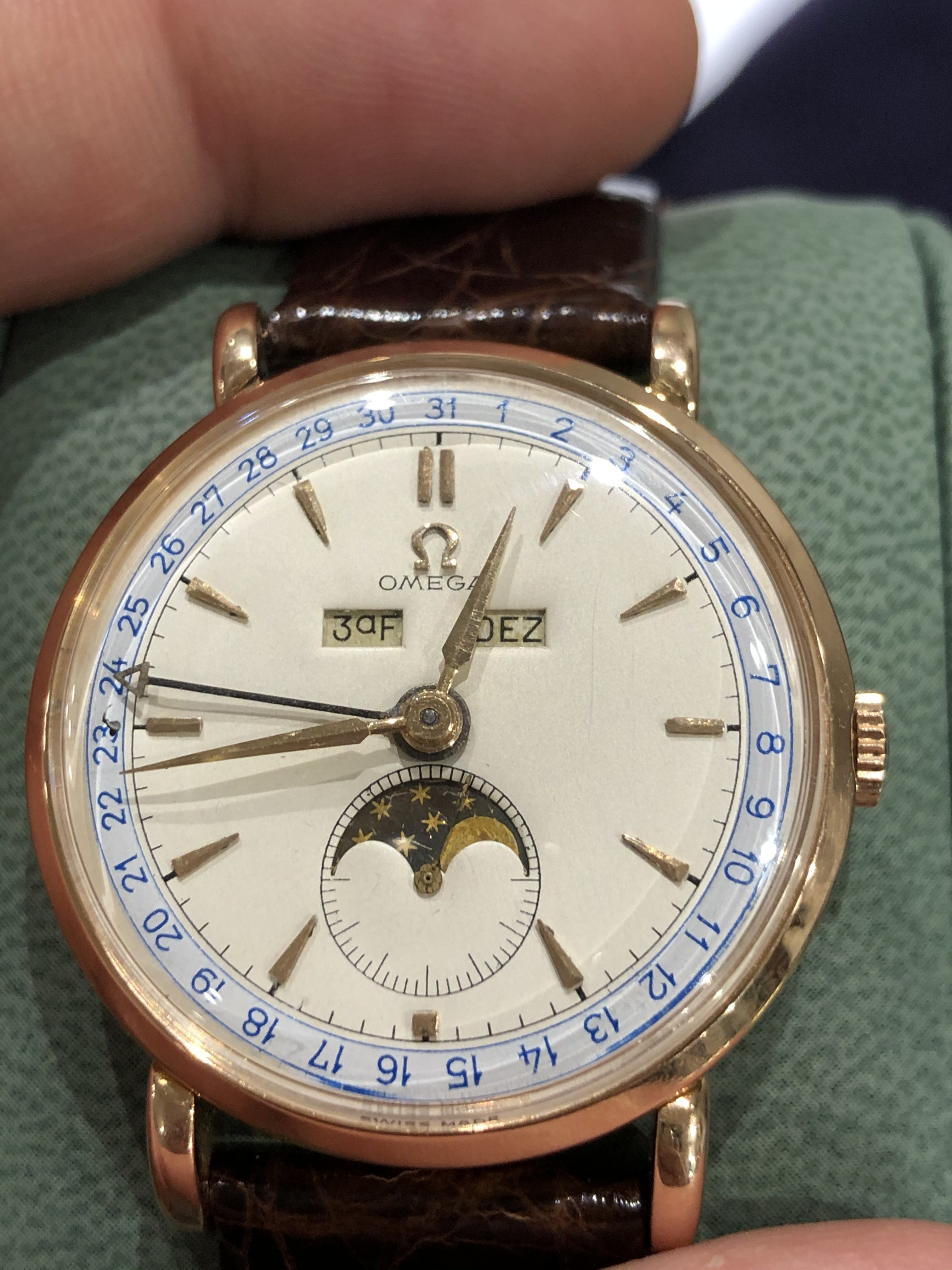

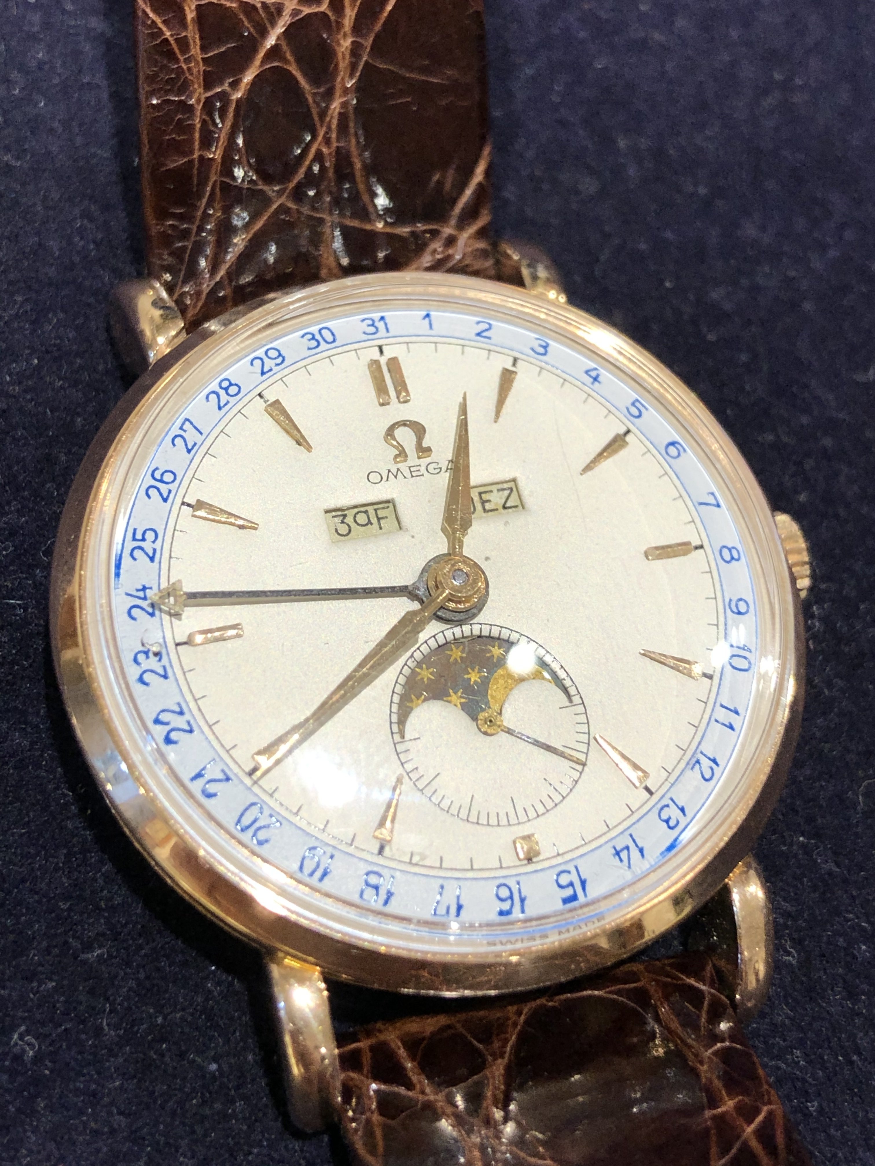

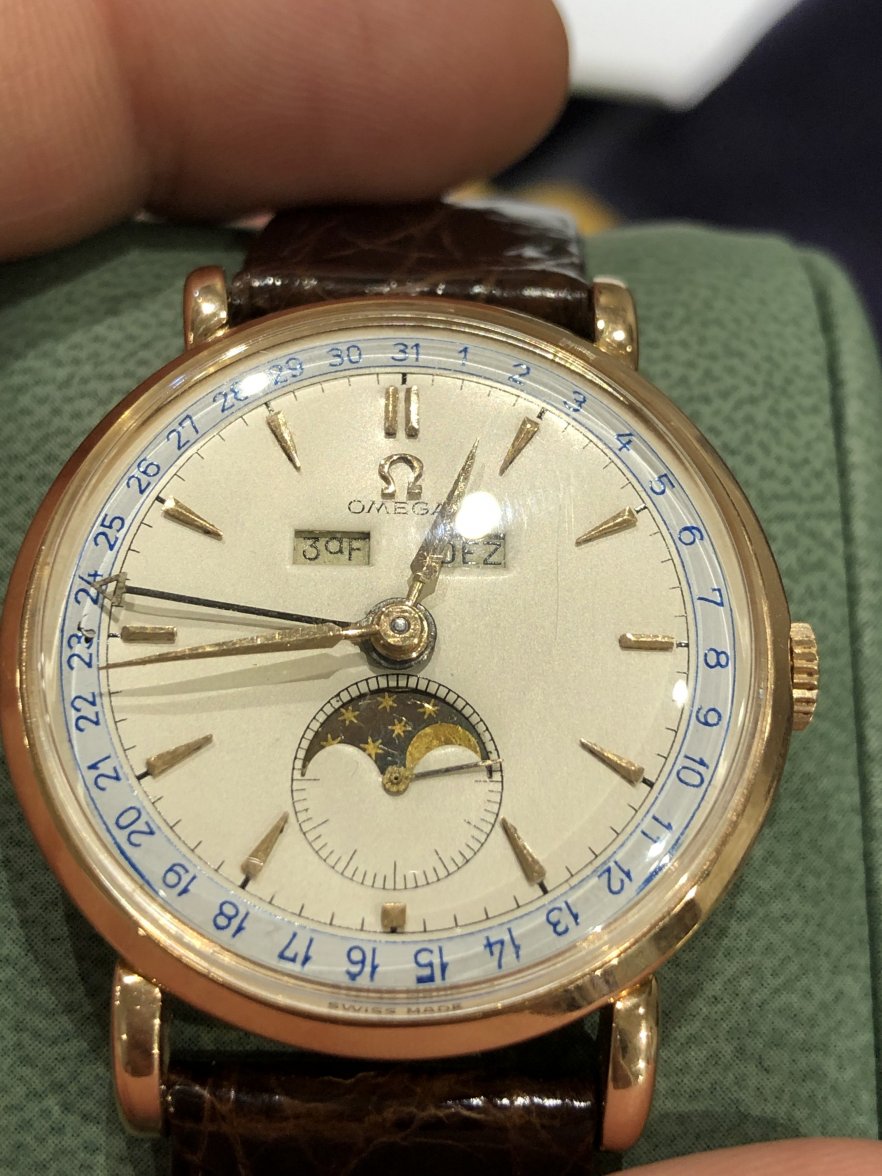

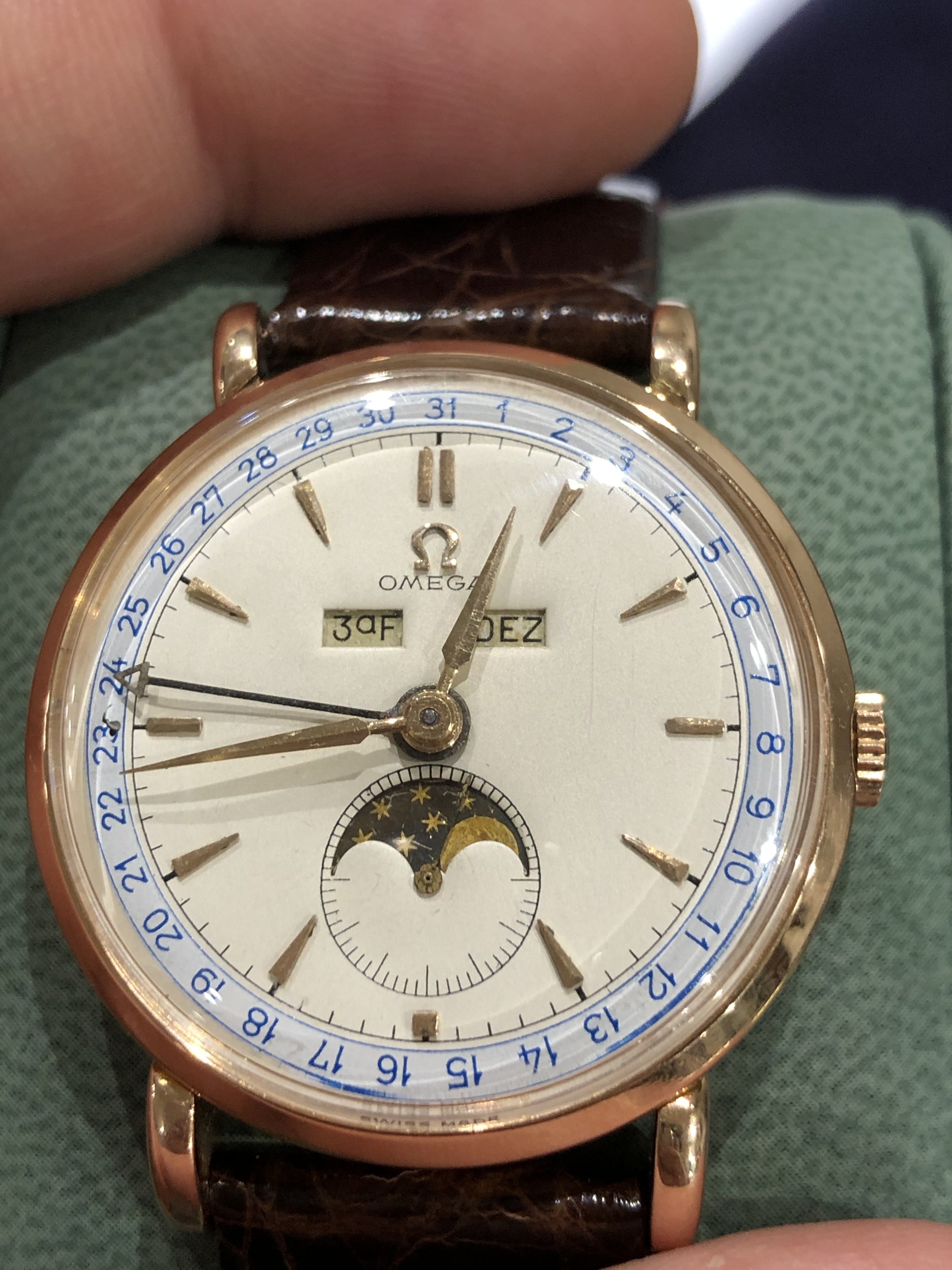

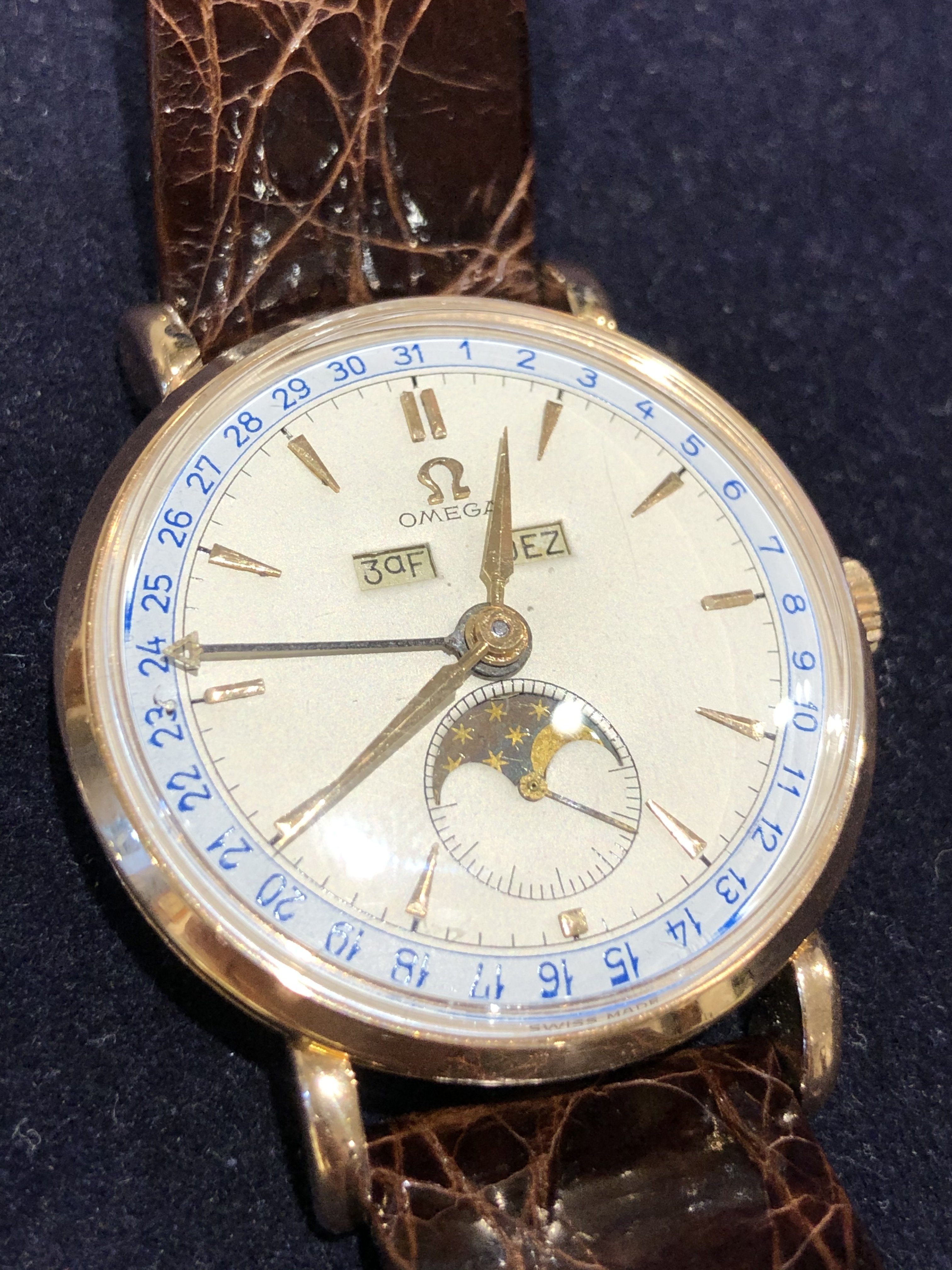

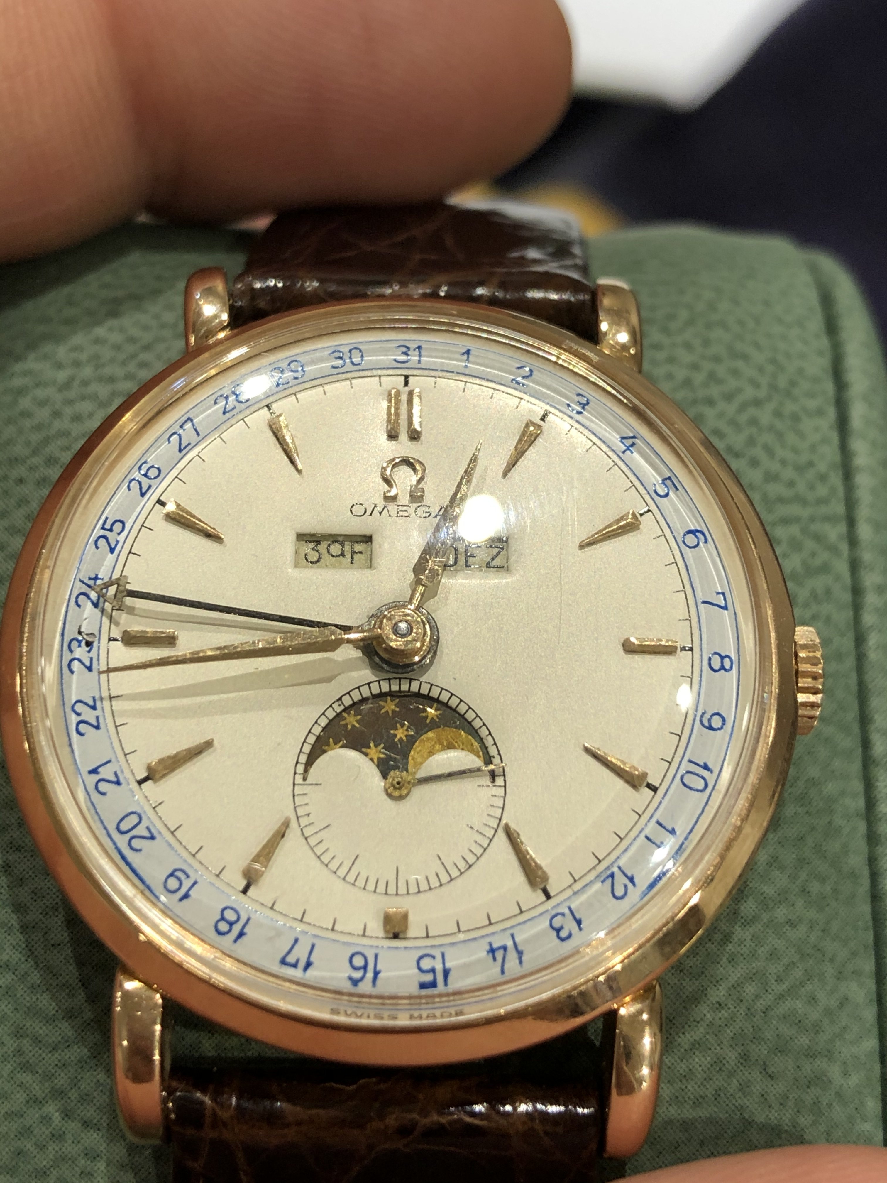

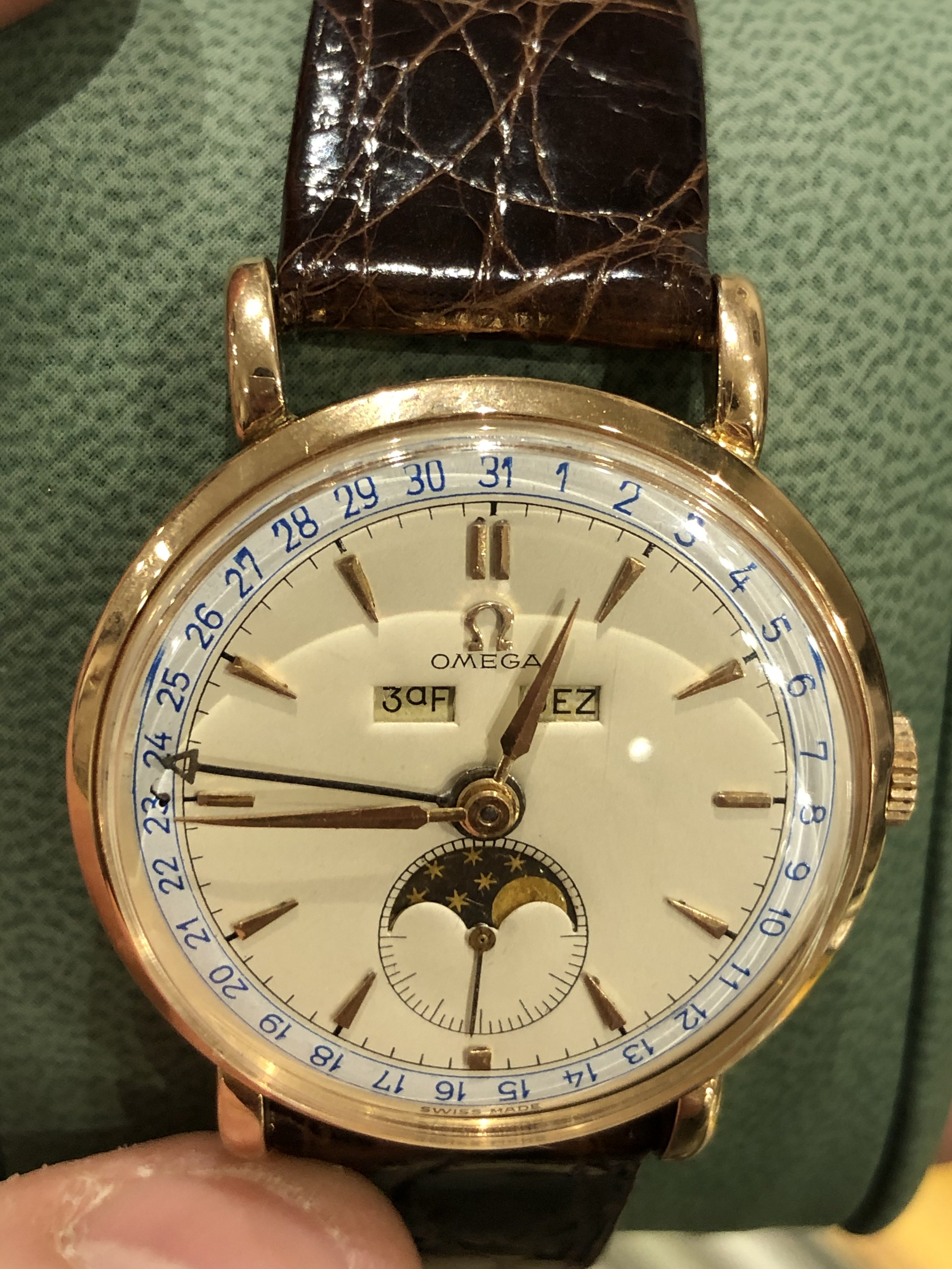

I have pictures! Went in and had a good chat with them. They did not know the REF (bit of a worrying sign, to me, from a watch dealer, but they claimed the expert is away).
The dial is in excellent shape, minus a chip on the “23”. Not sure if - given it’s a different dial to others - this will help with figuring out the reference.

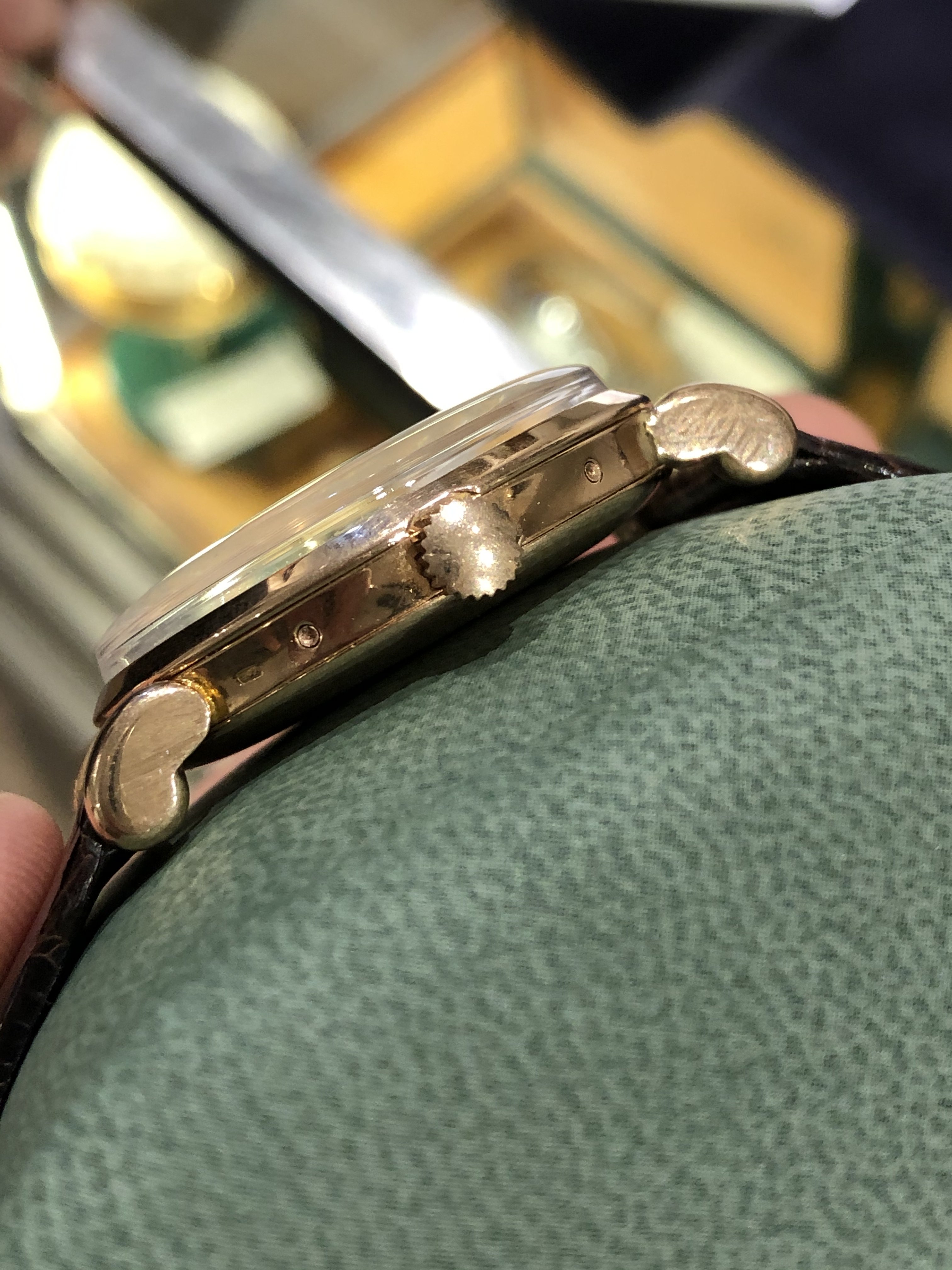

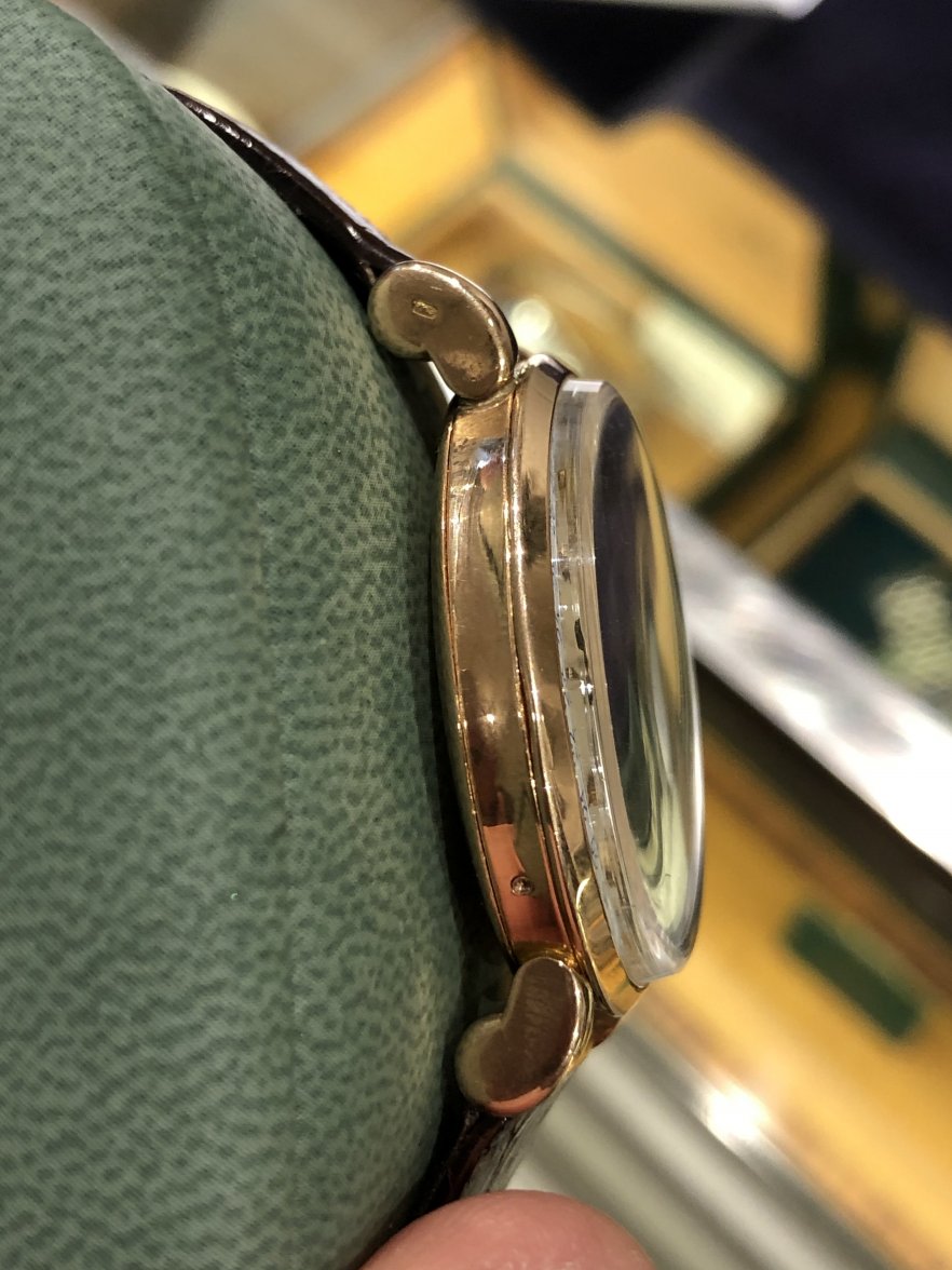

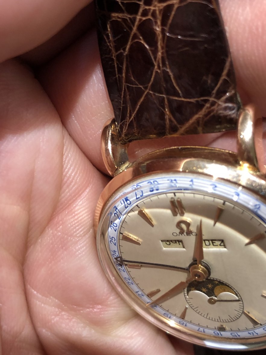

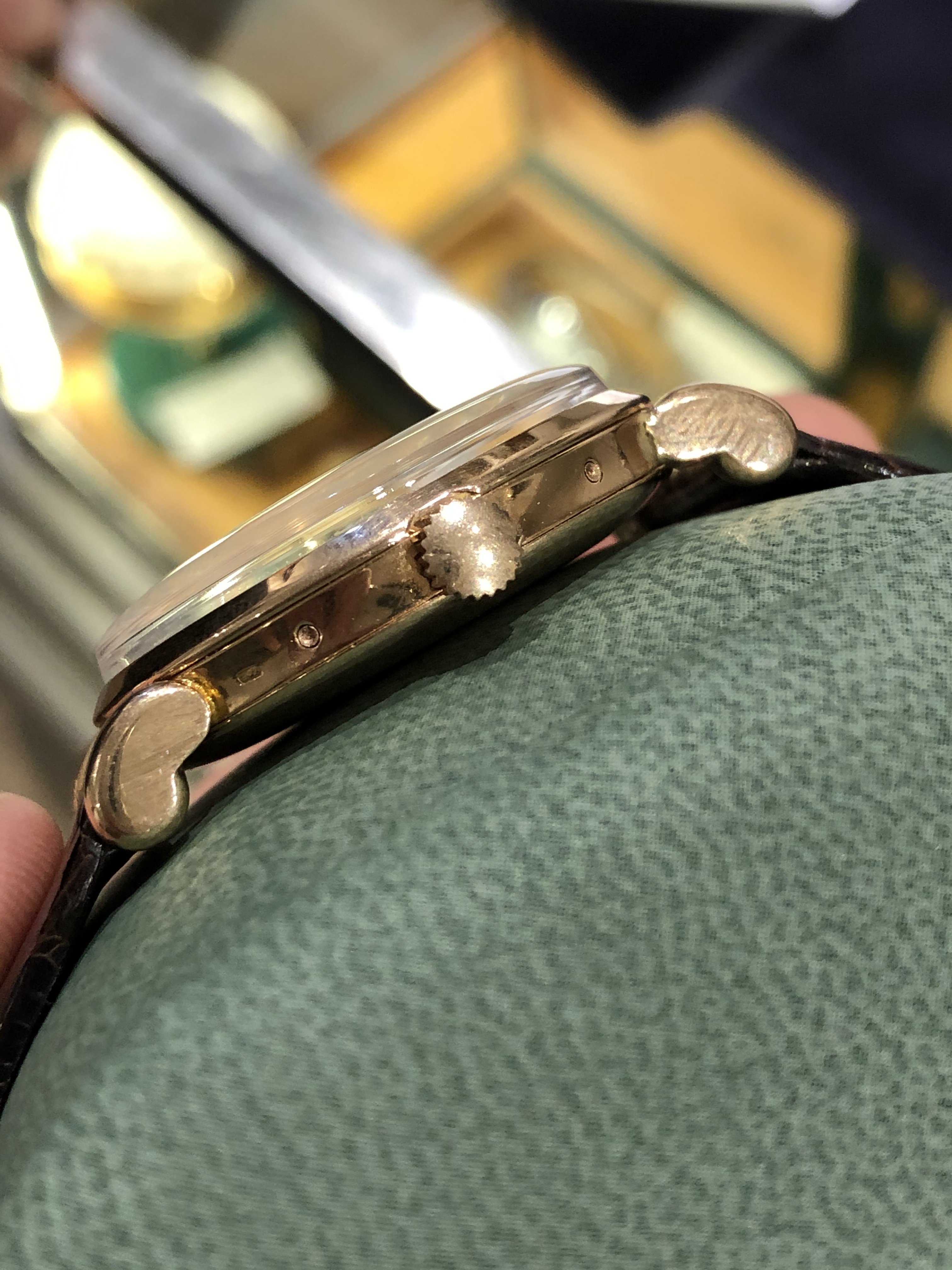

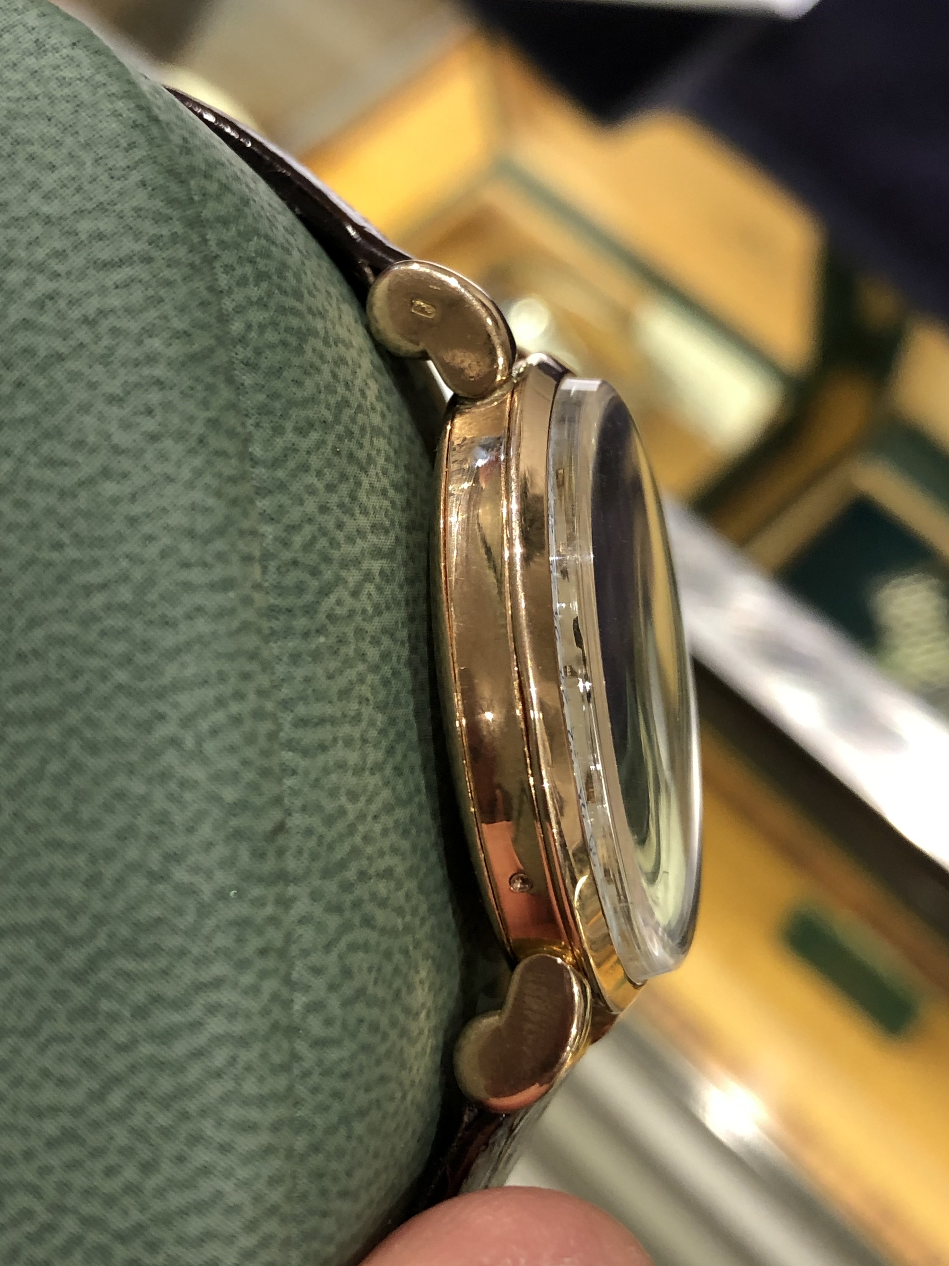

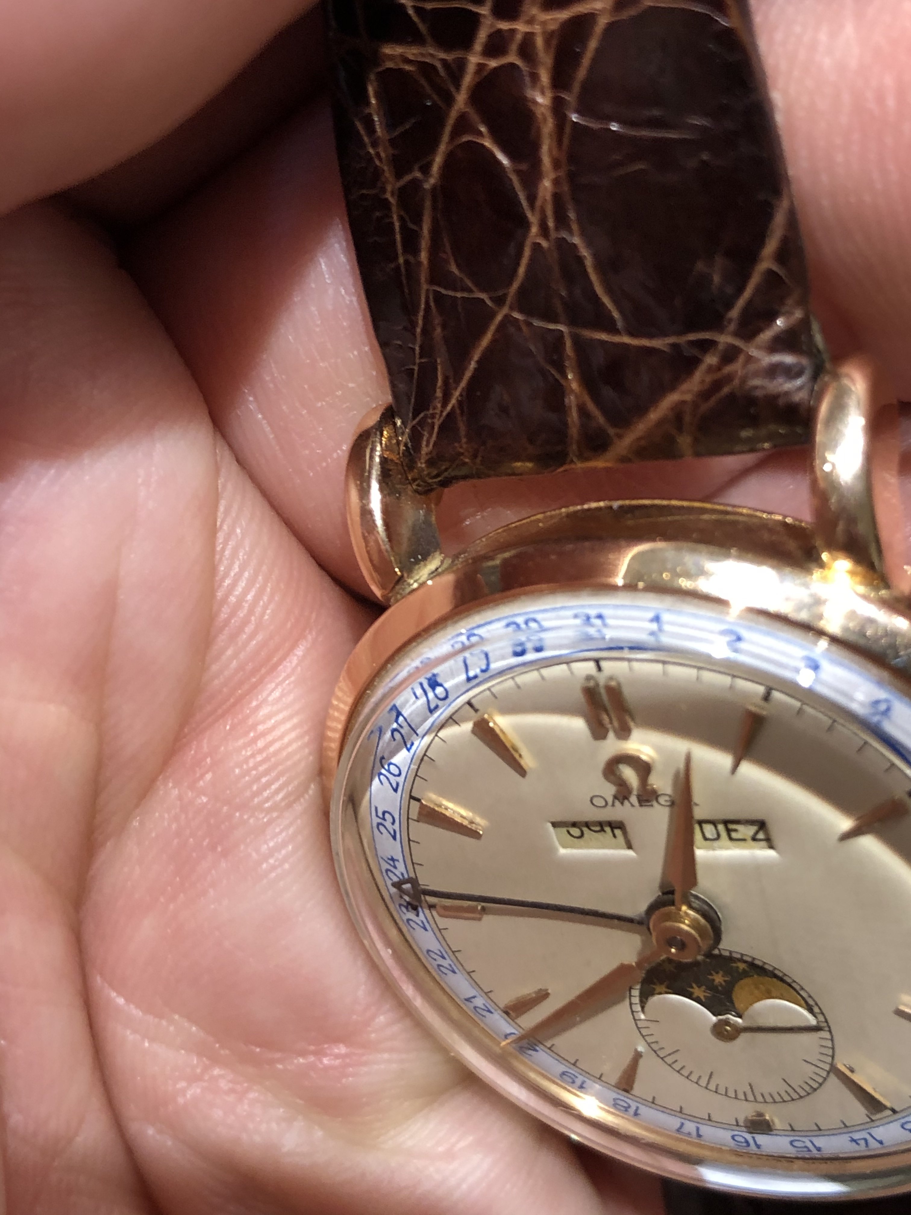

Bigger concern is I noticed that the top lugs are narrower-set, and in fact the left-hand top lug is skewed. Clearly was reattached at some point, and looks like there’s a stress crack on the inside seam!
It’s a beautiful watch, but I’m concerned by the lugs. I even forced them to bring the calipers out so I could prove it! Good 0.5mm difference at the widest point and 1.1 at the narrowest (the roots of the lugs).
Any thoughts? Thanks Cristos for replying so fast! I have put the purchase on hold while they figure out what to do about the lug, they won’t reopen til the second so I’ve got plenty of time to figure it out.
Merry Christmas all!
206
164

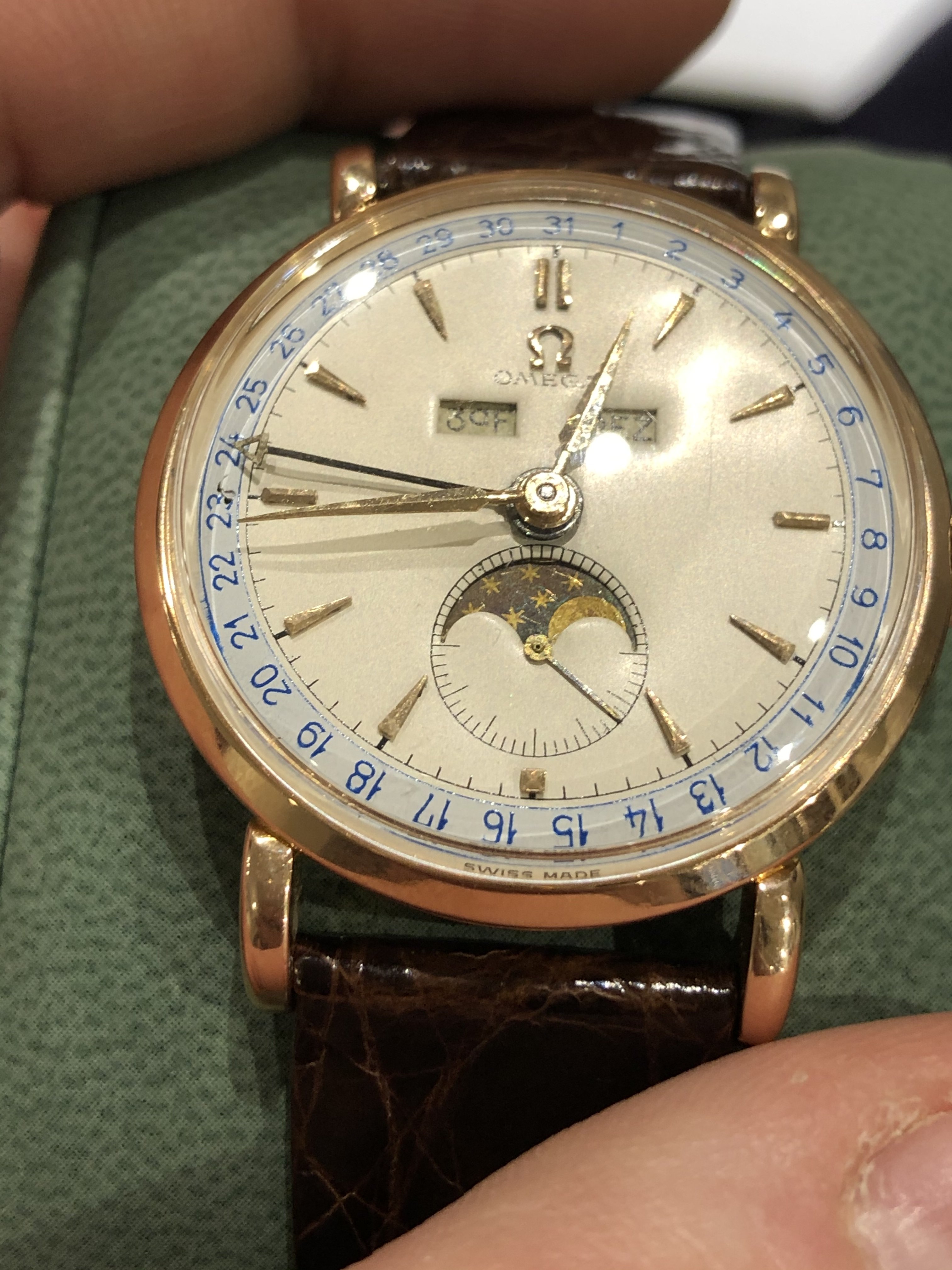

Comparing the lugs at 5 o'clock and 1 o'clock I don't like the differcence.
The one at 1 o'clock looks as if it has been resoldered.
And the one at 11 o'clock has a "funny" crack
I also have a feeling that the crown isn't original.
And do you really want the weekdays in that language, whatever it is? (month looks like German but days ???)
24,836
55,255

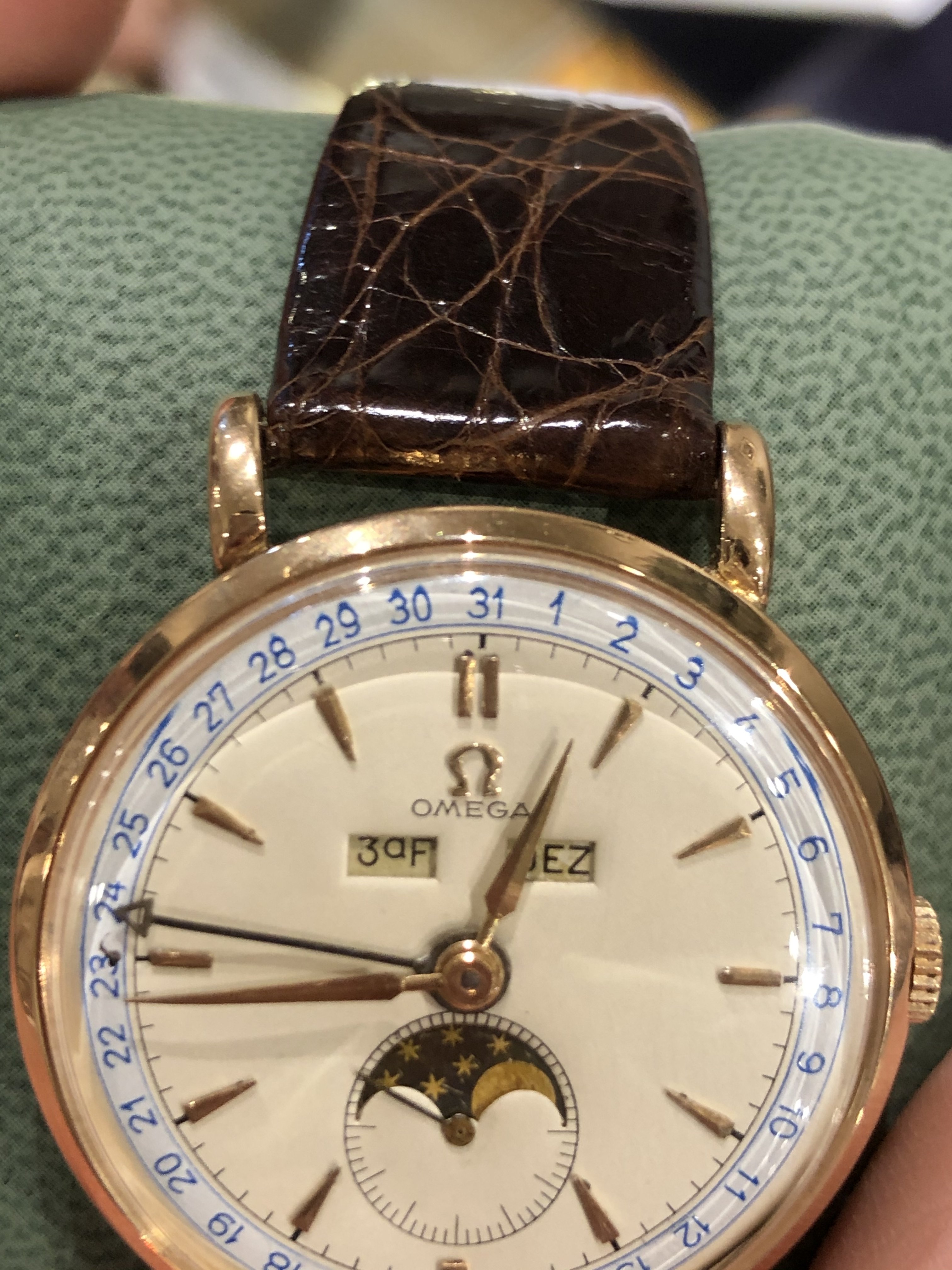

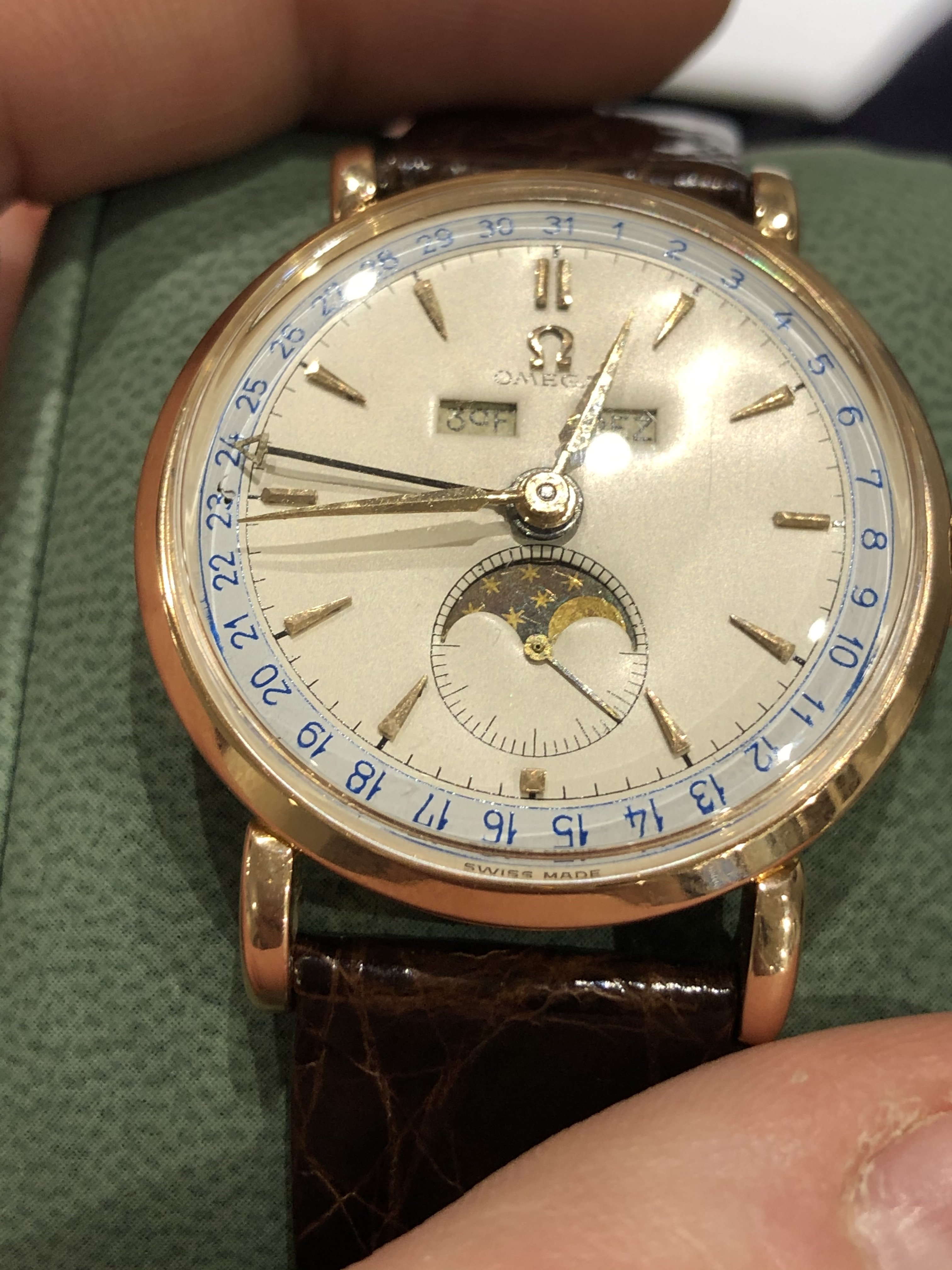

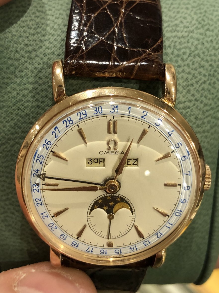

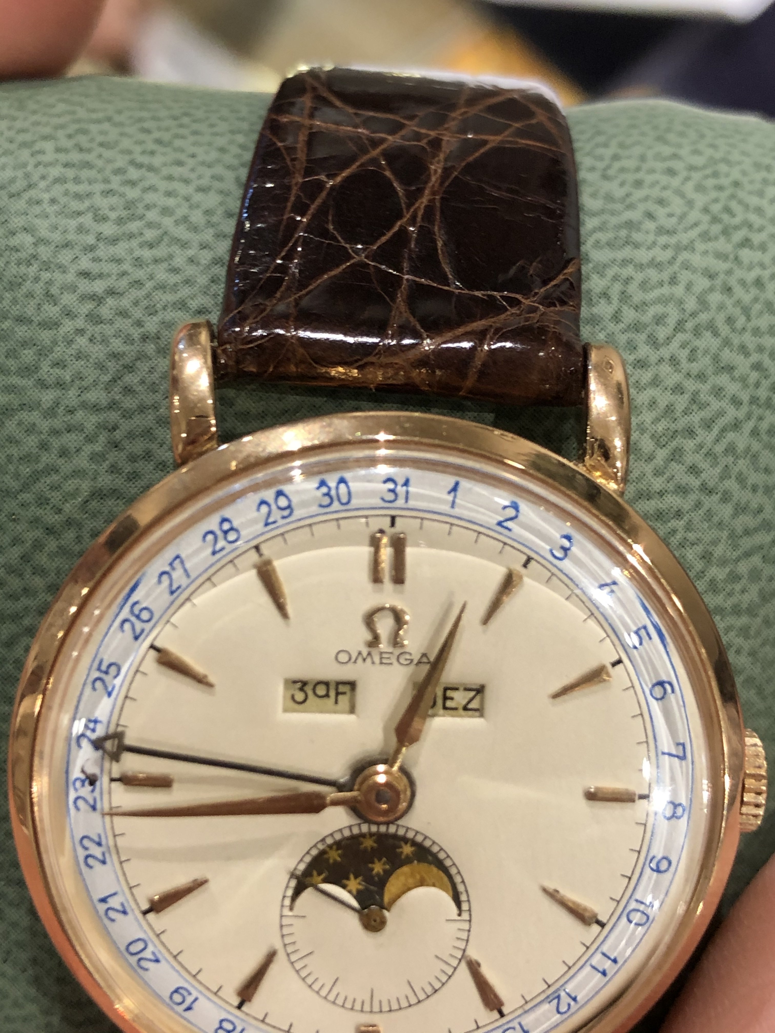

Look at the alignment of the painted hour markers and the applied markers. Some of them are badly offset. Some are touching (7 and 8 o'clock) while others have a big gap between the end of the painted marker and the applied marker (1 and 2 o'clock). You don't need to be an expert about printing subtleties (e.g. flat "A") to notice these issues, just observe alignment and symmetry.
I suppose someone may follow up by saying that dials weren't always printed perfectly, in which case I will add that I don't want to pay 7,000 GBP for an uneven, poorly painted dial, original or not. It would bother me every time I looked at it.

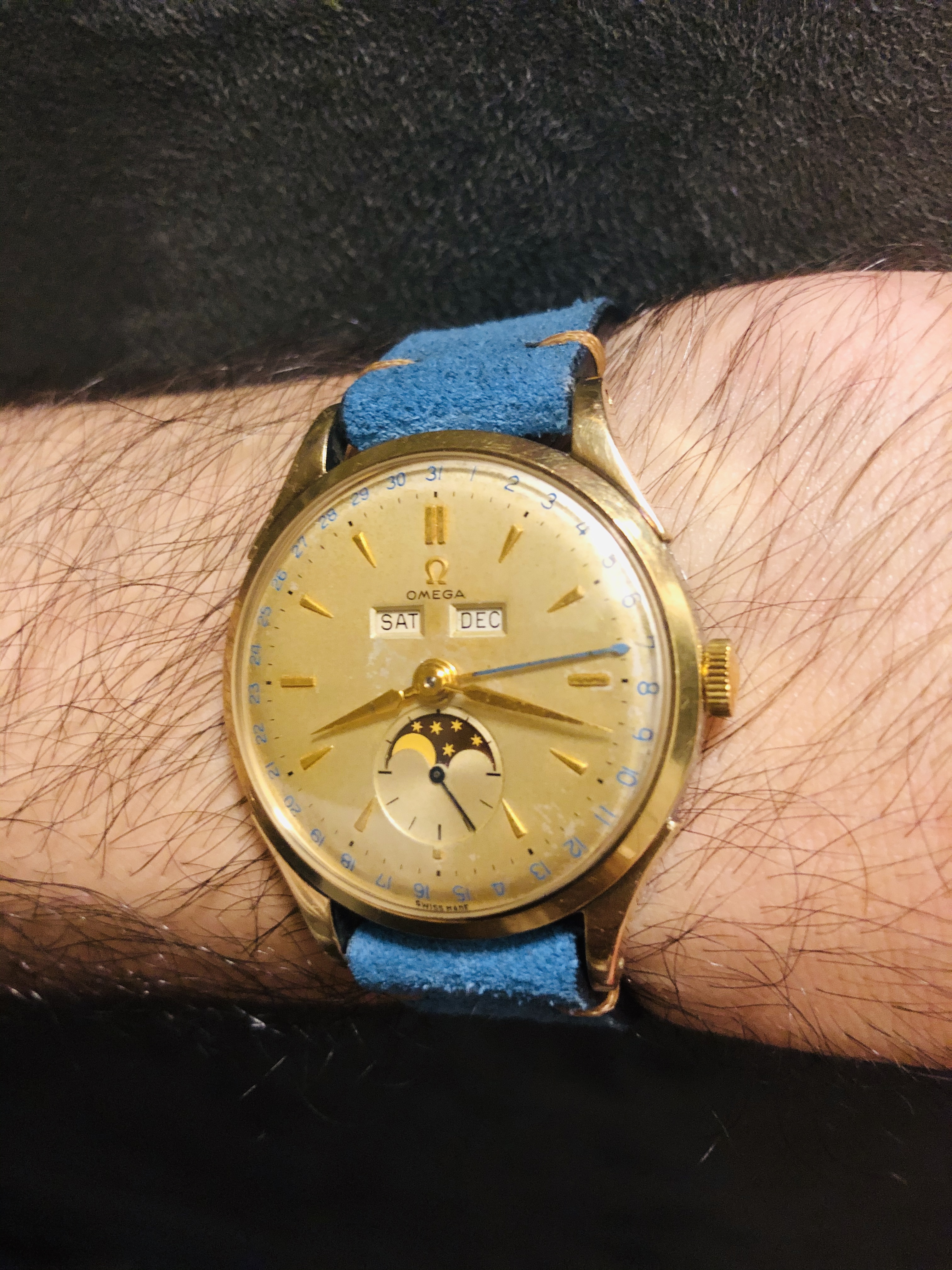

yes it's quite common for these old models to have slightly misaligned printing in relation to the applied markers. seen it quite a bit. I guess it's a matter of how much the flaws bother one. I learned long ago not to constantly loupe old pieces as the more one does it the more one notices the nuances 😀

Same as Dan, I also noticed that the minute hashes aren't symmetrical to the hour markers all the way around. Nor is it only in one place (potentially happens if one of the markers is misaligned) but here it looks like the print was shifted up and to the right... so all of the markers are touching on the left/bottom half and are not connected on the top/right. That coupled with a broken lug... that seems to be a problematic watch.
Again, as I am not familiar with the reference, I dont know its cost, but from others, it appears that 7000 GBP is a lot... add the redial and the lug... and it appears to be way over priced.

I said no such thing. I was referring to the second watch posted as that also has obvious slight misalignment of print in relation to applied markers. some old watches have slight nuances to their dials. it is what it is.

I think the redialer had good intentions but overdid it a bit with the serif font of "Omega"

The day of the week was puzzling to me. My only thought was maybe the watch made a distinction for 3rd Friday of December in Portuguese possibly? I don't own any triple calendars so I'm not sure if that's possible.

The blue 1's are off compared to the two examples shown. The examples have the "l" shaped ones and your dial has ones like this "1". There is also slight variations in the ones shape. I'm not an expert on dial printing issues, but another thing to consider.
I see... I read your statement originally in reference to the watch OP had posted. However, I do agree with you that watches will have small imperfections, especially ones that have been around a few decades and begin to slowly degrade.
But in this case, it looks like a redial and not degradation of a correct watch. Both effect value, but in this case I think a redial may have a more of an effect on the price than the degradation that may have happened. Unless the dial would have been totally destroyed and ugly looking.
You’re right about the “3rd” and Portuguese, but it is the 3rd day of the week, otherwise called “Tuesday” in English.
To continue the piling on, the date pointer hand is incorrect on the OP’s watch.
For £7,000, I would expect something much better.

Massively helpful replies from all of you! I was so focused on the lugs that I didn’t notice the applied vs painted differences - and to split the differences in opinions, I’d guess that on a vintage watch one might always expect some irregularities but the consistency of the irregularity in this case suggests a redo, especially when combined with other details - gatorcpa, glad you pointed out the date pointer, I had wondered whether it should be the blue foliate as opposed to a black arrow... The “I” vs “1” is also a very big spot, and altogether I’m ready to be convinced that the watch is re-dialed.
I’m also in agreement that the 1 and 5 lugs are in the wrong positions relative to one another, let alone the 11 - the calipers and some judicious work with a phone-app-spirit-level suggested that.
All in all, a beautiful watch but not likely an original one, and massively overpriced even if it were perfect is I think the conclusion here! I’m normally a classic car guy so this is a first watch forum for me, but always heart warming to see such a level of knowledge and passion, as in the car forums.
To echo those above, merry Christmas to all, and to all a good night - I shall be keeping an eye out for a good Cosmic Moonphase Triple Date from now on, as they’re undeniably gorgeous, but I think this one needs to learn some humility...

Ps. In Portuguese, and Brazilian Portuguese, as this watch is apparently set for, those who pointed out that Tuesday is the third day are indeed correct - the days run 2a (Monday) to 6a (Friday)f, then SAB and DOM.
