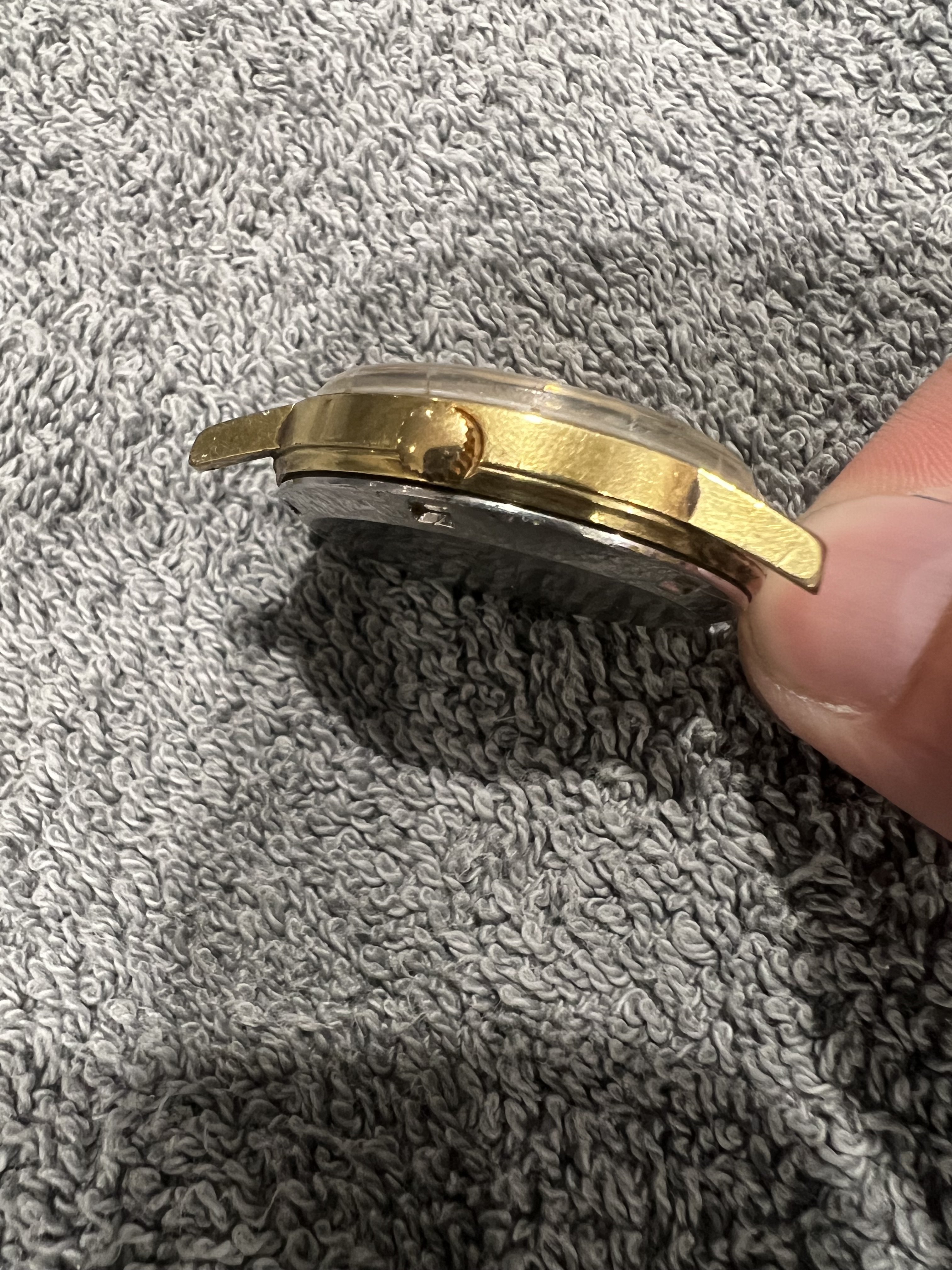

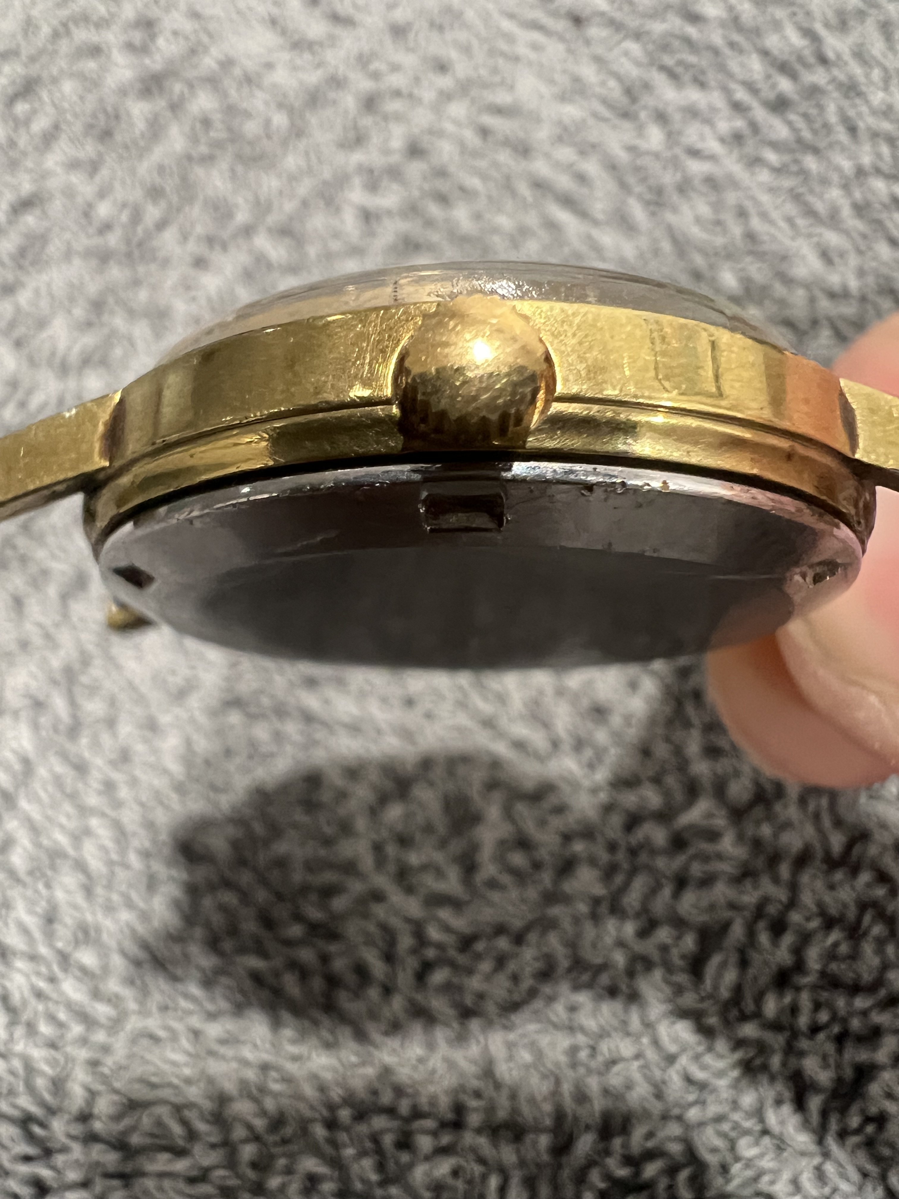

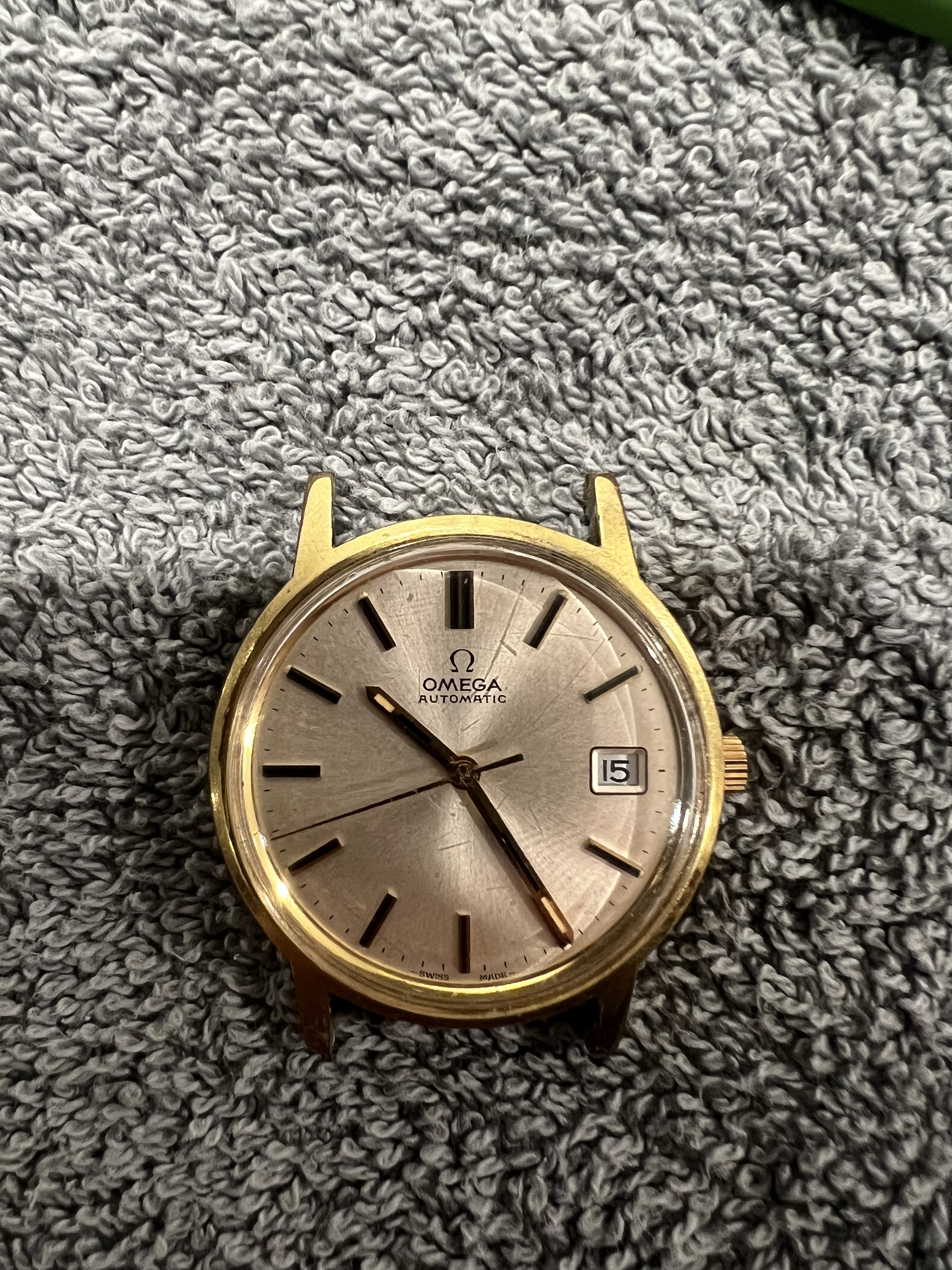

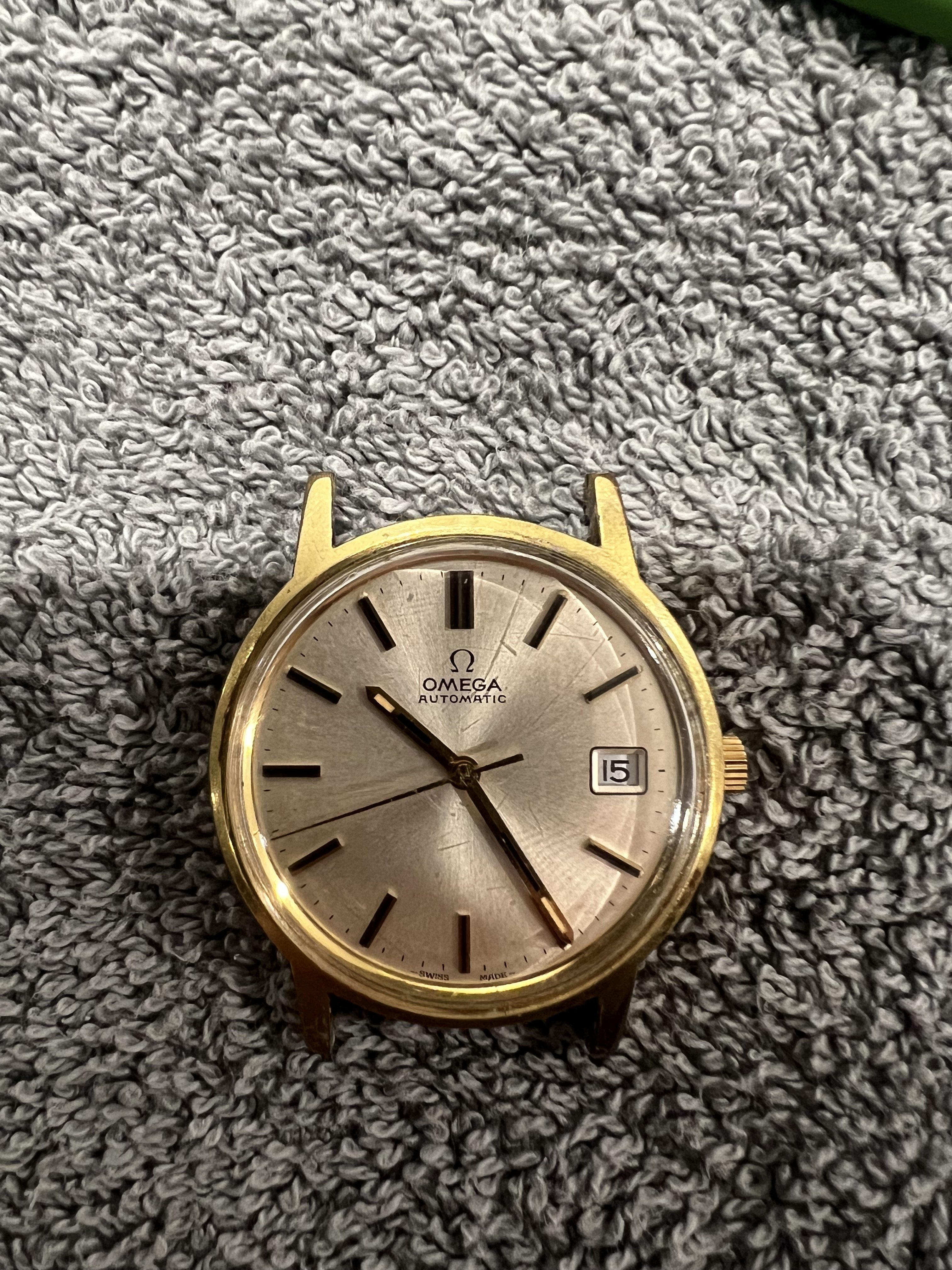

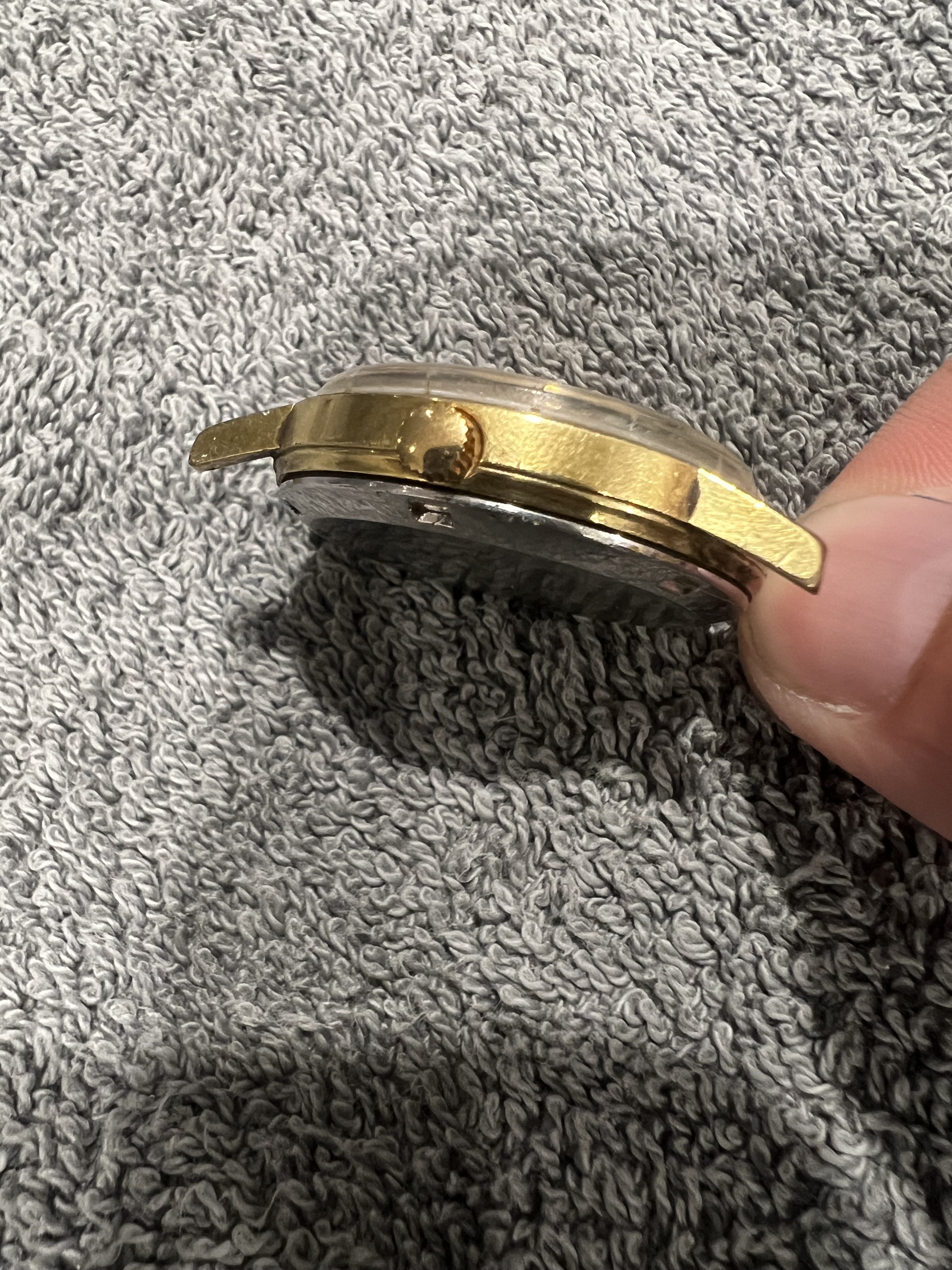

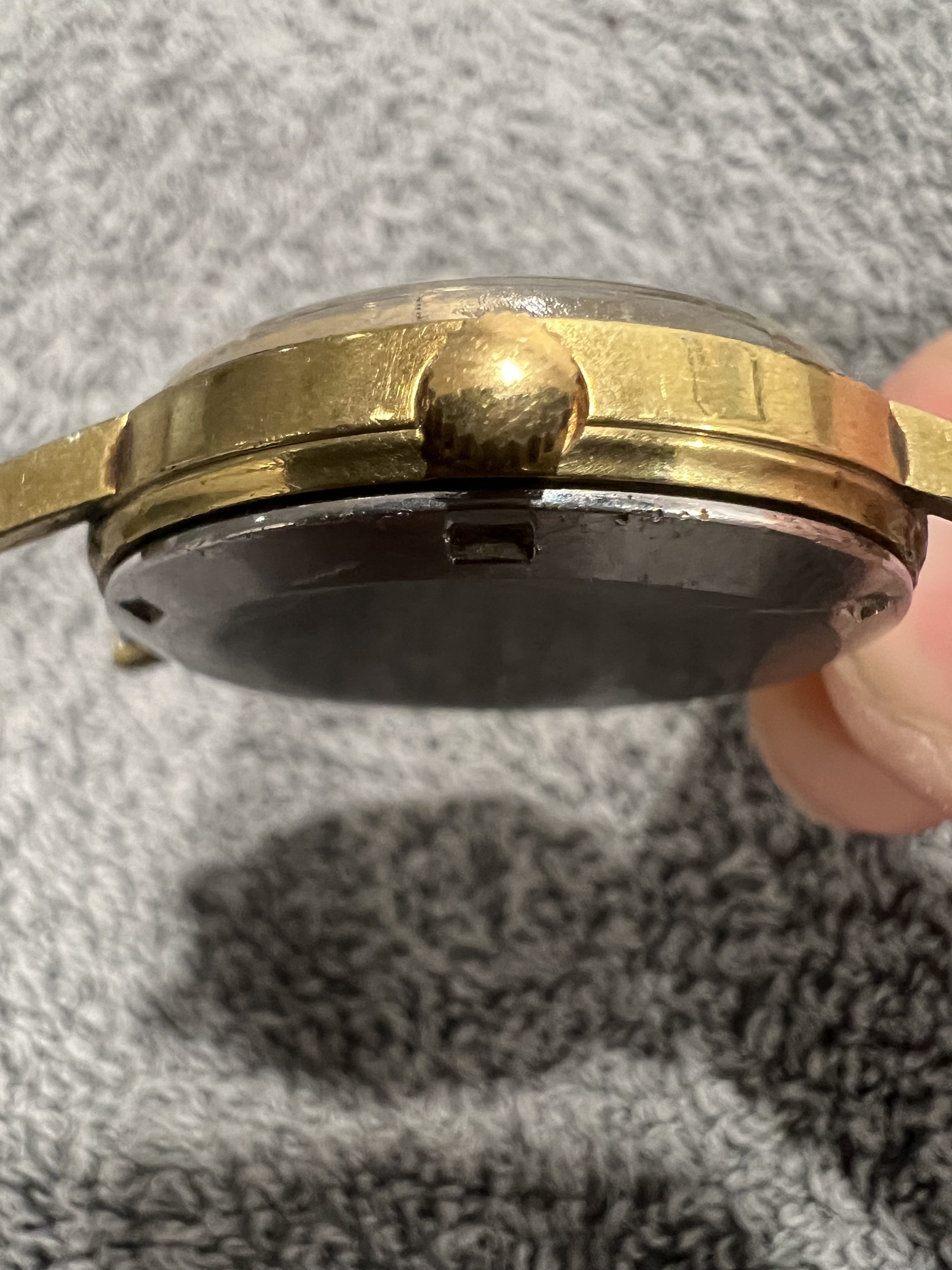

Hey all, just received a watch from an eBay auction. Only issue is that it appears to be an aftermarket crown. I’ll attach the photos below. Would anyone happen to know what the correct crown should be or where I could find one? The serial number dates the watch to 1973 and is a Cal 1012 Ref 166.0163.
thanks all for the help!

If you know the reference number. You can do a google search. The ones with the same on them is the one you probably need.
can also use the reference number inside the case back and order one. However. Current are gold plated and won’t be a 100% match to case colour
last. If you order a new crown. Buy a new stem as old cut to fit incorrect crown. Might be long enough, but if not. You incur a second shipping fee
