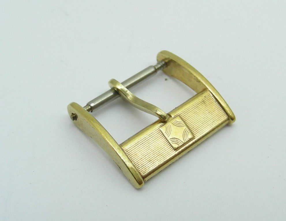

The buckles are a bit of a loose subject, like a lot of things Zenith. In about 1960, they changed to the buckle with ZENITH written on it, but they also carried on using (presumably old stock) buckles like MMMD has shown up until about 1965 as well as the "new" design.
http://www.ebay.co.uk/itm/VINTAGE-Z...0640750?pt=US_Watch_Bands&hash=item5af6fa136e
For reference, this is the one in the earlier link:

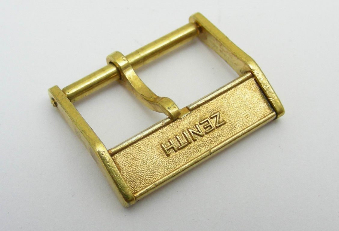

To complete the set, here is one from the 1970s from after the radio company bought Zenith:
