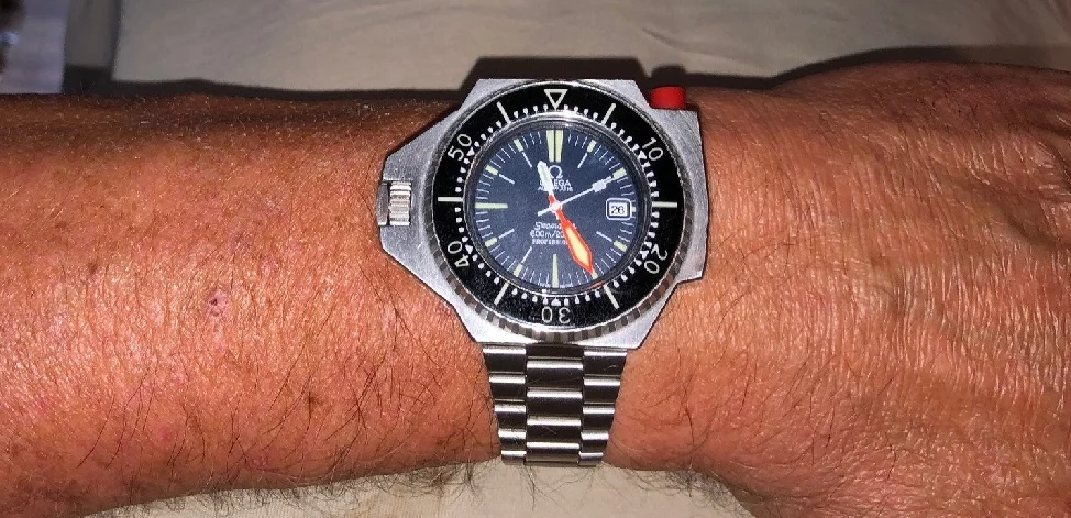

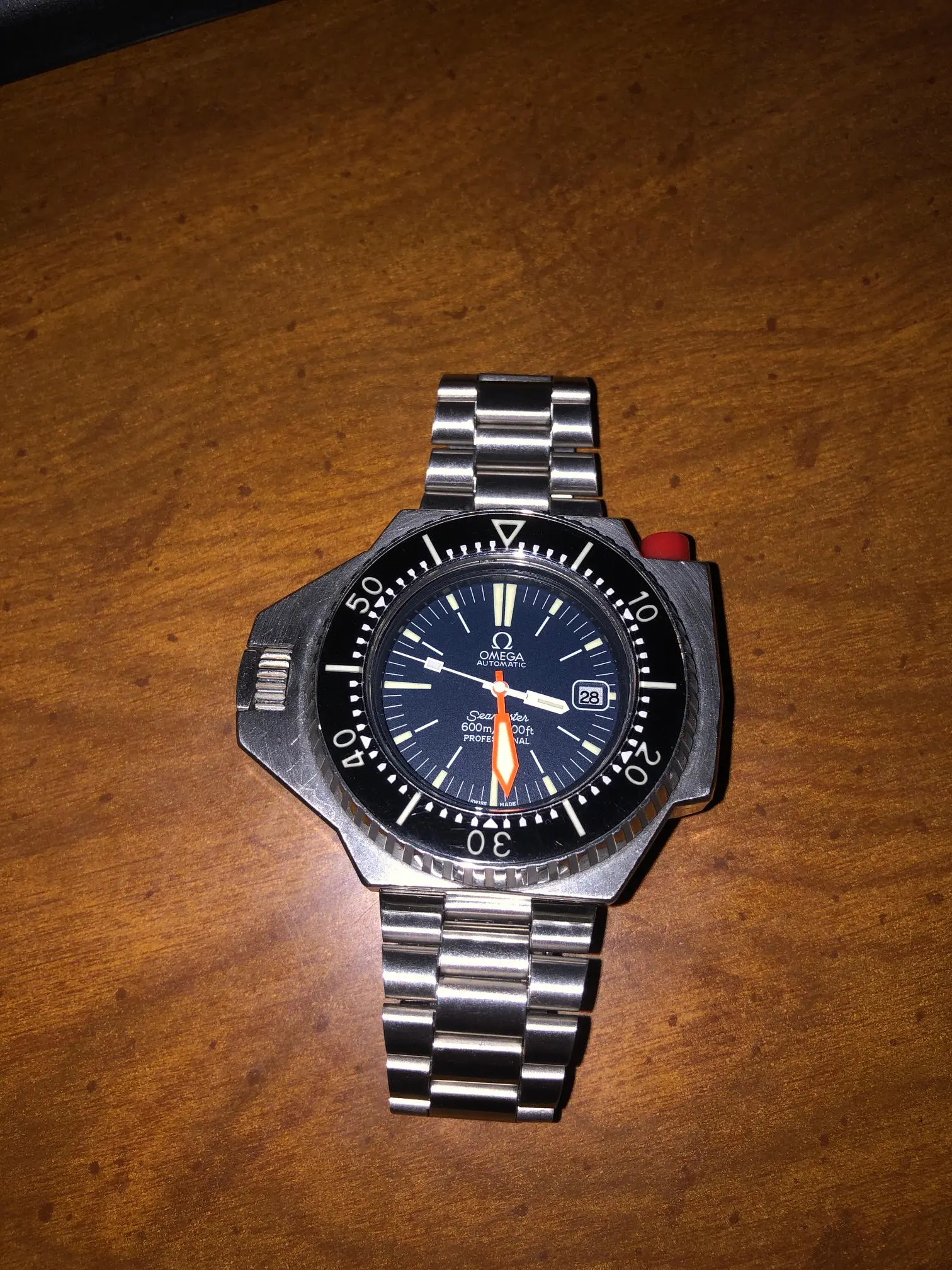

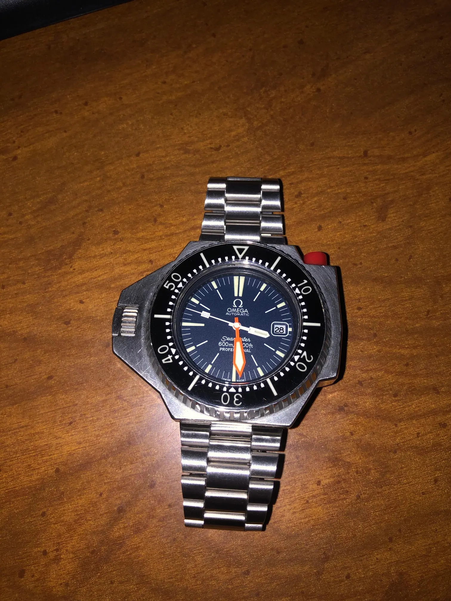

Morning which is the correct bracelet for ploprof 600 vintage?1162/162 24mm or 1162/172 22mm?
Some ploprof having 1162/172...not only 1162/162

some using 1162/172 with extract....in the past....the same for 1266/247 or 1247/237 22mm .depends on stock availability

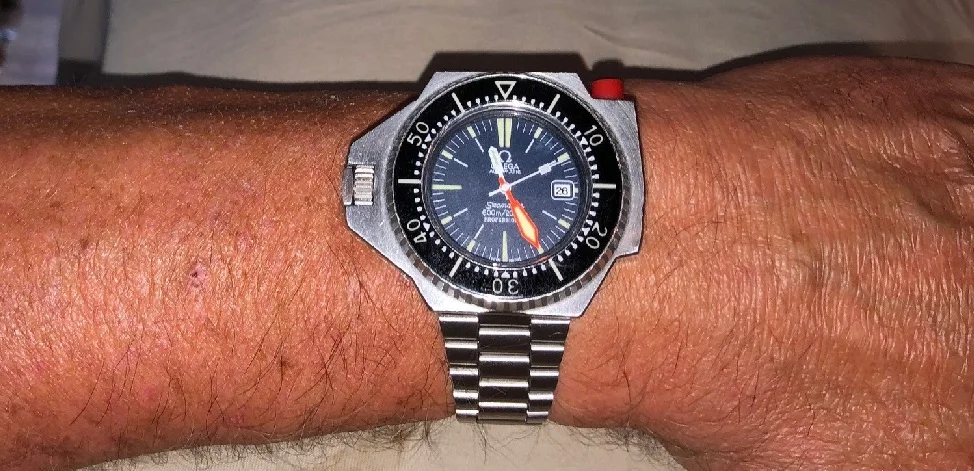

It’s the 1162/162. The 162 endlinks are 24mm. The 22mm endlinks are for the flightmaster and the big blue.

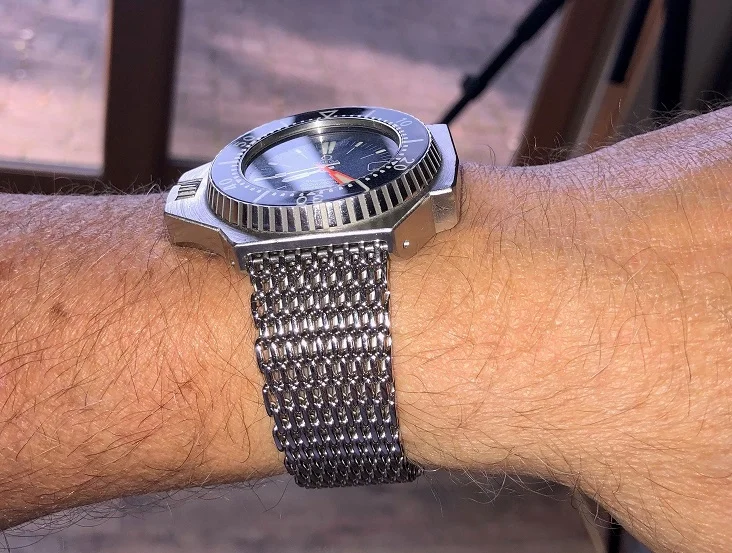

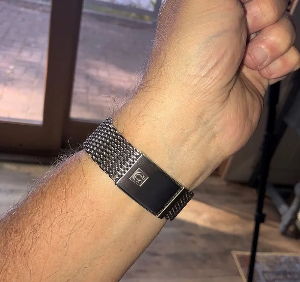

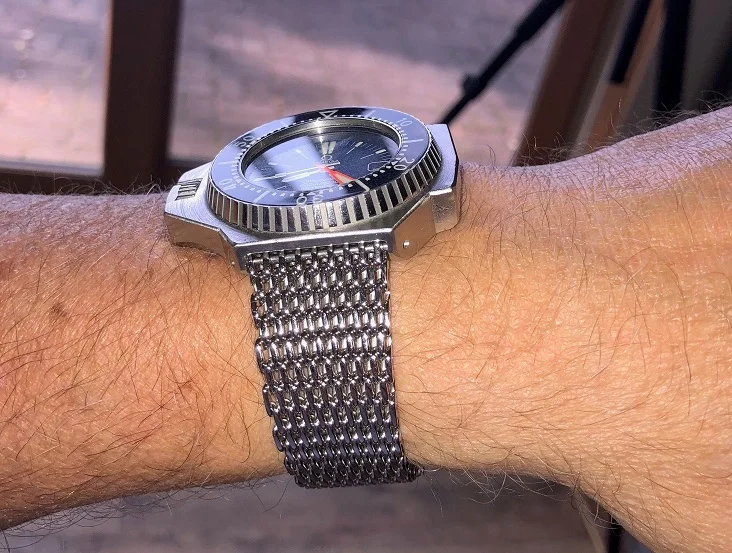

It will probably fit the PloProf albeit a little too loose. The mesh bracelet is the 1266/237 24mm.
The 22mm endlinks are for the PloProf 1000 166.093. Again, might fit but not the correct match.

The mesh bracelet ID is: 020ST1266237
The link bracelet ID is: 020ST11621621
The Isofrance style strap ID is: 0032CA4750001
