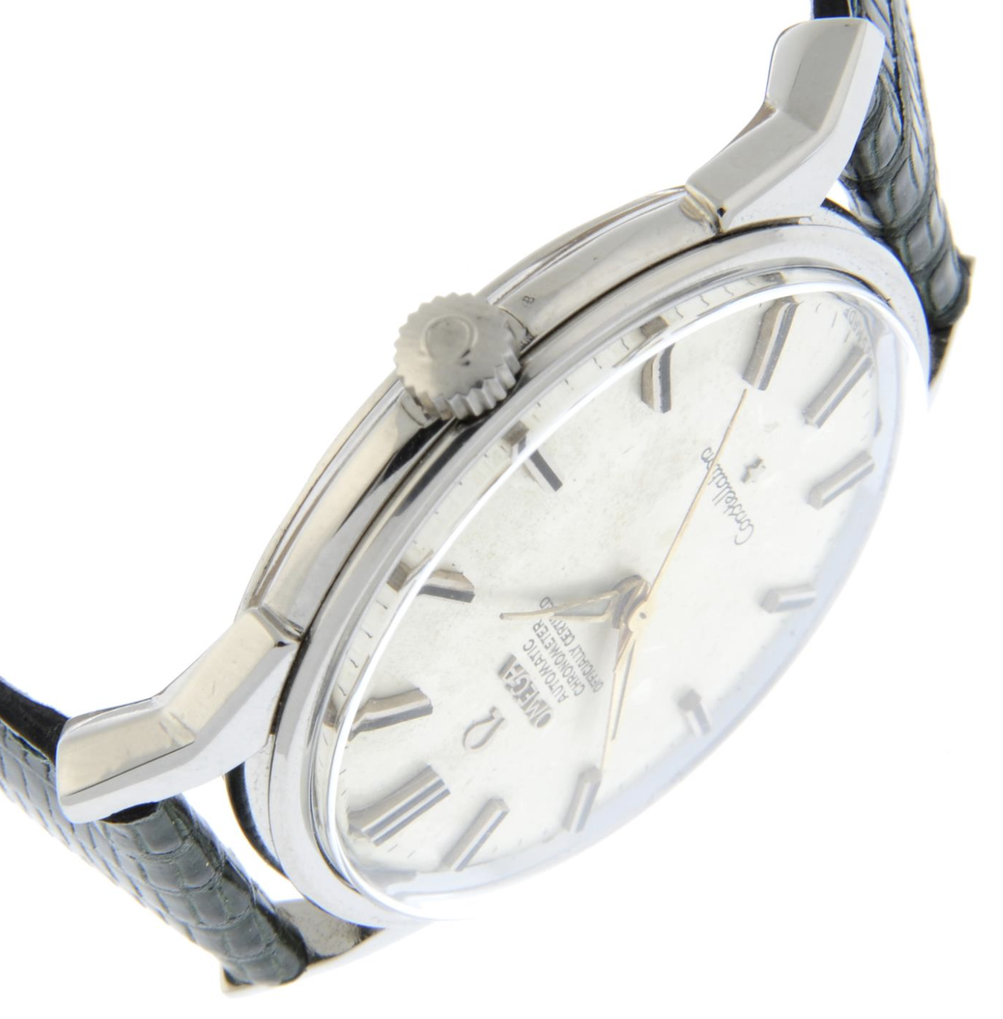

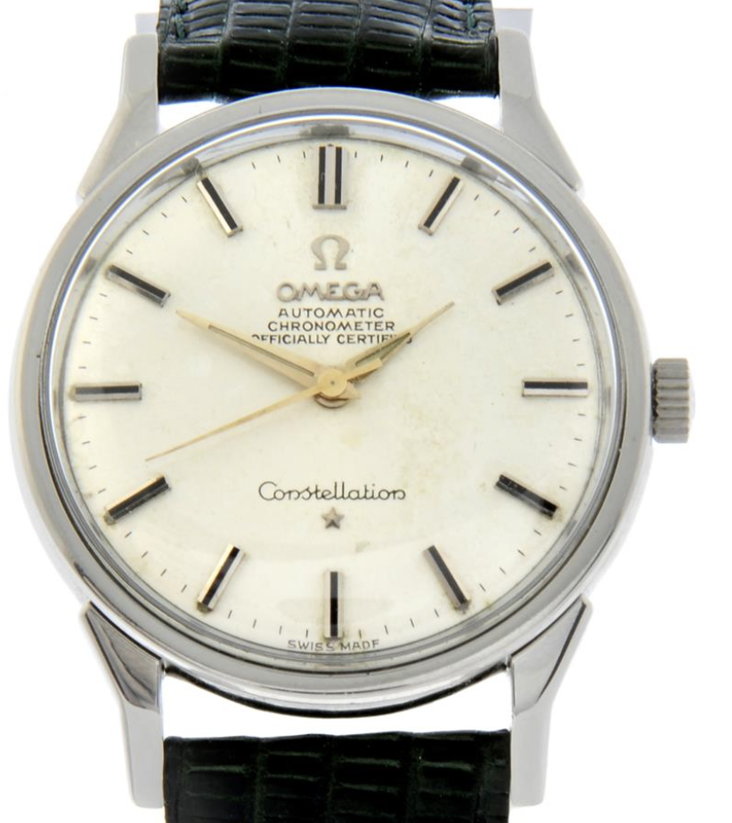

We've had a couple of new members looking for Constellations recently and as we haven't had a 'spot the difference' for a Constellation for a while, I thought I'd post this one - up for auction at a well known UK auction house at the end of the month.
First of all here's the auction-house description
"Omega - a Constellation wrist watch. Stainless steel case. Case width 34mm. Reference 14900 62 SC. Signed automatic calibre 551, numbered 19378038. Silvered dial with baton hour markers. On a green teju strap with gold plated pin buckle, signed Raymond Weil."
Estimate £400-600
And here are the pics- the watch has been 'messed around with' and there are a couple of problems, one obvious, the other major one needs more of an experienced eye -can you spot them?

Here's my starter for 10 and in no particular order
1. Polished case (wot no facets?)
2. Wrong hands - much too short
3. Wrong crown - looks like much later variety
4. Suspect redial - pix are not great quality but writing seems heavy

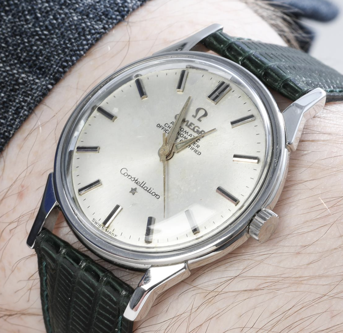

Constellations aren’t something I’ve purposefully researched, so let’s see how much I might have absorbed from all the great knowledge that gets exchanged here:
- I’ll firstly agree with Gareth that the handset doesn’t match the dial, as hands seem too short. Also might I have expected to see a T mark on the dial if the hands are lumed (or is this a red herring for this reference)?
- Also, perhaps a stretch, but is this dial type actually also wrong for the case style?
very true
true - wrong style, too short and also gold on an otherwise entirely SS watch
true - not even a correct replacement crown
Dial is grubby but I don't think it is a redial
true - also the colour and style
Its a 1962/63 watch so pre-Ts on the dial but there are also traces of lume at the ends of some indices
Getting warm but you're going to have to expand upon why you think it's an incorrect dial (tip- it's not just that it is a dome dial as that is quite ok)

It's always weird to me to see "Officially Certified" on a 14900. I know they exists on later serial numbers but still weird.
well, while your right - they do exist, but there is a picture building here….😉

Because that dial doesn't belong to that case and movement We can see hour markers with black painted tops which only seen on later references (167.005) with movements 24 mil serial number and higher.

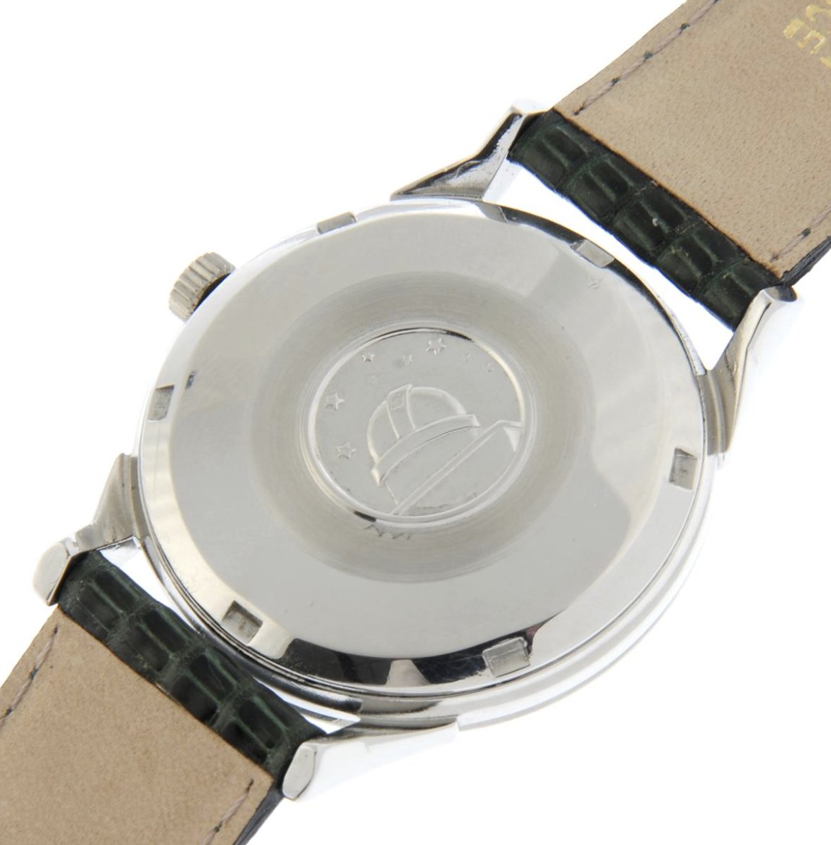

+1. Along with everything else, that brutally overexposed case back photo would have put me on alert right away.
that’s the ticket. 👍
I suspect that what is left of the lume at the end of the indices was added when the (incorrect) hands were added - otherwise the later dial would have had Ts.
Although I don’t recall seeing painted indices with lume ( unlike the onyx insert/lume combination seen on some late 60s Constellations)

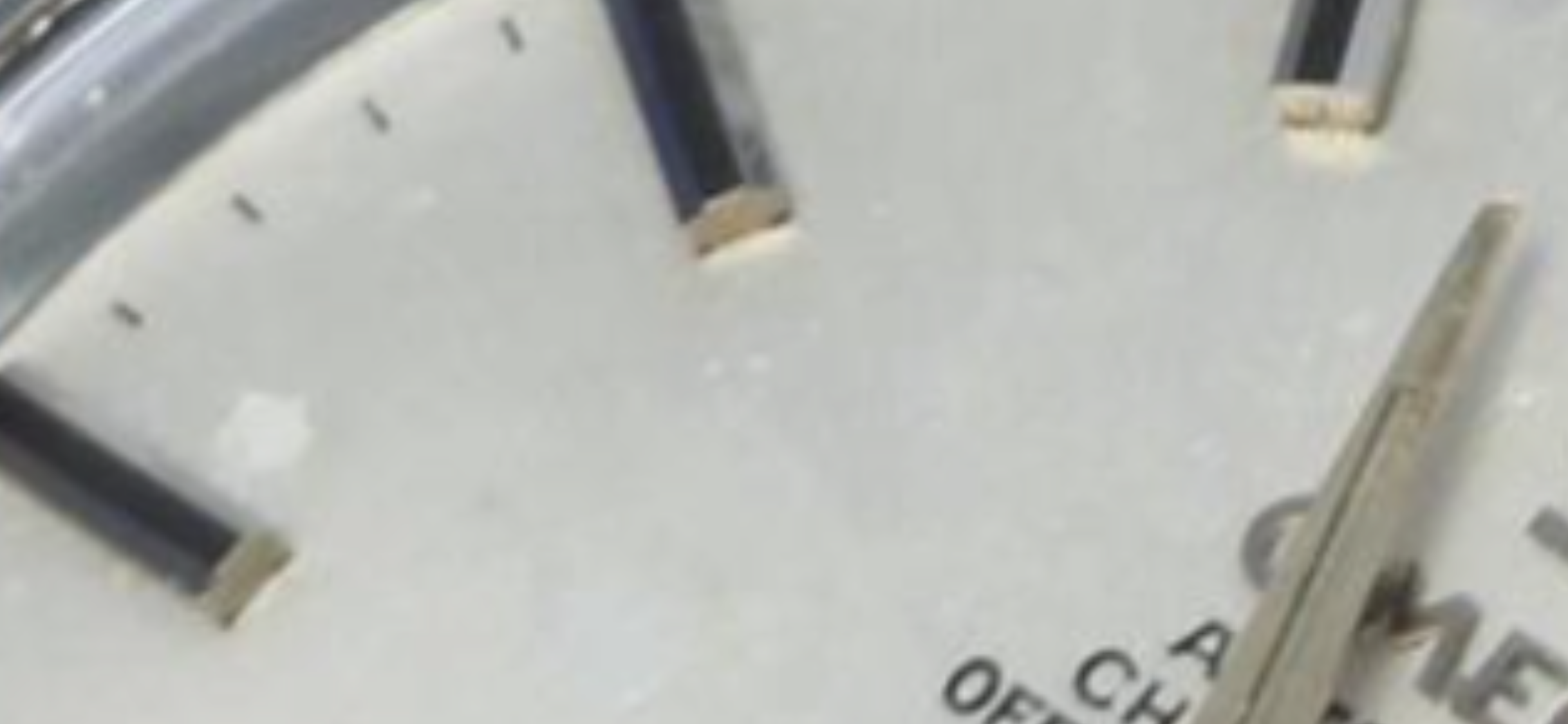

For clarity, this is the telling image - there is no depth to the black ‘inserts’ and this style of dial didn’t arrive until around 5 years after the 14900 case and 19,m movement were released.
