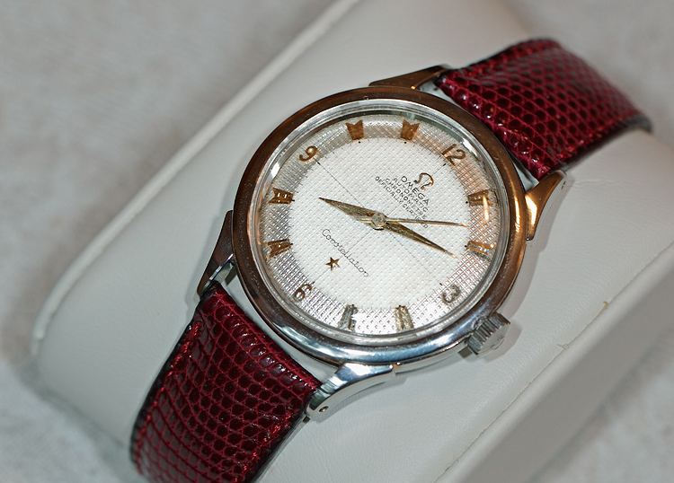

    Crosshair and script look a bit too thick (?)
    Here is mine.

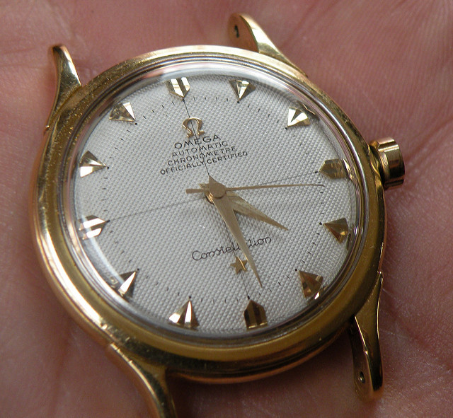

  3. gatorcpa ΩF InvestiGator Staff Member Feb 28, 2016
    12,206
    15,722
    I think dial is OK on this one.
    It says "Swiss" in really tiny letters under "6" marker and has straight legs on the "M" in Chronometre.
    [​IMG]
    That's the key on these.

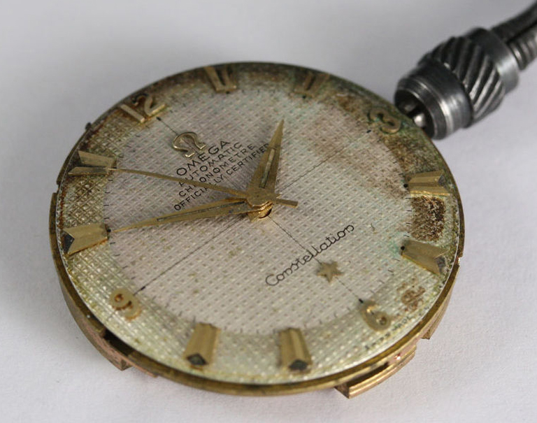

  8. cicindela Steve @ ΩF Staff Member Feb 28, 2016
    15,047
    23,791
    Yes this particular type of dial can be cleaned depending the areas affected. It requires care and the use of stereo magnification, Such as a microscope or at least an optivisor. This dial would be spot cleaned using a mild window cleaner on a extra small makeup applicator. Great care must be taken to avoid touching any of the printed areas or applying too wet. These are the only areas I would do. As soon as these areas are cleaned work should stop, you don't want to over clean.
    Please understand, I consider this dial to be pretty good to begin with and would want to have it in hand before deciding to clean.
    Here is a Dial that necessitated cleaning and the pros outweighed the cons.
    Samir, Gavin, Banner Roar and 2 others like this.

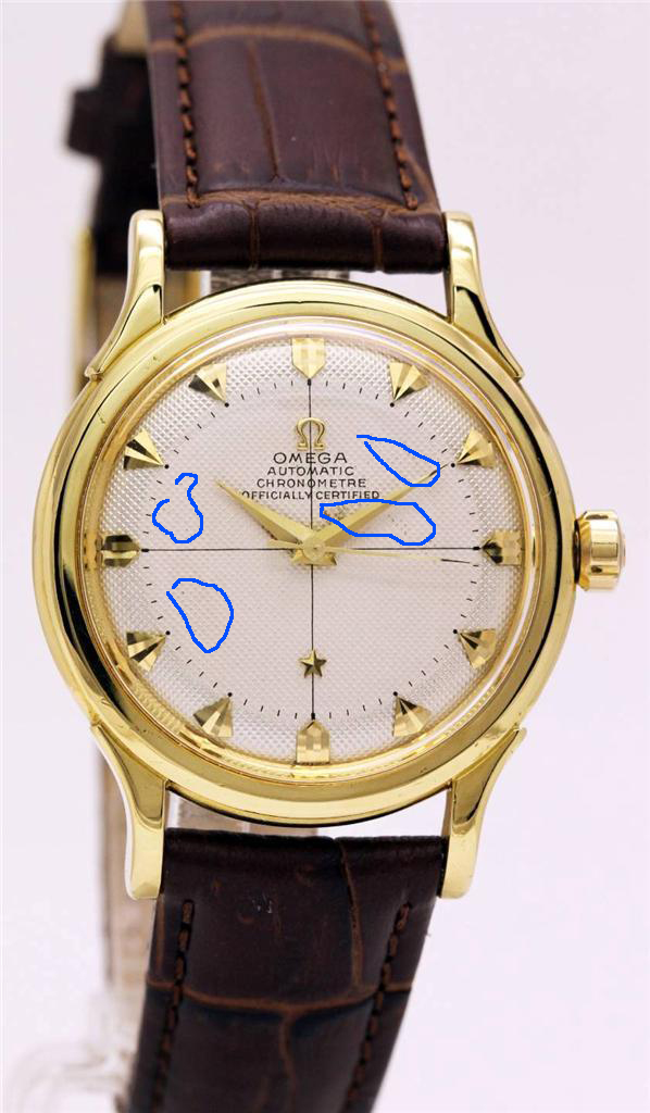

  16. Banner Roar Mar 2, 2016
    1,014
    2,580
    From an oblique view, can still see the marks below the 'certified'. Under the hour hand looks like a shadow. However there is a section that is darker than the shadow, will ask seller for more pics......made an offer but he is not moving on the price.
    I have a rule about buying anything...never pay the asking price.
    [​IMG]
