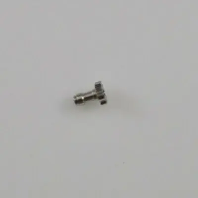

Found this one online and was wondering if it is a good fit (as the seller specifies):
Omega Sweep Second Cannon Pinion Caliber 351 Ht. 2.20 mm
Also for Omega 352 and 354.

I need the sweep second pinion. What I posted above is the description of the seller of the pinion he sells - so, not sure what he meant.
Do you know if sweep second pinion is interchangeable across all cal. 35x?

Used in the 351, 352 and 354 movements. Ht. is 5.52 mm

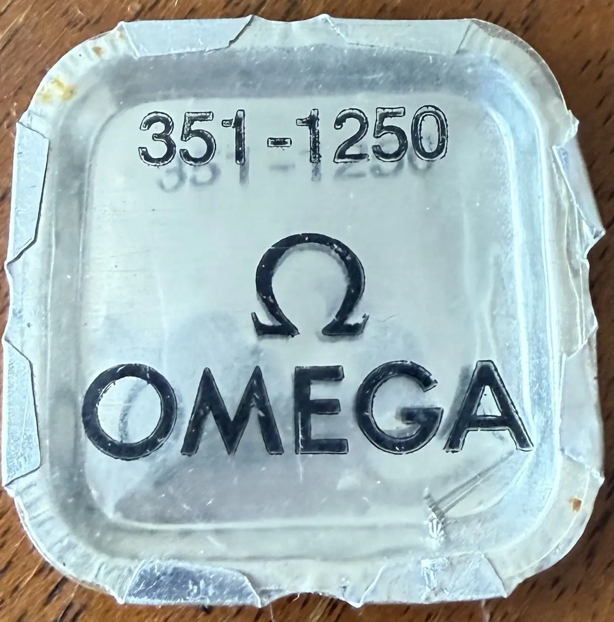

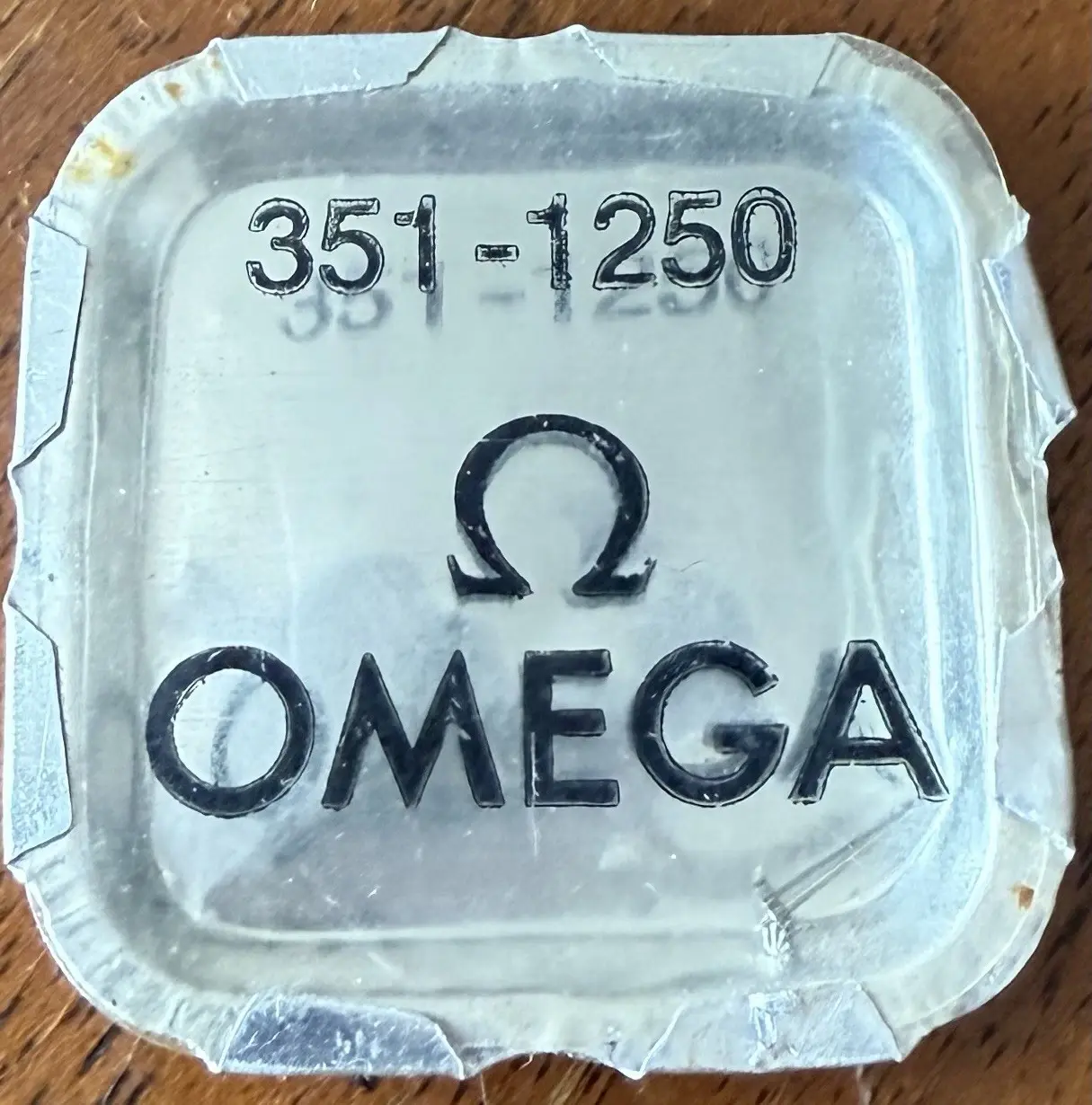

The part number you need is 72203511250, or 351.1250
