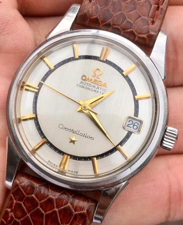

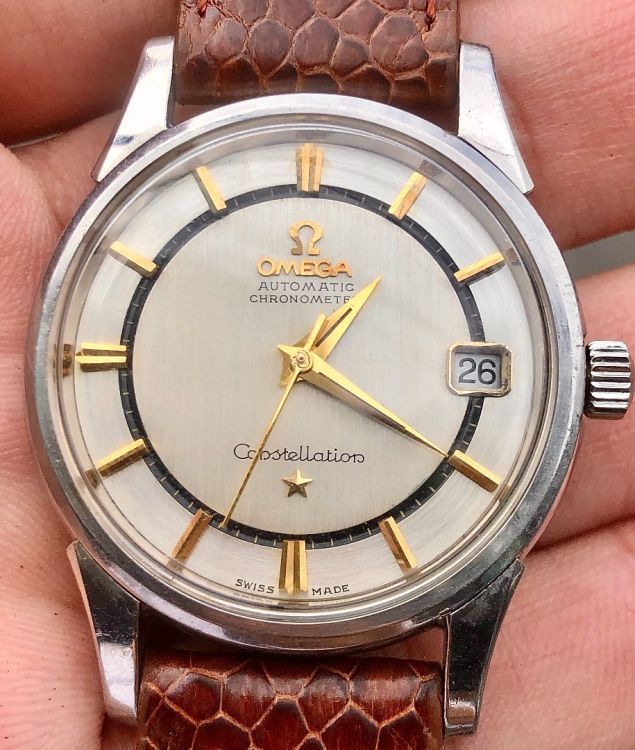

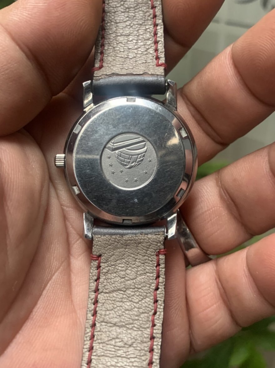

Hi valuable OF members.
I am interested in this Connie for sale locally.
I would like to solicit your thoughts about its authenticity especially concerning the dial.
Being newbie in this hobby I think the dial layout is quite unfamiliar. Is the first time I see "railroad" on white paint like this design.
Gold markers and hands are uncommon (to me) on railroad dial.
Also the crown seems wrong. Should it be a clover or a octagonal one?
Would you please confirm or refute my assessment. Thank you all in advance
6,832
10,502

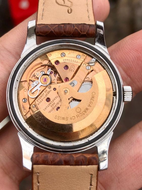

As a variant of the 14393, the 564 movt from 1969-ish is defintely a replacement.
The crown is a replacement.
The centre of the dial looks correct layout - with missing text and grained central pane - but the first E in chronmeter looks suspect (I thought it might be distortion but it appears to be the same from two different angles)
The images aren't good enough to asses the track itself but I don't recall seeing a black track against a silver dial (the tracks are usually 'silvered' and are often repainted on this reference of dial
The second hand is a replacement too
hope that helps
edit -looks like a crack in the bezel at 4 o'clock too
411
627
Thanks @Peemacgee and @nanjingcigaretes for quick replies.
I did not see the crack at 4 on bezel until you talked about it!
Except gold logo, gold indices and gold markers - which attract me the dial layout is definitely weird.
I will pass on this Connie.
Thank you

1. Have never seen a cal 564 in a rail track dial.
2. Is the rail track coloured black....if yes then is a redial. Also agree its a Franken for 1 above (and would NOT get this one)
3. Wrong crown though wrong crown not usually a deal breaker

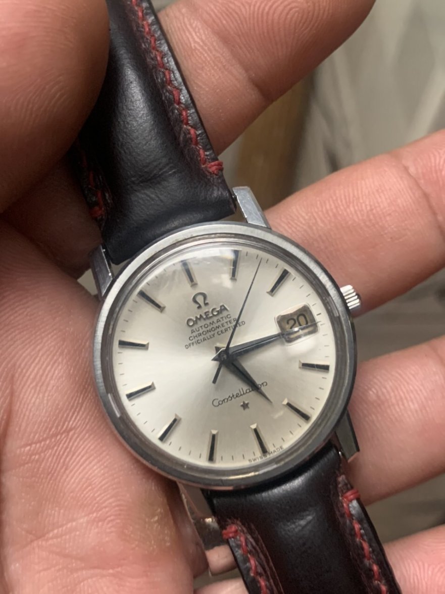

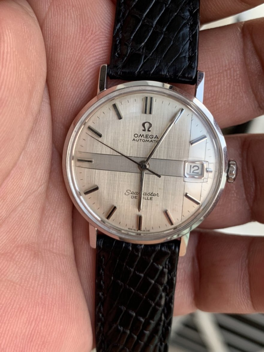

@ConElPueblo Yes. I live in Saigon Vietnam
@JohnSteed
Agree ! Vintage watches resemble a minefield in my country. But...
Although I am not playing advocate’s devil. Sometime I stumble on nice pieces in local watch forums. Please comment these:
