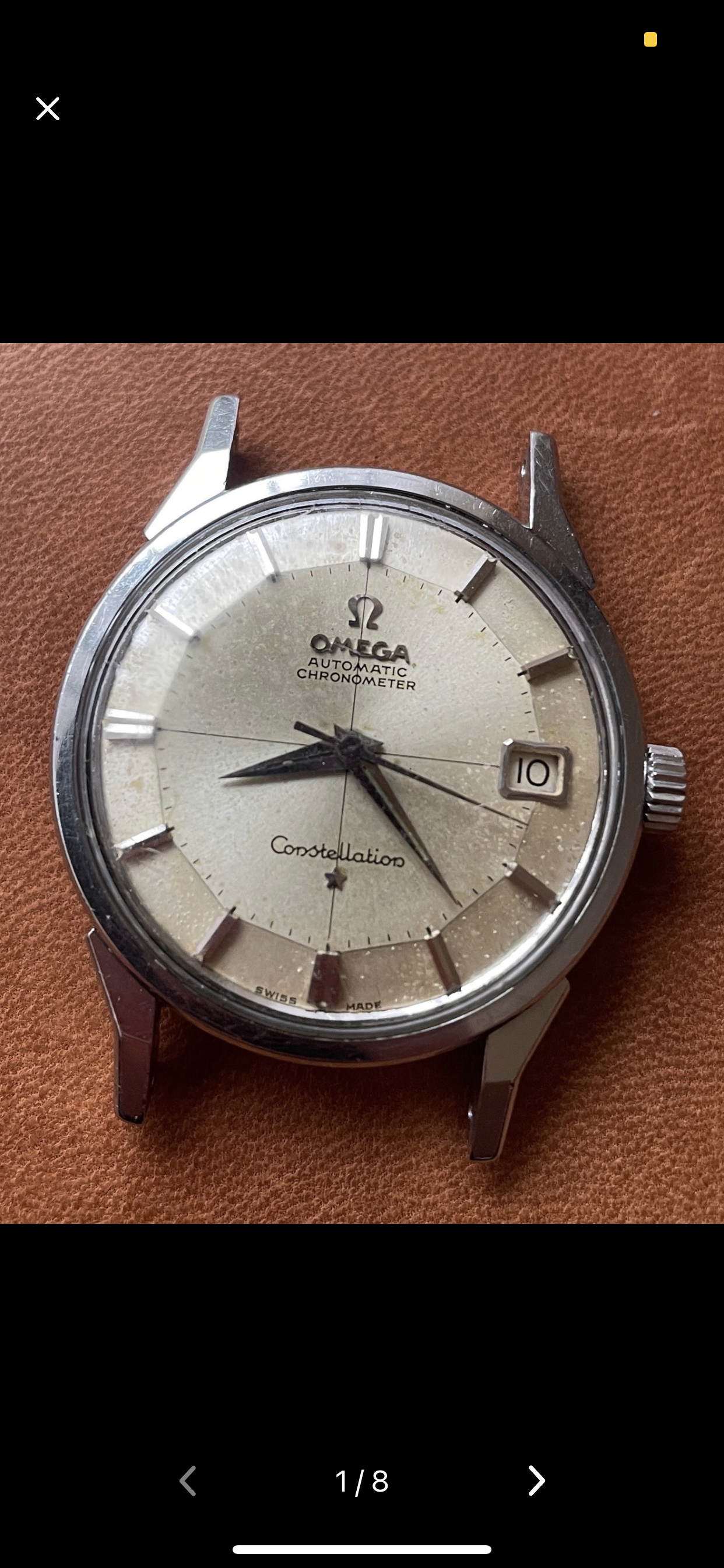

You are correct saying the crown isn't the matching one for this reference.
The dial is original but has seen better days. The same can be said for the case condition.

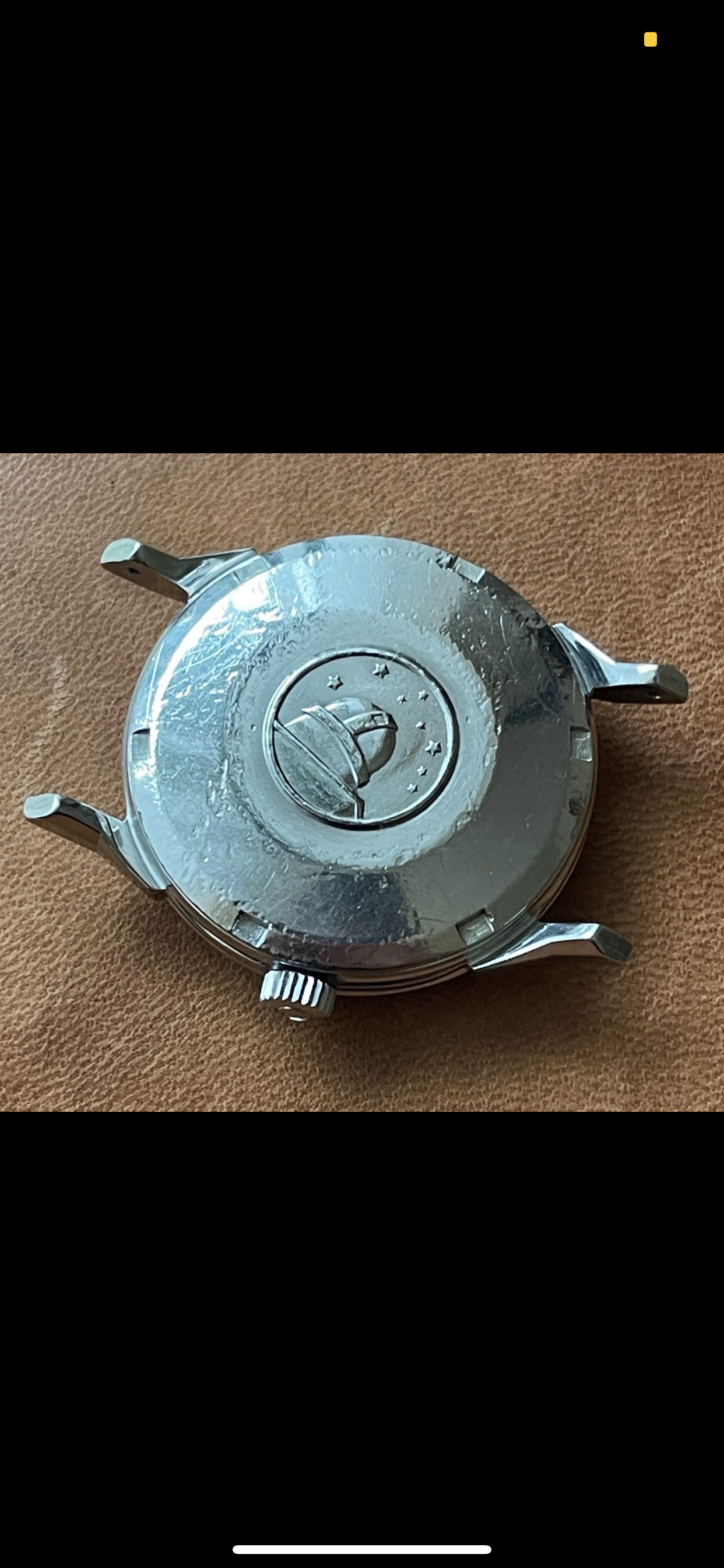

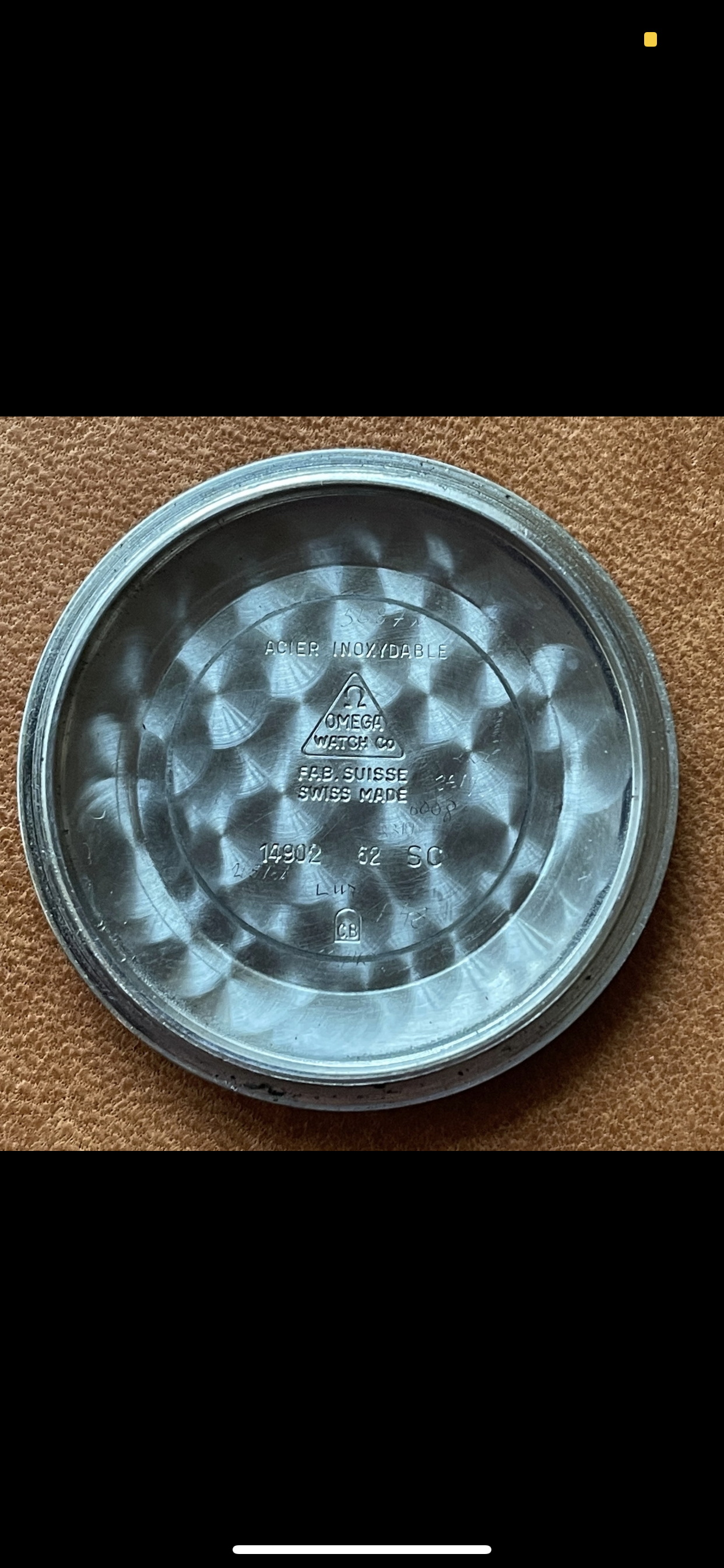

For the price, I'd definitely advise you to wait and pass on this one. The caseback is really in bad condition, the lugs have lost a lot of definition and the dial has lost its shine.
3,596
13,553
Wow. Whatever happened to the poor case back...

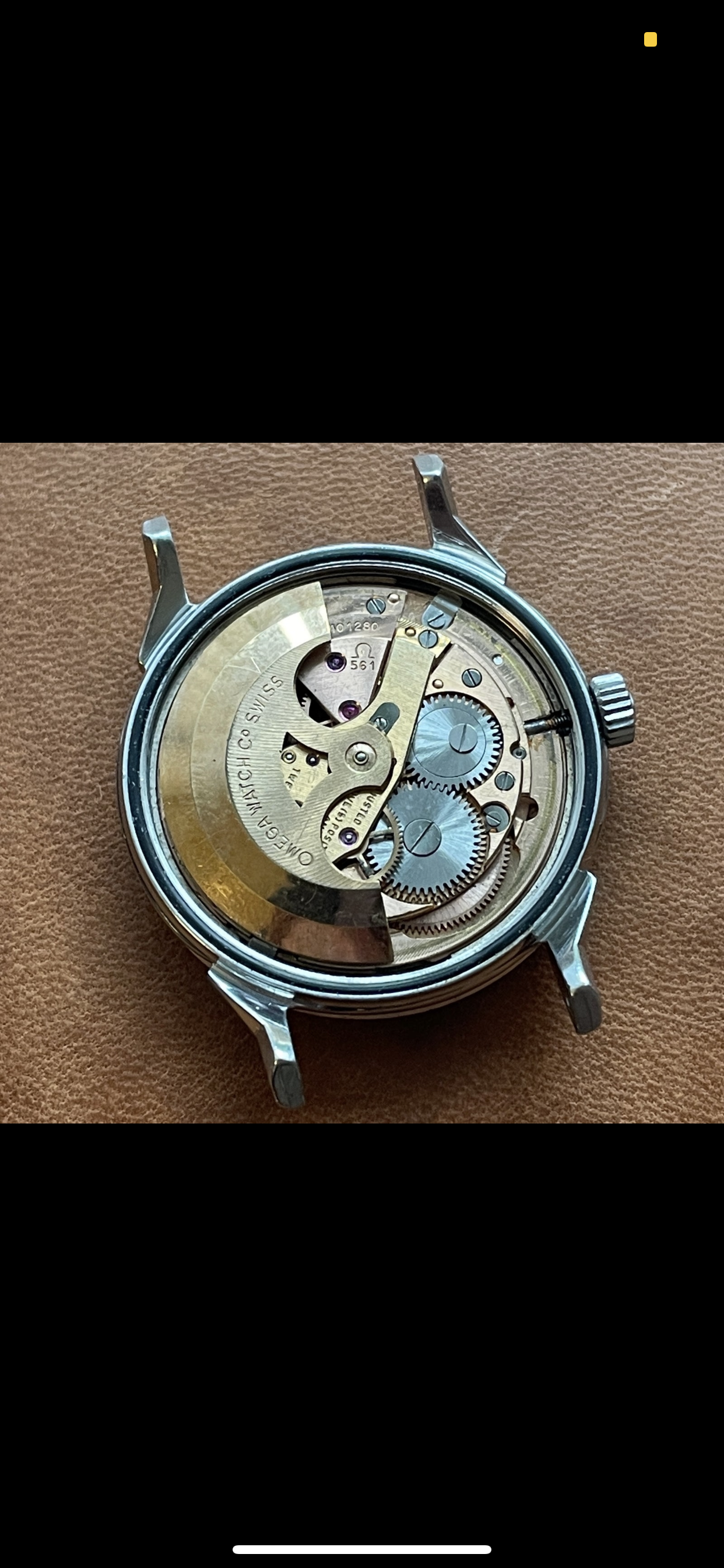

800€ is certainly pretty low for one of those, but I'd give it a hard pass regardless. Do you find it attractive as-is? Destroyed case back, unevenly damaged dial, and a very, very tired looking movement. The crown is a replacement, yes, but that's one of the smallest issues in my opinion.

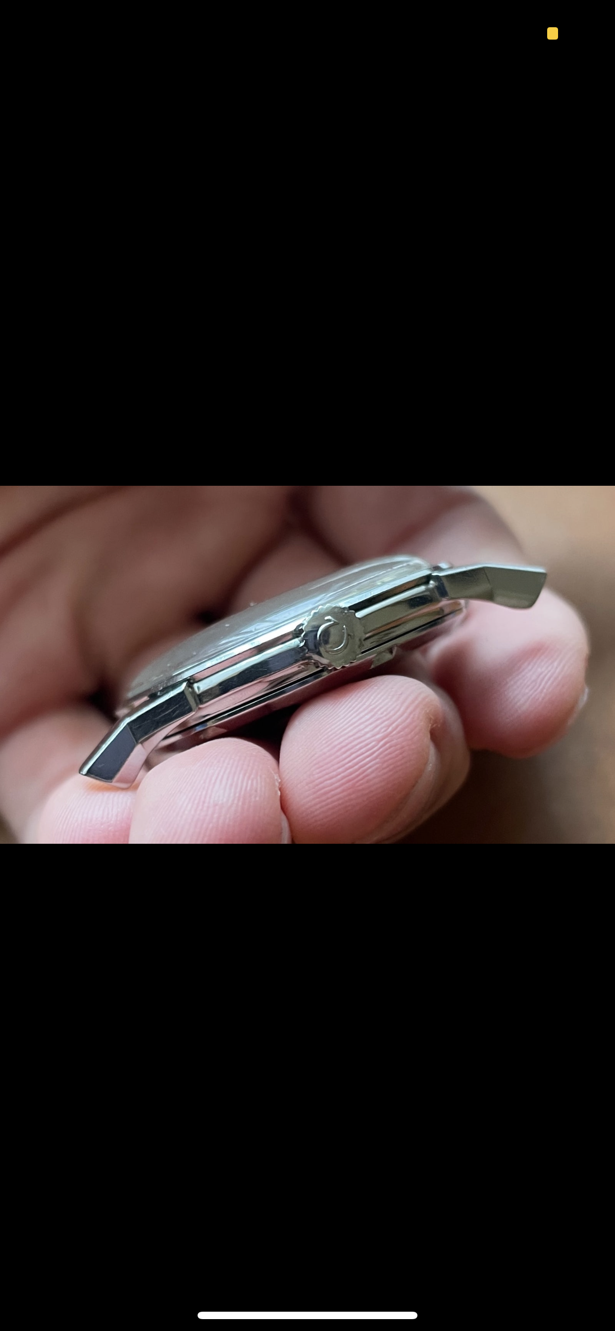

To end on a positive note: The lugs do actually look better than average. Not good enough to buy the whole watch for that reason, though.

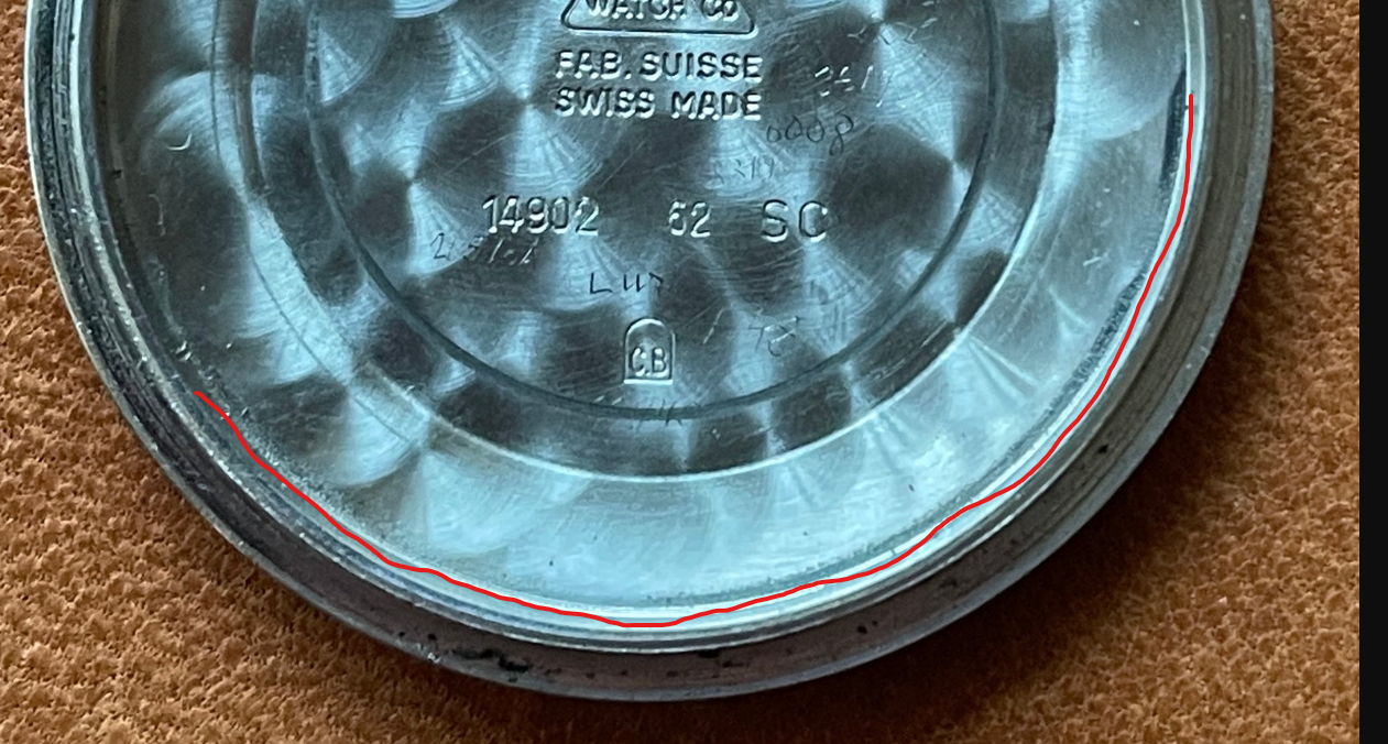

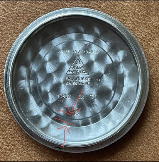

All the different colors of the parts, there are hardly any left in the original red gold coating. That plus the way the dial looks makes me think that there might very well be rust inside the movement. Oh, and the rotor has been rubbing on the case back for quite a while.
233
1,871
Thank you for your keen eye on this. Is this is the indication of the rubbing (right above the red line)?
4,593
10,813
I like the watch...for around $400. I would give it a quick and dirty lube job and wear it at that price. The case back looks like the watch was sitting in a vehicle's glove compartment full of nuts and bolts or coins and rattling around there for years. If there was similar damage to the bottom of the lugs I would then suspect it was on pavement and run over a few times before someone picked it up. As a kid I found a Longines in the street with similar road rash on the back.
3,596
13,553
I was mainly thinking of this one:

The watch has a lot of condition issues, spotting on dial, missing lume in hands, etc. But the only really terrible part is the case-back, and that doesn't show when you're wearing it. So if you can get it really cheap, it could be a fun watch to wear. But it will be hard to sell in the future if you want to upgrade.
