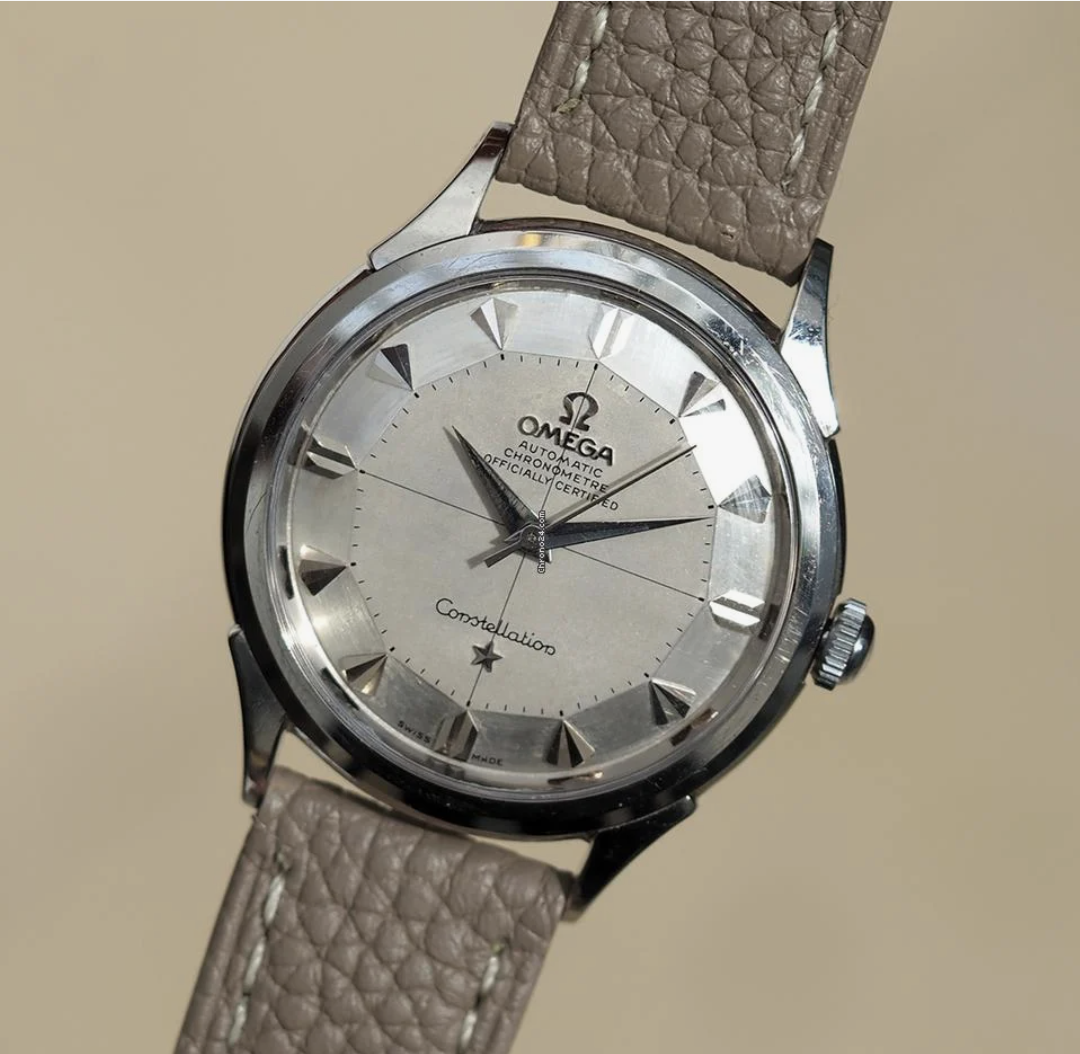

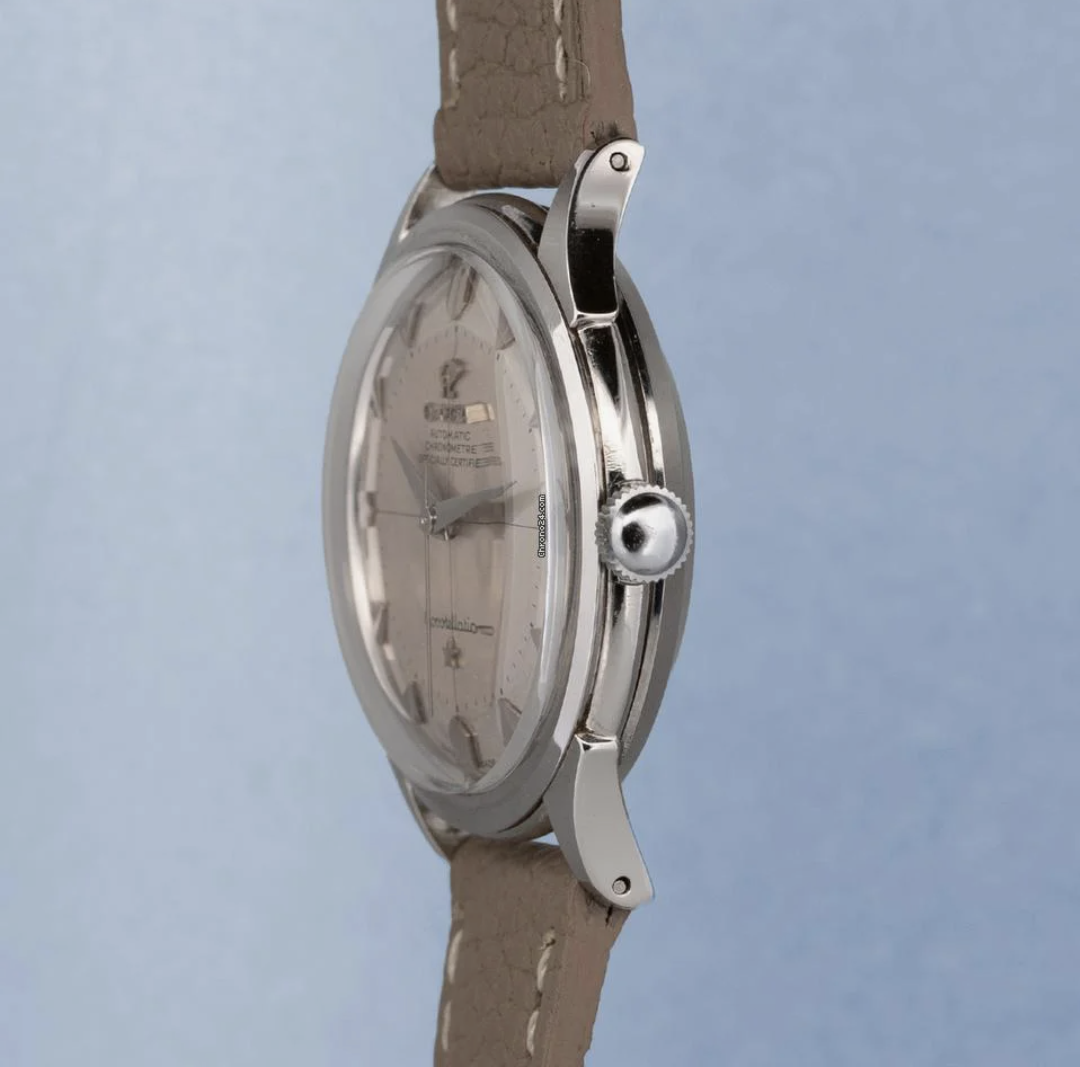

Posts 16 Likes 18 Dunk15 ·Aug 19, 2024 Hi Everyone Been searching for a nice crosshair 2852 for some time and I'm considering purchasing this one. To my eye, the watch looks good aside from the crown, but I was hoping to get the community's input on if anything else looks off. Thanks in advance!

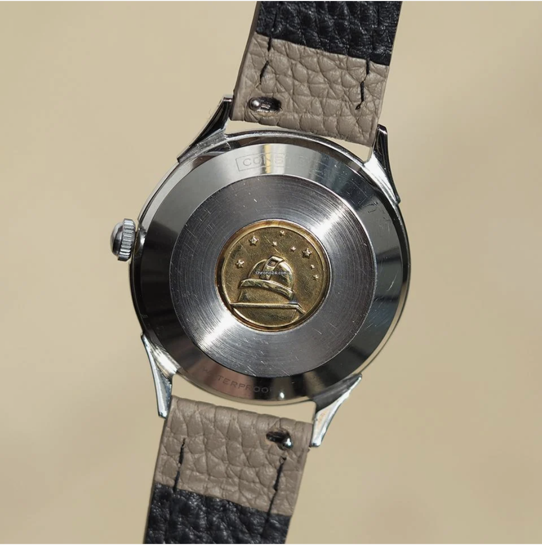

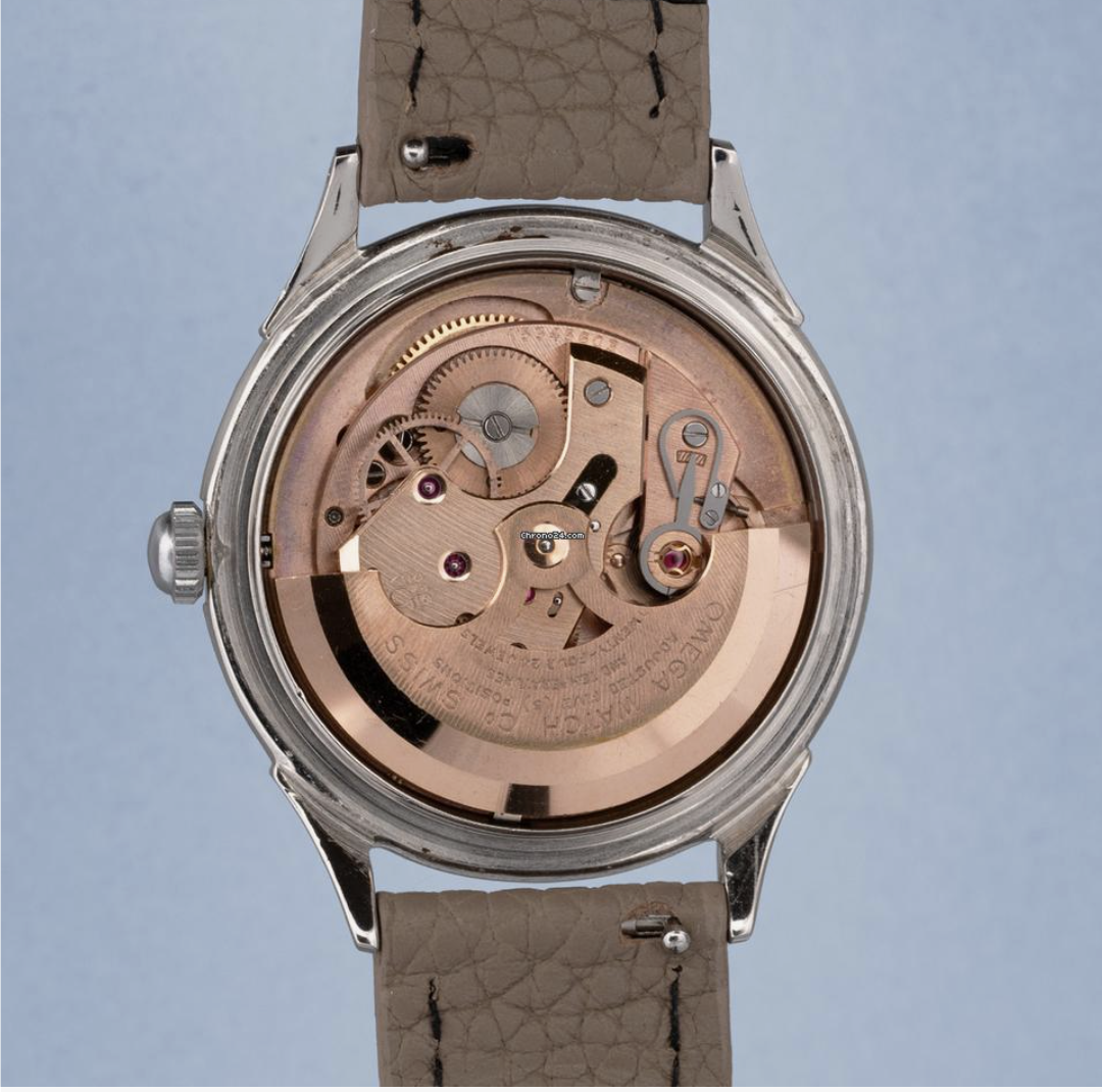

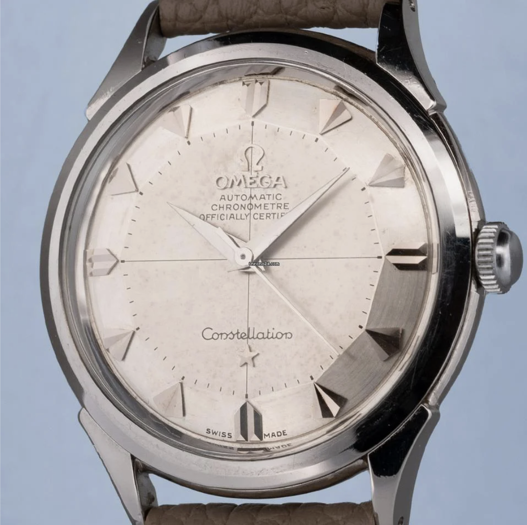

Posts 24,798 Likes 55,079 Dan S ·Aug 19, 2024 The dial has some condition issues and I’m seeing significant rotor rub. The crown as you mentioned.
Posts 16 Likes 18 Dunk15 ·Aug 19, 2024 Dan S The dial has some condition issues and I’m seeing significant rotor rub. The crown as you mentioned. Thanks Dan. Is the rotor rub the black markings on the inner caseback, or are you seeing that on the movement itself?
Posts 24,798 Likes 55,079 Dan S ·Aug 19, 2024 Dunk15 Thanks Dan. Is the rotor rub the black markings on the inner caseback, or are you seeing that on the movement itself? Both. You can see discoloration on the outer edge of the rotor. It’s always possible that it was addressed in a previous service. But probably not.
Posts 4,453 Likes 11,353 kyle L ·Aug 20, 2024·Grasshopper Whether it's a good buy or not depends on the price, but dial has potentially been "cleaned". The top layer looks kind of splotchy.
Posts 8,817 Likes 62,454 TexOmega ·Aug 20, 2024 kyle L Whether it's a good buy or not depends on the price, but dial has potentially been "cleaned". The top layer looks kind of splotchy. Appears that way and over exposed/manipulated pix confirm the seller was concerned, too. Need better pix in natural light, hi-rez
Posts 13,489 Likes 31,801 X350 XJR ·Aug 20, 2024·Vintage Omega Aficionado I'm seeing the same issues as others have noted re the dial, not likely to look this clean in person.
