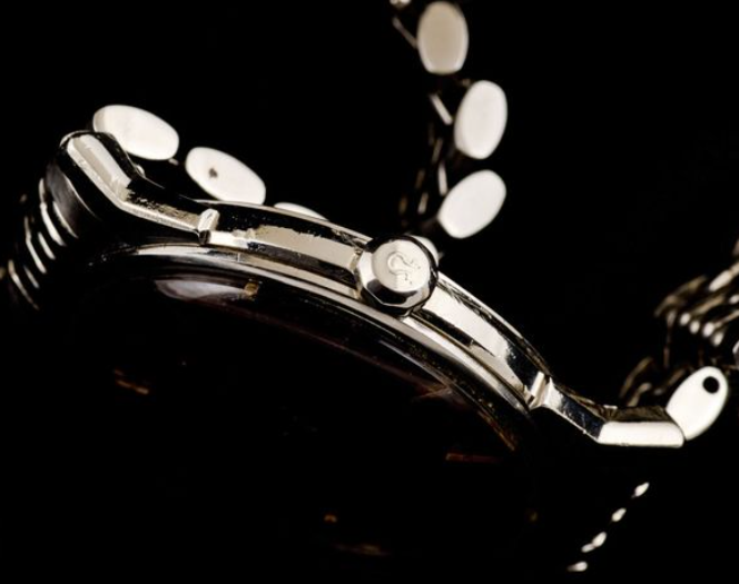

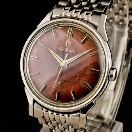

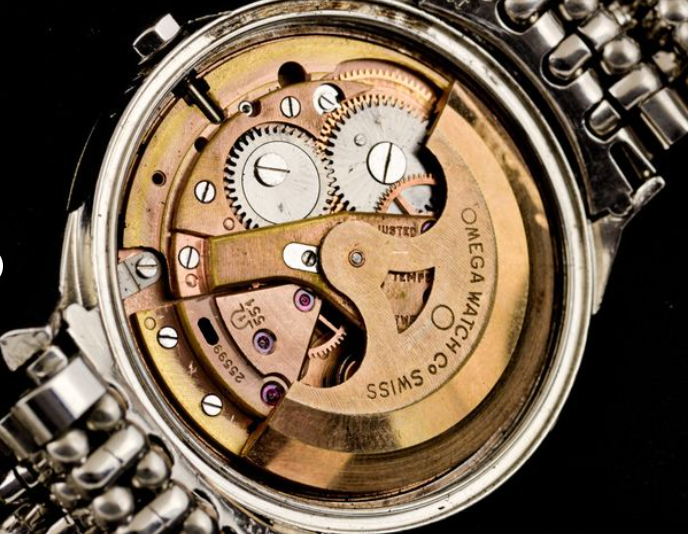

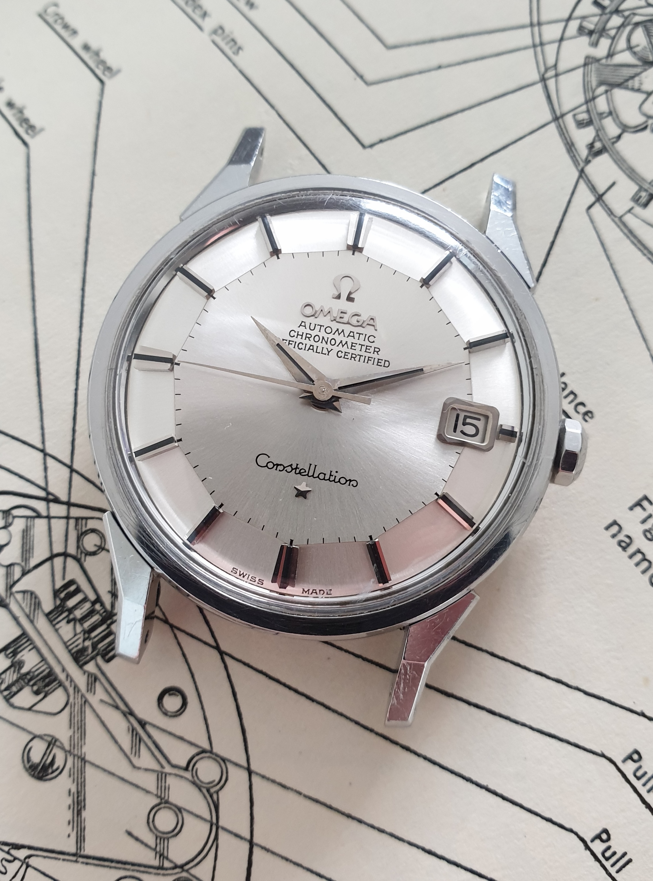

Hi everyone,
I saw an ad for the Constellation below and fell in love with it, and thinking about buying it.
It's a Cal 551, movement number 25599
Curious to hear your views on it. Anything to consider with dials like these? (durability, sensitivity to light)
As for the rest of the watch?
What would you believe is an appropriate value for this model?
Best, Yves
3,595
13,551

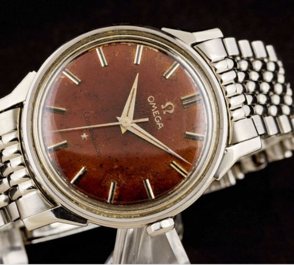

The dial has developed an interesting color - I like it although it really is extreme, but the rest of it is too far gone in my eyes.

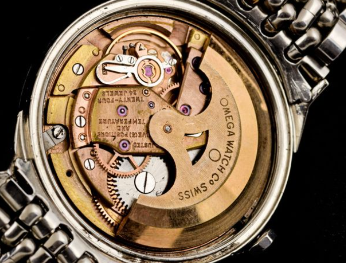

The tension ring of the seems to have degraded? It’s dirty and unpleasant. Also there seems to be color missing at the edge of the dial. Case is soft, and the movement looks very tired. I wouldn’t be surprised if there was rust in there tbh, and if the gasket wasn’t only removed for the picture but has been missing for a while, then there’s a good possible reason.
It also depends on the price. For 300€ I’d be tempted, even if it ends up needing a new movement / the case not being particularly attractive. For 700€, this’d be a hard pass for me.

Hello,
If you like the dial then great but it doesn’t add any to the value of the watch, it actually depreciates it. But it is to everyone’s appreciation.
Dials like that usually appear due to a default in gaskets and the sealing system in general.

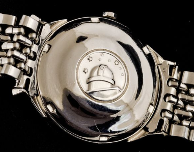

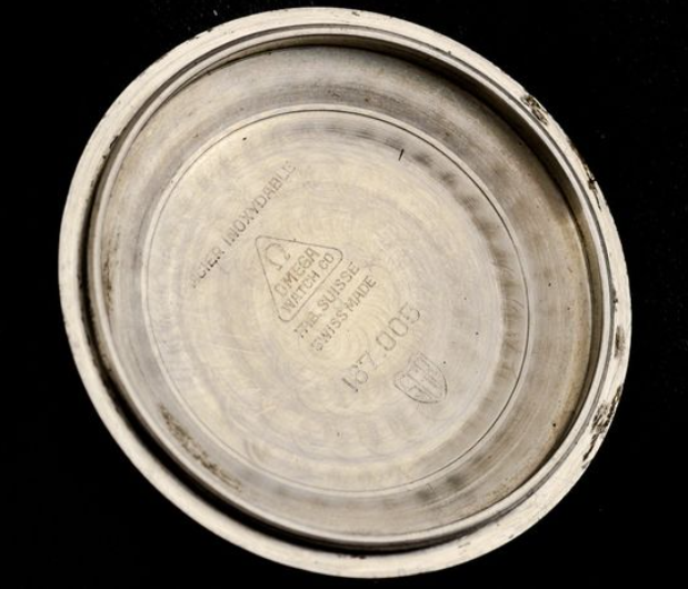

The case of the watch has been highly polished, there isn’t any original trait to it. Even the caseback is heavily polished.
The movement isn’t clean at all. So you’ll have to plan a service.
Finally, it all comes down to the price. I wouldn’t put more than 500e-600e in that watch.

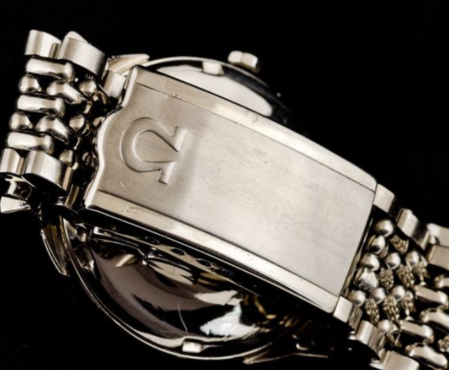

Oh wow that's a lot lower than expected. Isn't there value already in the bracelet?
3,595
13,551
Yes. It’s not correct/the best fit for the case, but it should be around ~150€ I’d say.

I like the bracelet and the only part here worth saving, in my opinion.
The pictures seem to be fairly heavily doctored, so what you end up with will differ from what you see, at least in regards to the dial colour etc.
The movement has been treated badly and is very unattactive. The caseback is one of the worst I have seen on a Constellation. The lugs and bezel have been heavily polished. The dial is toast and - IMO - completely trash.

The rotor assembly is from a much later watch (maybe early 1970’s?).
This looks to be an over polished, artificially aged frankenwatch.

totally agree with @ConElPueblo - this is a very sad watch.
There is no such thing as a tropical Constellation dial.
There are clean dials, patinated dials, heavily patinated dials and knackered dials.
This dial is off the scale of the latter. ( but ‘toast’ is an apt description)
if you like it that’s great, each to their own - but let’s not attribute a Rolex fandom phrase to cloud the sensible world of Omegas.
I also agree that the only real monetary value is in the bracelet, and the movt looks like a money pit.

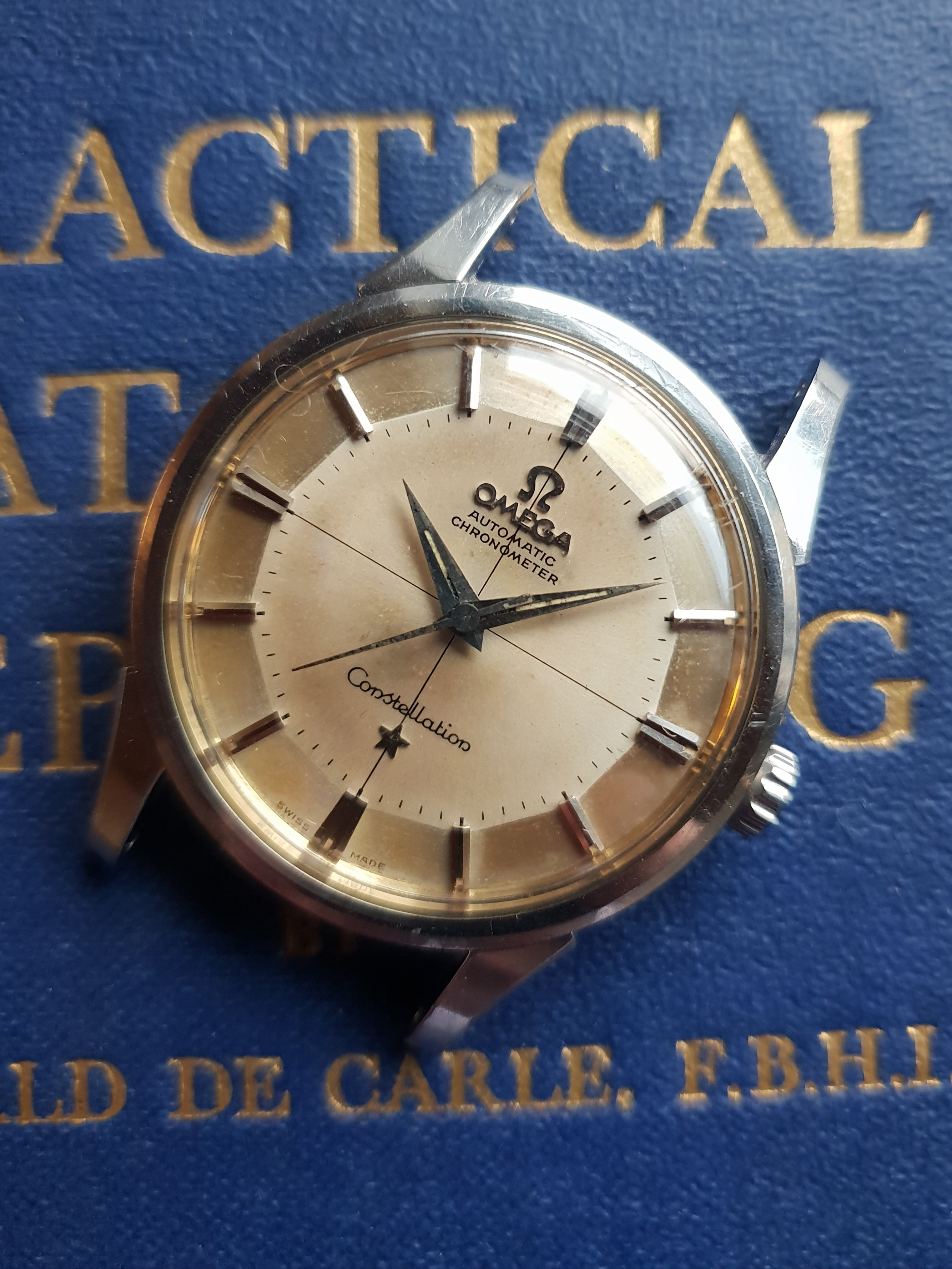

It is not a correct 167.005 bezel - on the dogleg versions they are flat, this one has an angle to it like a 14.3XX bezel, or it could be a custom made replacement.
14.381:
20181023_173721-jpg.645760
Dogleg model:
