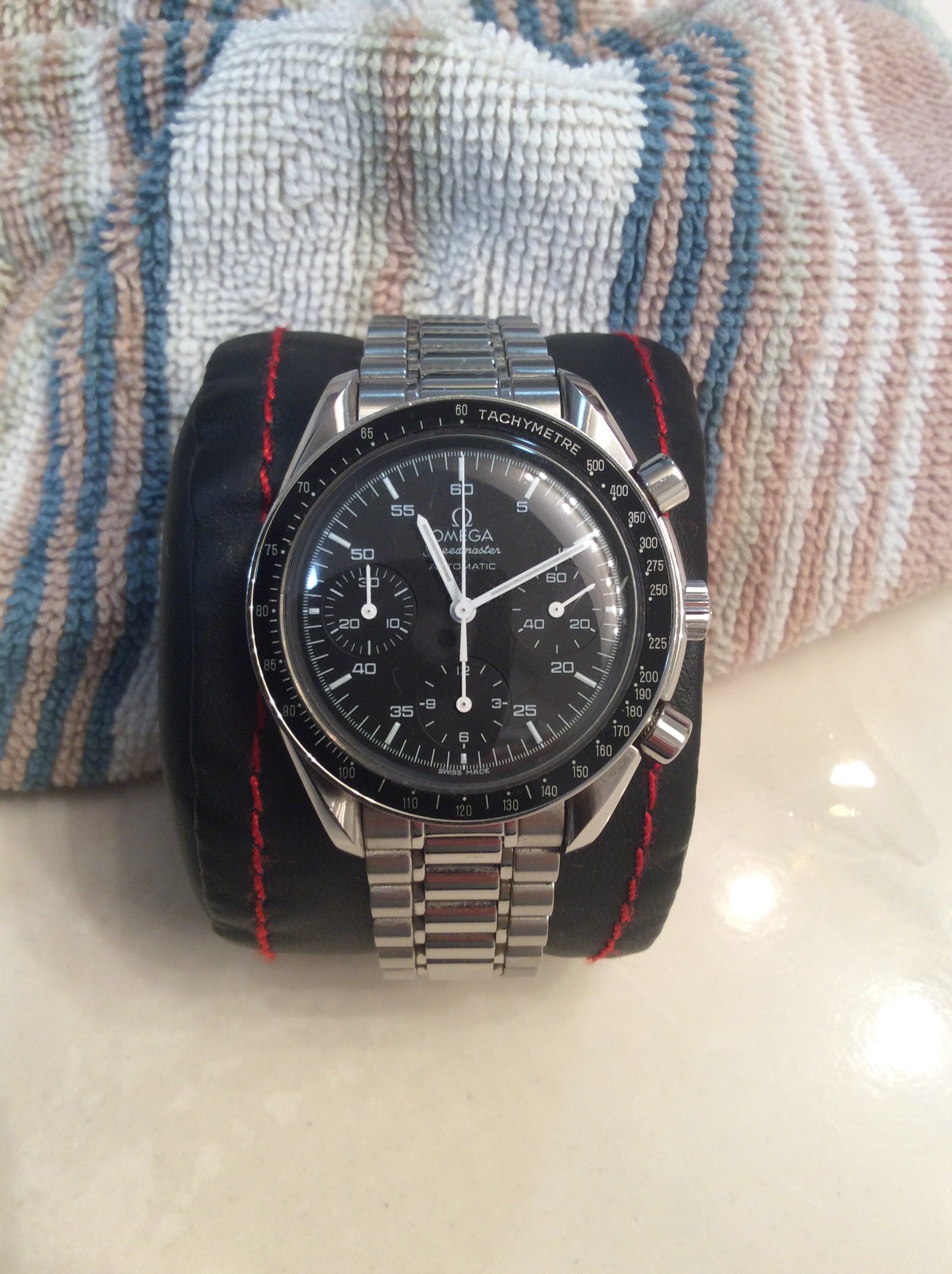

My first nice watch was a Reduced. One of the originals from the 90s. Since then I’ve gotten a couple of Pros.
I’ve had the Reduced serviced once (yes a bit pricey) but now use it as a daily “beater”. It is surprising accurate.
It’s been a good watch

Here she is. About 20 years old
