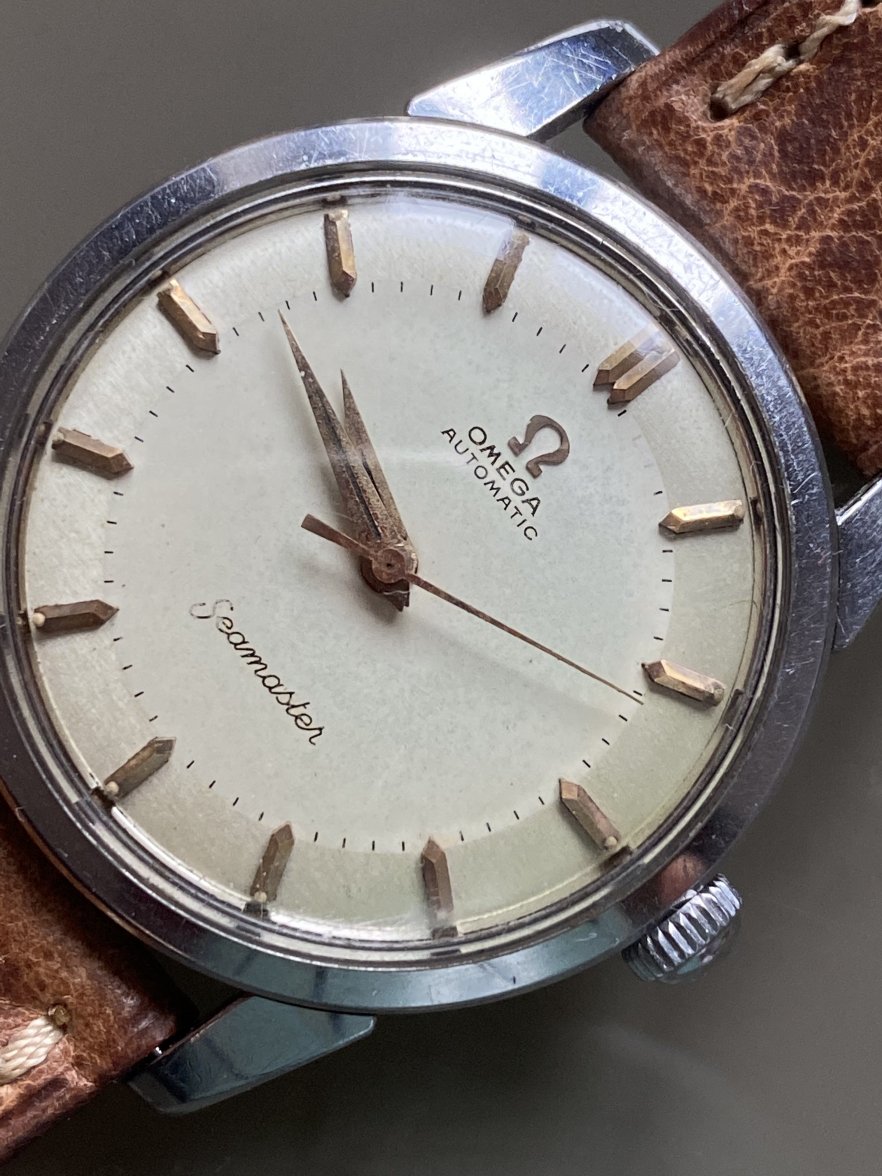

The first one is tiny at under 32mm, were you aware of that? If not that's certainly something you need to pay attention to.
The second at first glance looks reasonably OK, a simple dial, case in decent shape, a movement that looks clean and not heavily worn. Wrong crown. Still I'd say it is expensive, I see it more around €550-650.

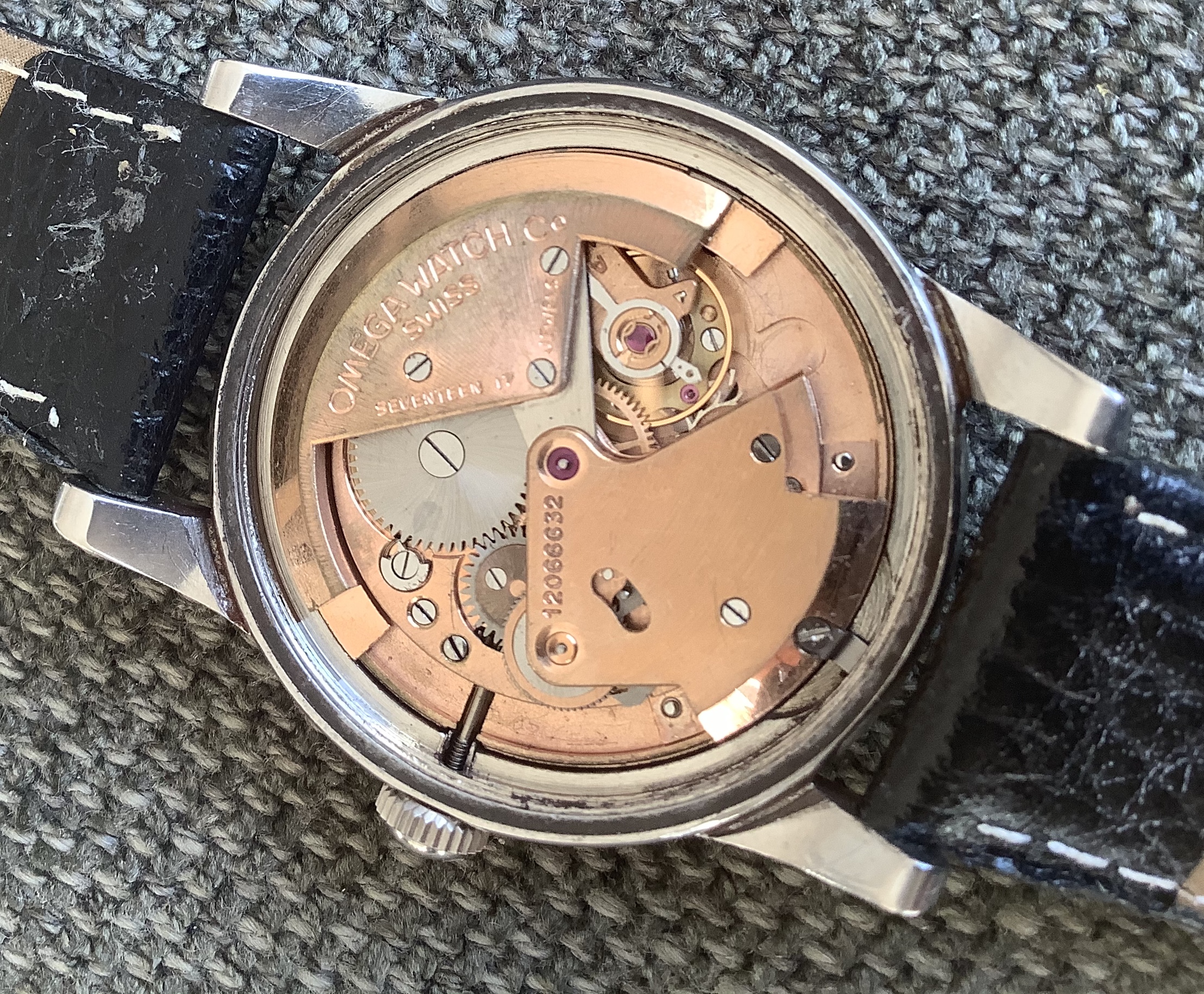

Hello dear @Revo, I’m not very knowledgeable about vintage Seamasters by any means but I recently embarked on a similar search, with slightly different specs, and I found a watch I really like within a few weeks.
With patience you should find something nicer at a much better price than what you posted.
Keep an eye on the sales forums here, and as usual look at all that’s out there, including threads here for research.
Keep us posted.

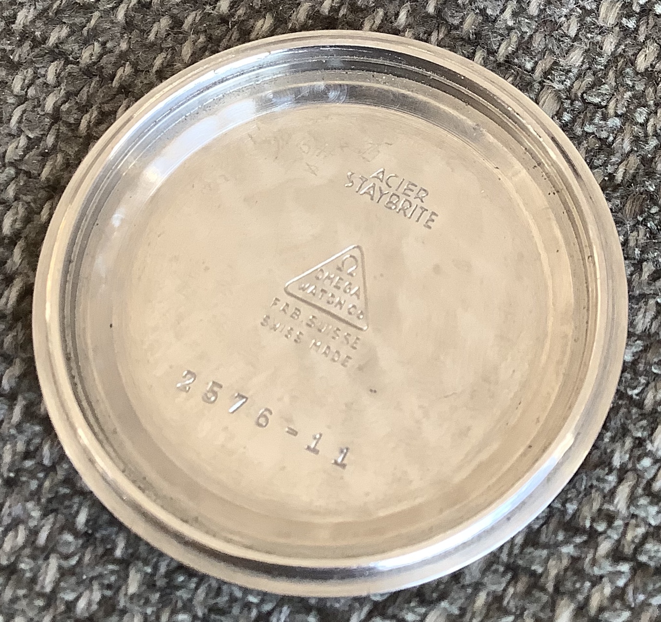

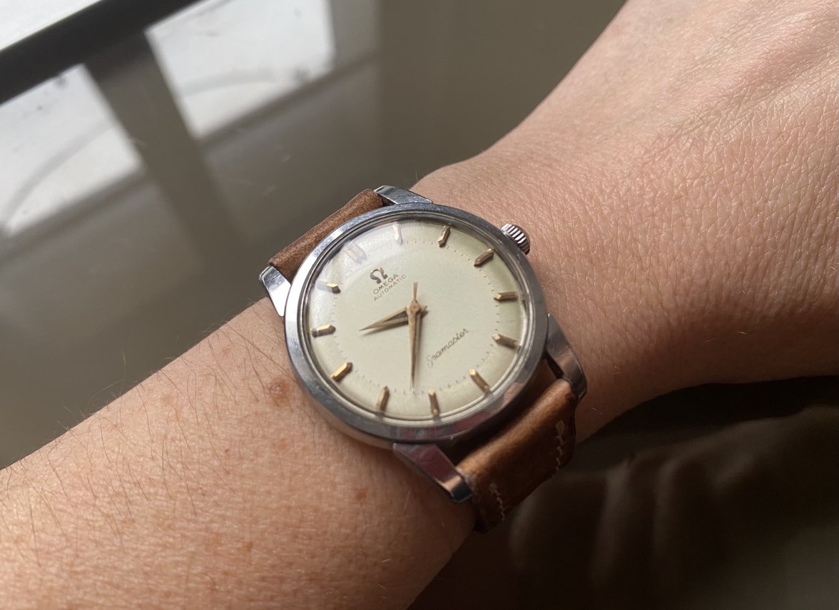

And since the custom on OF is to share lots of pictures, here’s a picture of my recently acquired Seamaster. (34mm, ref 2846 sans hippocampus; and with soon to be replaced replacement crown).

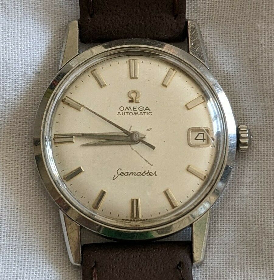

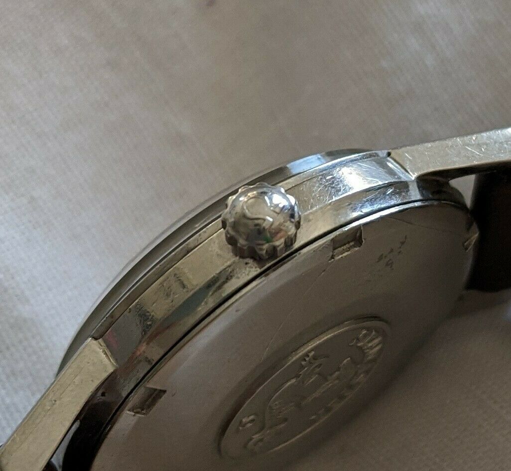

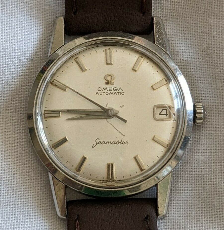

I quite like this one, reasonable price not *quite* what I'm after but I think I could learn to love it:
https://www.ebay.co.uk/itm/1950s-Vi...eamaster-147-60-SC-62-Mens-Watch/174718949418
Also: a forum that allows direct posting of images without a third party hosting site?! Wow. No wonder you guys love pics.
What a great forum; I have had several Omegas in the past (including a 53 FA, 1940 AM Weems and a Bond Seamaster and a co-axial vintage lume thing that I flipped pdq). Always been a fan of the brand; less hype than you-know-who but just as much history, if not more.
7,690
22,055
O. with due respect that scratch on the back and that scratch on the dial are too ugly- you can do better than that.
PS - if anyone out there has a nice Seamaster for @Revo I should disclose he’s a fellow moderator on the Military Watch Ressource forum and you’ll find plenty of references there - although he sometimes has a strange British sense of humor. 😁
4,857
12,285
You guys are great -- what's the catch?! When do I get the bill? 😀
It looks to be original, but dial damage and case condition would be a deal breaker for me and most everyone else.

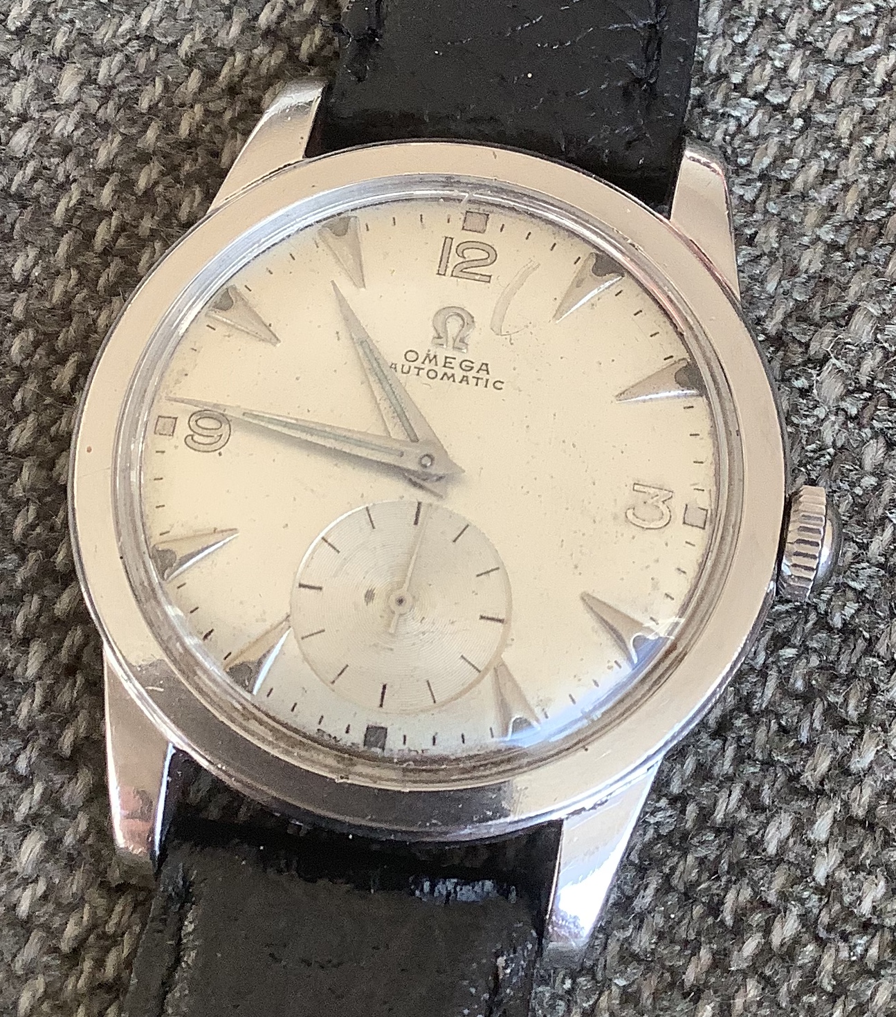

2,597
5,666

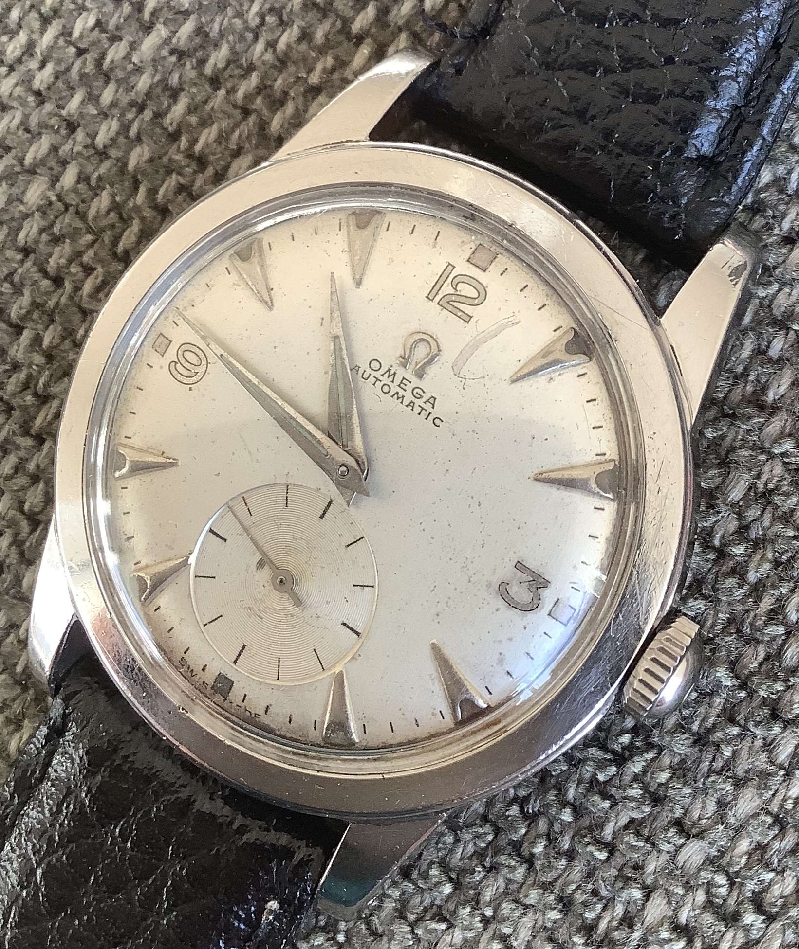

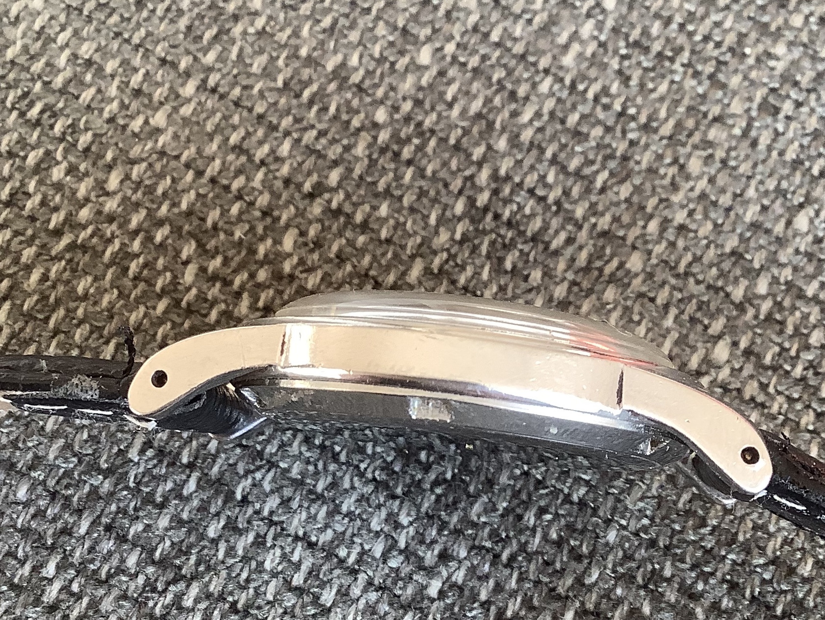

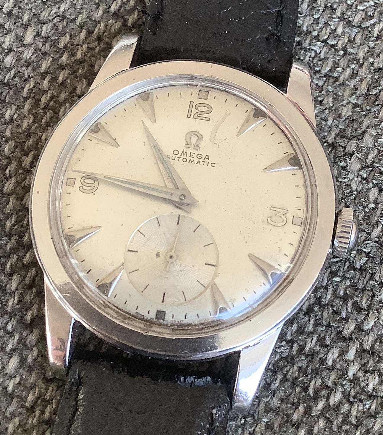

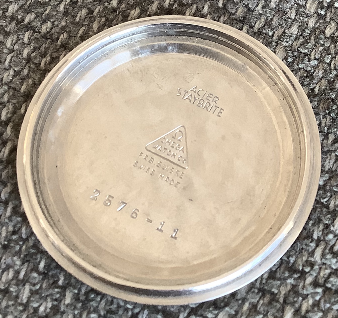

I’d be happy to let this one go O.
Obviously it’s got a dial mark, and it’s far from mint, but it’s all original and I think it’s a nice dial variation. I could do it for £300. No service history though.

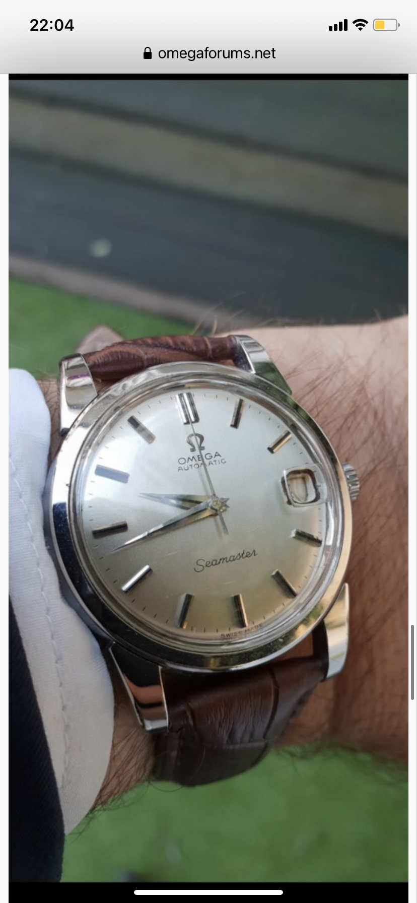

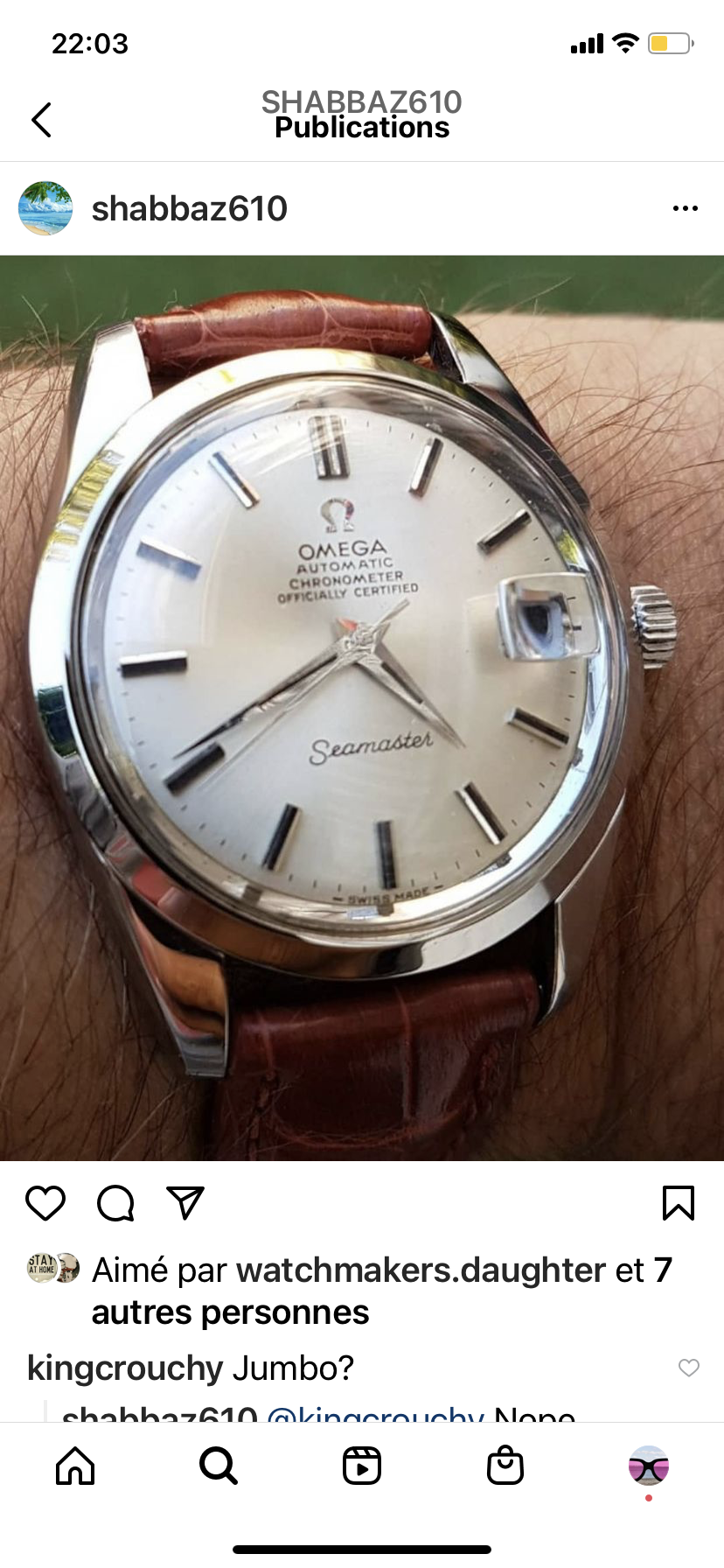

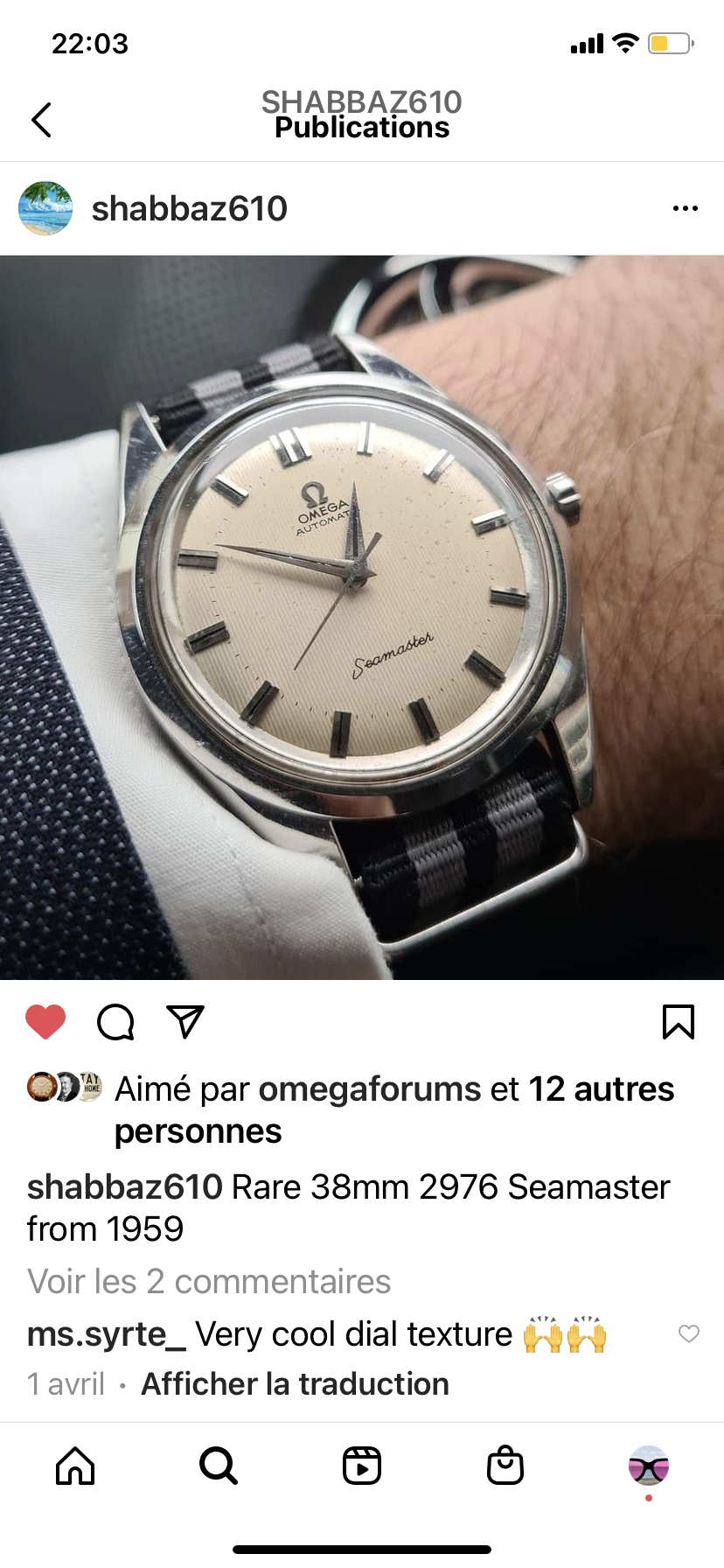

Here’s more cool references posted by @Shabbaz in another thread and on Instagram, 1960s but quite nice -you can also browse the thread below for ideas. It’s also a nice story.
https://omegaforums.net/threads/is-this-right-decision-for-husbands-60th-1961-seamaster.128486/

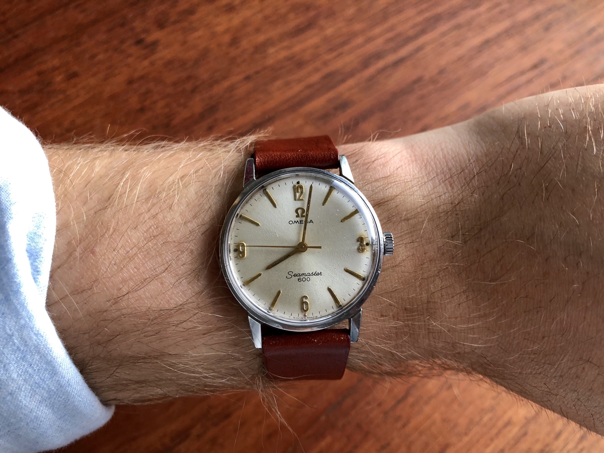

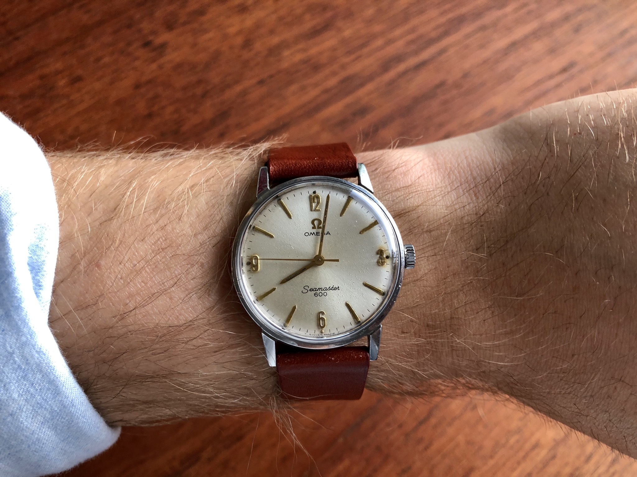

The Seamaster 30 and Seamaster 600 lines have models with the dial variant you are looking for. They’ll be with 2xx or 6xx calibres but nothing wrong with those.
My daily wearer says hi. It’s a bit rough on the dial but I like that I can use it without worrying too much.

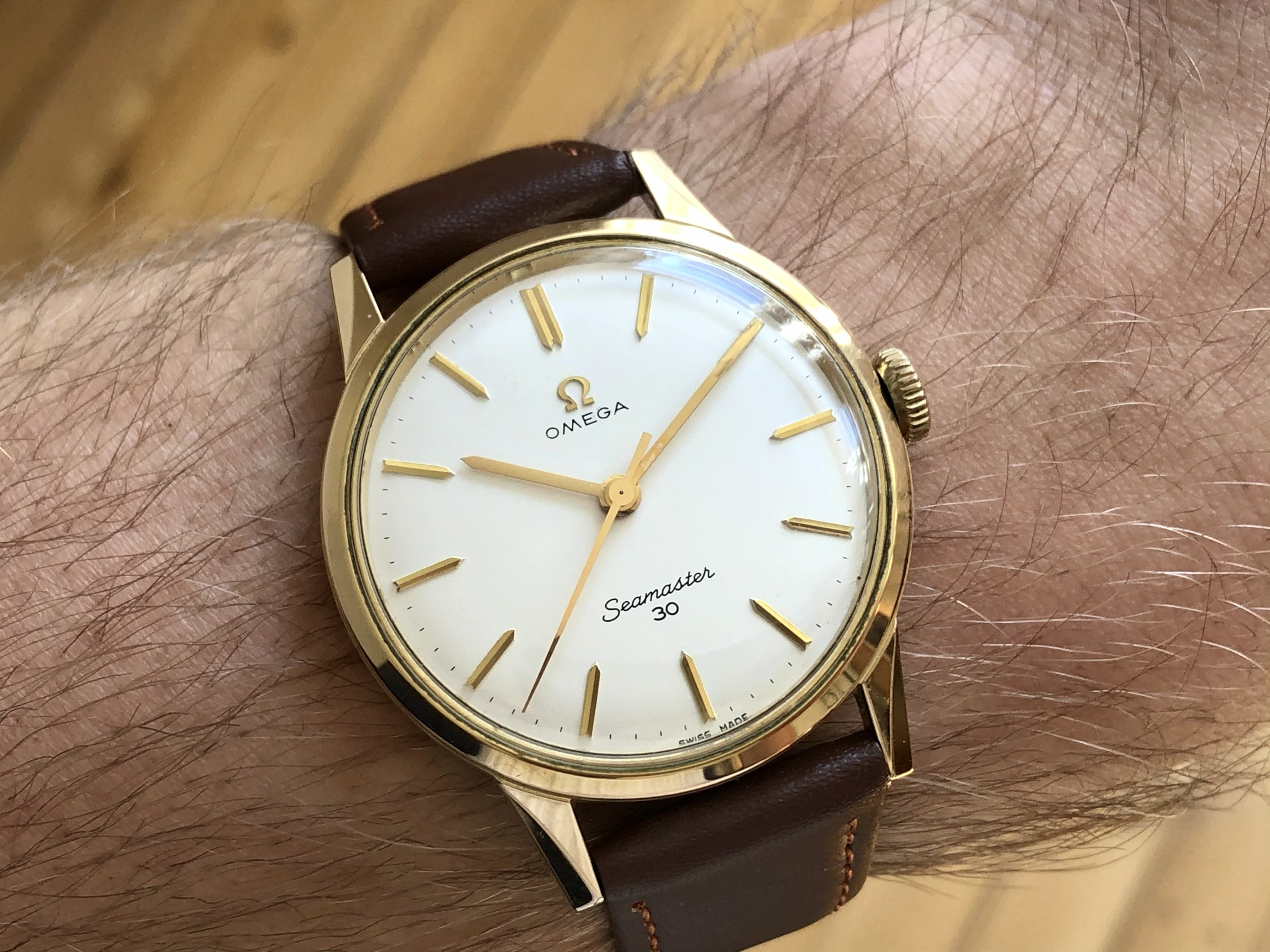

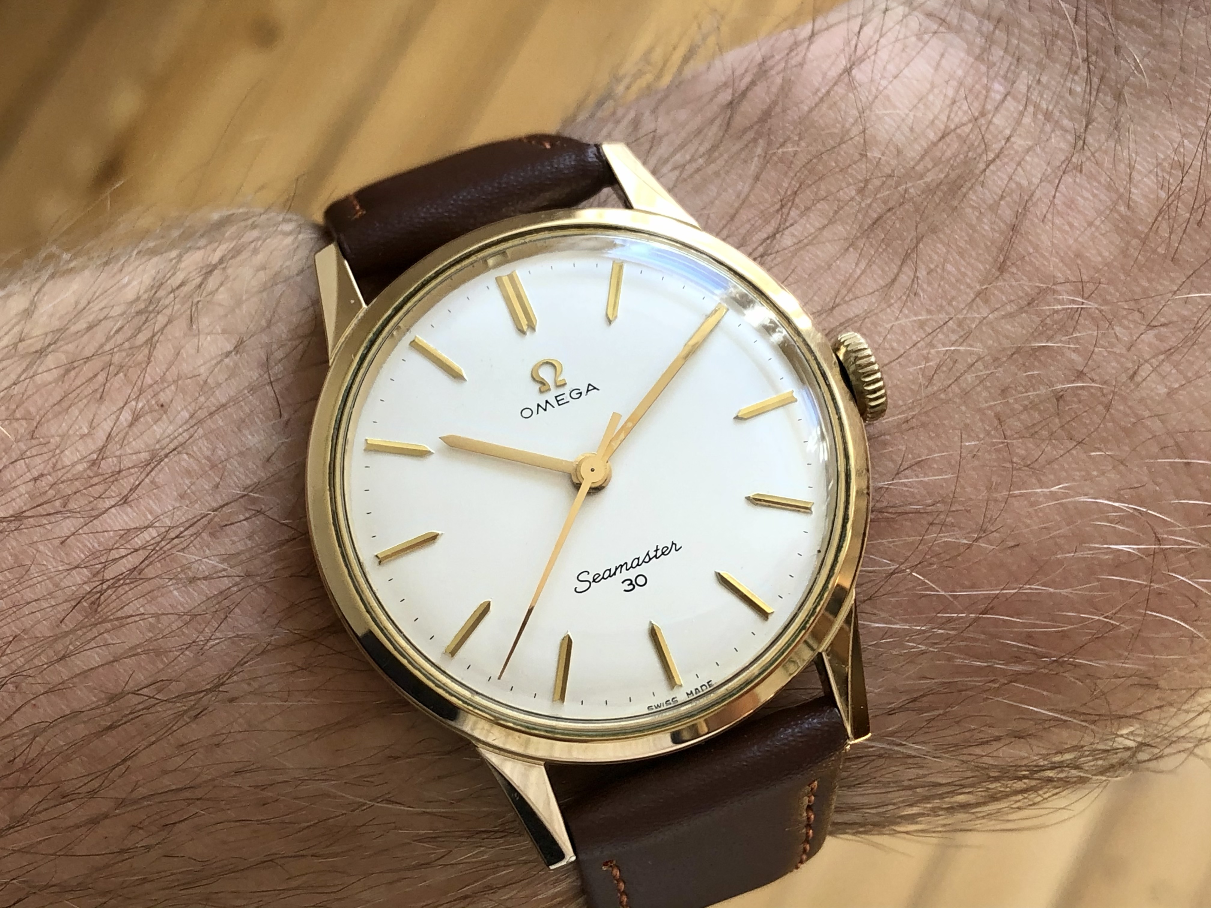

The Seamaster 30 would look something like this (although this one of mine is not in steel and without Arabic numerals).

Thanks! I think I'll hold out for something in slightly better condition but I really appreciate the offer.
