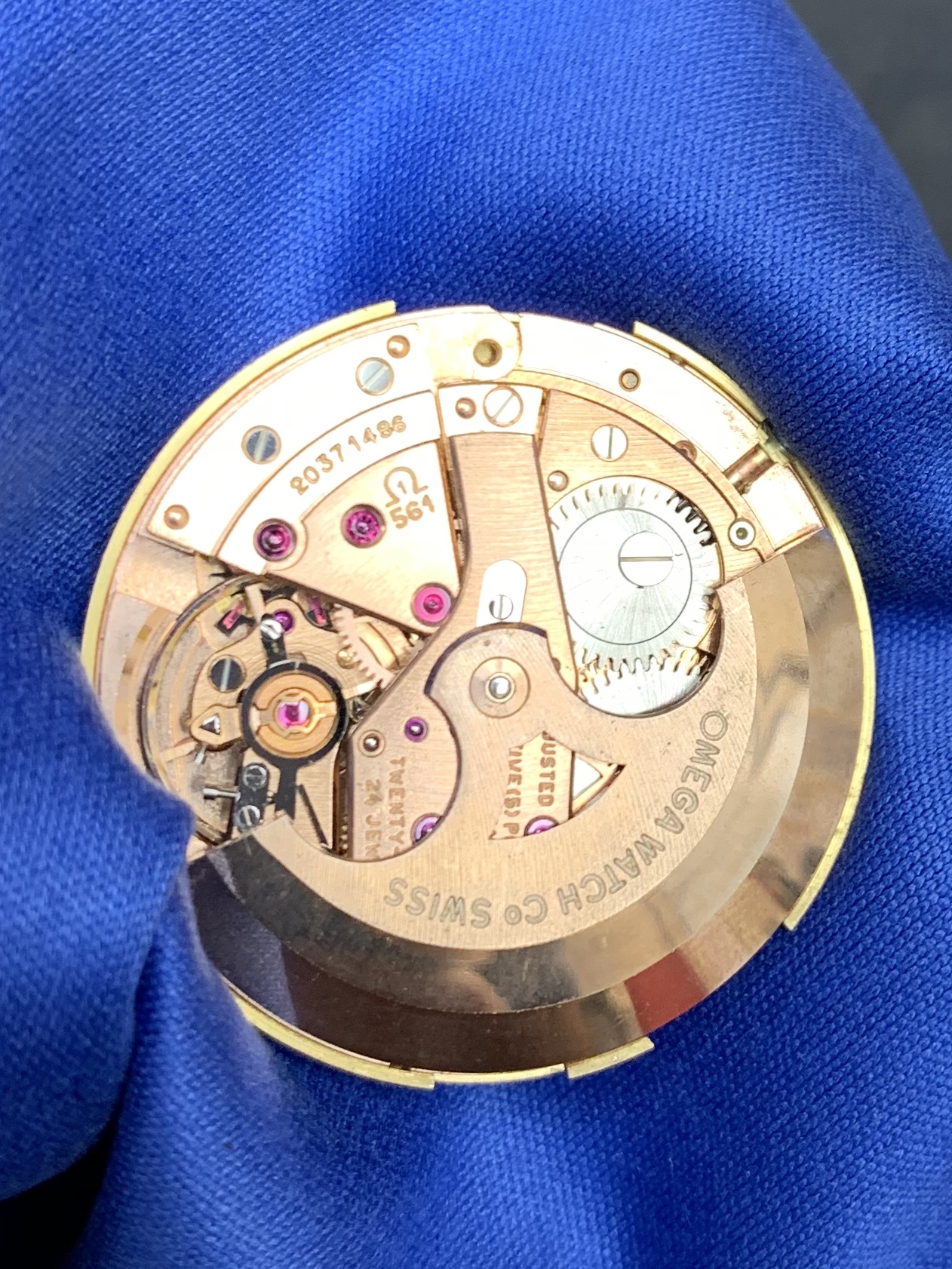

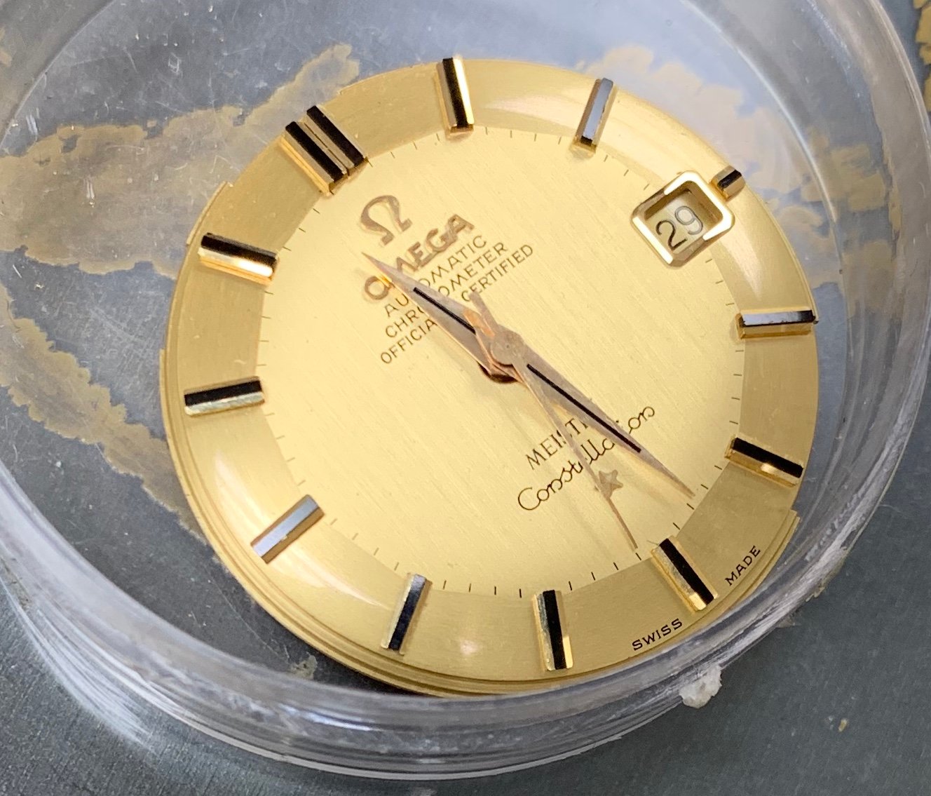

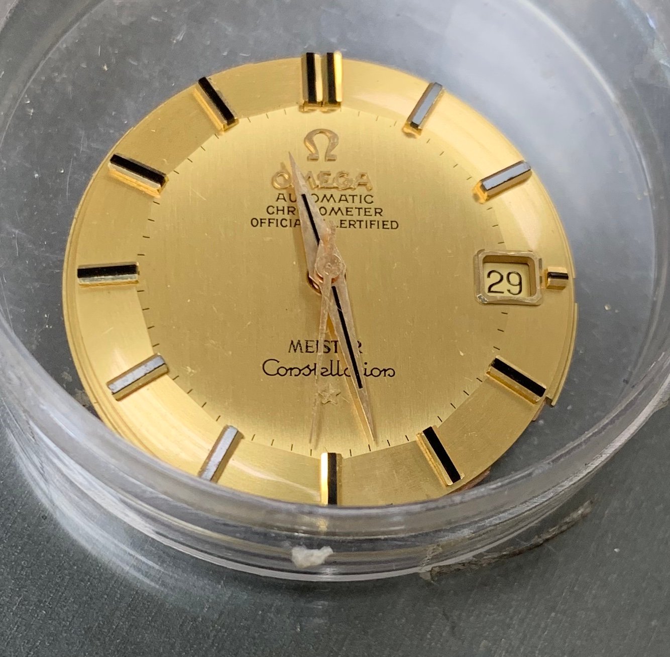

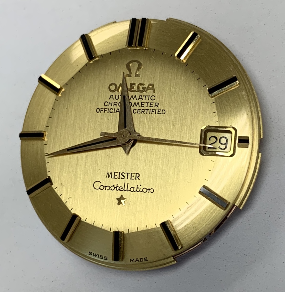

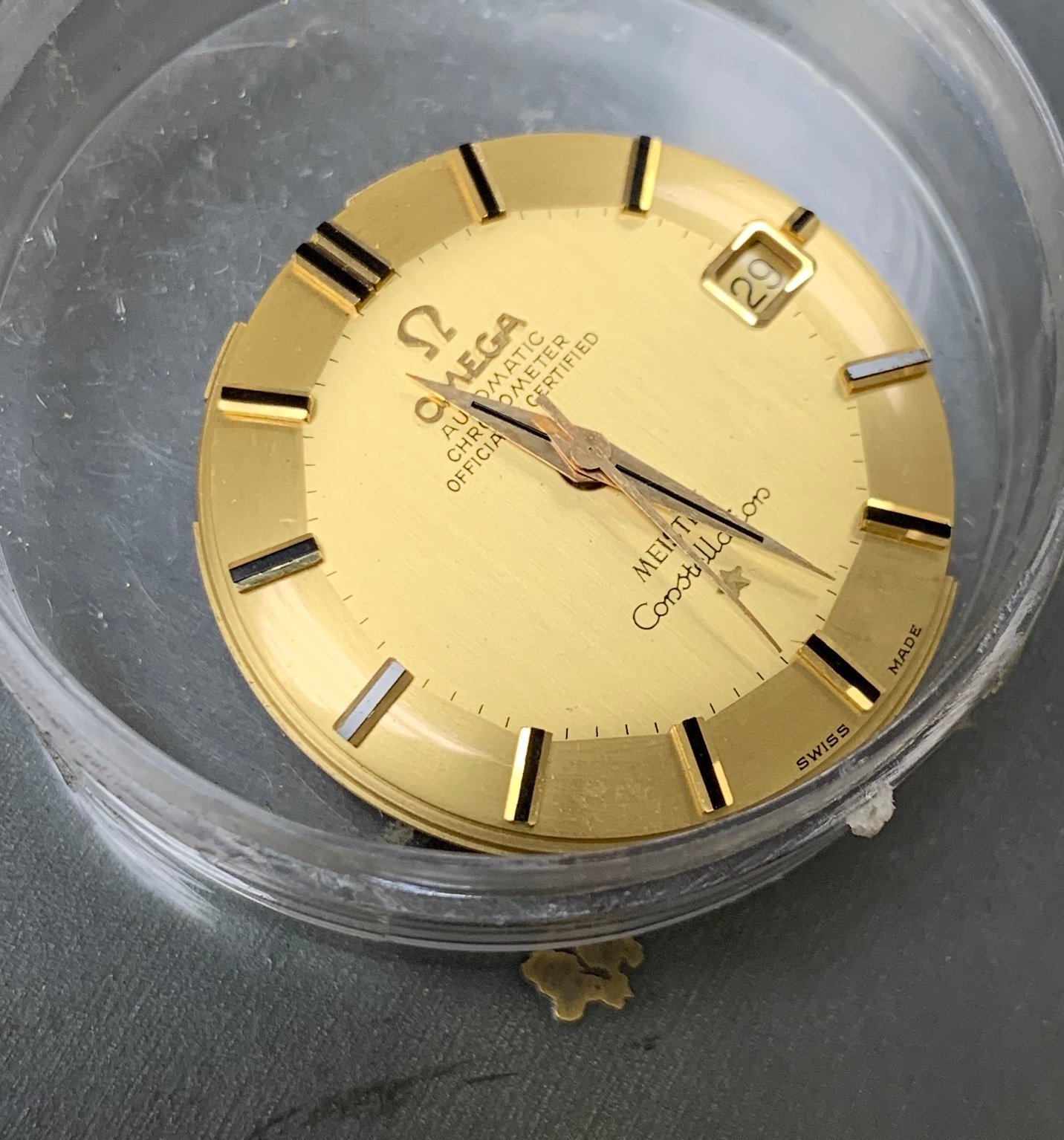

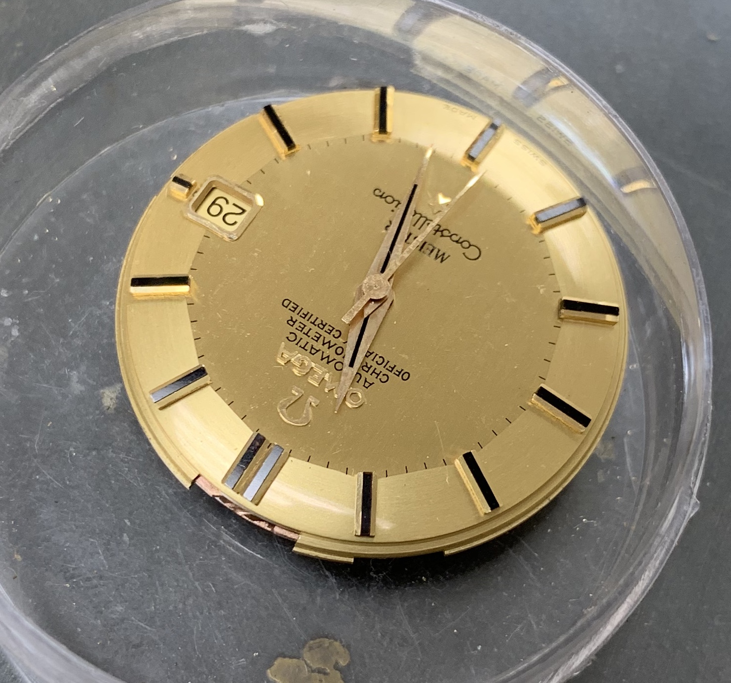

Hello all. A few members have shown interest in this combo and I’m doing research to ensure we all know exactly what it belongs to. My initial search said 168.006, but now I’m not so sure.
For help, I’ve scoured: omega watches.com reference search; omega constellation collector blogspot “de luxe models”; Chrono24 listings; OF website.
Data:
Dial has “officially certified” but doesn’t have ”Calendar”
The 561 movement has serial (20,371,XXX) dates to ca. 1963

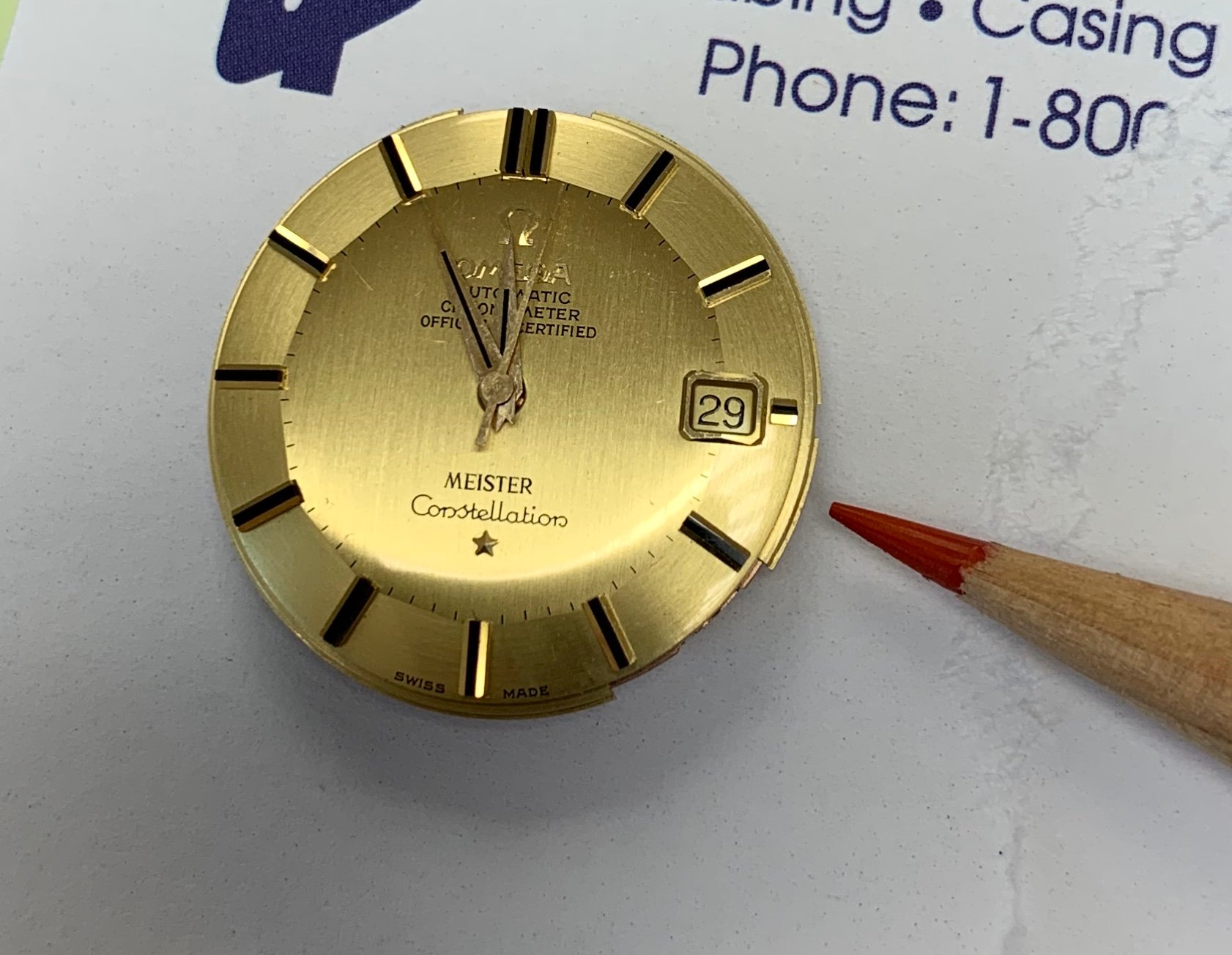

Dial OD measures approx. 29.28mm (measured from outermost edges of dial—I’m trying to point pencil to it in pic.)
The watchmaker recalls the case being solid Gold and being melted (whether correct or not, obviously I don’t know).
While the omega site is nice wherein you can insert a reference, a number of the models it presents are just pencil drawings. Also, I know that there are any number of dial varieties within any given reference.
Any help is appreciated!

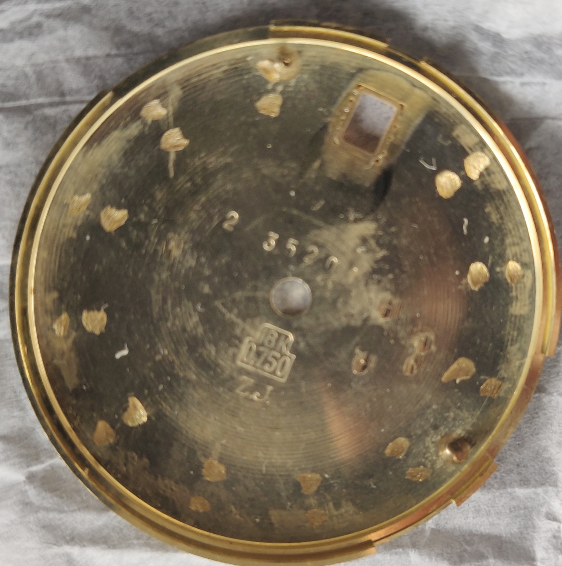

Have you removed the dial from the movement to confirm that is it solid 18K? There should be a hallmark on the back of the dial.
Could be a dial from one of several early Constellation DeLuxe models:
https://www.omegawatches.com/en-us/vintage-watches?v_watches_calibre=3066
My suggestion would be to look up the case references from the above link in Google, and choose "Images" to determine which one is closest. But bear in mind that the same dial could have been used for several similar references.
Then again, Ref. 168.006 might very well be right.
https://omegaforums.net/threads/18k-constellation-türler-pie-pan-is-this-beauty-not-a-bargain.11377/
Hope this helps,
gatorcpa
3,790
6,452
Don't need to remove the dial. 100% of dial in that color with large onyx inserts hour markers are 18 k gold.
It will fit into a 168.006 case to be a correct combination .
13,676
19,044

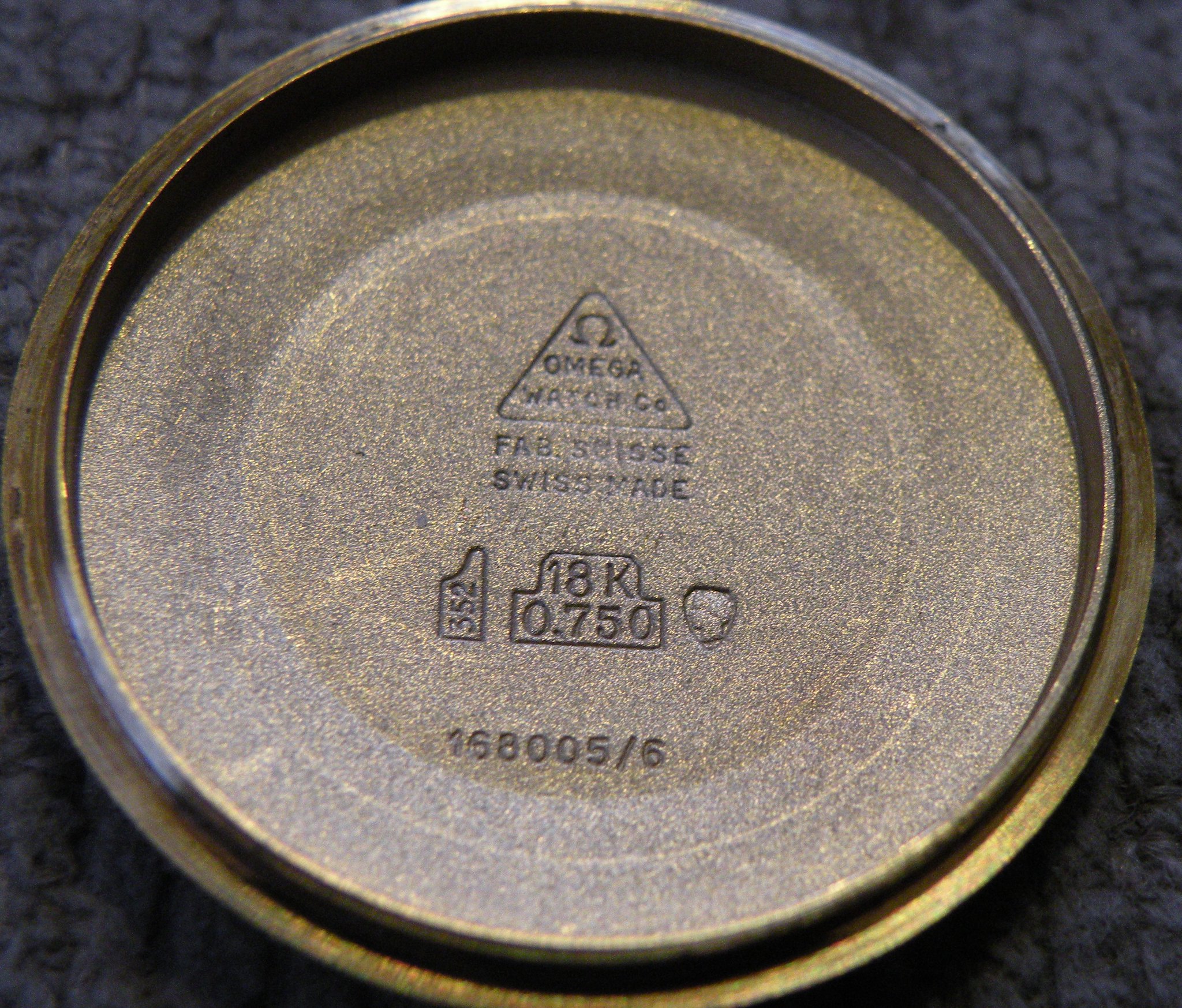

Actually, these cases are marked 168.005/6 because they are used for both models.
conniegoldmvt-jpg.43417
The 18K gold dial separates the .006 from the .005.
gatorcpa
Yes. It looks like this
And 168.005 is correct for a normal dial
And 006 is for 18k dial.

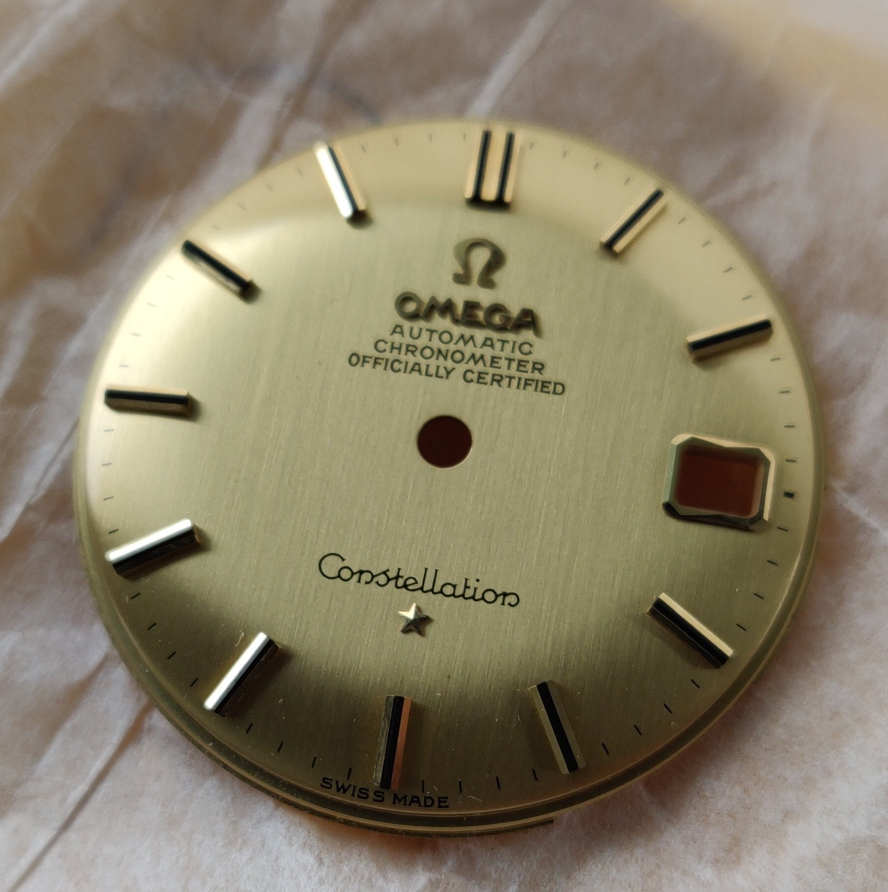

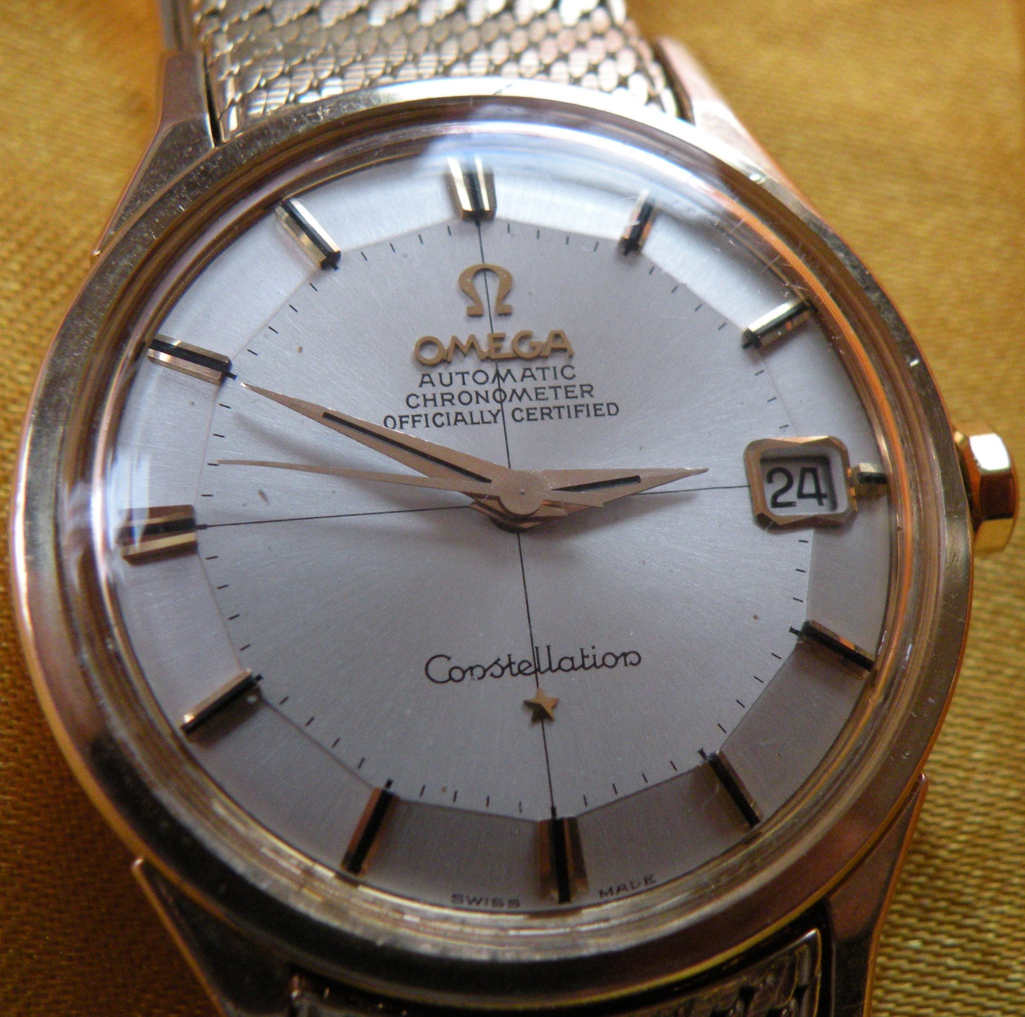

Do you know, I hadn’t previously noticed the style of onyx inserts on the OP’s dial
Flat top surface instead of the usual prismatic shape.
Less finesse perhaps but they do give the dial something of a robust presence.
Just checked my 14382 dome dial deluxe and it has them too 😀:facepalm2:😀
Were these large flat inserts a feature of the gold dials of the time @hoipolloi or do you know if they ever appeared on other non-precious dials too?

Great dial and movement, I really hope you find a case. So many have been converted to bullion, perhaps yours was too 🙁

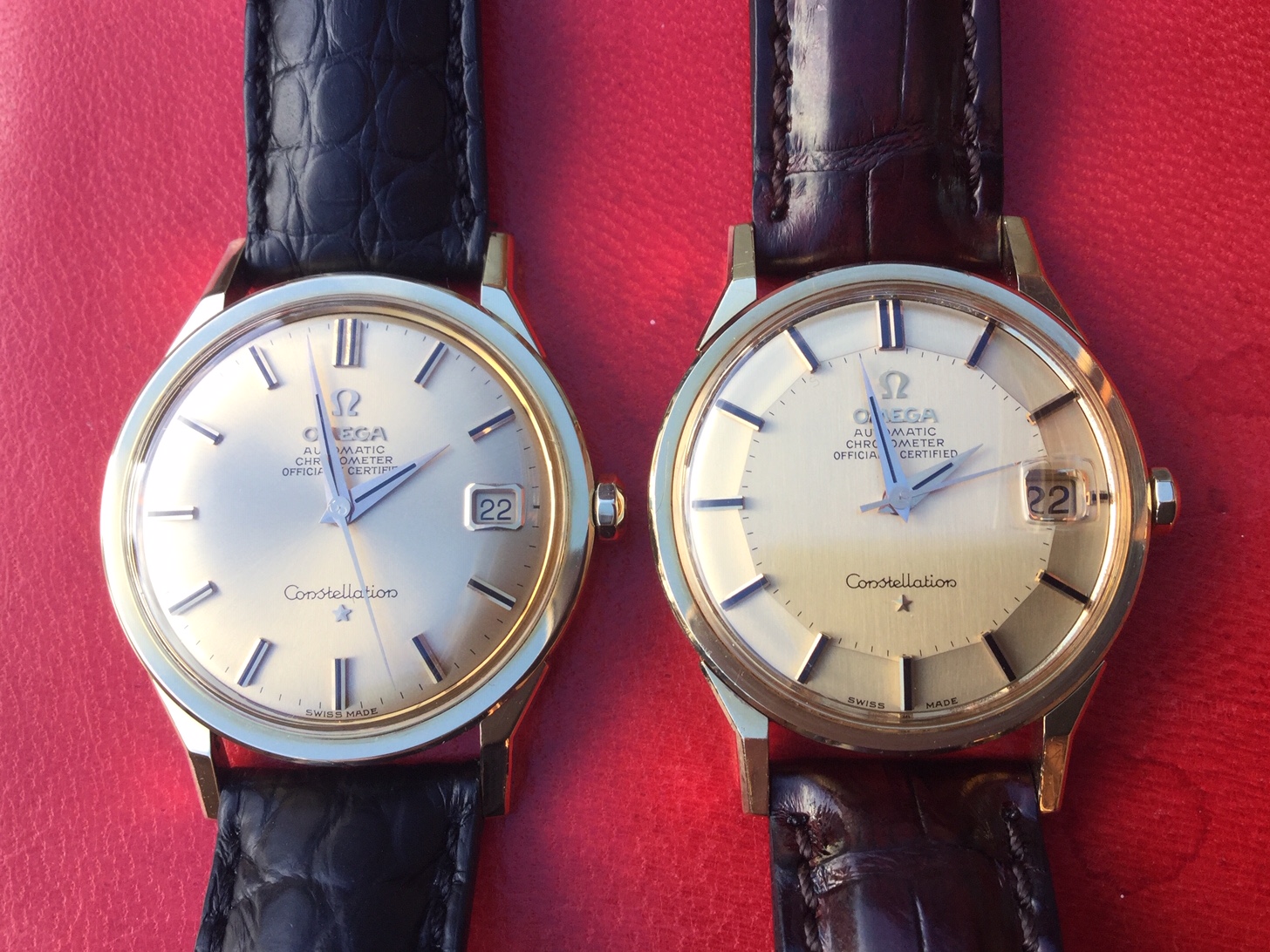

No, I haven't seen them on a non-precious dial yet.
(these large inserts are always on 18k pie pan dials.)
On 18 k domed dials, Omega also used small inserts.
A friend of mine (a watchmaker) has removed and tested, compared and said they ( small and large) are made by different material.
Large are straight, hard and cannot be bent.
Small are softer and can be bent.

I'd never noticed this until you pointed out.
