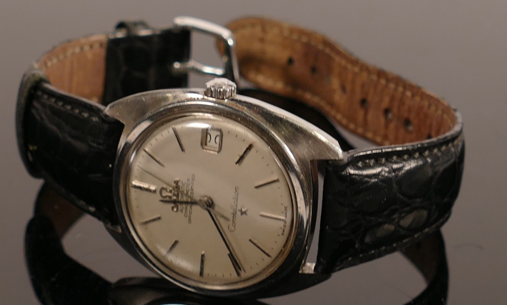

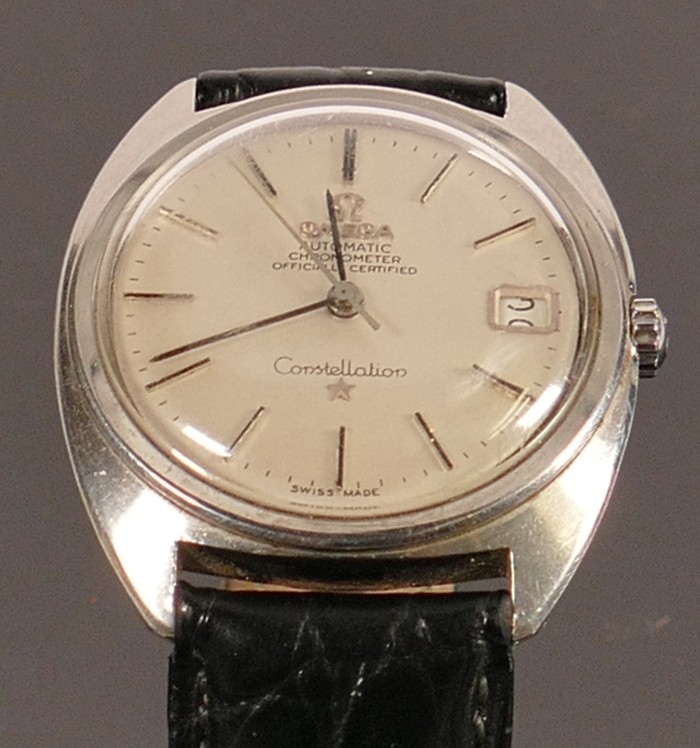

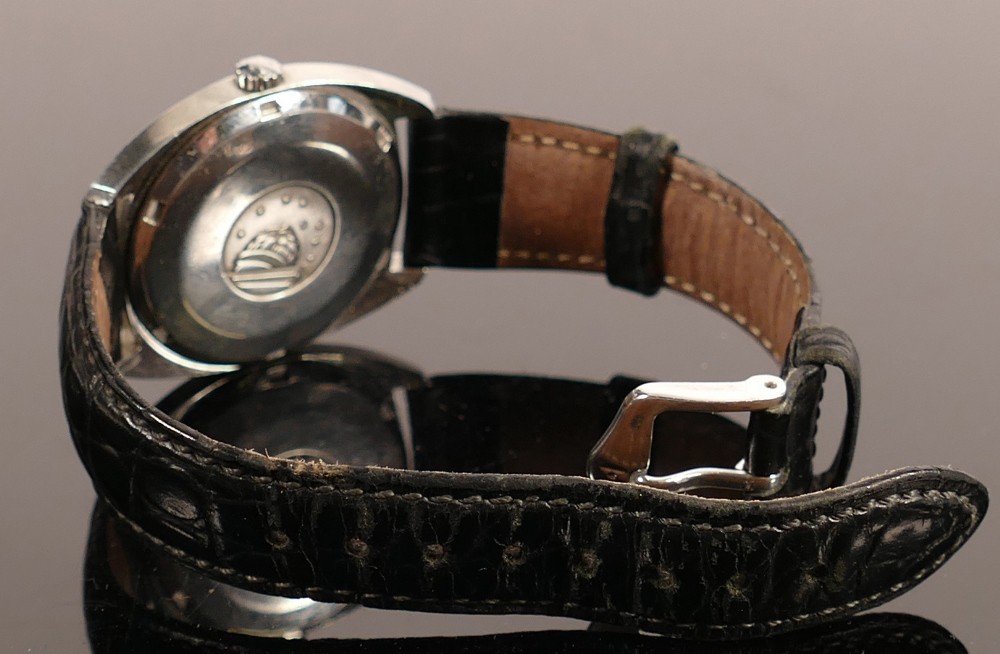

Seen this constellation on an auction site and just wanting to test myself really. I'm looking at the font on 'Automatic' & 'Chronometer' and seeing straight M's and pointed A's. Normally a red flag which would suggest redial, but is this the case with all connies, or only connies of a certain age?

C-case have some various dial variation, but this one is probably a redial from what I can see
15,046
24,049
Poor photos but the noticeable problems are the m’s and the Swiss Made misalignment. The A’s are not necessarily a problem if the rest had looked OK.
Ordinarily a good quality C-case is quite precise.

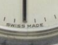

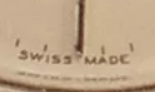

How is it misaligned? The outer edges are aligned, and "Swiss" is wider than "Made" so I wouldn't expect that space to be centered. The WatchCo Seamaster 300 I'm wearing is the same way.

"Swiss Made" should be centered under the 6:00 marker. Not "Swiss" on one side and "Made" on the other.

The "n's" in Constellation are not correct, also

MOY test? Hate it when they cover up the writing with hands. Suspect.
There are like 5-6 valid "Constellation"s in C-Case though, at least, one of them has almost identical and not too curled n's like this dial, whoever re-dials these chose the worst kind to copy as it's kinda rare 😁
Though as @redpcar pointed out the Swiss Made gives it away
