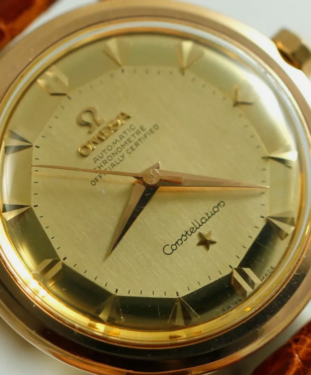

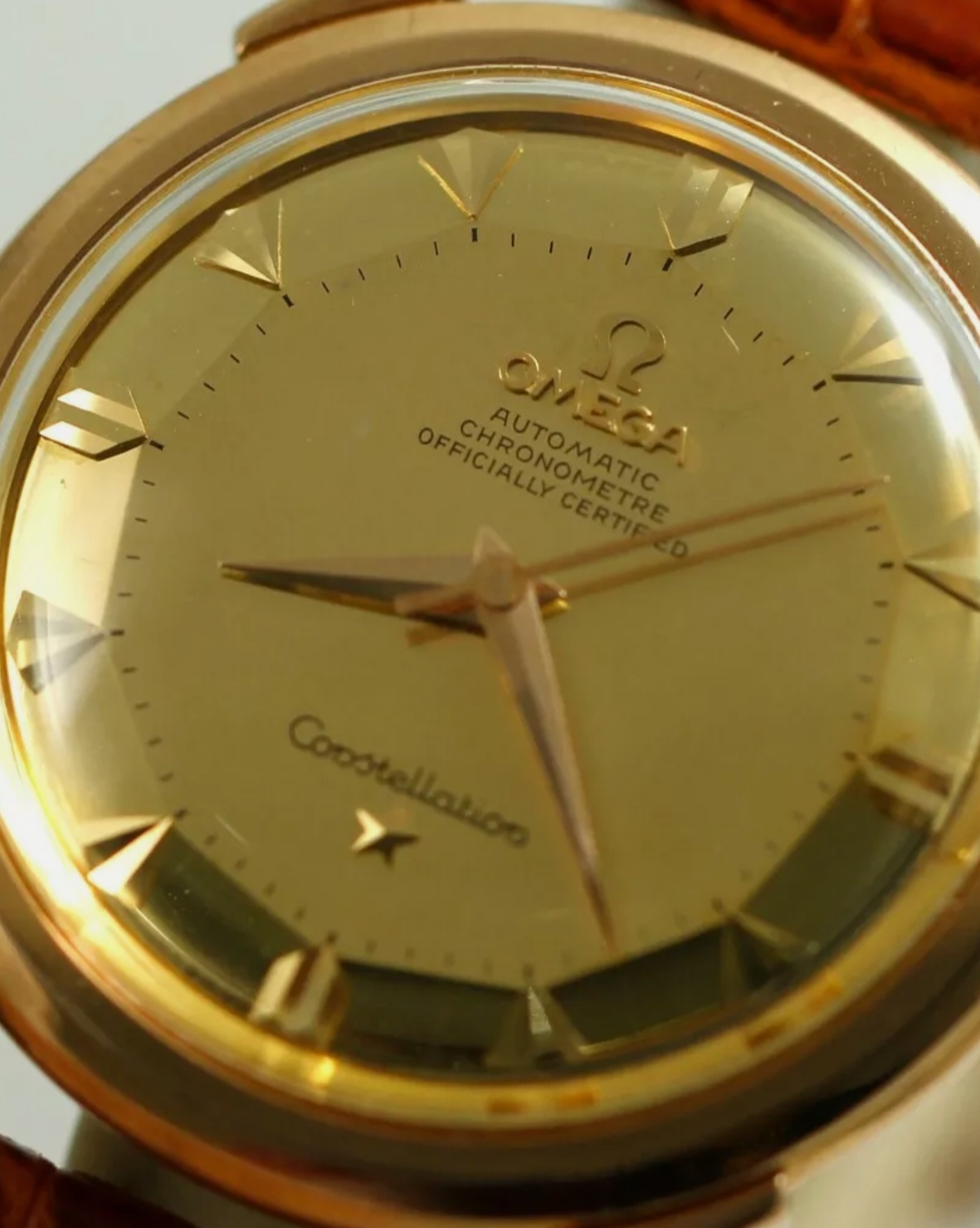

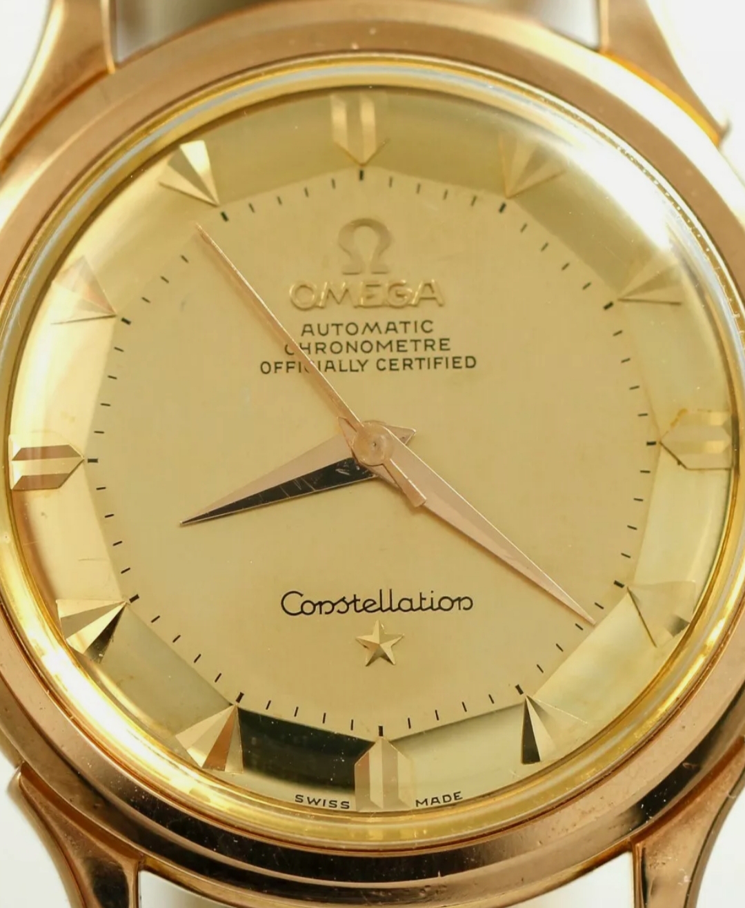

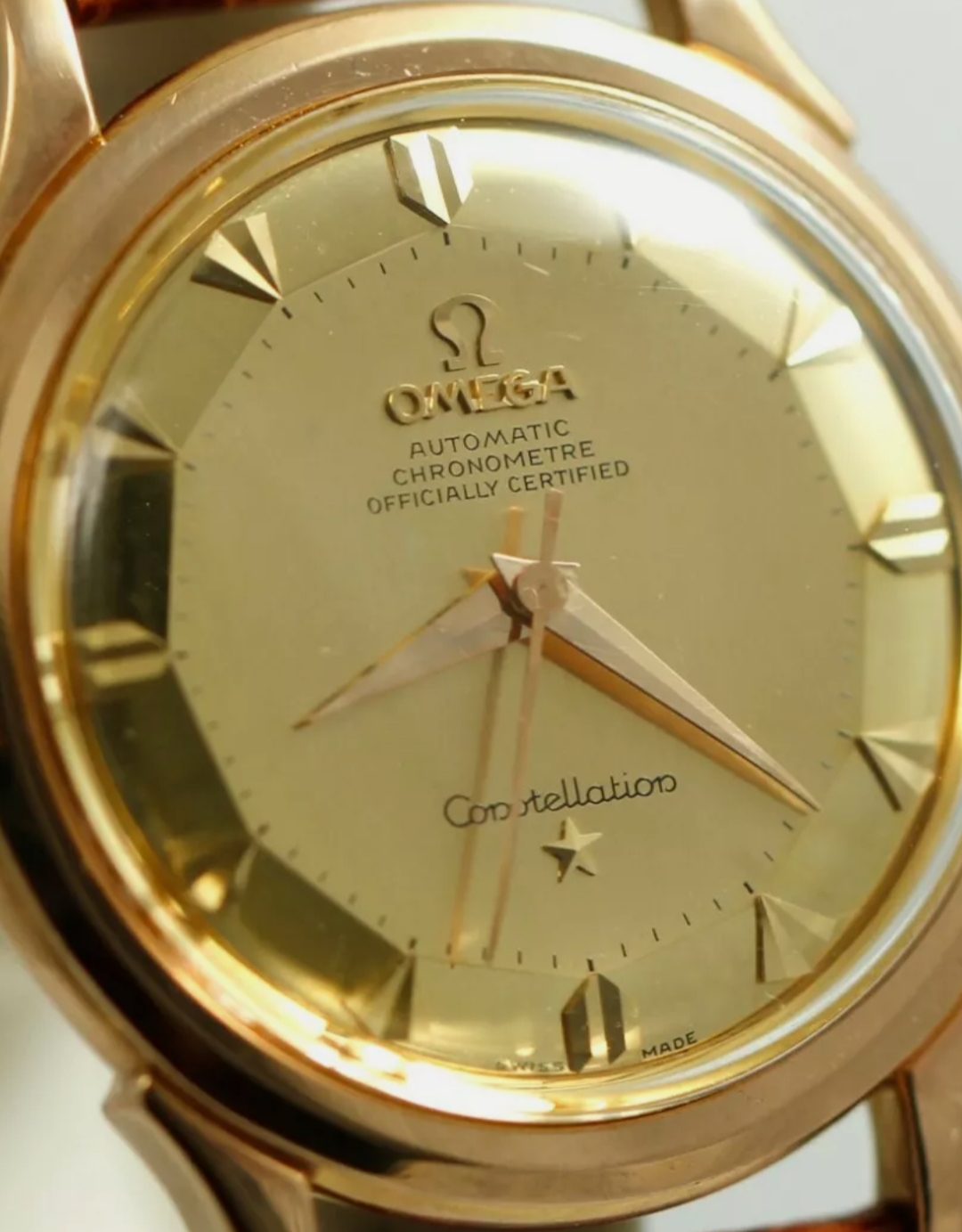

Hi guys, I want to consult the brain trust here before putting any bid in on this Connie I spotted on ebay. The listing states that it's not been touched. I'm on my phone and am not seeing anything that jumps out at me as being wrong. I am mostly asking for piece of mind because my spidey sense is saying that it's possibly too clean. This watch ticks all the boxes for me, rose gold case, arrow head markers, pie pan dial. I want some input that isn't corrupted by lust.
https://www.ebay.com/itm/VINTAGE-OM...2349624.m46890.l49286&mkrid=711-127632-2357-0
3,596
13,551
While I don't see anything on the dial itself that'd bother me (maybe except for some smaller imperfections), it's listed as a YG dial in a RG case / with RG hands. Happy to stand corrected, but I've never seen this combination before and I'm sceptical it left the factor this way.
6,685
11,654
No go for the YG dial in a RG case. The exception to this that I've seen is the centenary.
4,402
13,115
Thanks guys, that's something that gave me pause when I first saw it myself, but just figured I hadn't seen enough variations yet.
