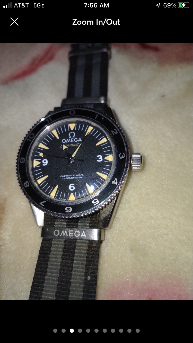

I’m looking at a Seamaster supposedly 2012.
I nowhere near as knowledgeable as most of you. Can anyone take a look and help determine if this watch is legit or not? I appreciate any and all help

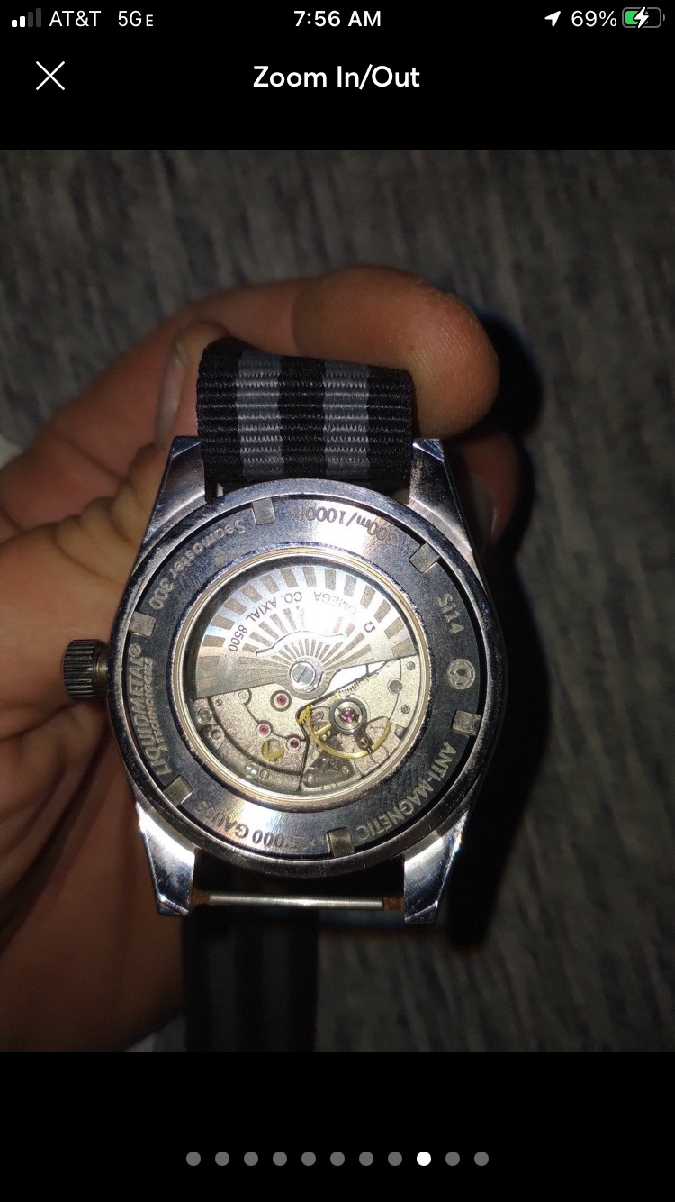

I think if you look up pictures online of the 8500 movement you might notice a few things
718
730
That is wrong in so many ways, but the obvious signs: movement, 12hr bezel that makes no sense, and "Master Co-axial Chronometer"

Additionally compare the general quality of the text on the back on the watch to any other Omega…
It’s supposed to be the Bond Spectre bezel, but yeah there is a lot going on with that watch.
Ah TIL... I wasn't aware of that watch. The real sample says "Master Co-Axial Chronometer" too.
Now I'm wondering how many dials Omega printed "Master Co-Axial Chronometer" before they changed to "Co-Axial Master Chronometer".
EDIT: Did some googling, so "Master Co-Axial" was for anti-magnetic watches before Omega started getting METAS certifications for "Master Chronometer". Learn somethin new every day, love this hobby.

thanks for the help.
I figured it wasn't right

One other dead giveaway that this is a fake (besides the obviously fake movement) is the quality of the NATO on it - that is nowhere near the quality of a real Omega NATO and pretty clearly fake. Even if you didn’t see the other signs and thought the watch head was real, you’d have to wonder why they would have a fake strap on a “real” watch.
