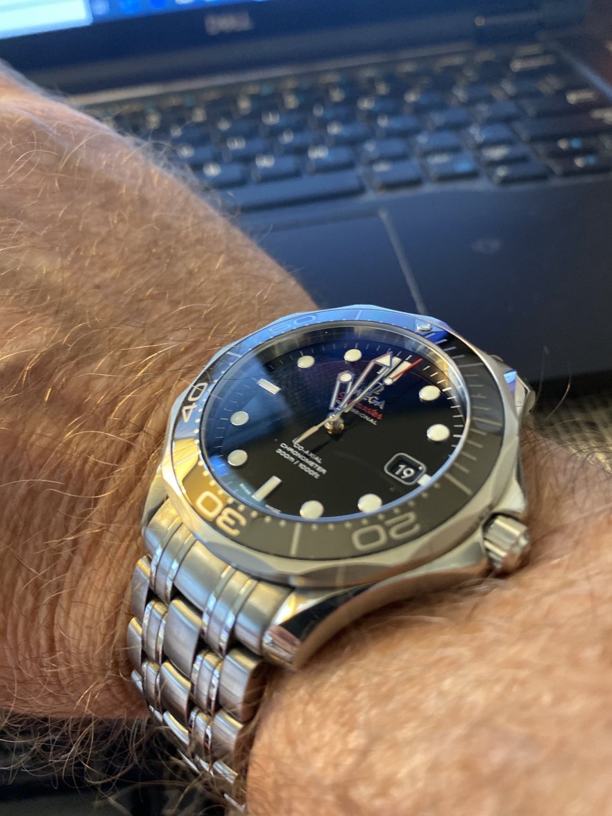

You can remove it with polywatch and some effort. That being said, the AR coating is tougher than you might think. My SMPC is my daily wearer. I've had it for several years, banged it on door frames and a few other mishaps, but the watch and the AR coating still both look new. When you clean the crystal, make sure to use a dampened soft cloth. I use an eyeglass lens cleaning solution and a microfiber cloth.

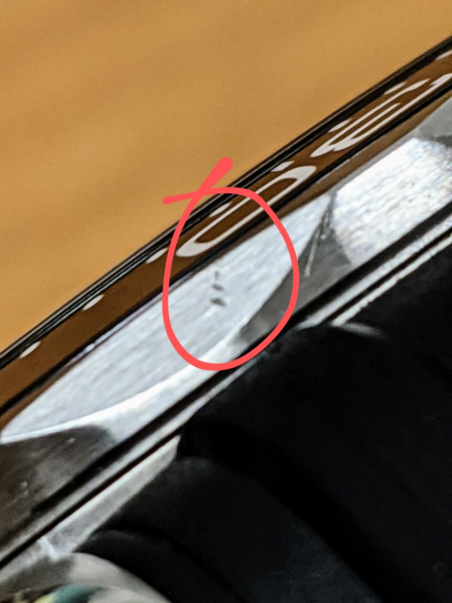

Already started on the steel!
I have a gnarly scrape on one of the scalloped edges. We live and learn right? Honestly, I'm just happy with the Ceramic bezel insert on my diver 300m so that thing is rock solid.
