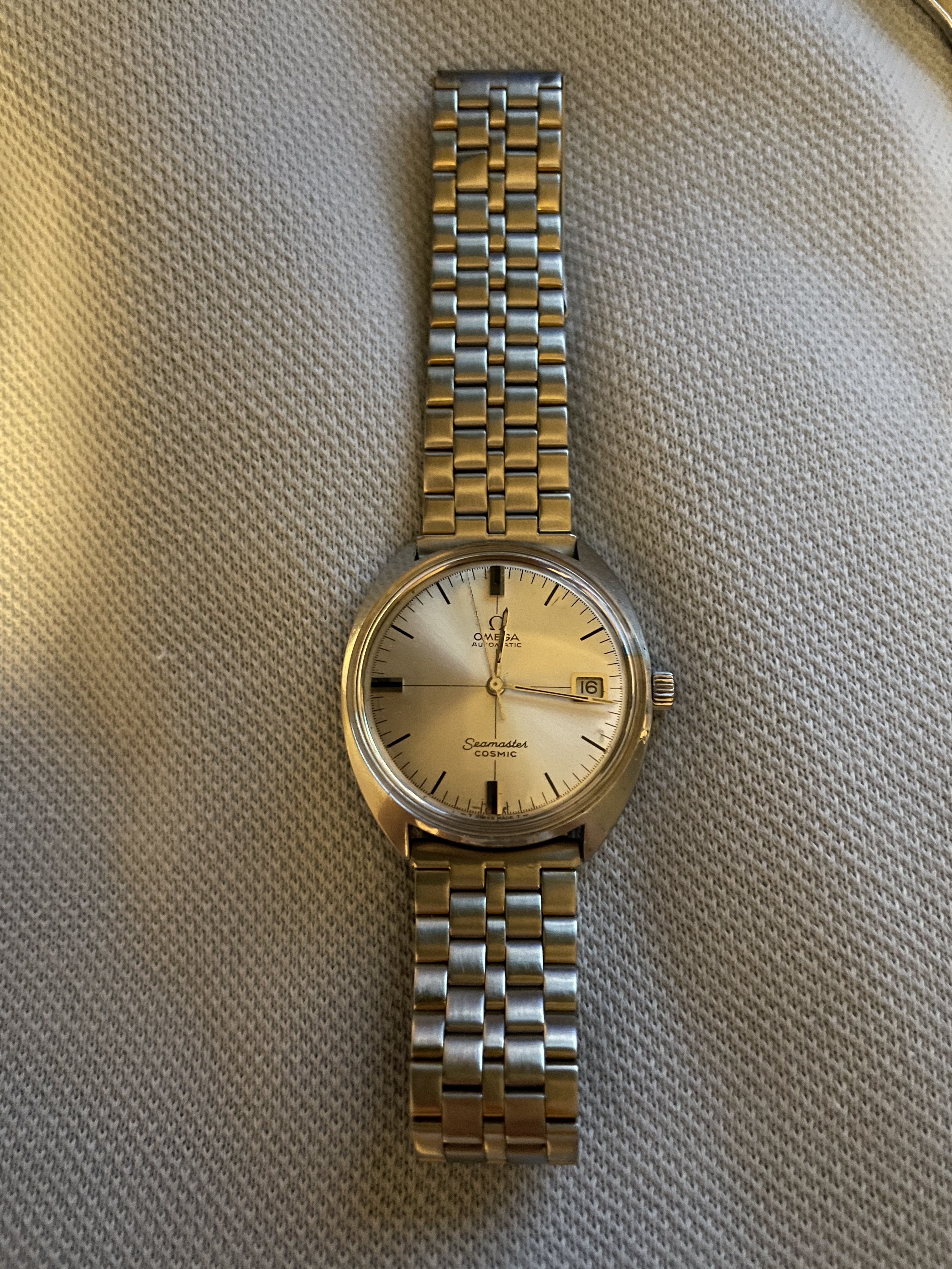

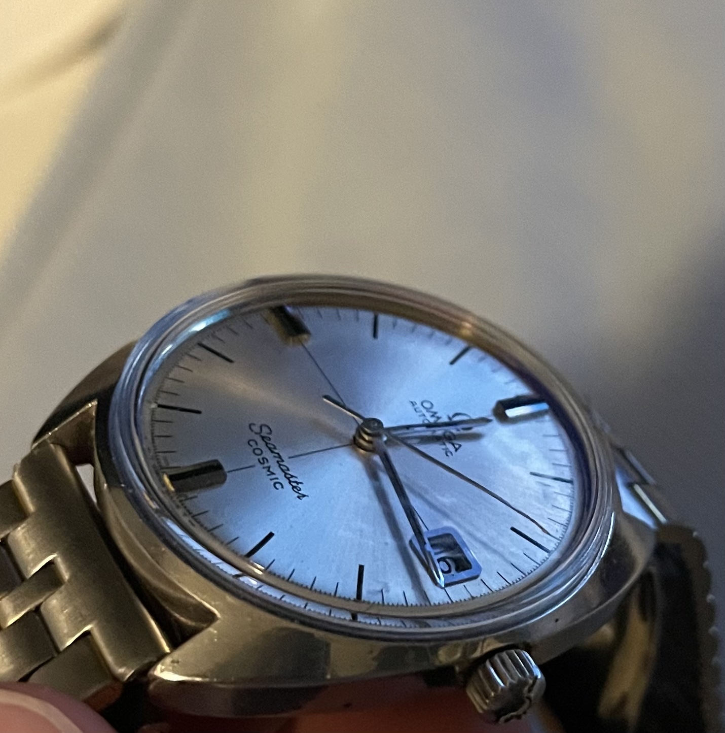

I recently bought a vintage Omega, my first vintage watch, online from a private seller. When I recived the watch and adjusted the time the entire face turned back and forth as I turned the crown. I contacted the seller and he said this was common with the cosmic. Is this true, or is my watch a piece of junk?

Maybe the case clamp got defected and couldn’t hold the movement. If you like it, just take it to your local watchmaker and they should be able to fix that.

Often the replaced crystals weren`t the right ones and in that case the movement with anything on board isn`t hold tight properly.
The contrary is that while installing the wrong crystal the dial is damaged beyond repair.
As a bad example:
http://www.ranfft.de/uhr/info-kva-e.html
If the amount of money you`ve paid was low enough I suggest to keep the watch otherwise get a refund.
When keep it take her to a watchmaker who knows it`s job.
I zoomed in your picture and yours has its dial damaged also to change it could be expensive a new crystal was forced in with the wrong tension ring which caused that damage.

Although I would take any repair advice from Roland (who says the movements fine but has the wrong lift angle on the timing machine), the point about the incorrect crystal is right.
