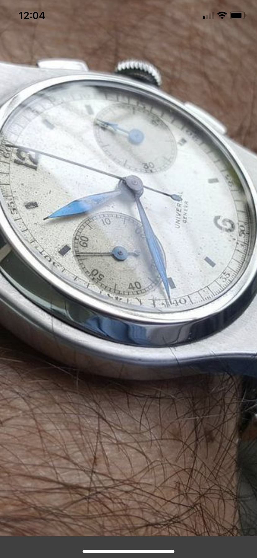

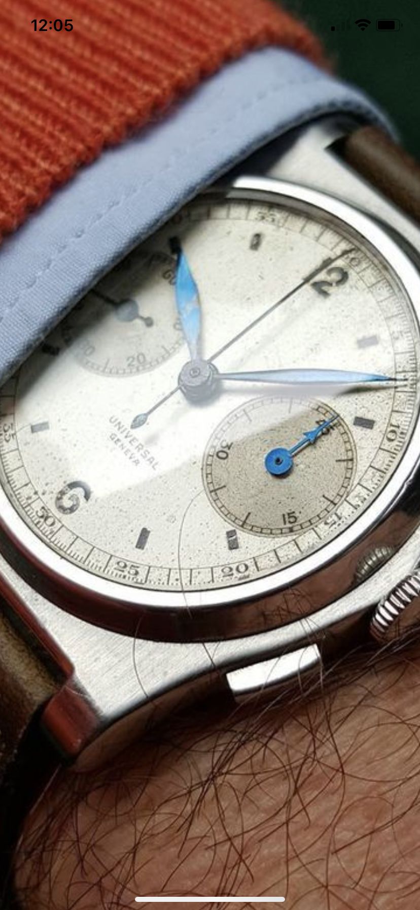

I trust all our member's eyes. Vujen larry bgrisso dirty dozen syrte woops aap etc have seen a lot of watches. Still - very hard to make these calls without touching the watch. Its from a time when universal sourced dials/parts from multiple places and there was never strict congruence- but there was rampant customization and incongruity, and a company that was expanding to try and meet market demand for their product. They didnt care so much is my point as long as it looks good and we all agree this watch looks good..
For the OP- Don't worry about the value- we are a small segment of watch nerds and even more segmented by a craze for ug. We are not normal 😉 Most normal people would anyway consider it an original dial and at auction I would predict a favorable outcome to you if you ever sold it (especially given it was gifted). But instead I hope you Enjoy it - its a beauty.

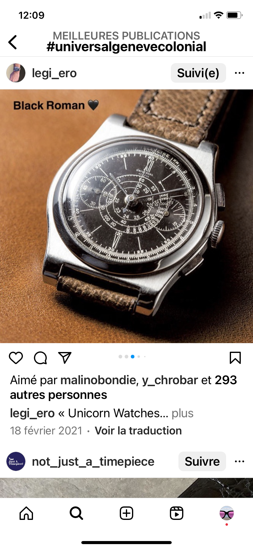

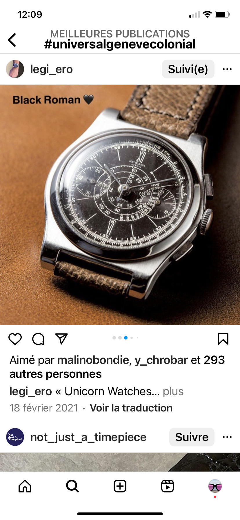

here are some other UG to counteract some ideas here

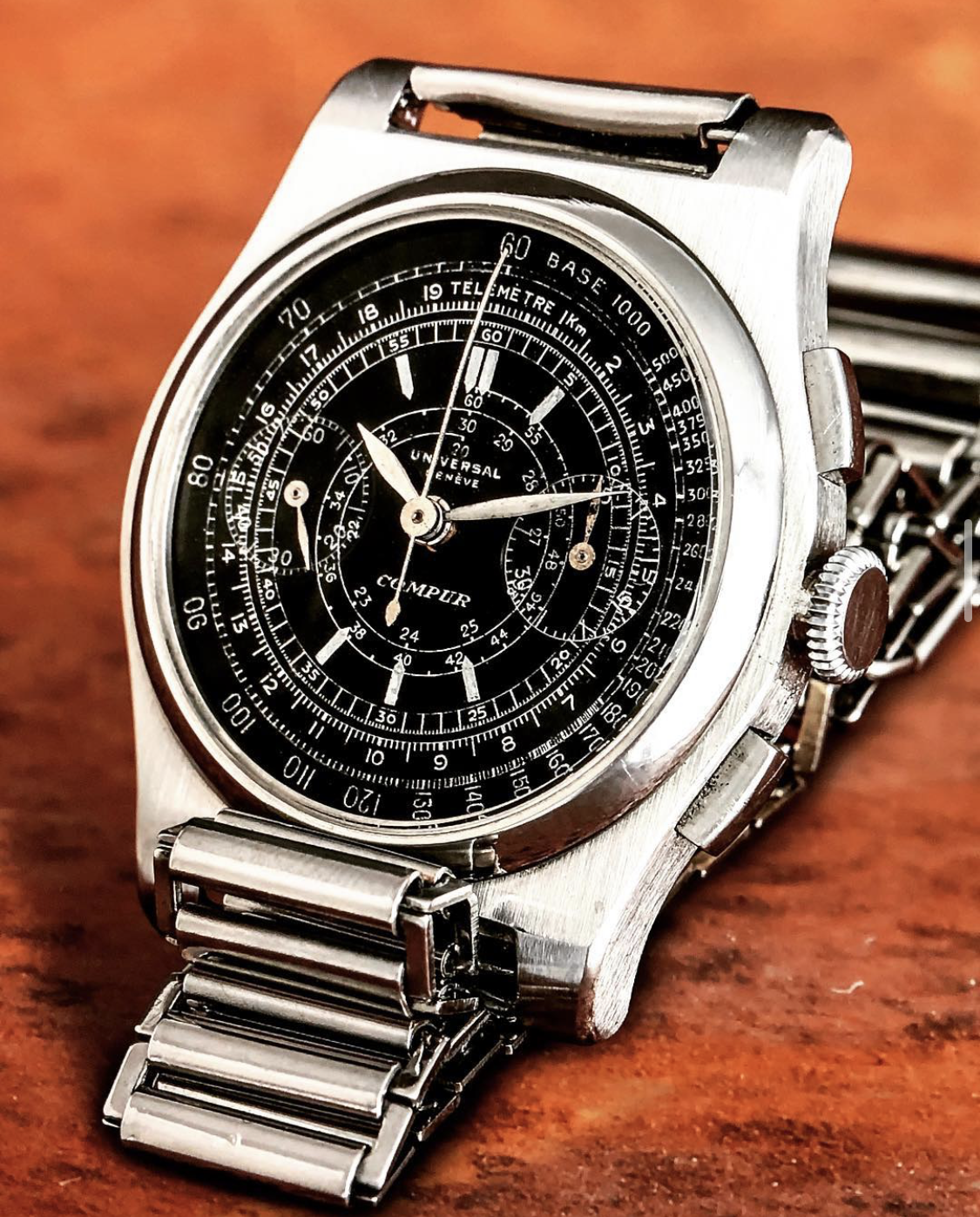

Don’t really understand what you mean with this. The white one was discussed with as conclusion: maybe. The black one is - without a doubt - legit. And of course: nobody knows whether it started it’s life in this case

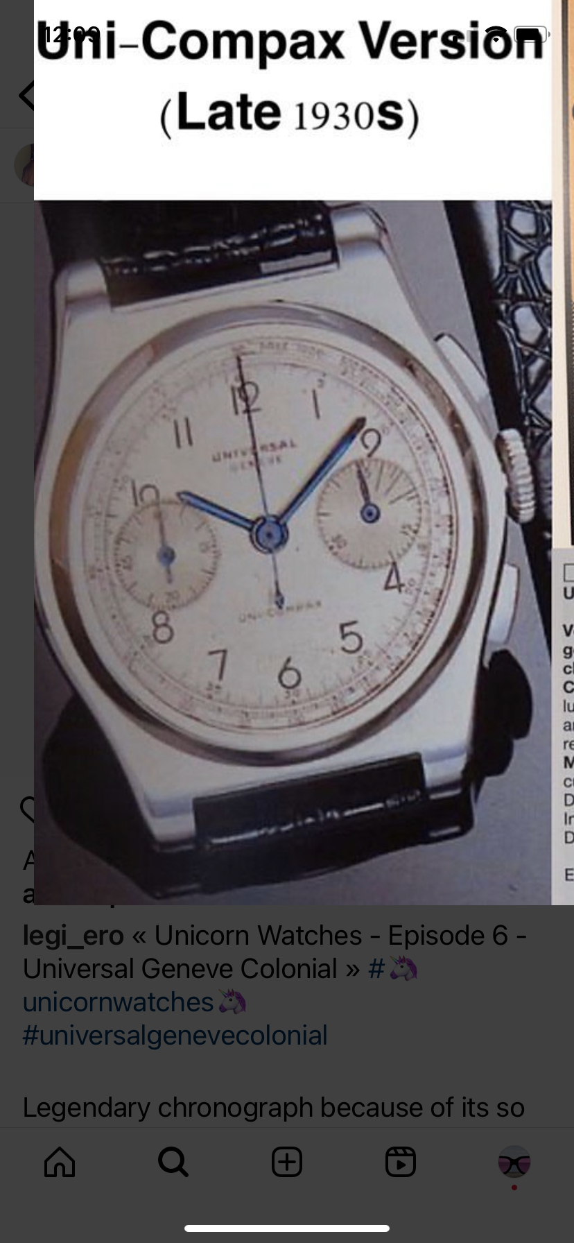

@Syrte , 1934-1935 dials are pretty recognizable, come on.
Their style is specific.
Anyway again, for the second time, you just need to see the second subcounters to understand that it's not legit.
It's like seeing a Longines 13zn with telephonic signs on the minute subcounter.
Collecting UG chronographs is not so easy like collecting other stuff, because you have to study more, specifically about dials during times.

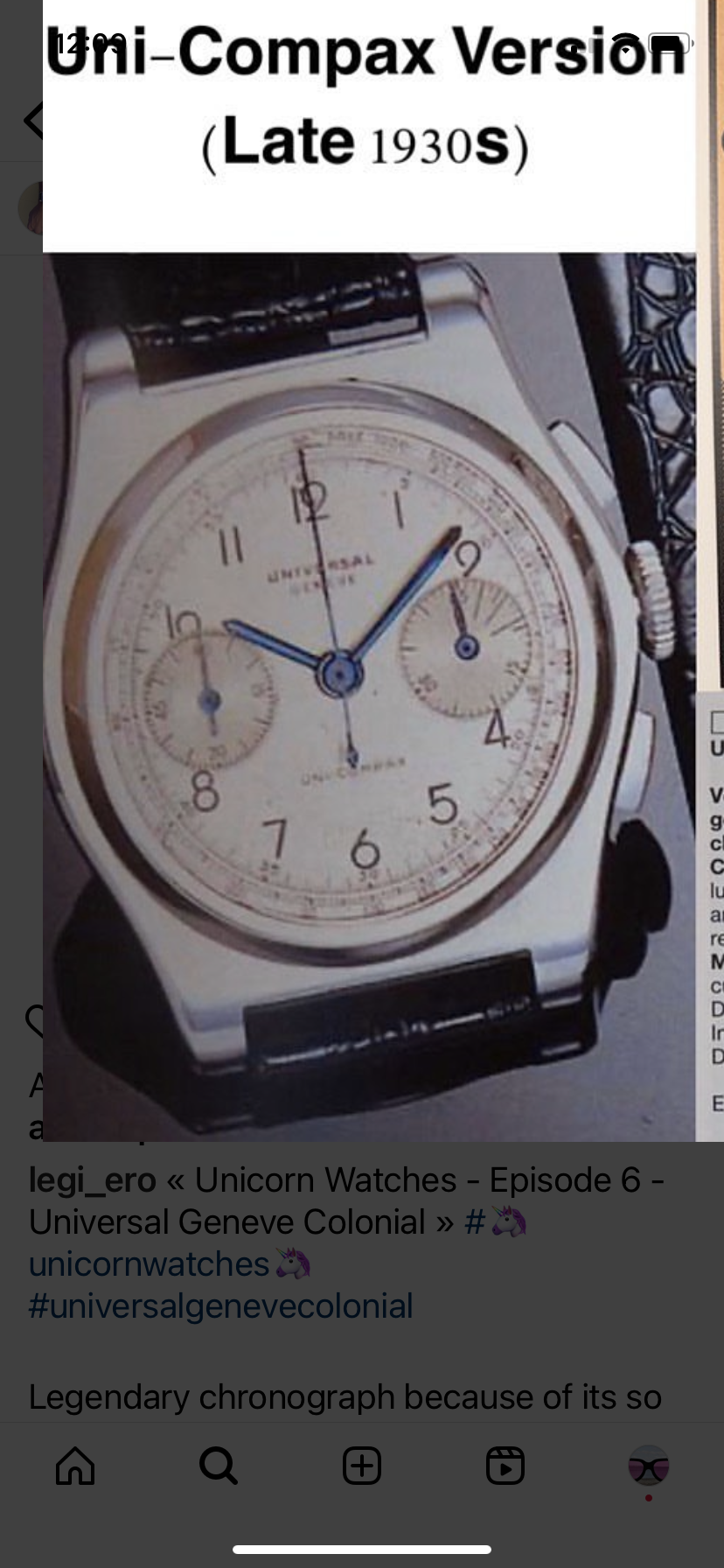

For instance looking at the colonials you showed us, I see - at least - 2 with later dials.
I mean there's one with a UNI-COMPAX dial! UNI-COMPAX models were created years later! Come on.
Again, for the last time (personally speaking!): truly congrats to the owner for the amazing gift, enjoy this rare watch and don't worry about its economic value. It's really rare to find a colonial, and for sure at some point in the future a matching dial can surface somewhere!
You are right I just thought on the black dial the indices werent railtrack but closer look they are. Will leave it up anyway.

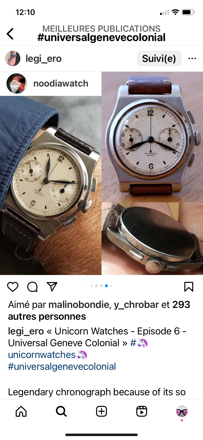

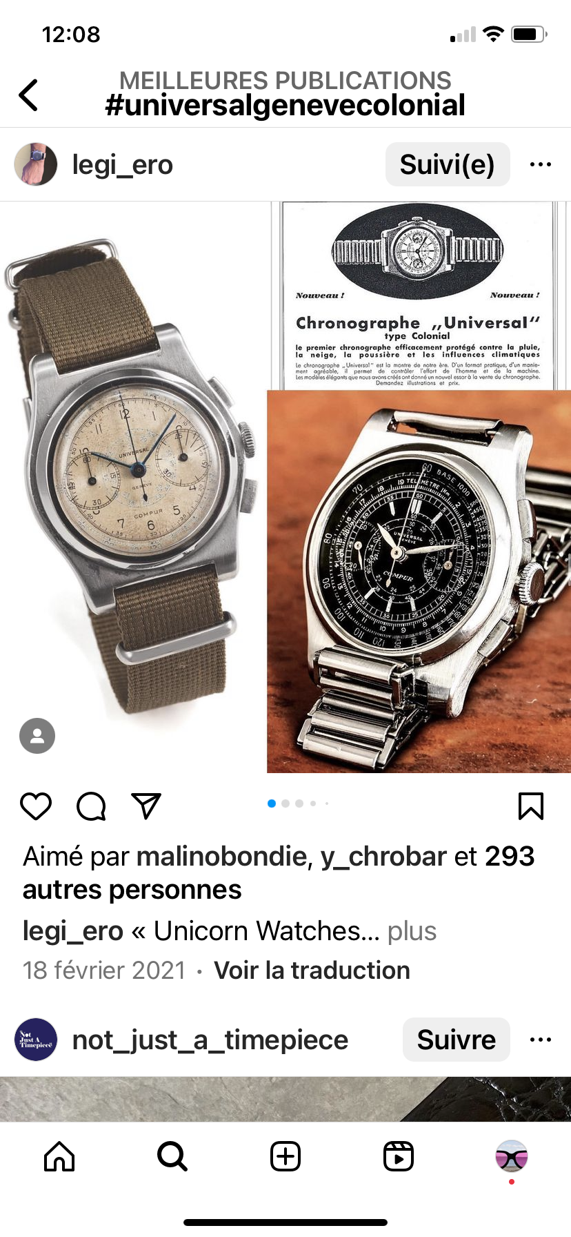

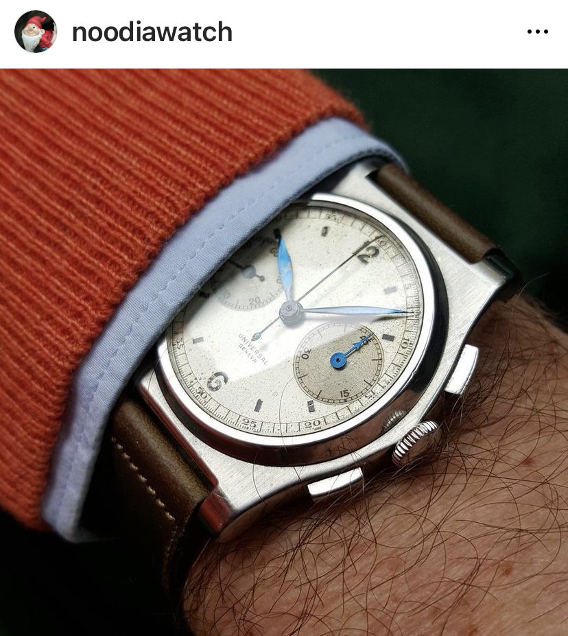

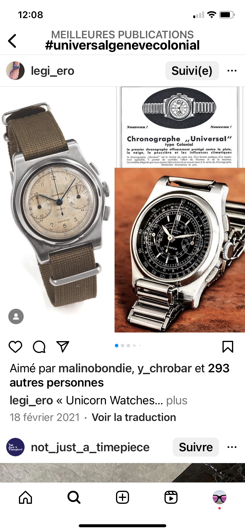

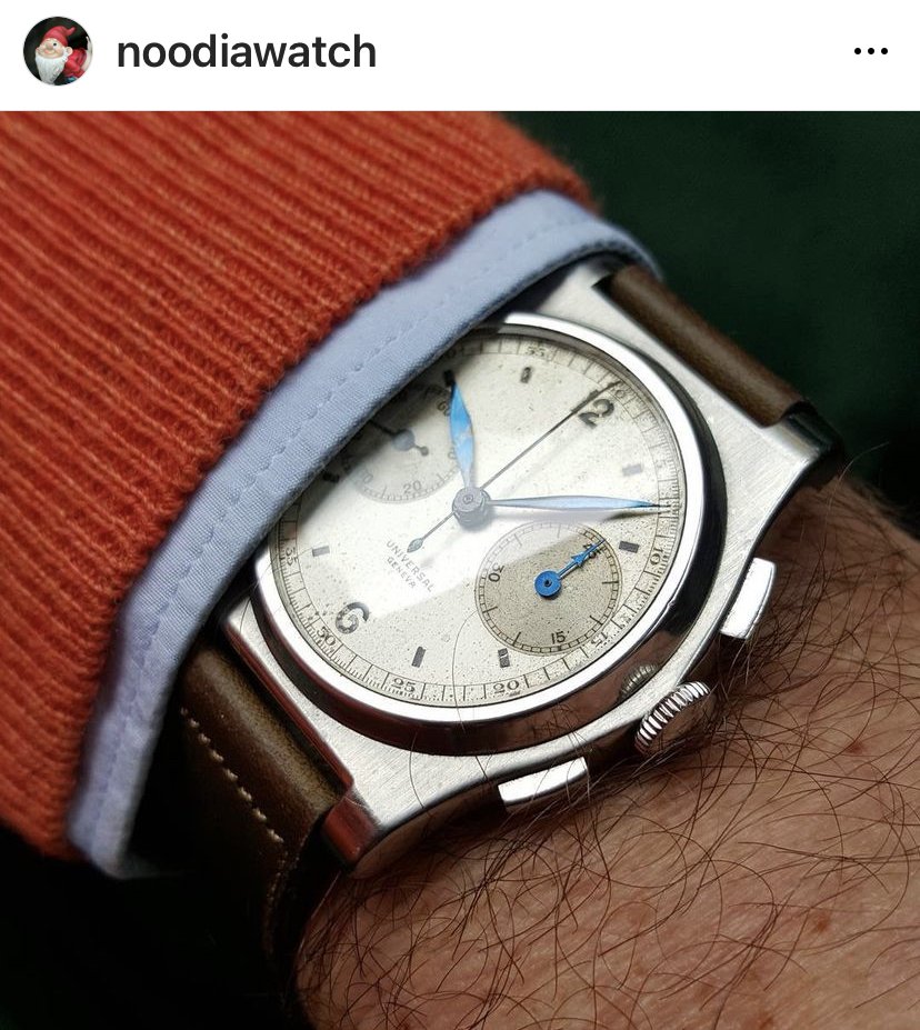

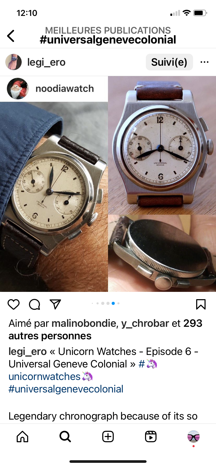

Just posting a few more for reference- all collected on Omegaforums by @valjoux72, @aap and on Instagram by @legi_ero.
One of them is part of the collection of now deceased OF member Laurent aka @Noodia.
Not sure if you tagged me by mistake, @Syrte?

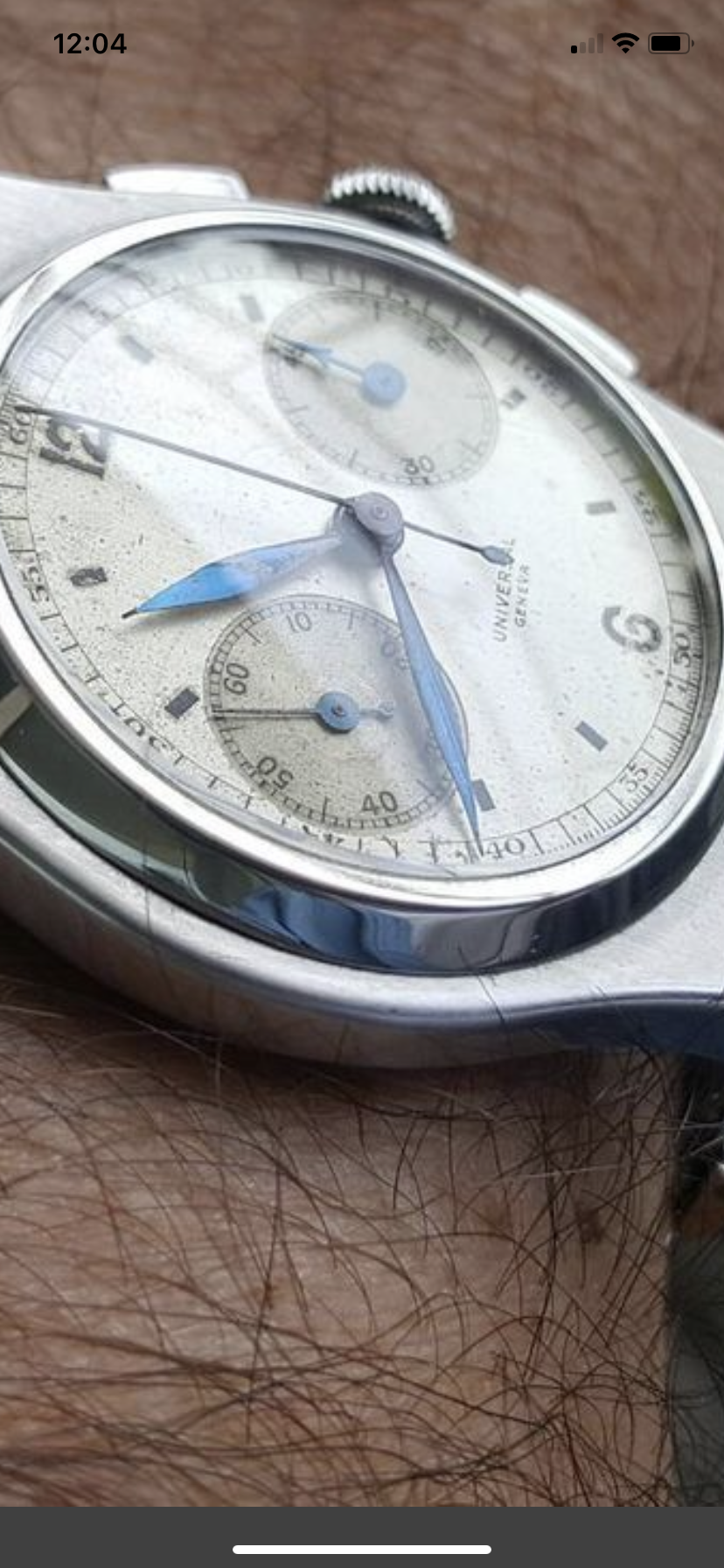

In any case, to add to the references on this thread, here's a pic I took of another UG Colonial owned by the Japanese collector, Taku:
I've seen and held this watch twice before:
https://omegaforums.net/threads/when-3-guys-from-of-met-tokyo-pic-heavy.59443/
https://omegaforums.net/threads/tokyo-jan-2018-report-pic-heavy.69907/#post-879879

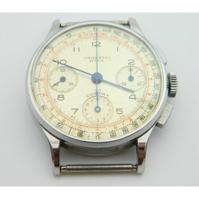

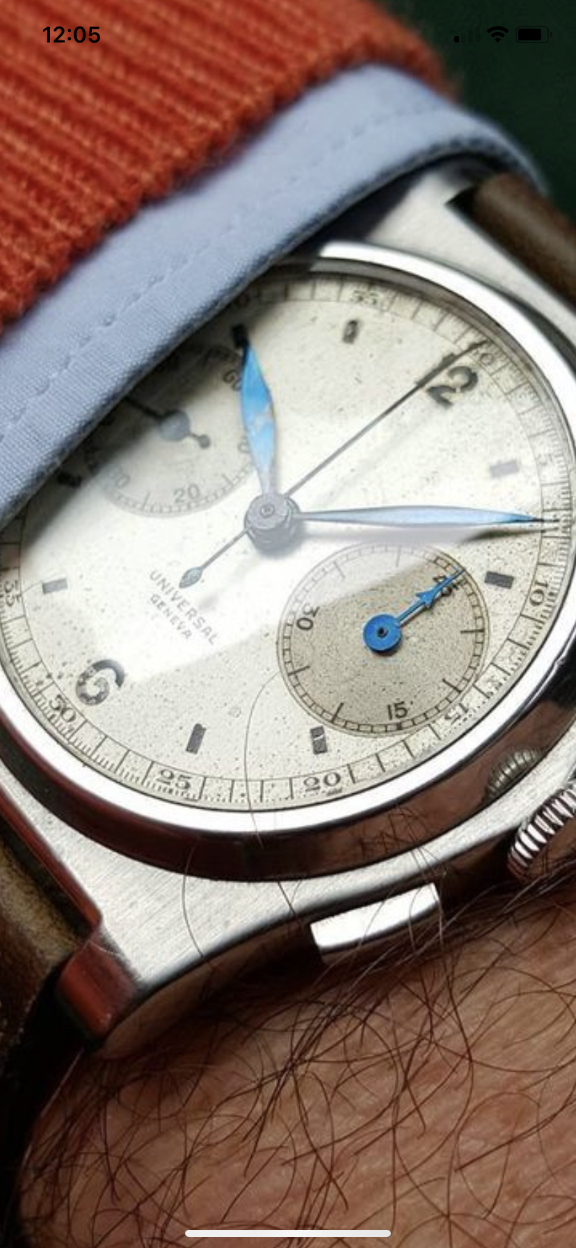

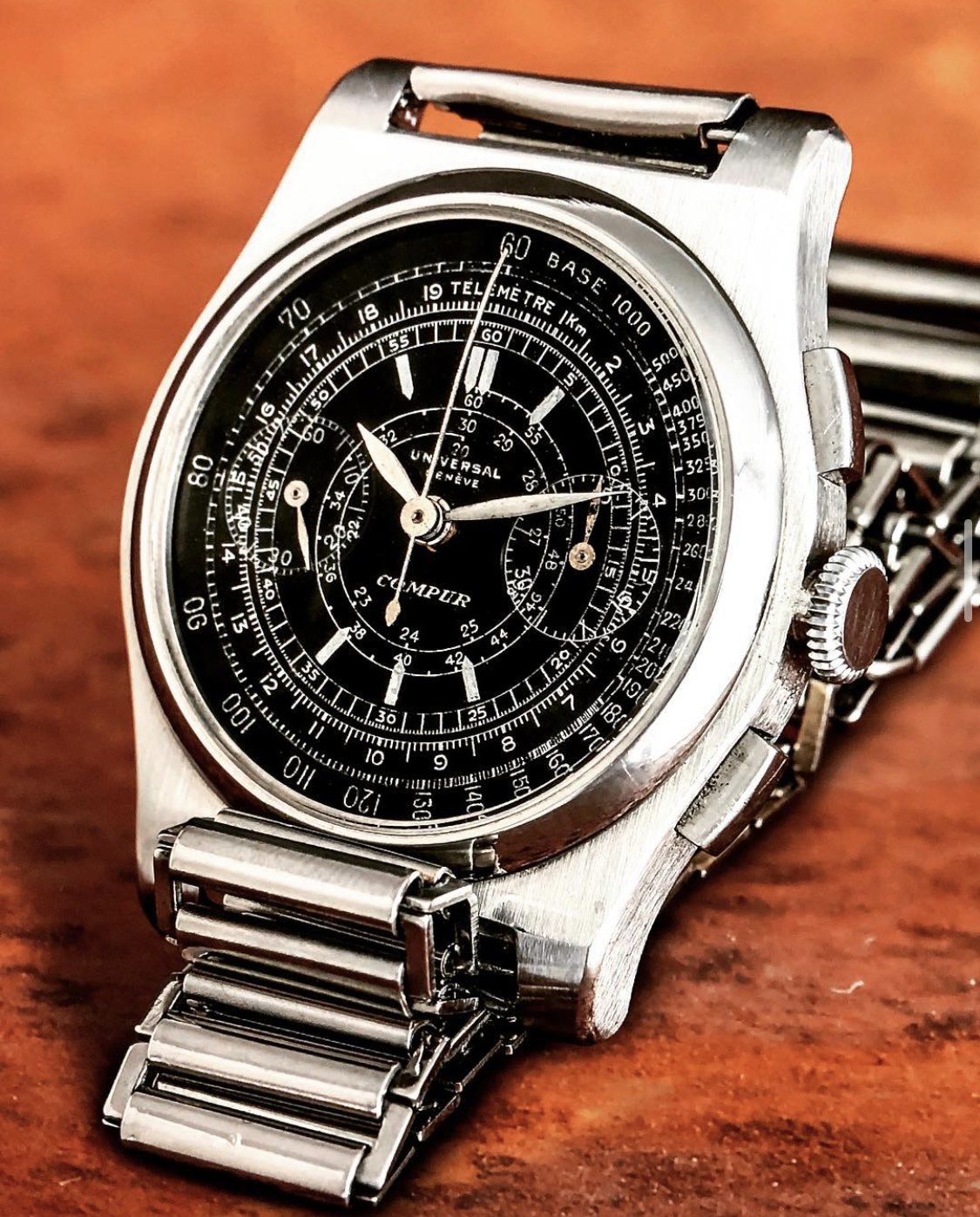

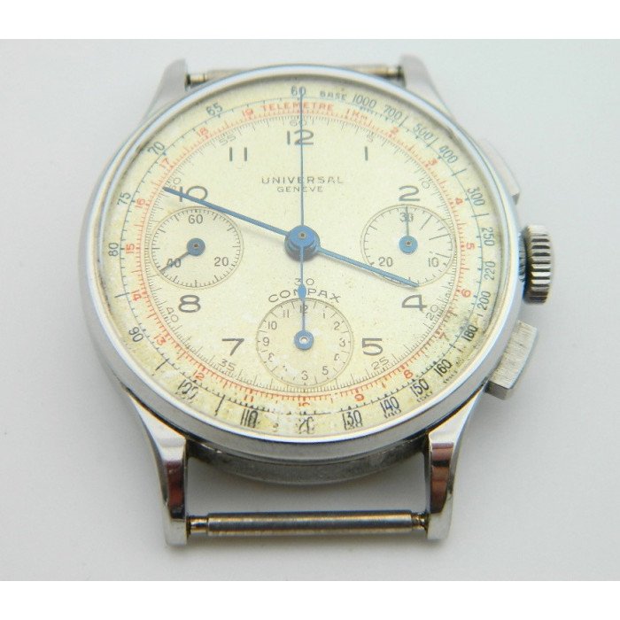

Thanks for posting those two dials. To clarify, I was specifically asking about Compur-signed dials, rather than Compax-signed dials.
A few people have mentioned that UG used multiple dial suppliers, and that there was huge variation in printing quality, and a lack of congruence among original dials. It has also been mentioned that there is a lack of data available, and that it is difficult to draw conclusions as a result. I would say that despite multiple dial suppliers, I do see a level of consistency (both printing quality and dial design) among original Compur dials. There may be more variability than with Longines 13ZN dials, for example, but there are still margins and trends.
In terms of quality, I would be surprised to see an original dial with a telemeter scale that overlaps with a concentric seconds scale. I know I keep harping on this point but I think that it is significant.
In terms of dial design, there is definitely a lot of variation. However, sub-dials are one area where there seems to be more consistency. As I mentioned, the sub-dials of the dial in question are unlike any other original Compur dial I have seen.
At this point, one might be tempted to say that we are discussing a Colonial, and atypical dials might have been used in this rare model. To me, this seems unlikely. While there might have been Colonial-specific dials, I doubt that these dials had anomalous sub-dial designs in conjunction with unusually poor execution. We do not see this on other Colonial dials, and it seems a much more convoluted explanation than a refinished dial on a watch from the mid-1930s.
Just for my understanding: you mean the combination of telemeter + snail or that the snail ends somewhere in the telemetre?
2,829
4,945
I meant that some numbers of the telemeter scale overlap with the seconds scale. On original dials, there is a gap between peripheral telemeter scales and the seconds scale that is inside and concentric.
