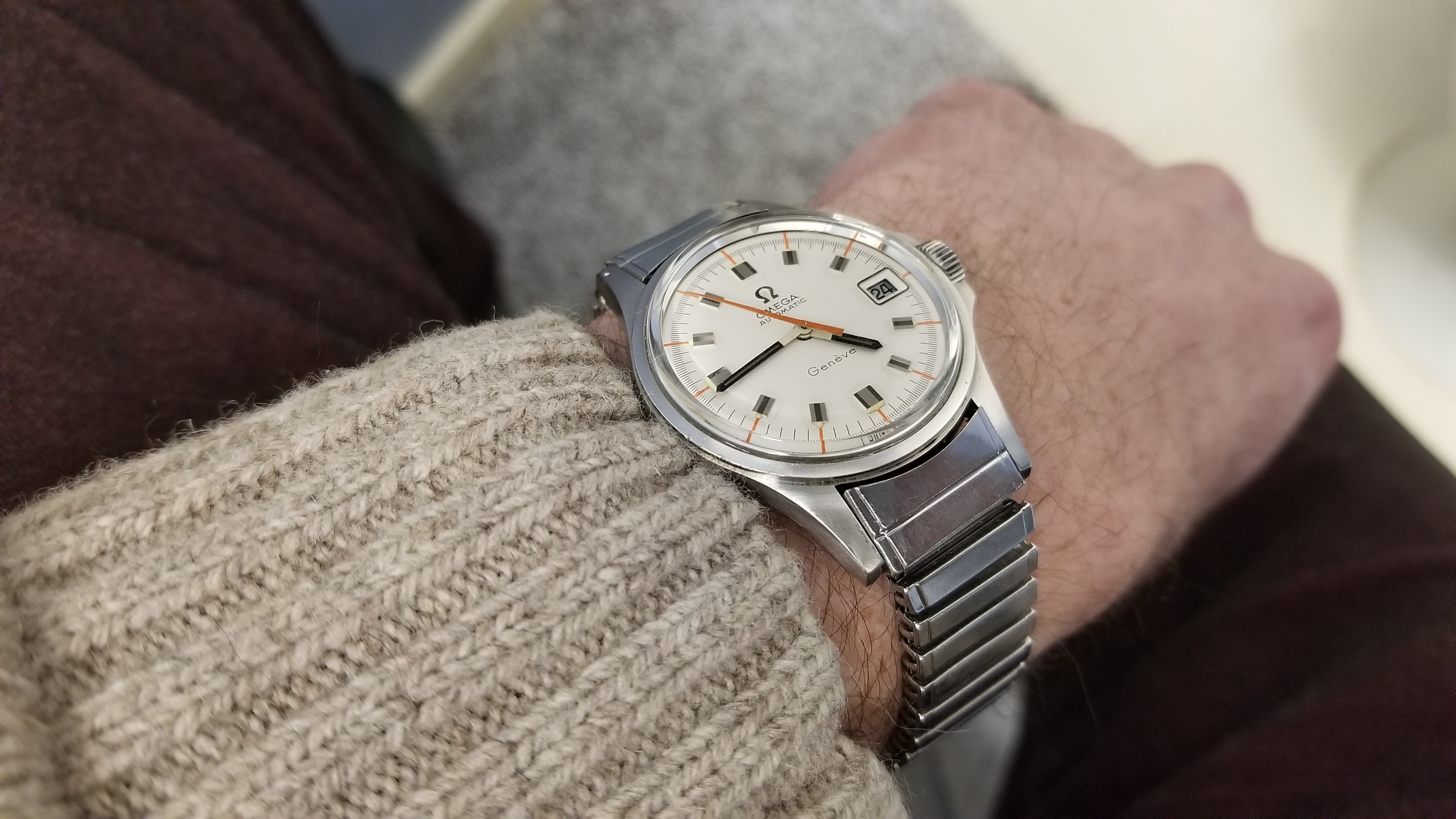

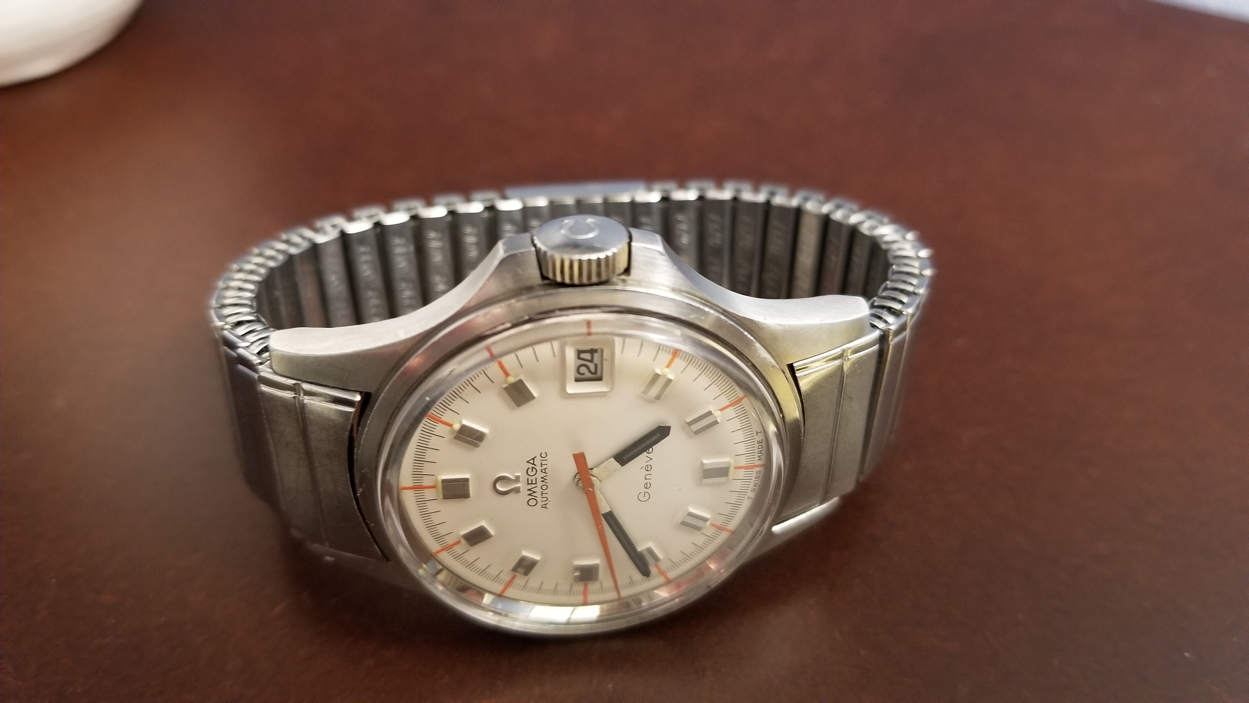

My 2nd Admiralty has just arrived....this time very clean white dial with the black tipped hands (very easy to read!) Auto movement and quick-set date.
This time I'm embracing the stretch band...(for now).
I'm on the lookout for a nice black dialed one to complete the triad.

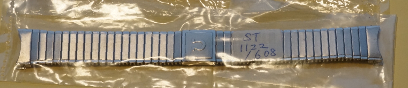

Oh, I forgot the corresponding Omega fixo-flex bracelet. It's ref. ST1122/608
By the way, @1jansen it looks like that FIxo-Flex is fitted with the short-lug end pieces...it won't fit your Amiralties unfortunately.

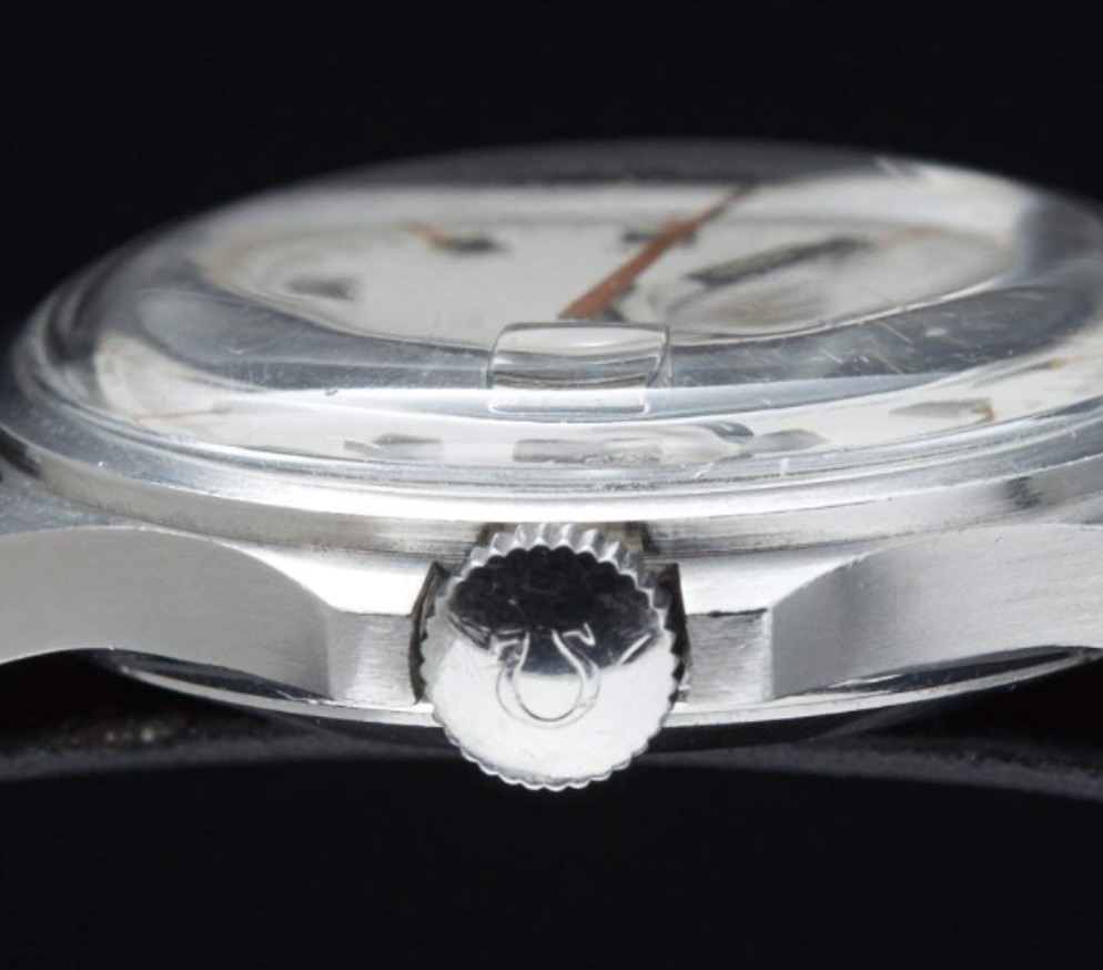

I've seen some Date models with plain crystals, but others with a magnification "reverse cyclops" (underside):
Were these the original crystals or are they replacements?
