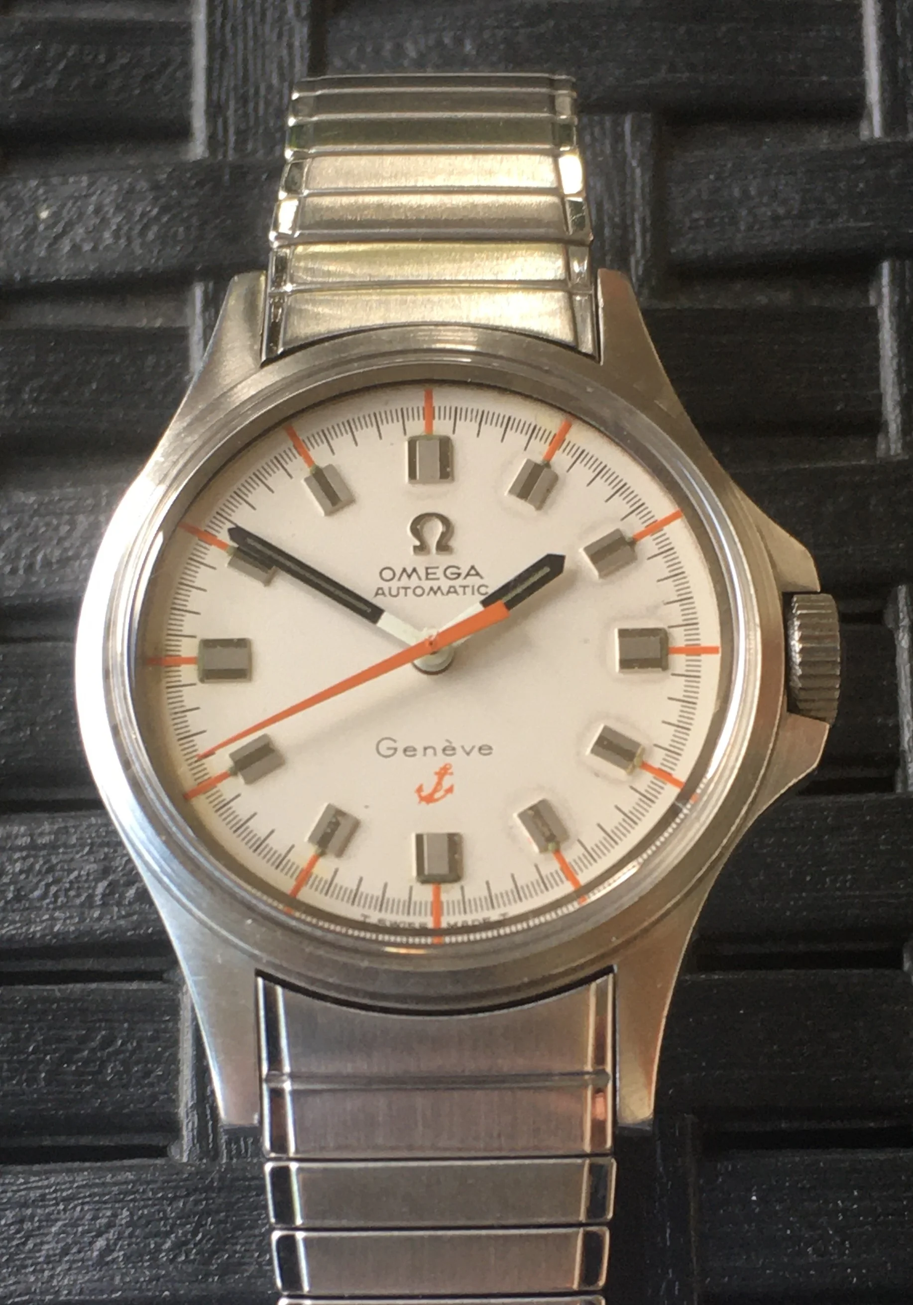

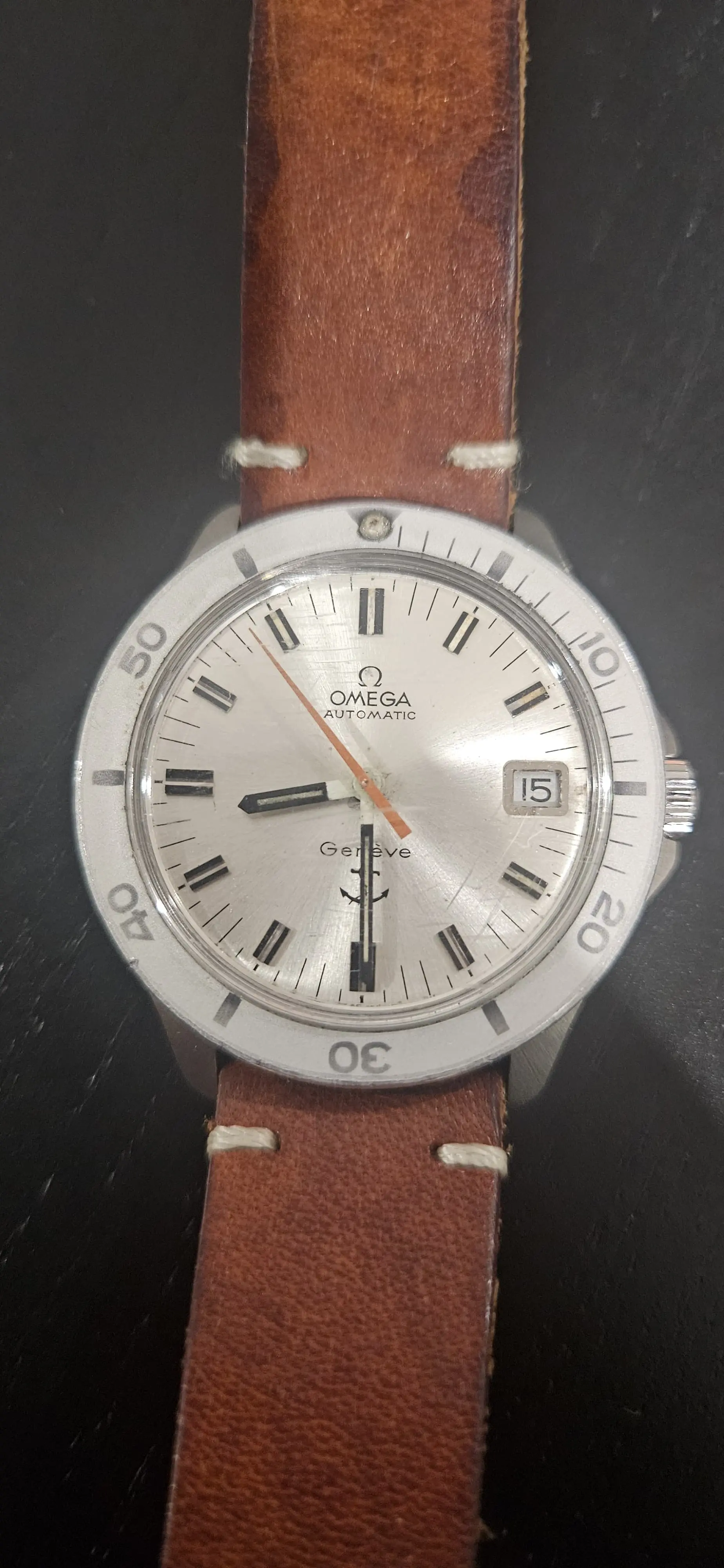

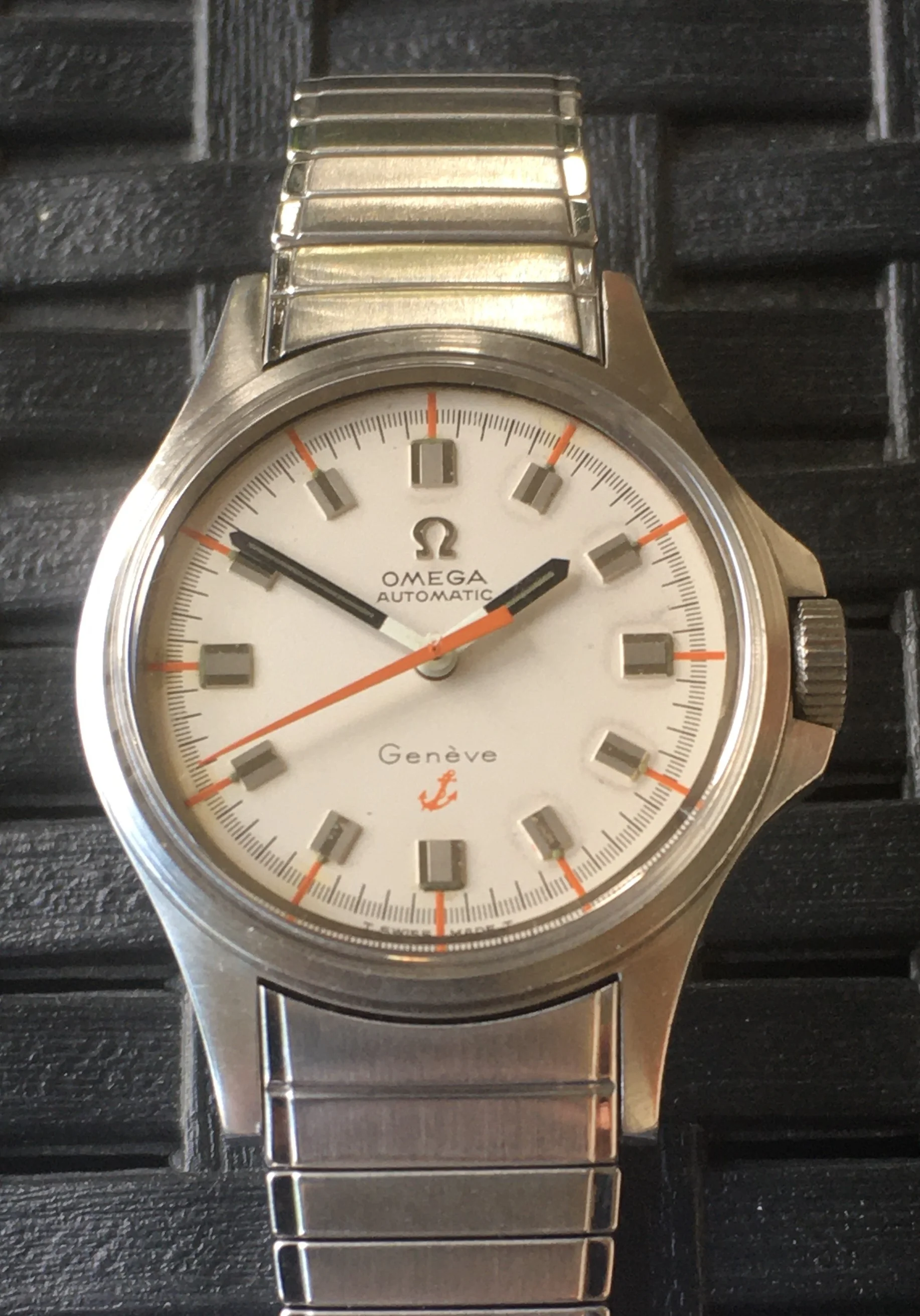

Bonjour à vous
Je viens de faire l’acquisition de cette superbe Omega Admiralty Ref 135.015 de 1968 ☀️
J’aimerais avoir votre avis sur le sujet mais aussi, débutant dans l’horlogerie, que vous puissiez me dire un peu l’histoire de cette montre ! La production semble ultra limitée et j’aurais aimé savoir pourquoi ☺️
Merci beaucoup à vous tous pour votre passion et aide !
Belle soirée
211
689

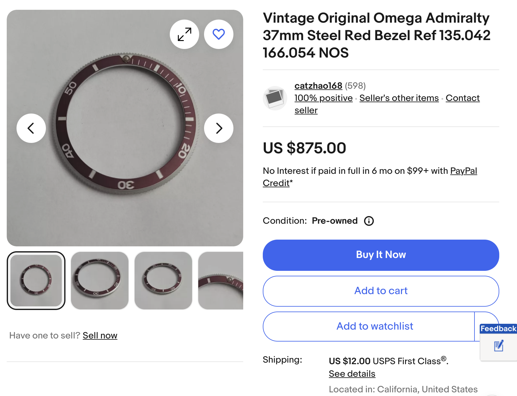

So, i have been looking at these watches for quite some time. I didn't know these were also sold without the bigger bezels.. 🤡 everytime i saw one i was like: hey, these is missing the most expensive part, the bezel.
However, many models are sold without the bezel, aren't these several different models? There must be a bezel normally on an Admiralty?

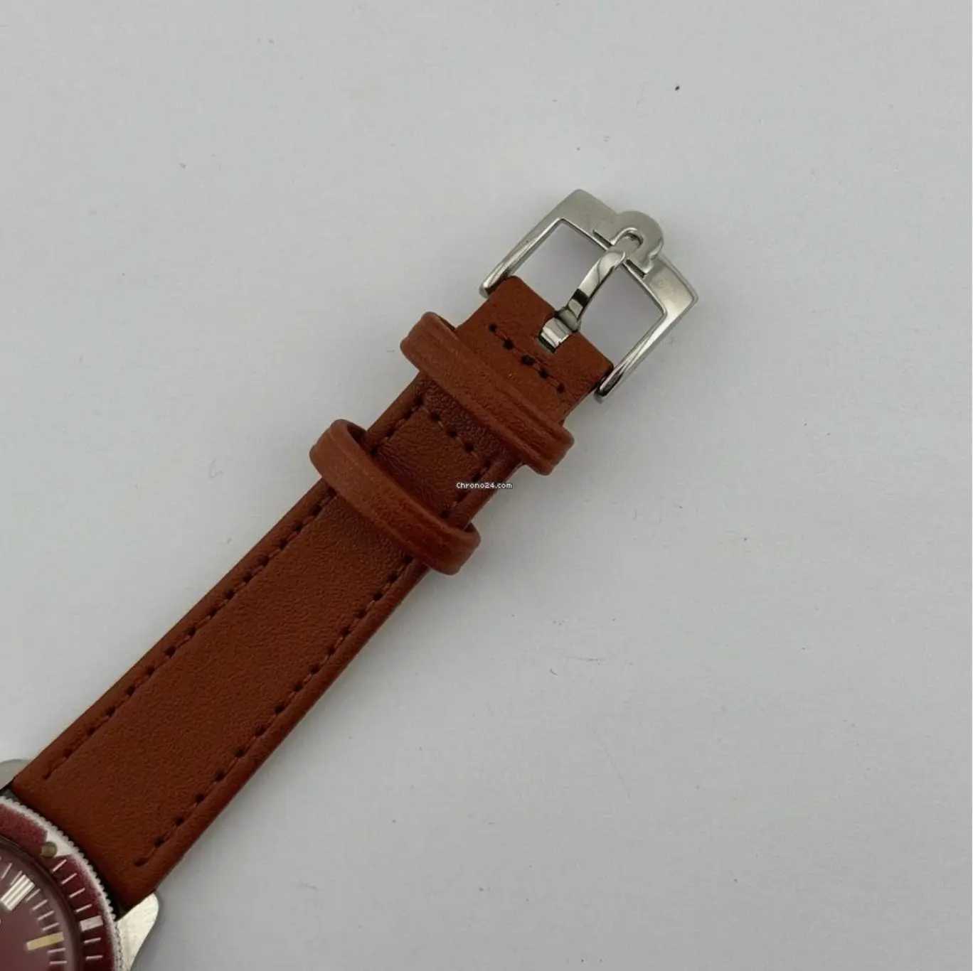

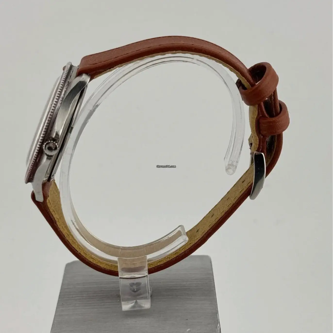

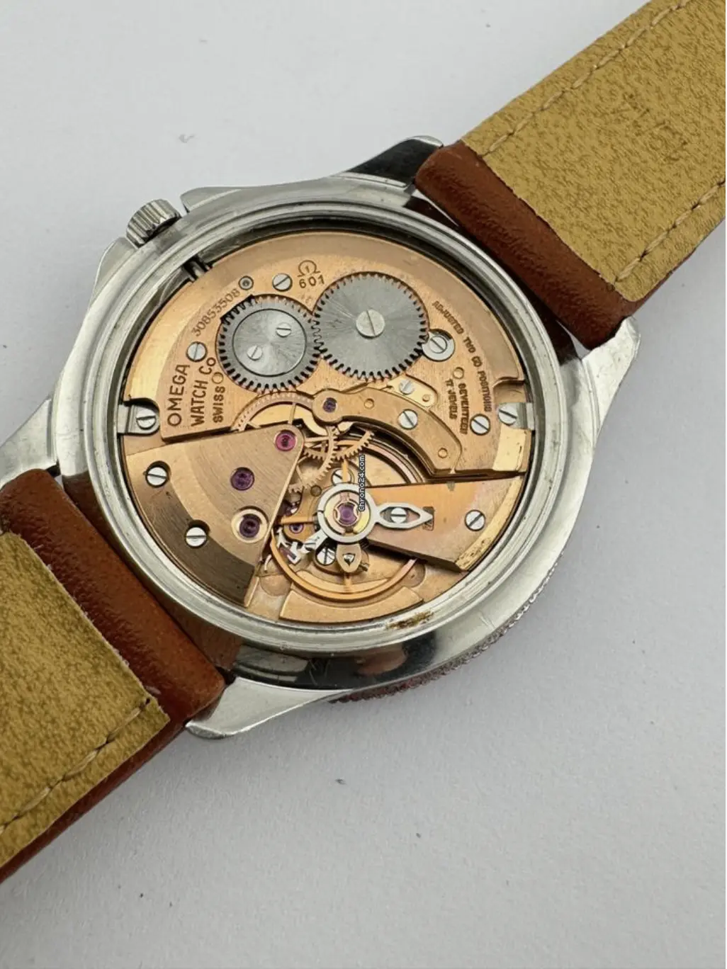

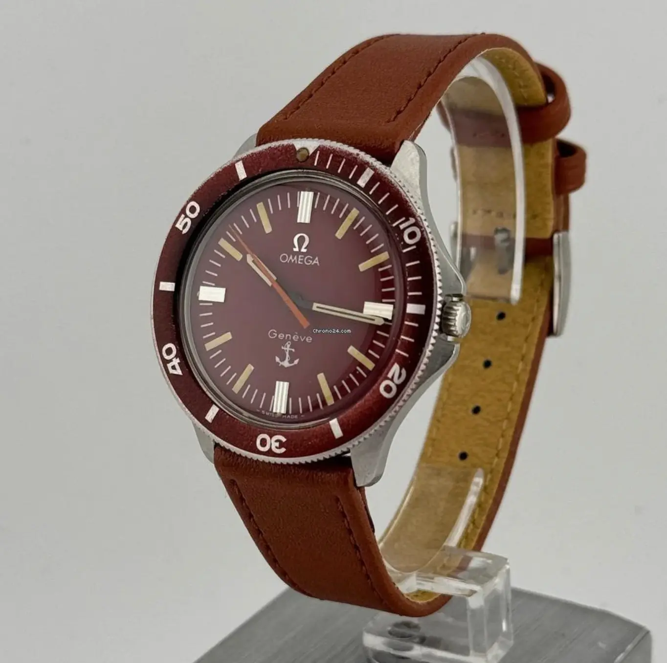

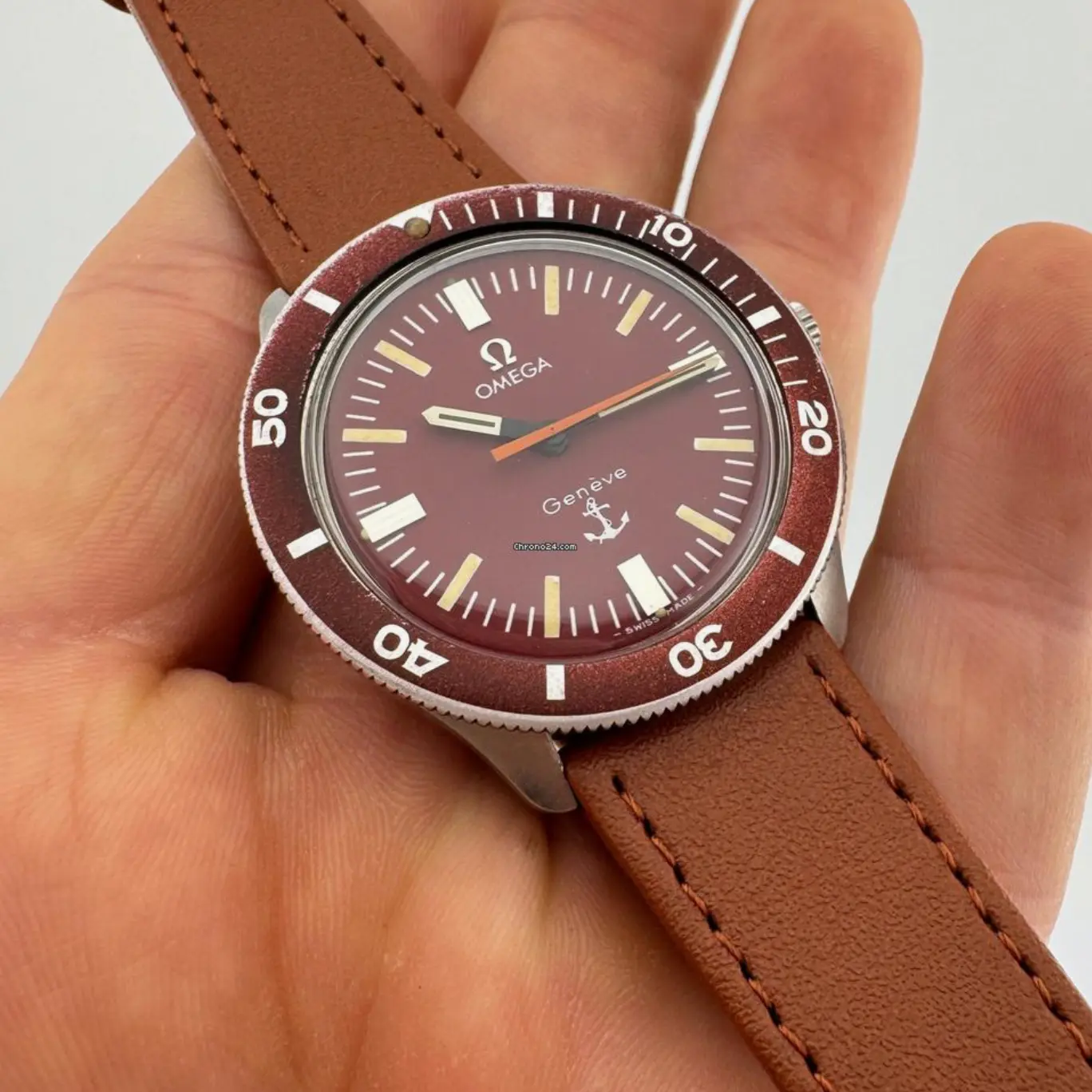

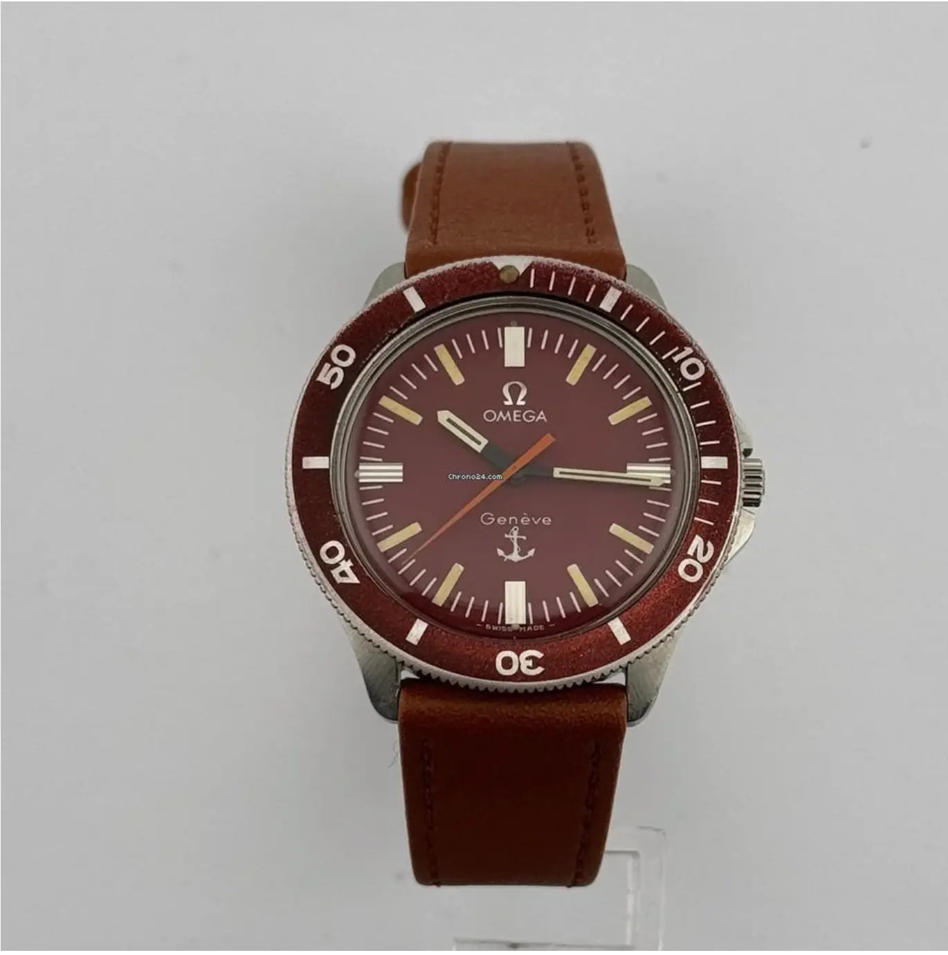

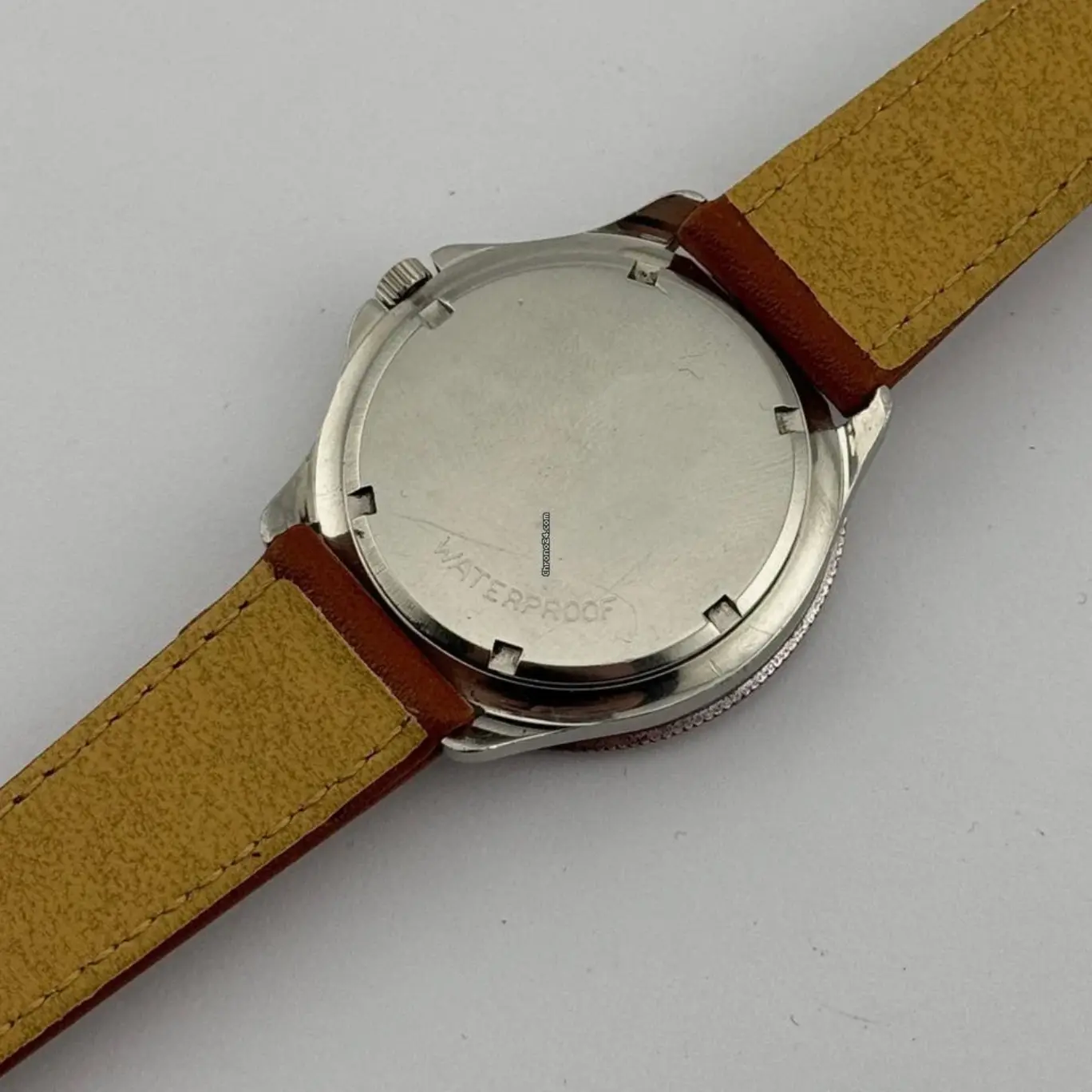

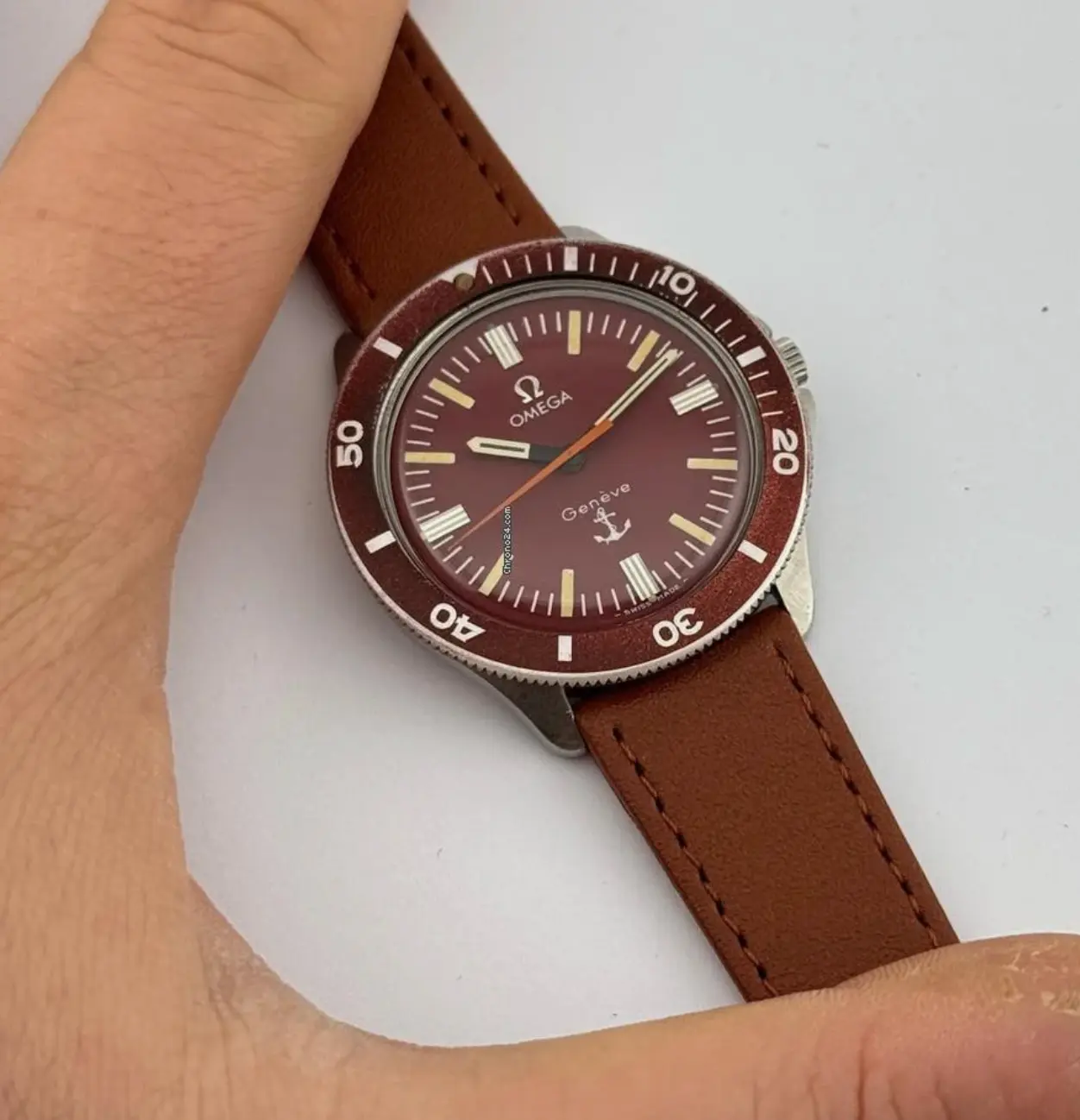

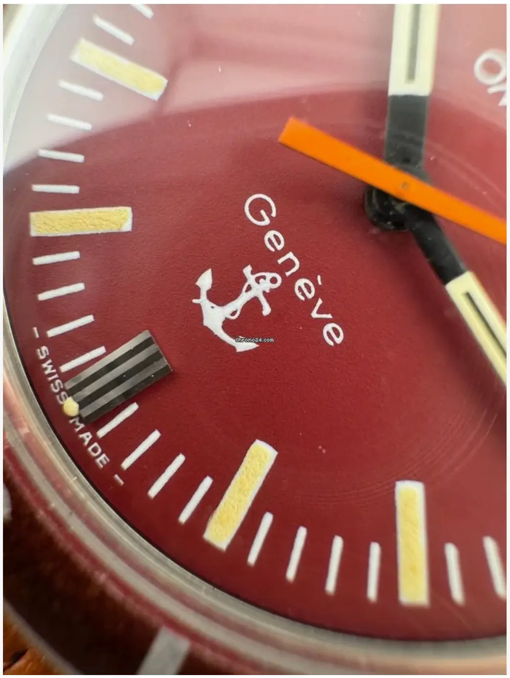

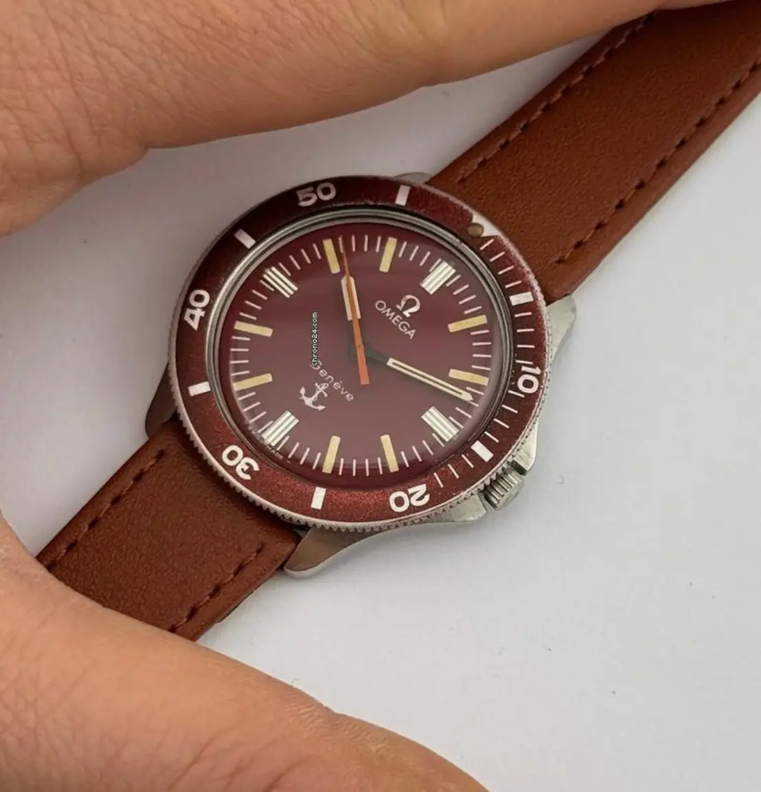

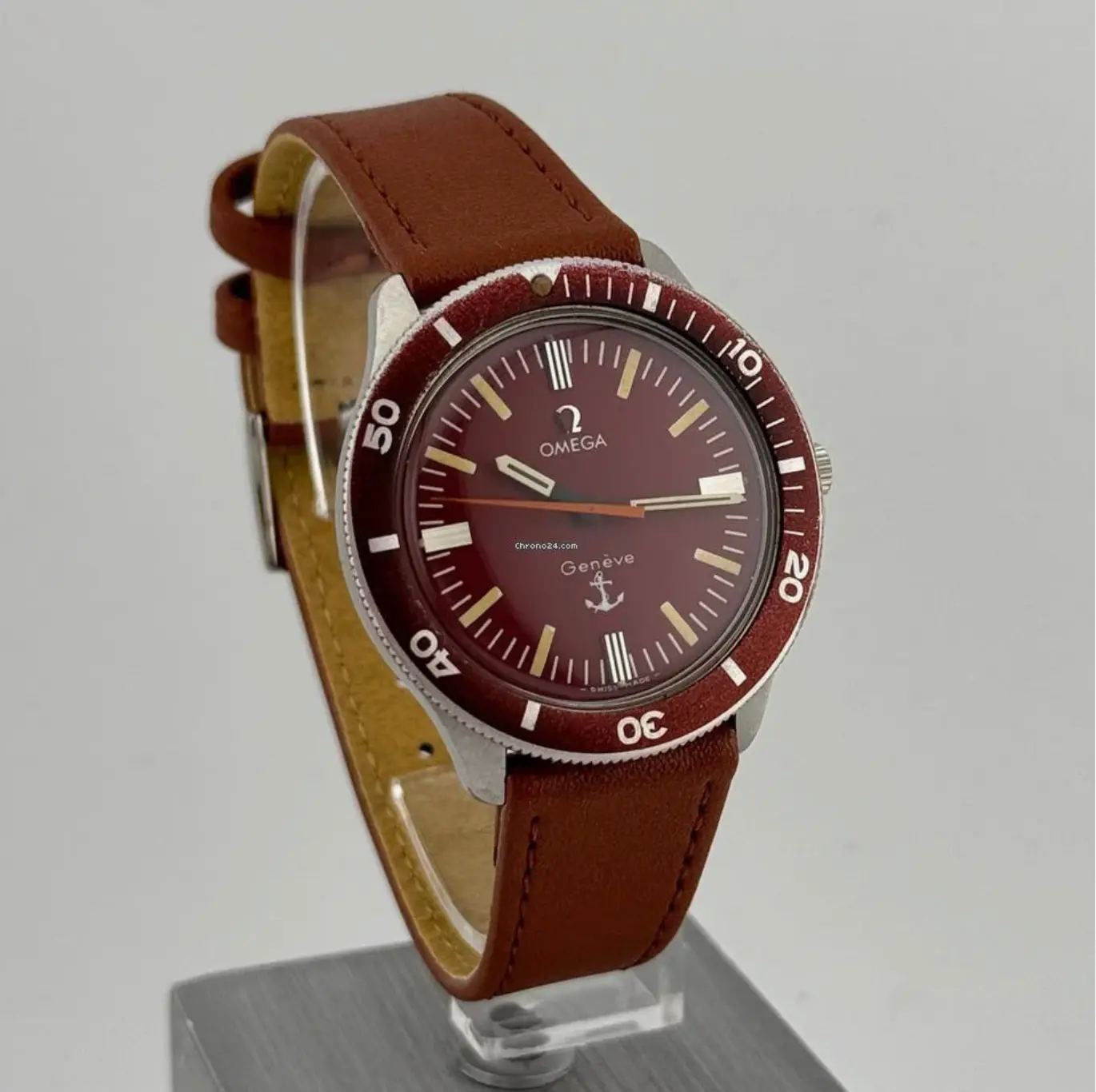

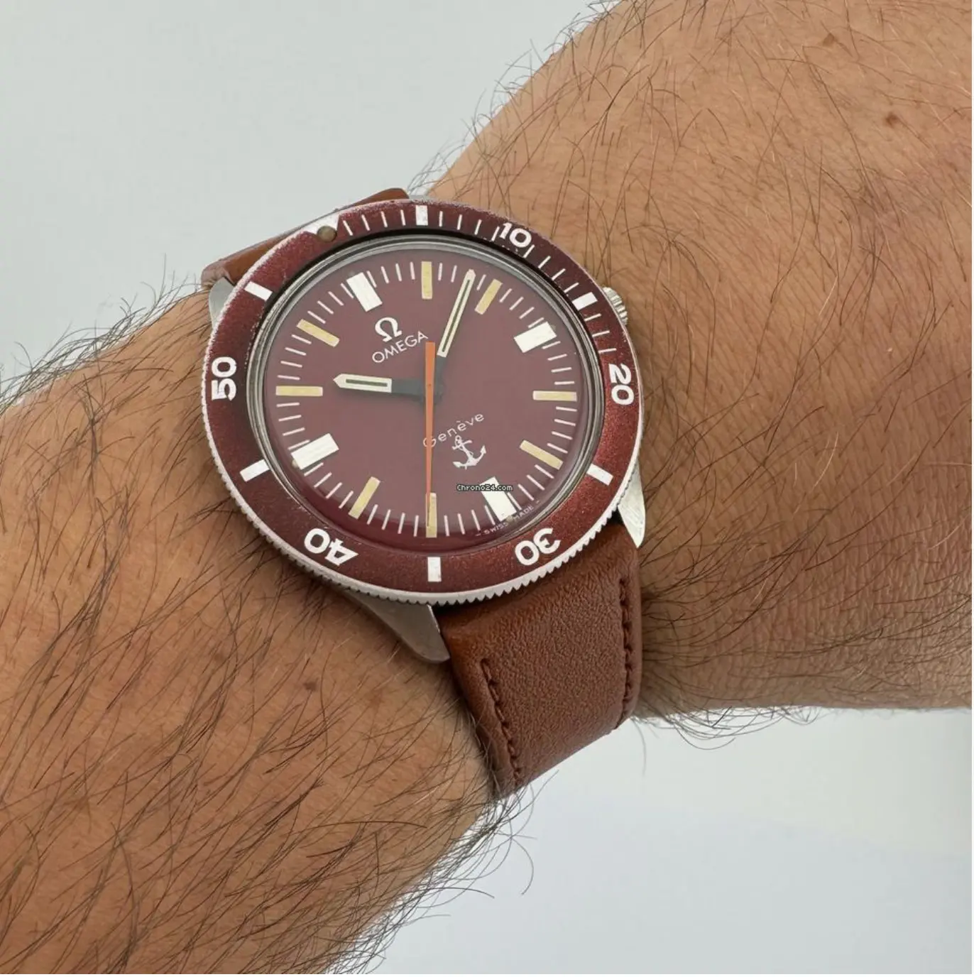

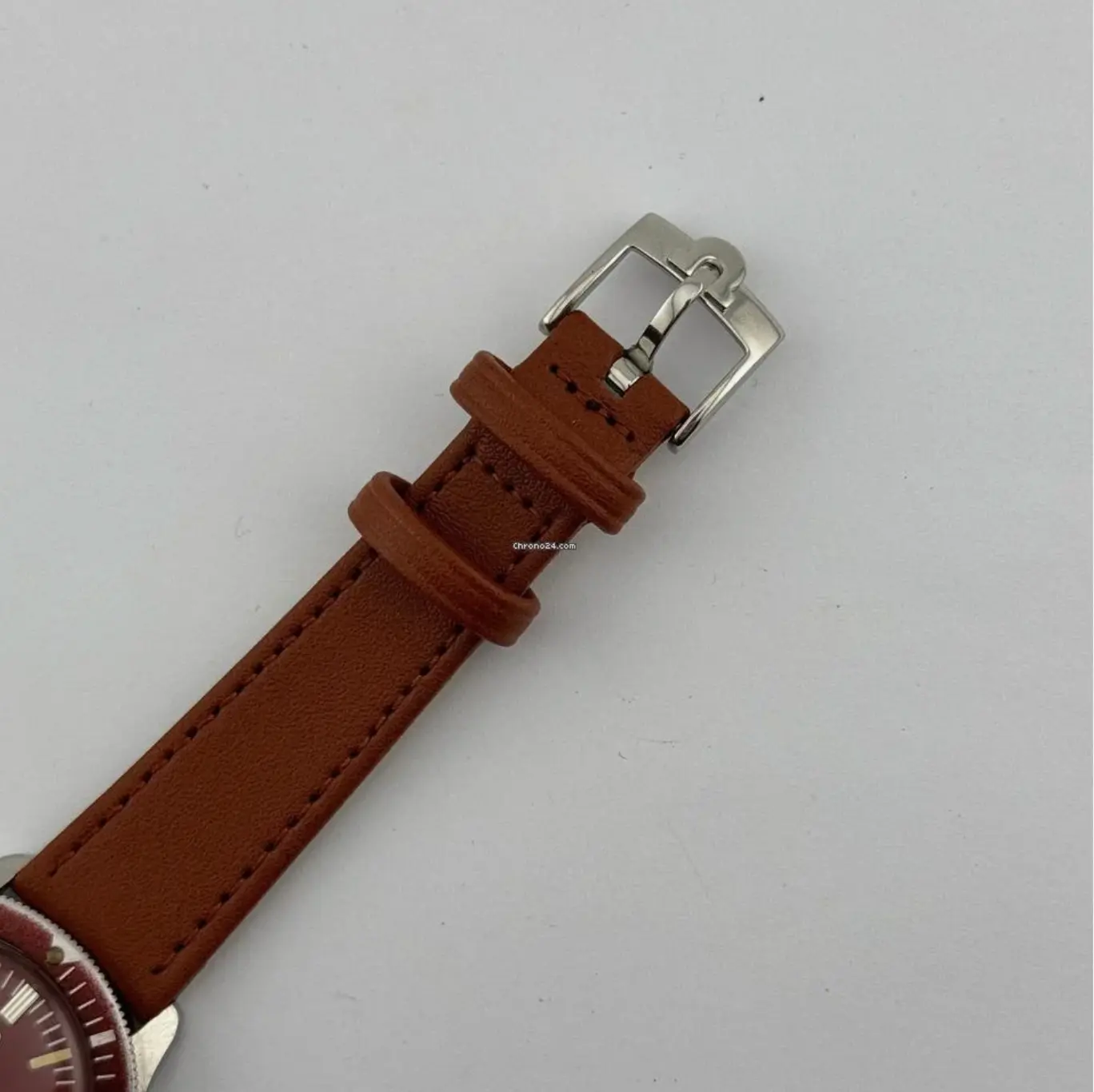

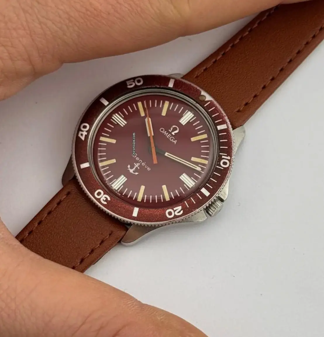

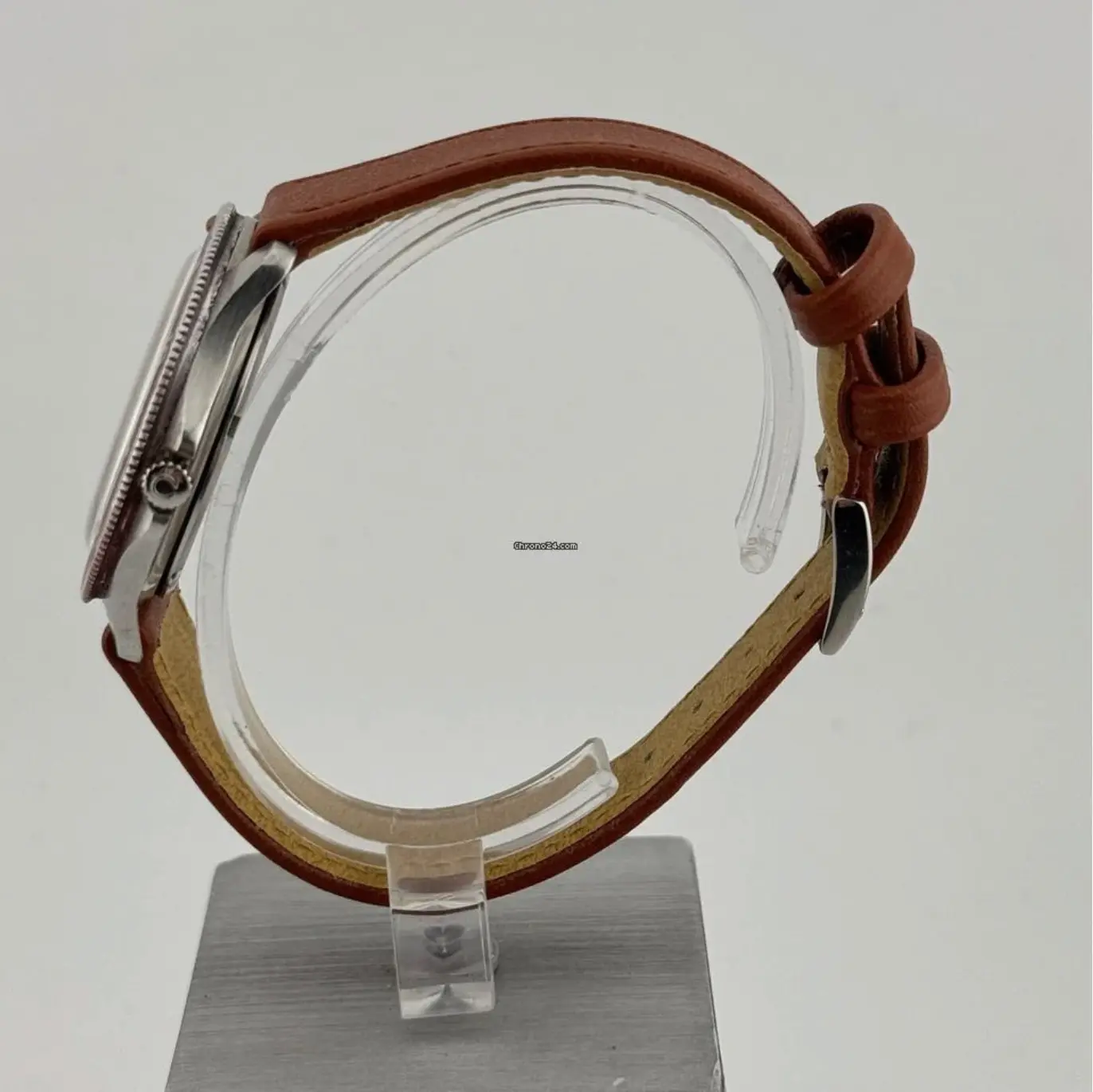

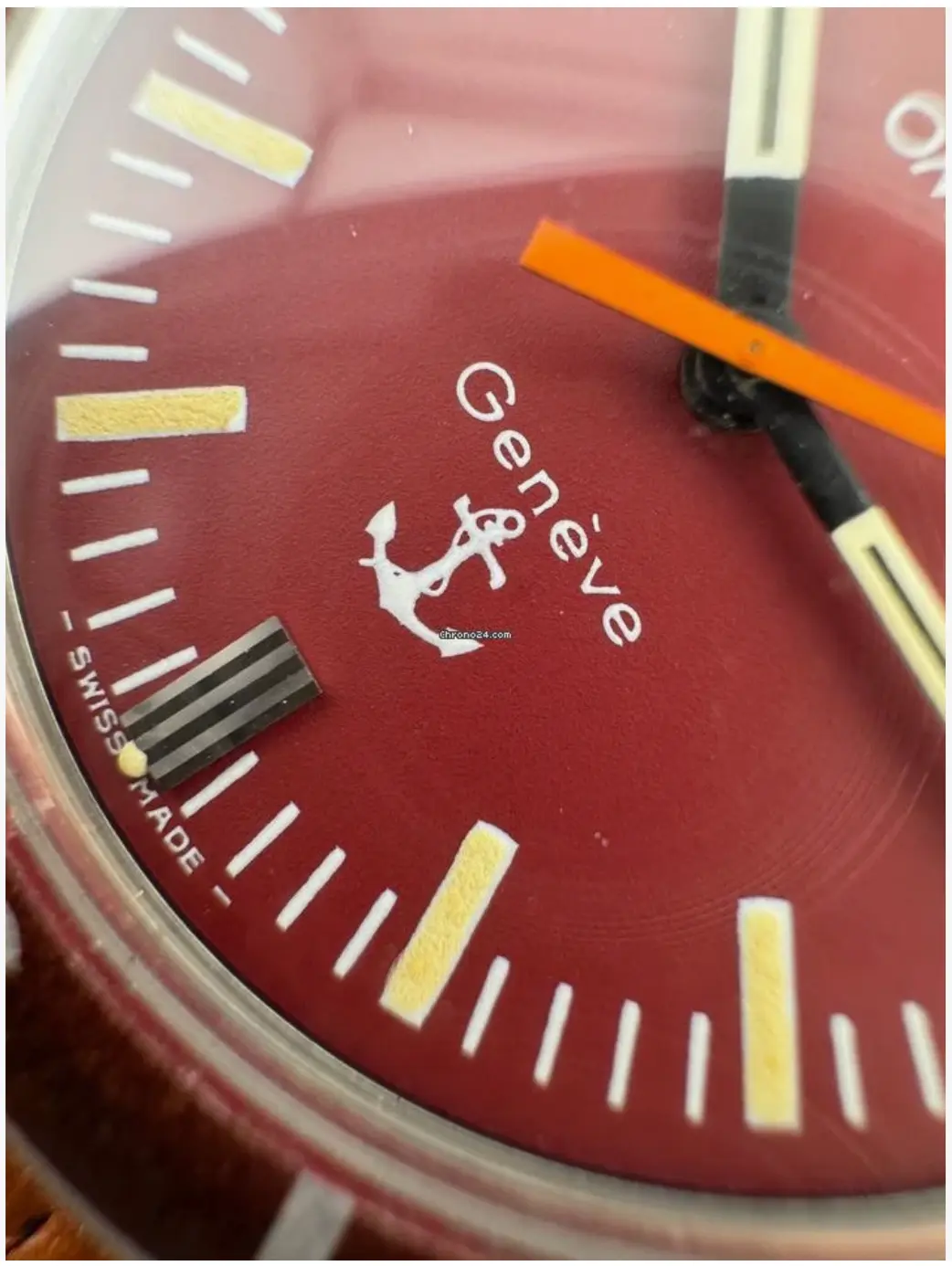

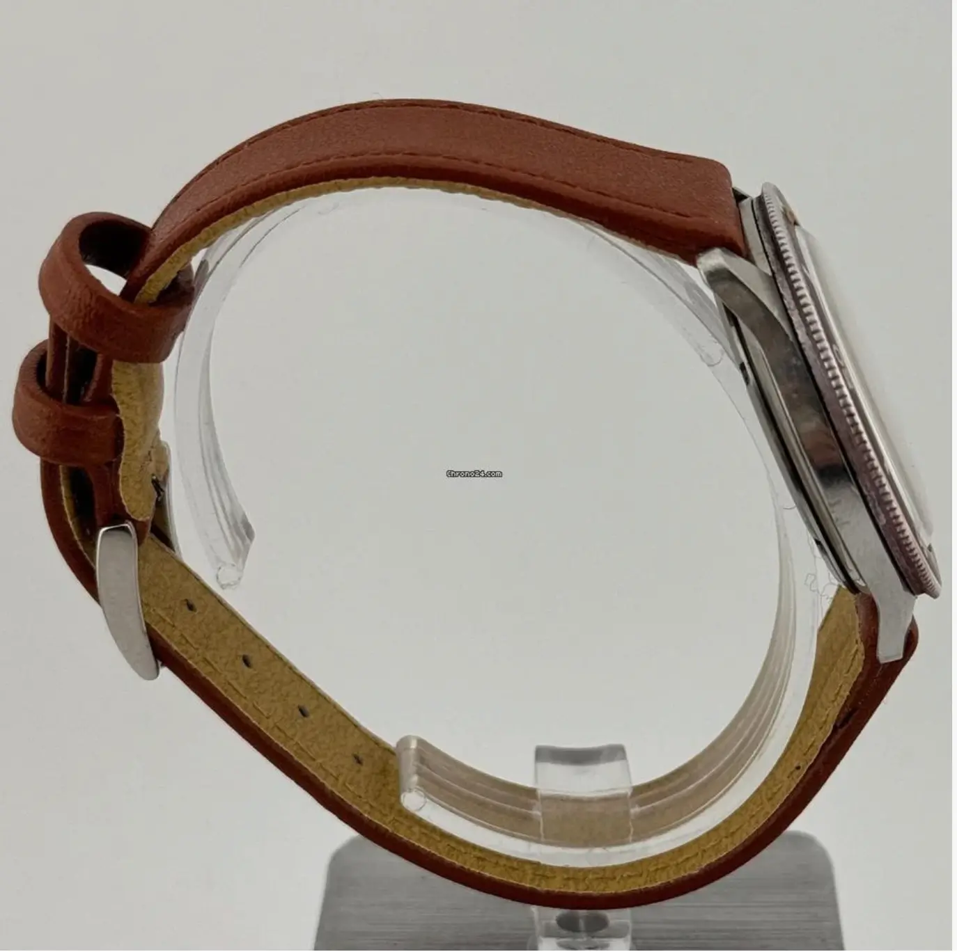

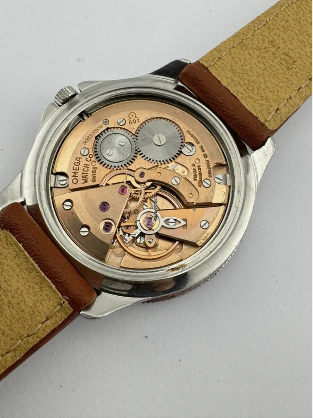

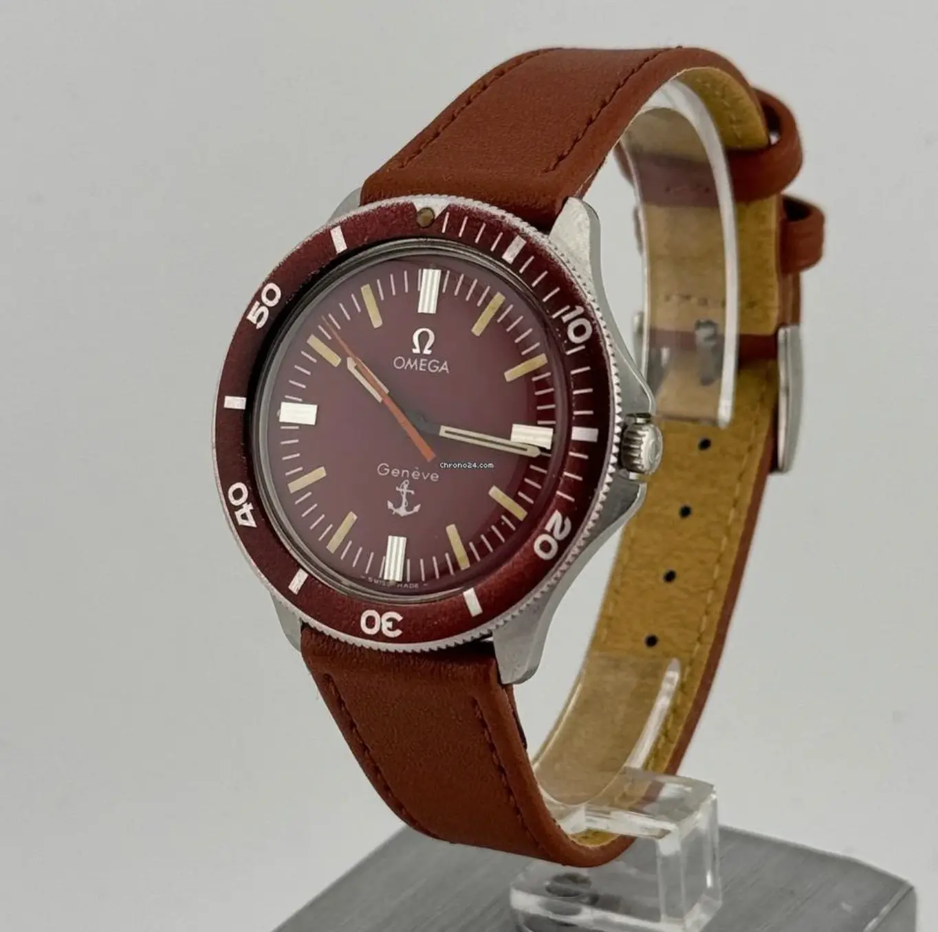

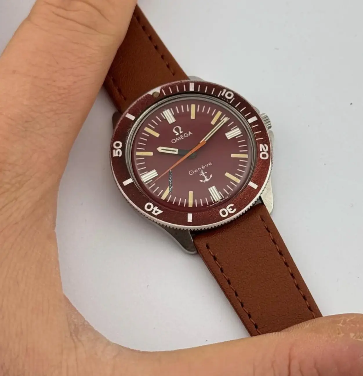

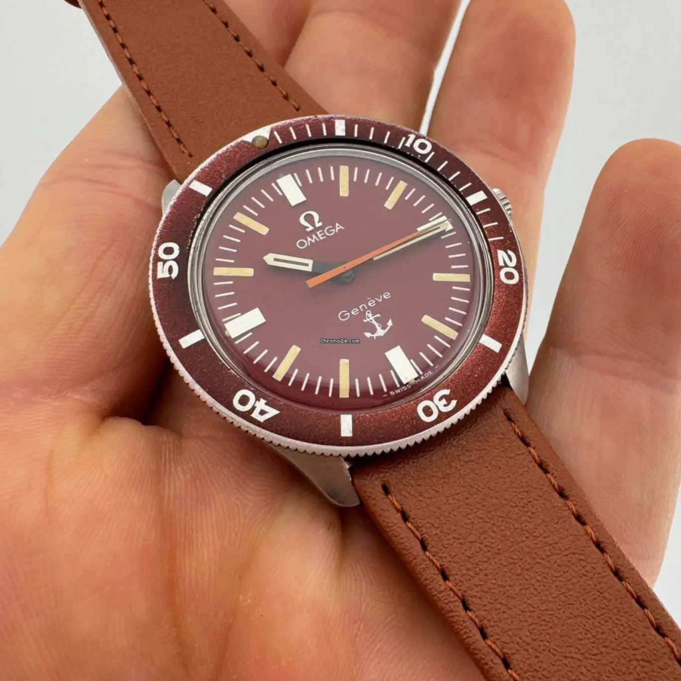

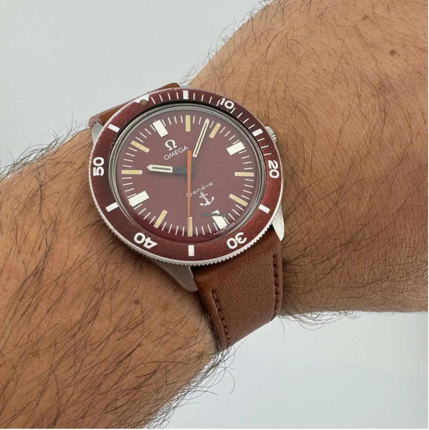

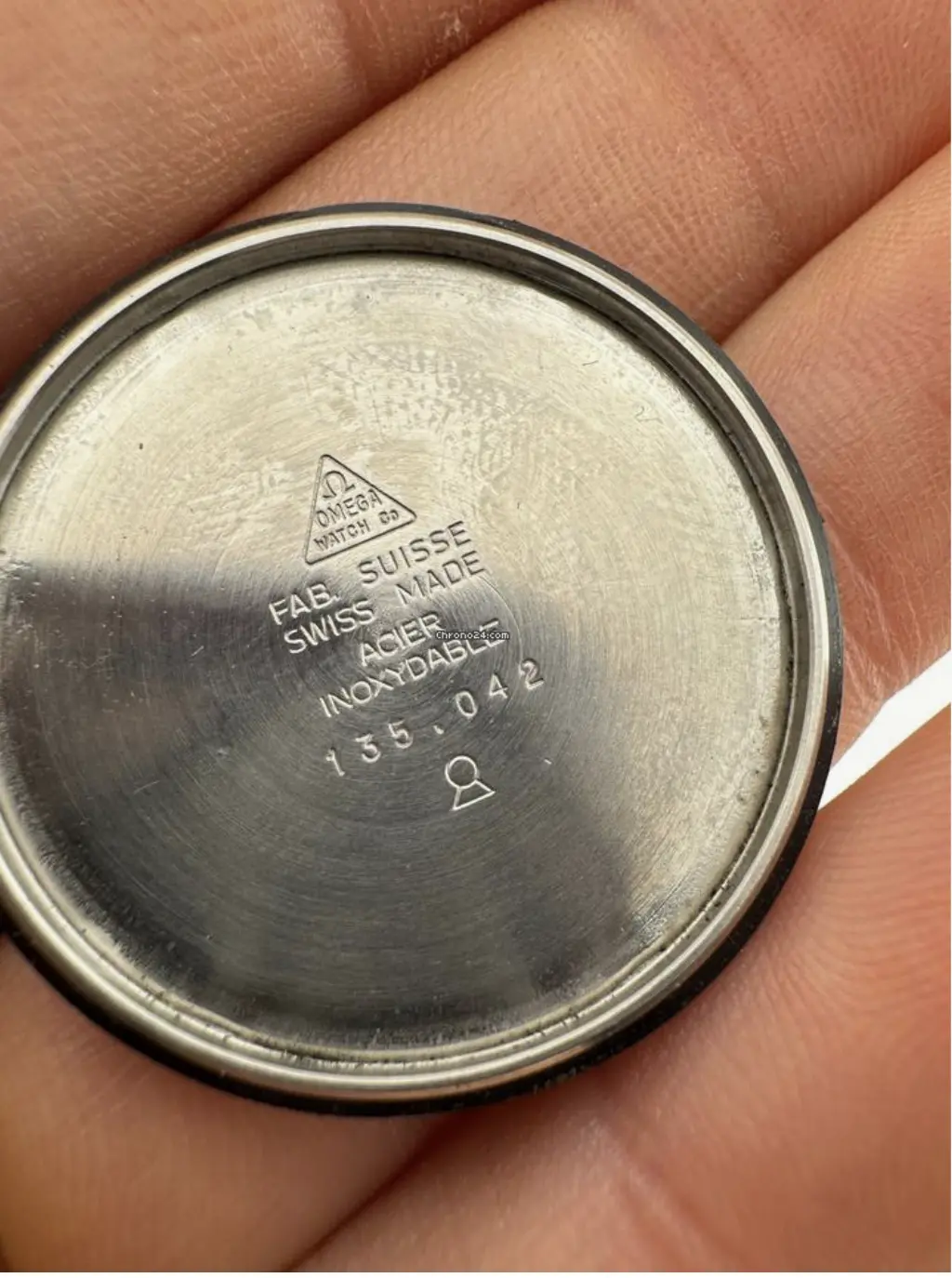

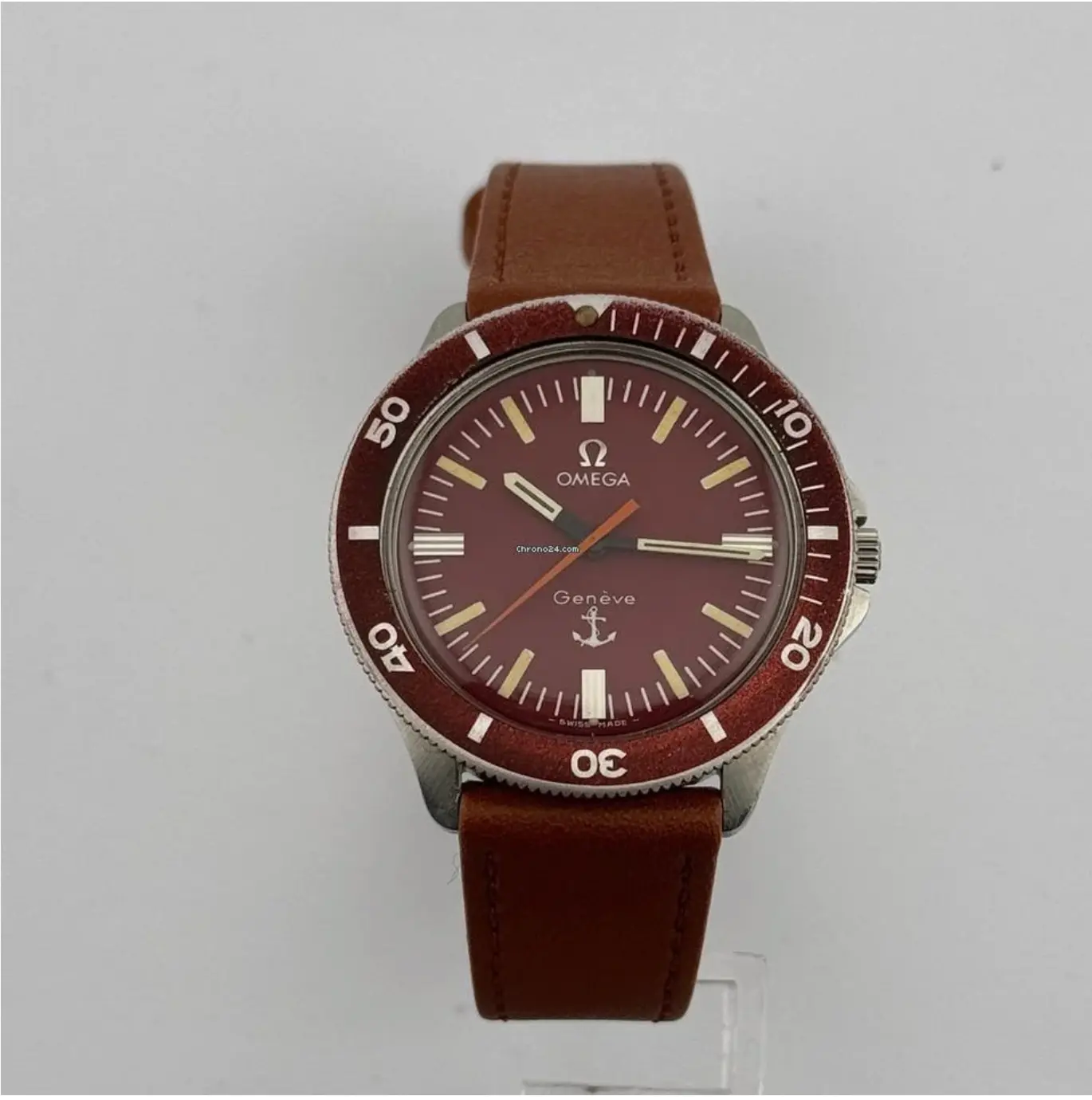

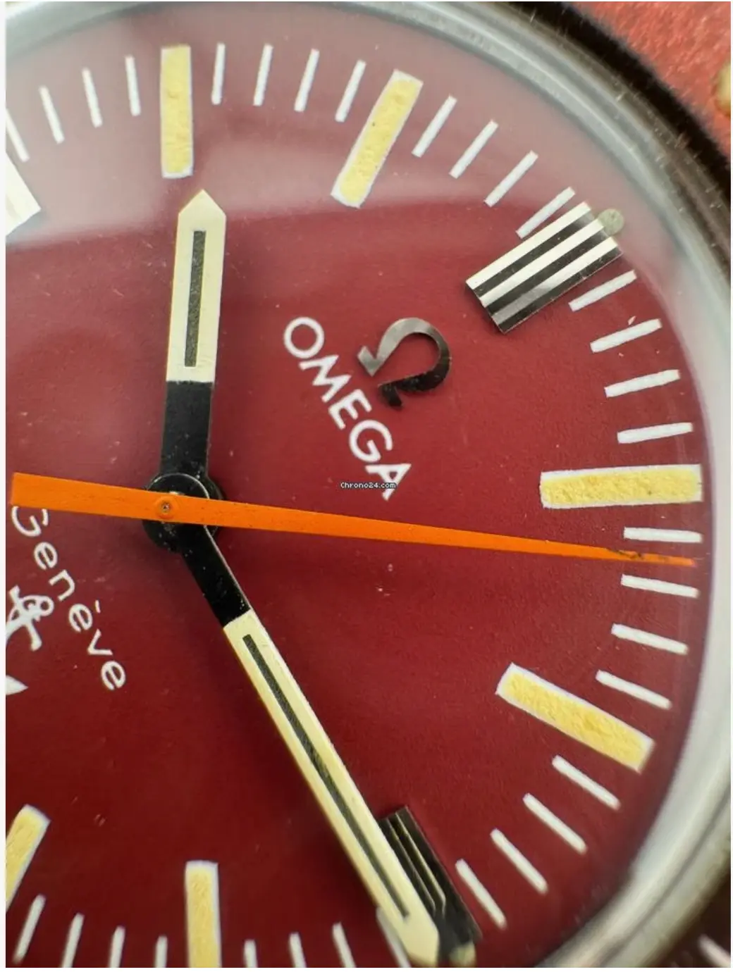

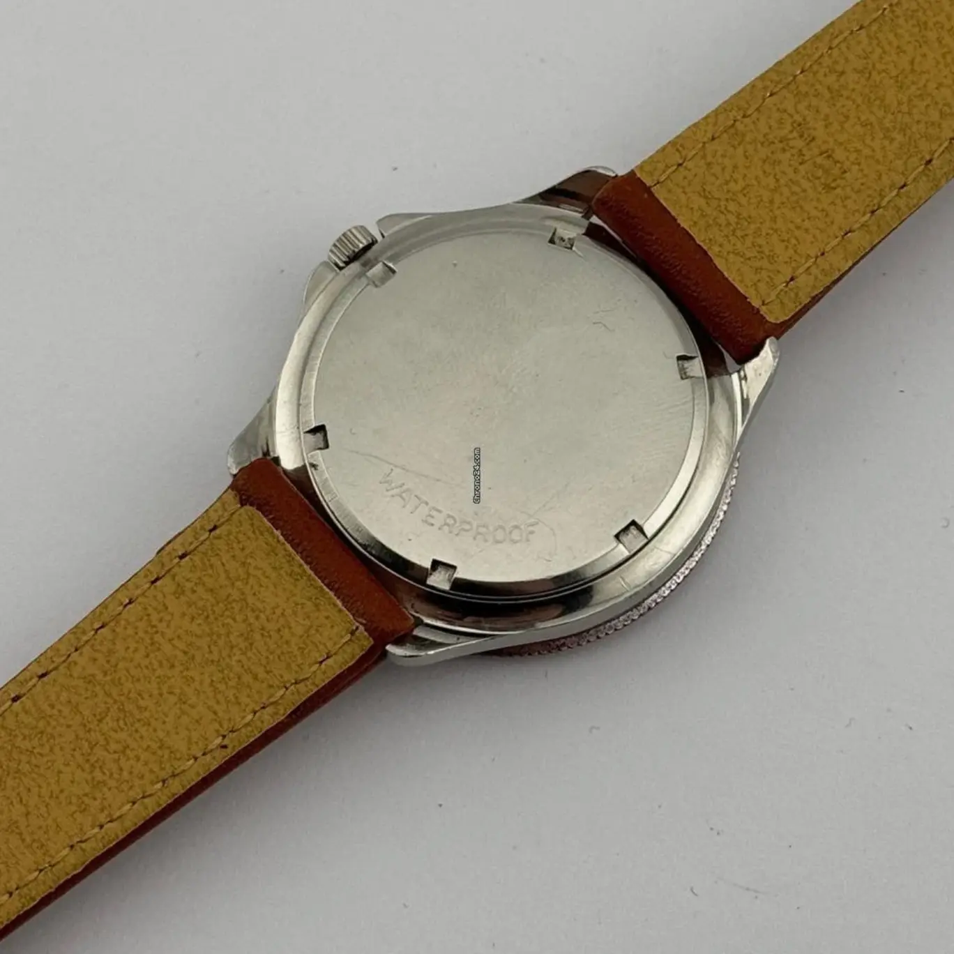

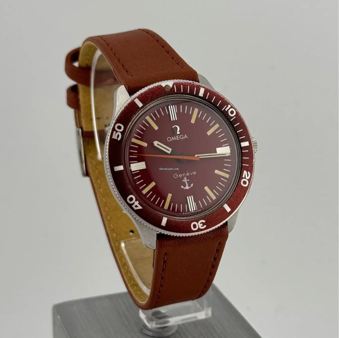

Hello everyone.

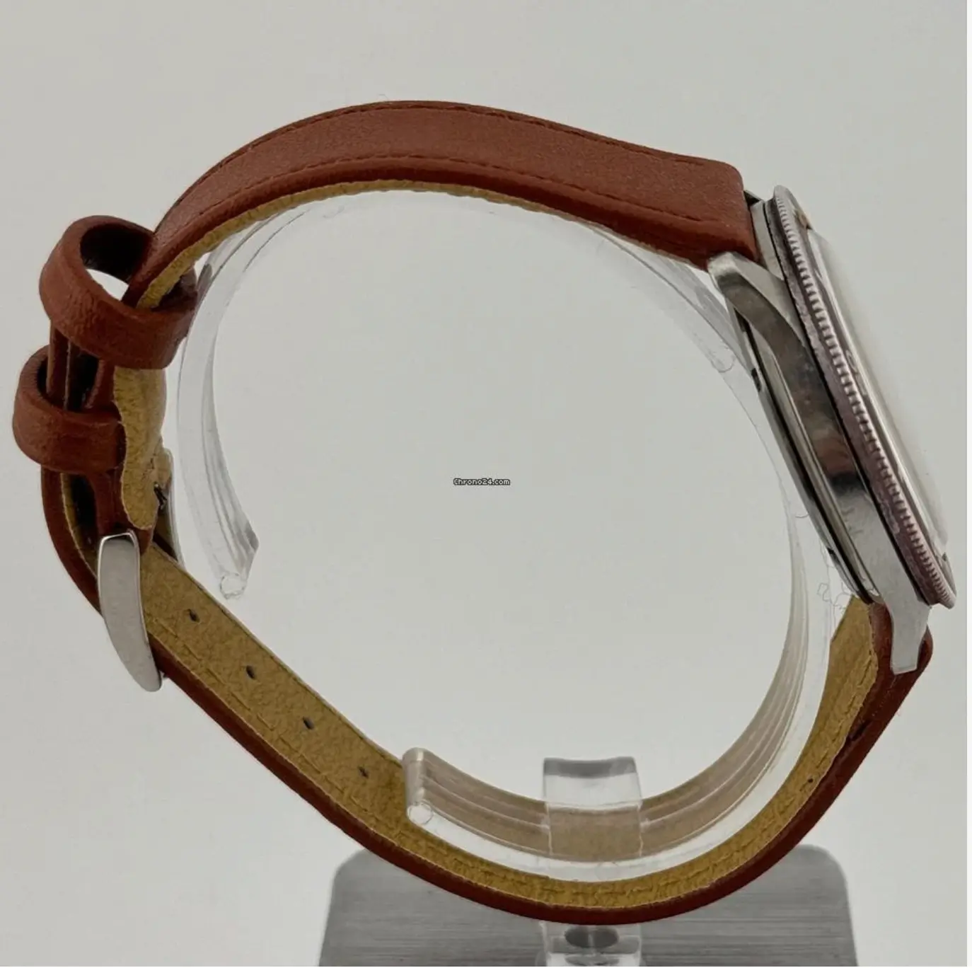

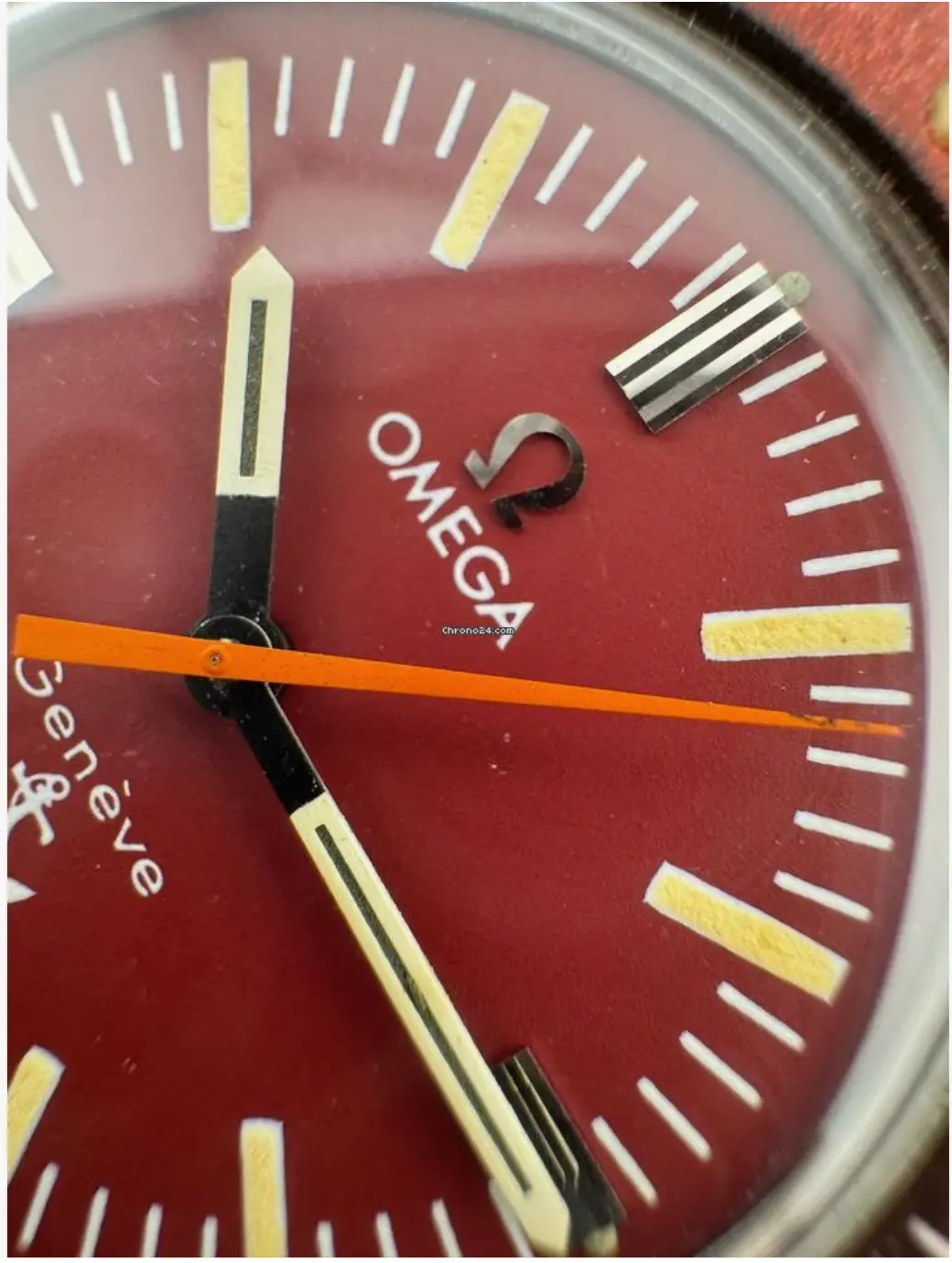

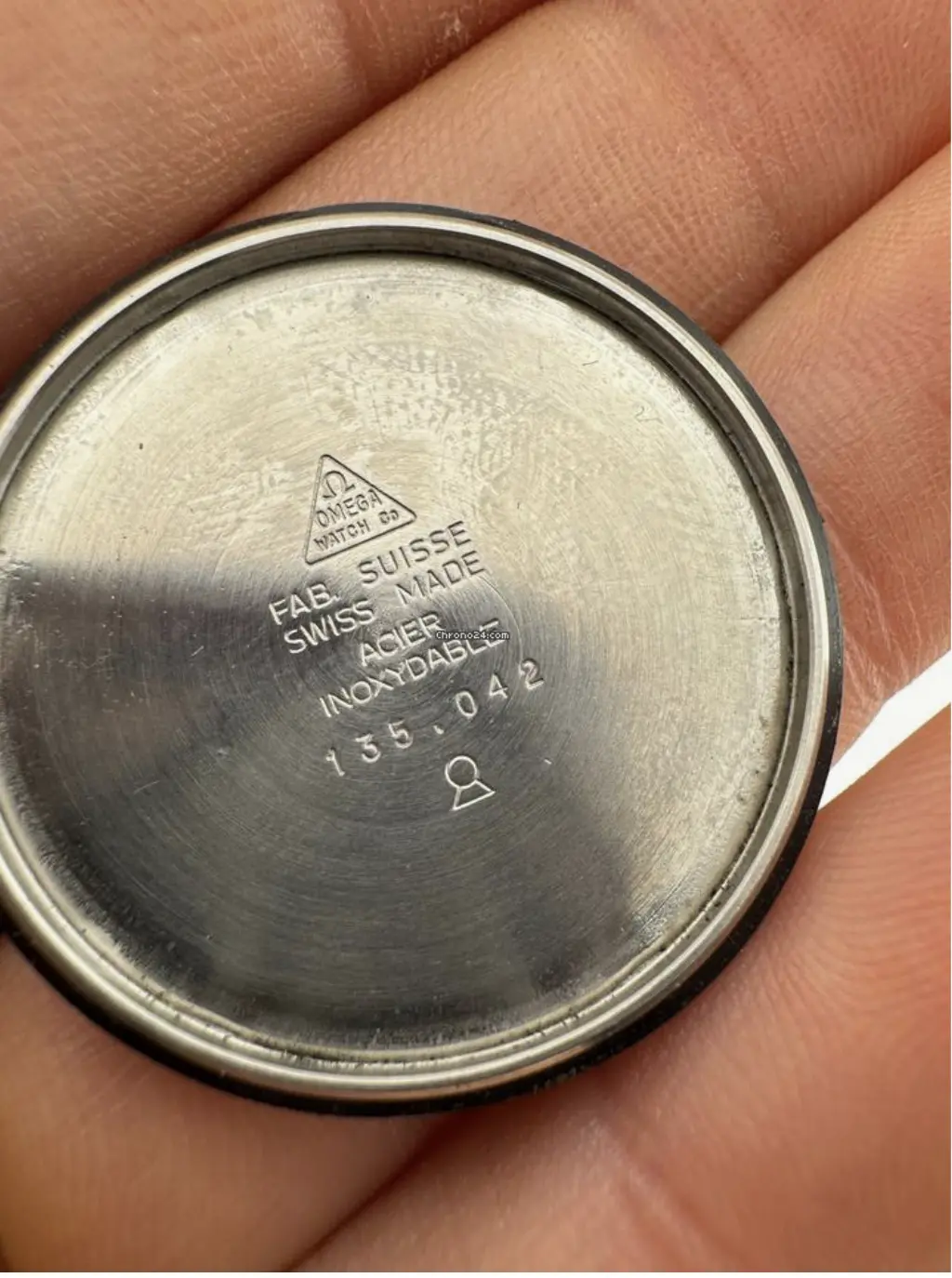

I spotted this 135042 on Chrono24.
I would like your opinion on it. The winding crown seems suspicious to me, the bezel has a strange burgundy tone and also the mechanism that despite being declared to have been serviced seems a bit dirty.
I am convinced that your more keen eyes will be able to tell me more.
I attach photos and links
Thank you for your cooperation
https://www.chrono24.it/omega/omega...ual-winding-calibre-601-swiss--id37335414.htm
Yes indeed! That's what i tried to say, i never knew that for several years.

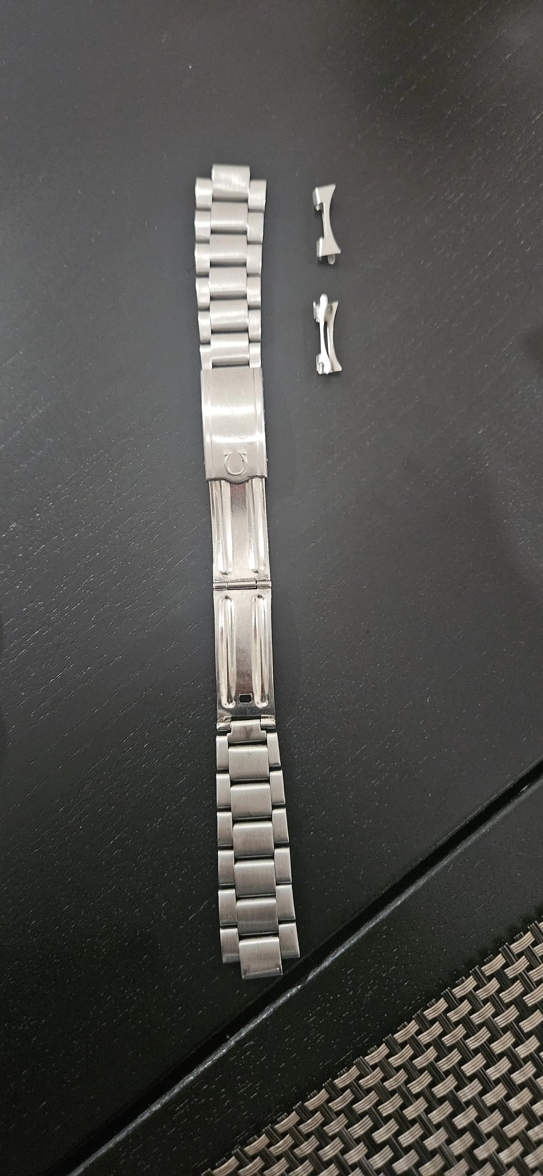

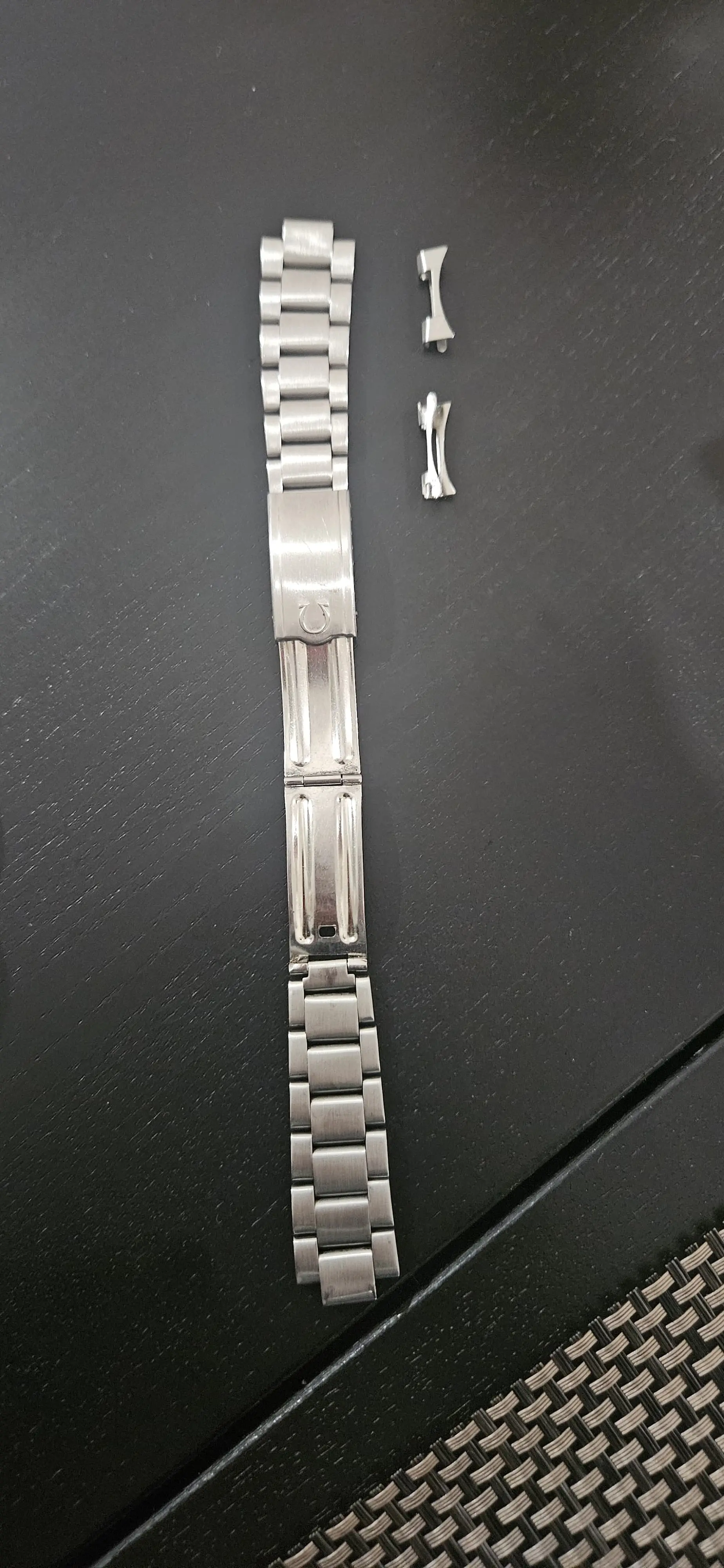

Pictures attached. I think it can be fixed with just some polywatch.
What about the bracelet, where could I buy the original brushed bracelet? Also don’t hate at all the Fixo flexed bracelet.
Picture of the original bracelet also attached.

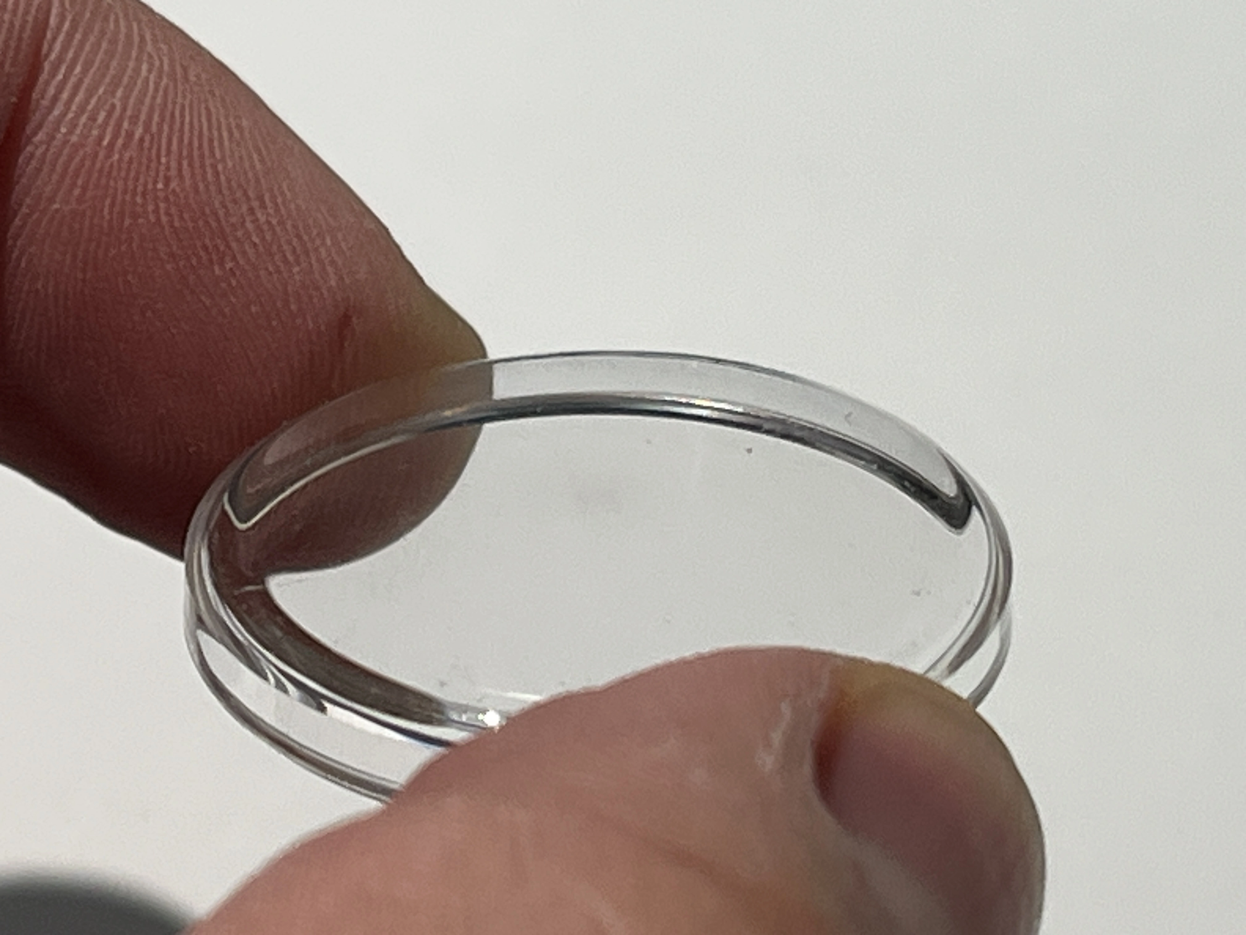

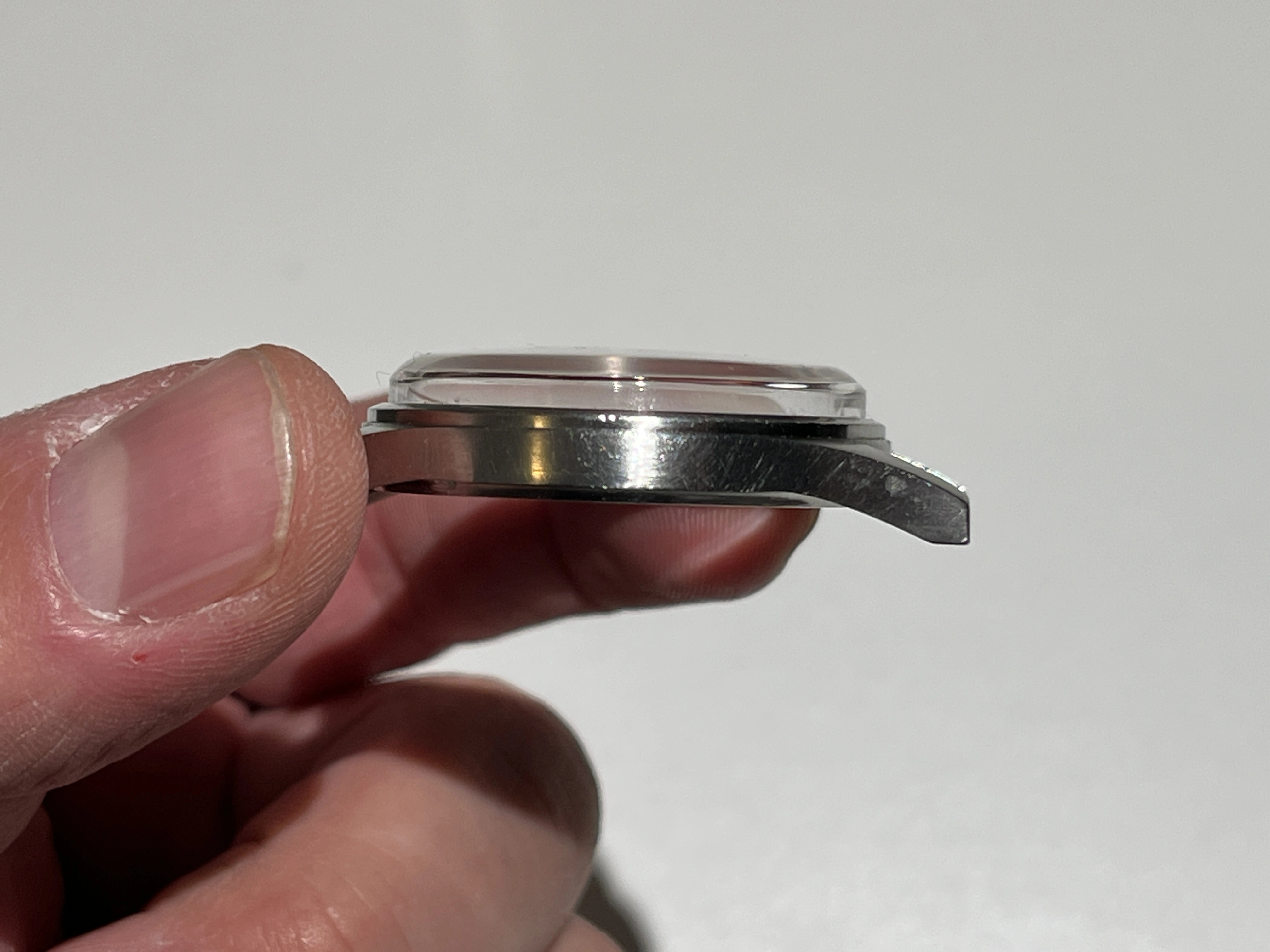

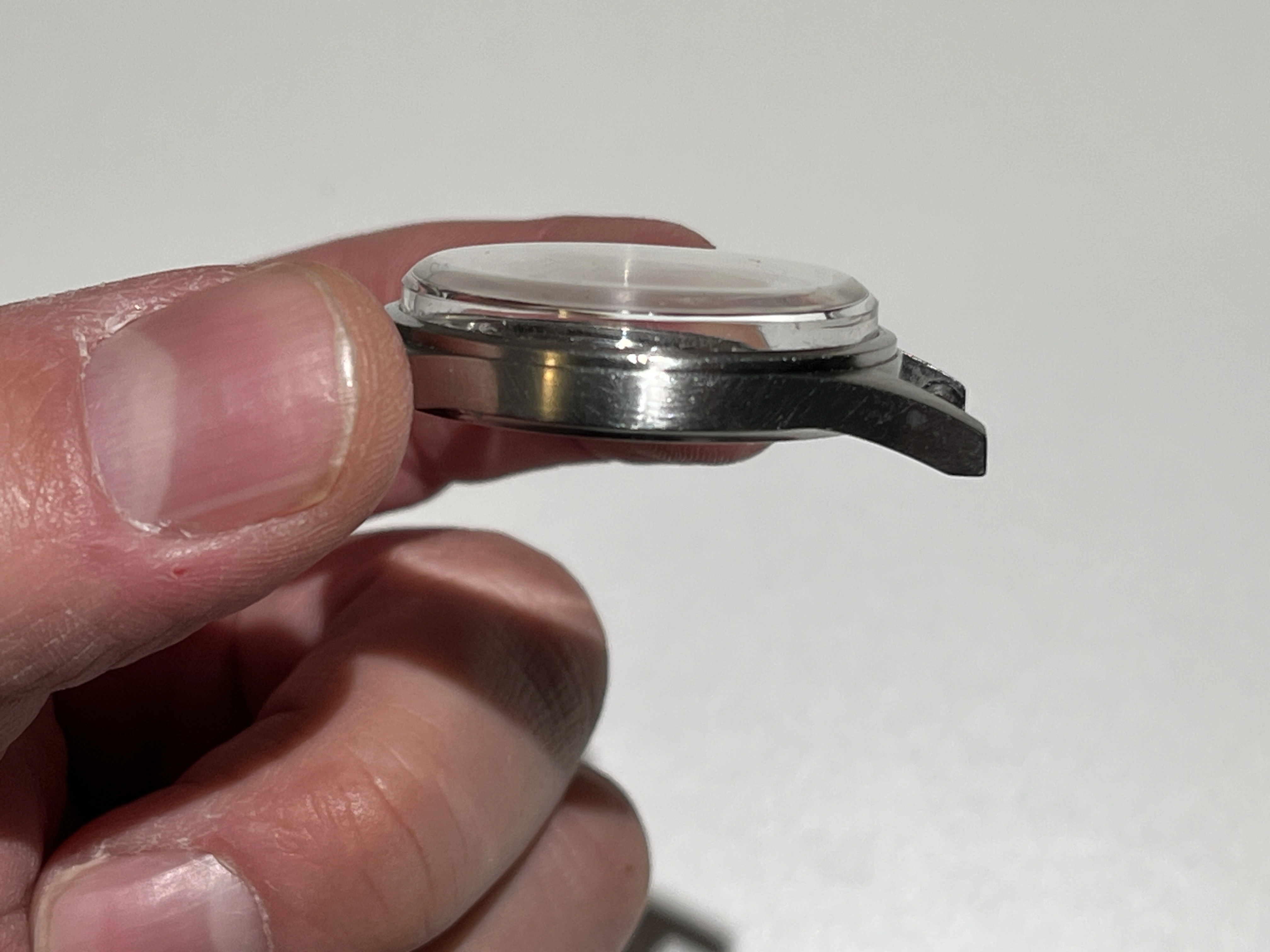

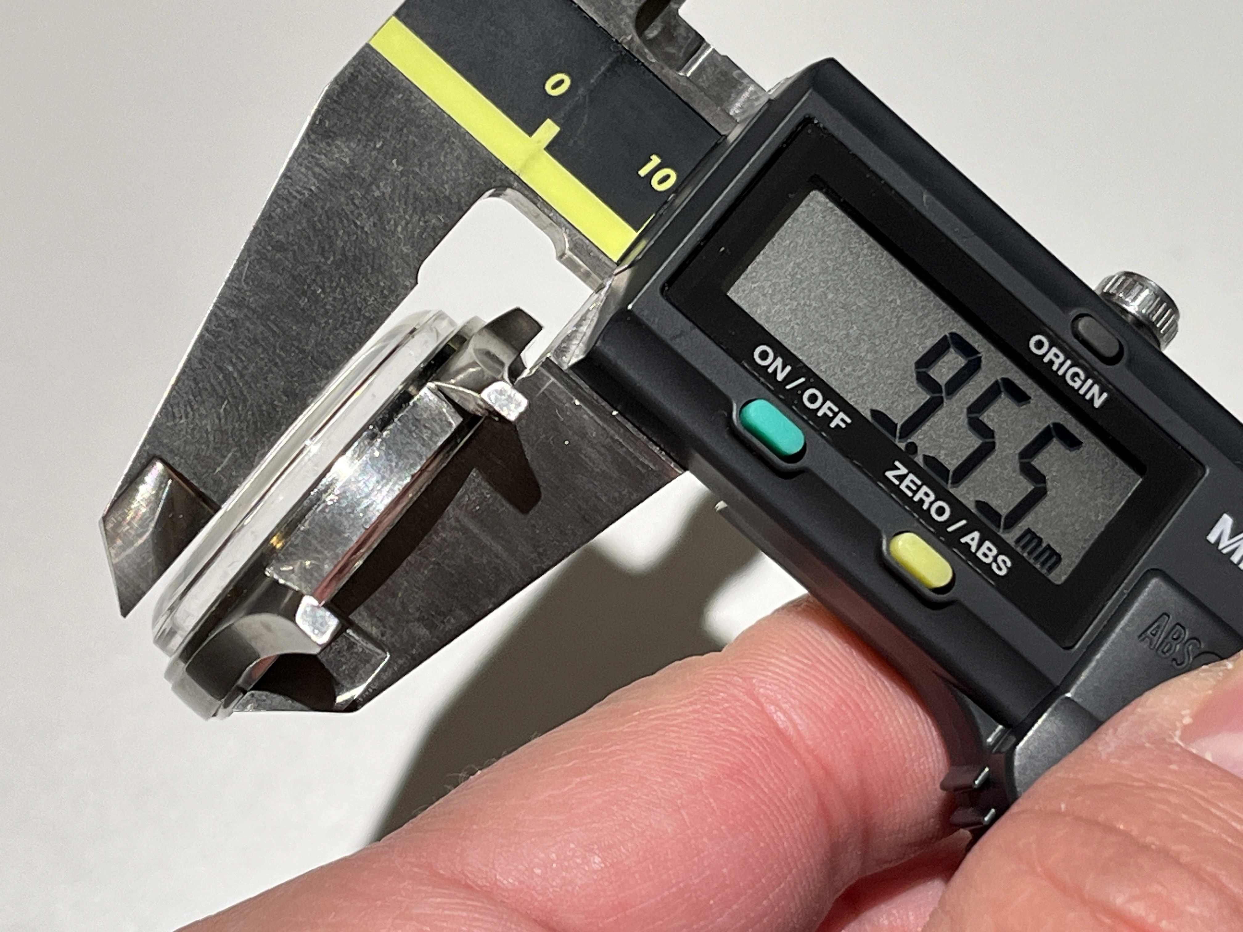

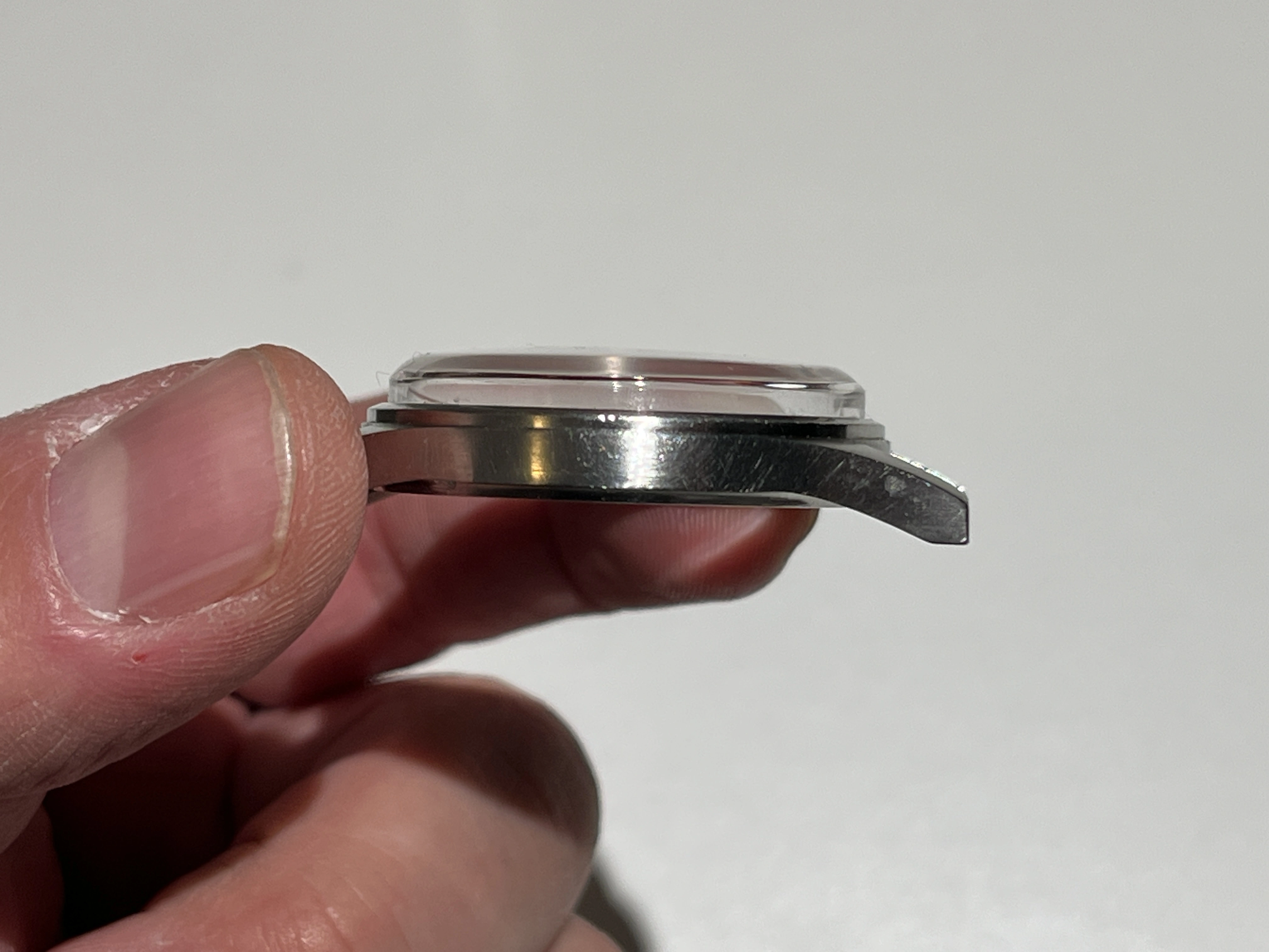

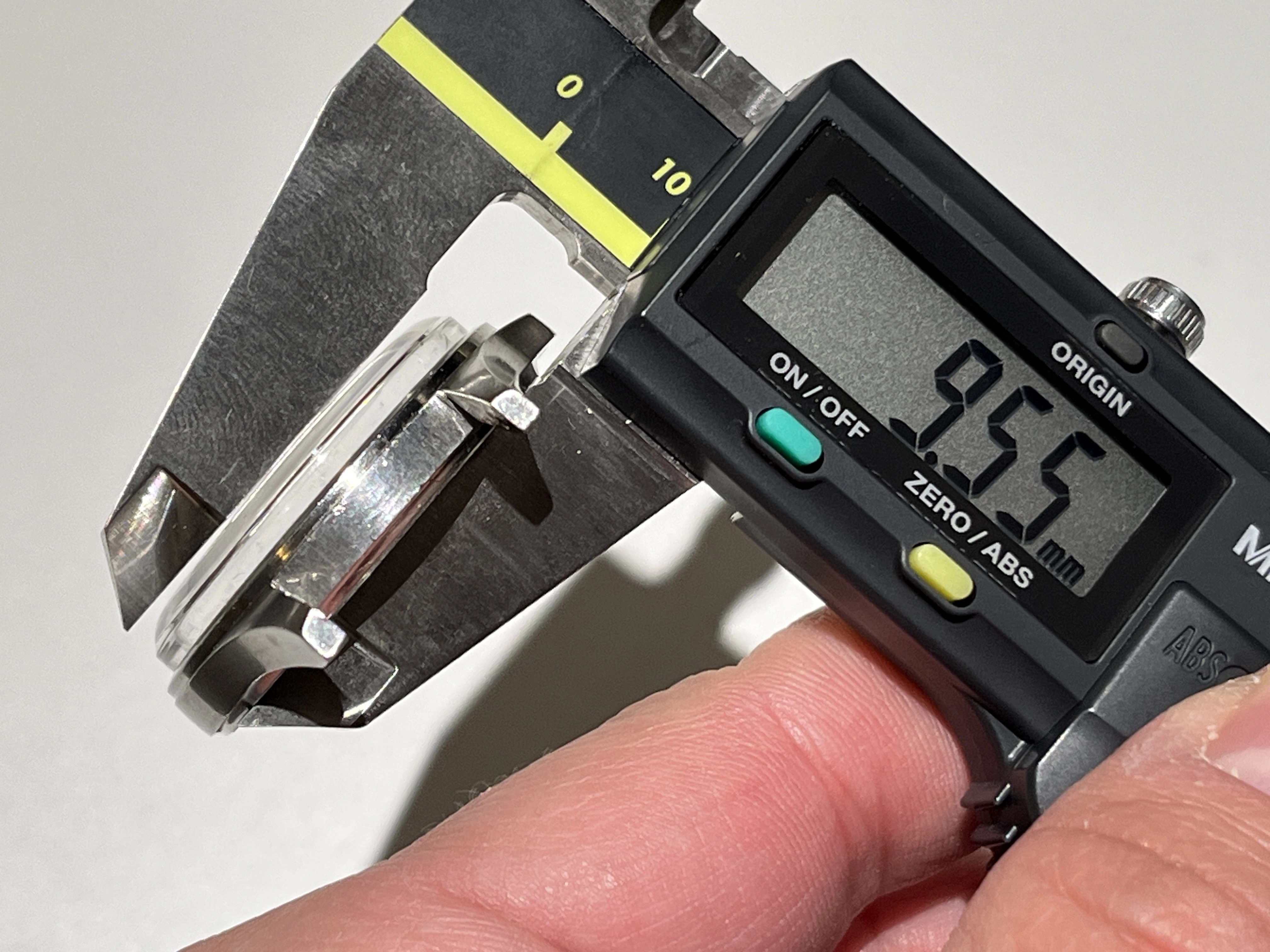

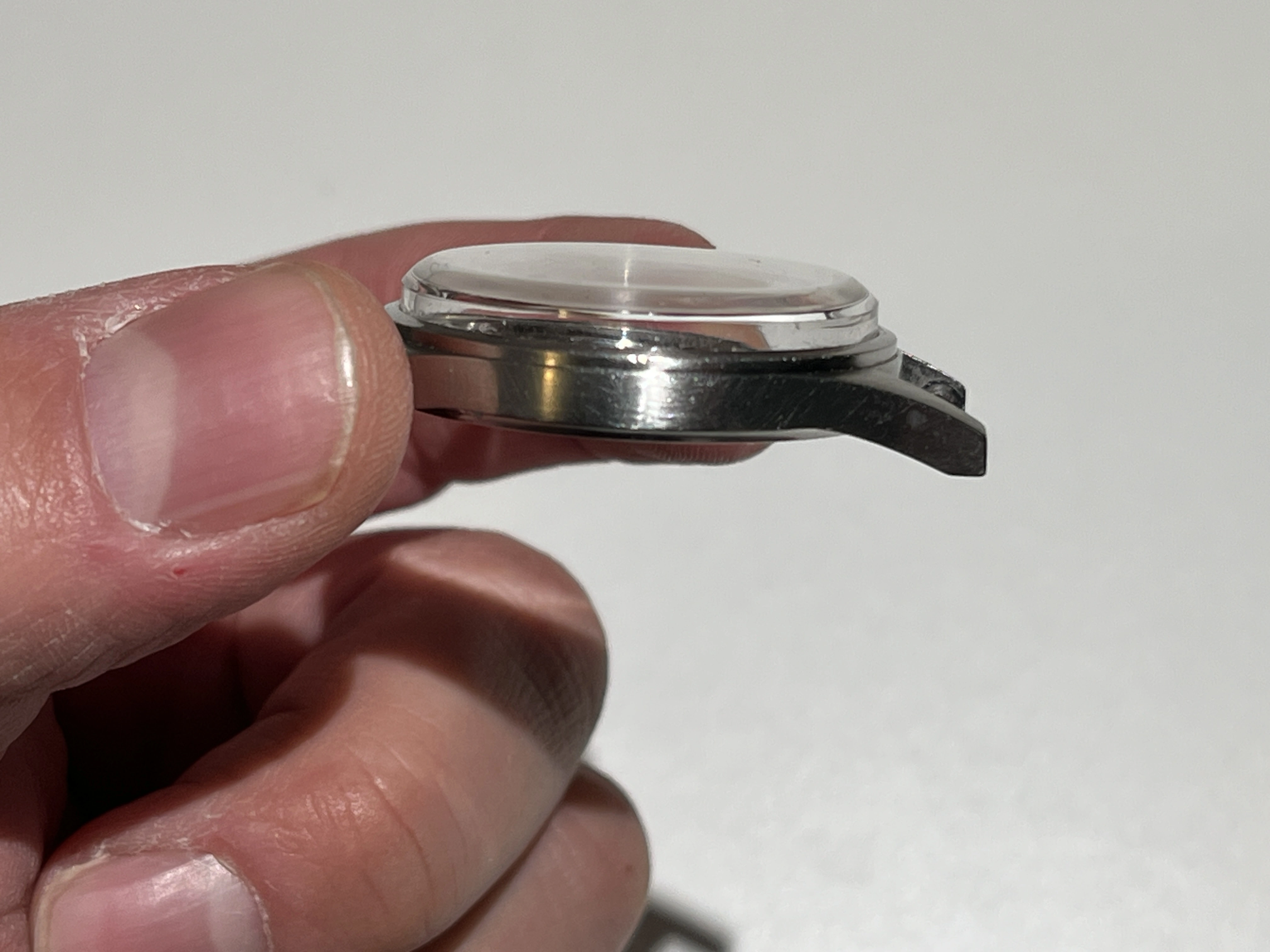

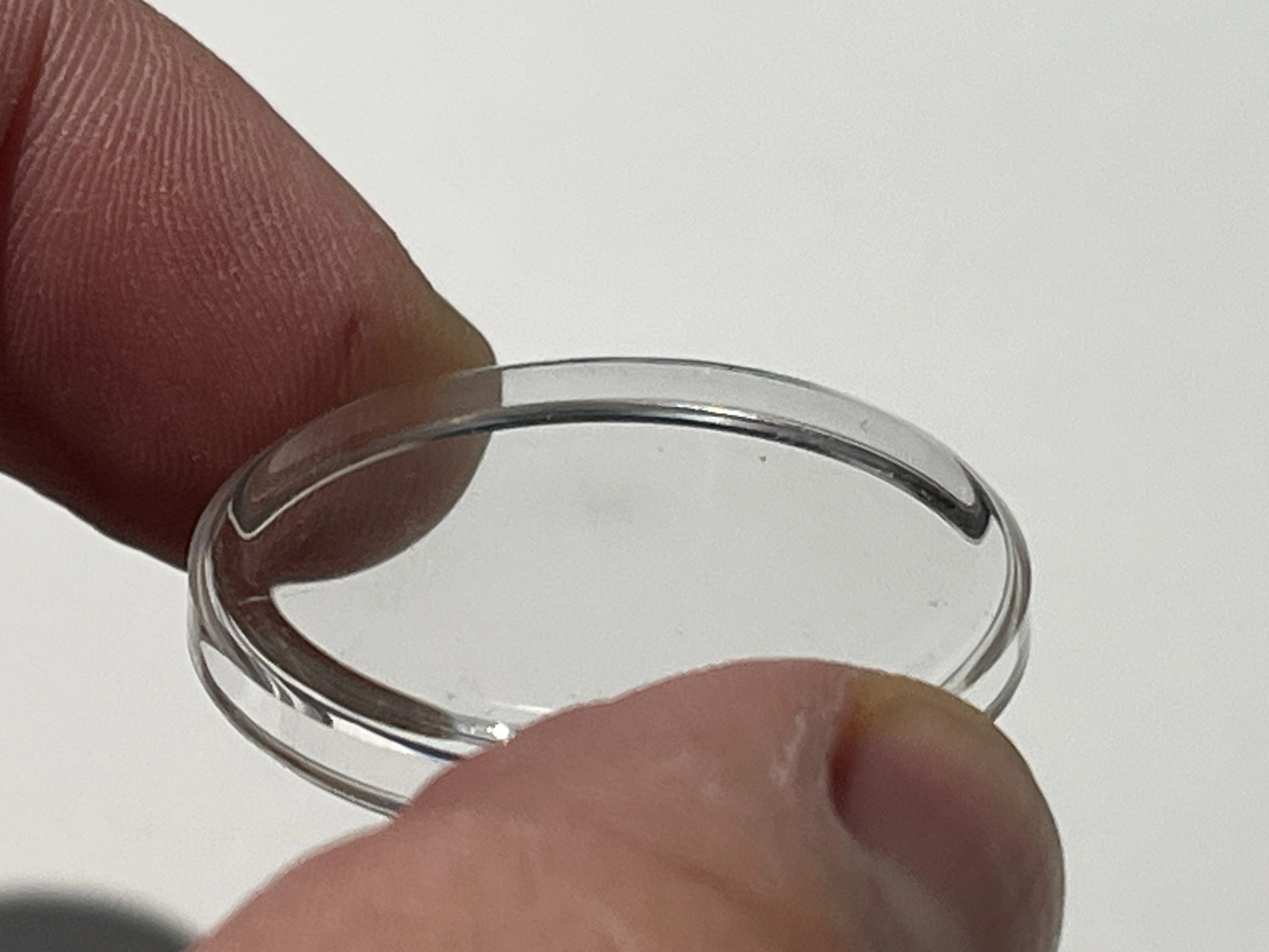

Hello everyone, I've obtained a 136.015 and have just installed a genuine NOS 5127 crystal. I bought the crystal through a dealer. But it looks so high. Can anybody tell me if this looks correct? The crystal is pressed all the way down, so it's installed properly. The last picture shows a measurement without the case bottom. Thanks for your help!

It was the wrong crystal. The diameter was correct, but height was too high. I ordered two other ones from different dealers with the proper height: both height around 3.9mm (crystal itself). Diameter around 31.7mm.

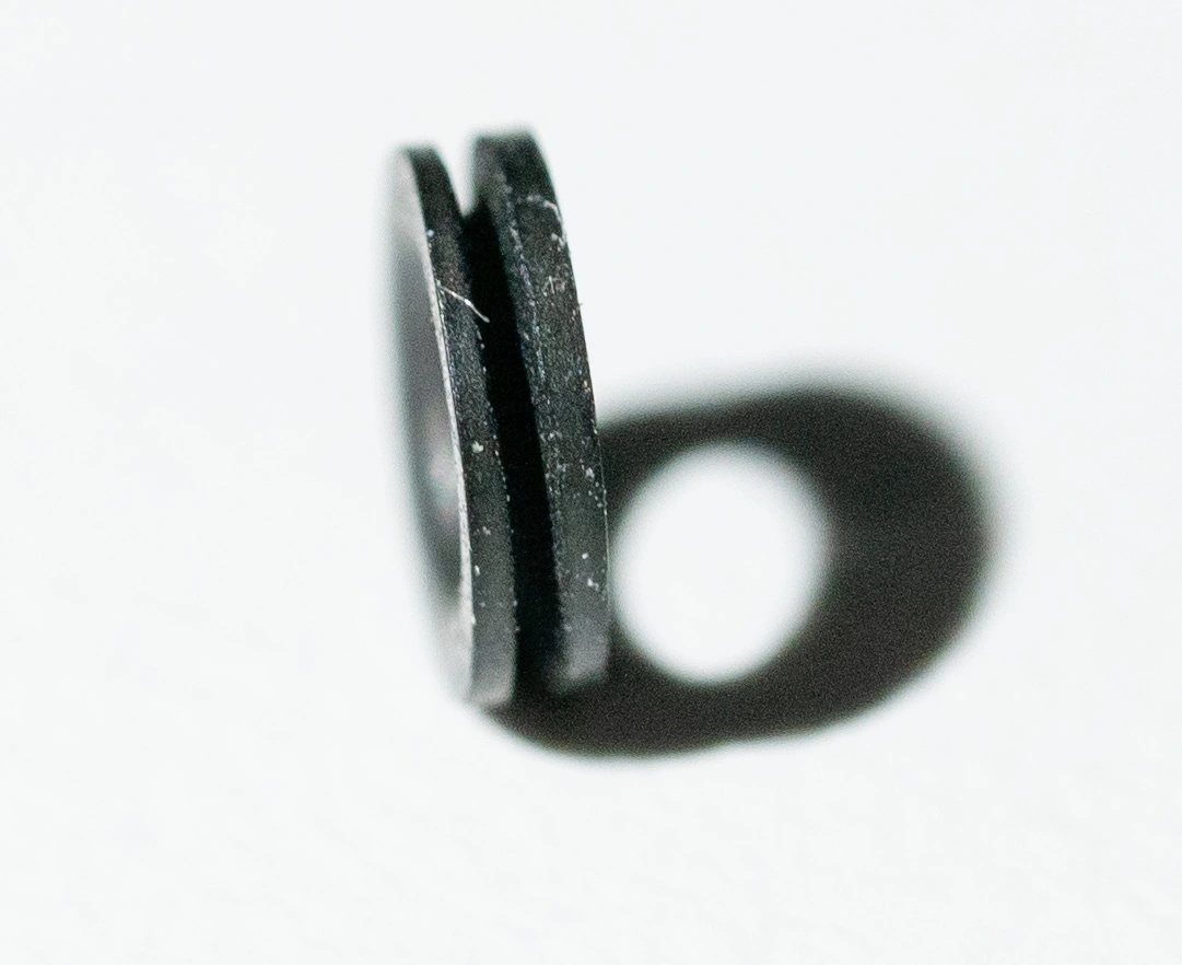

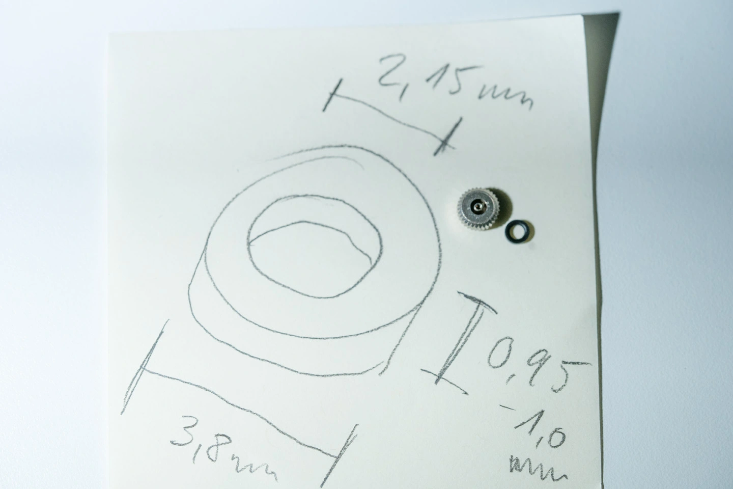

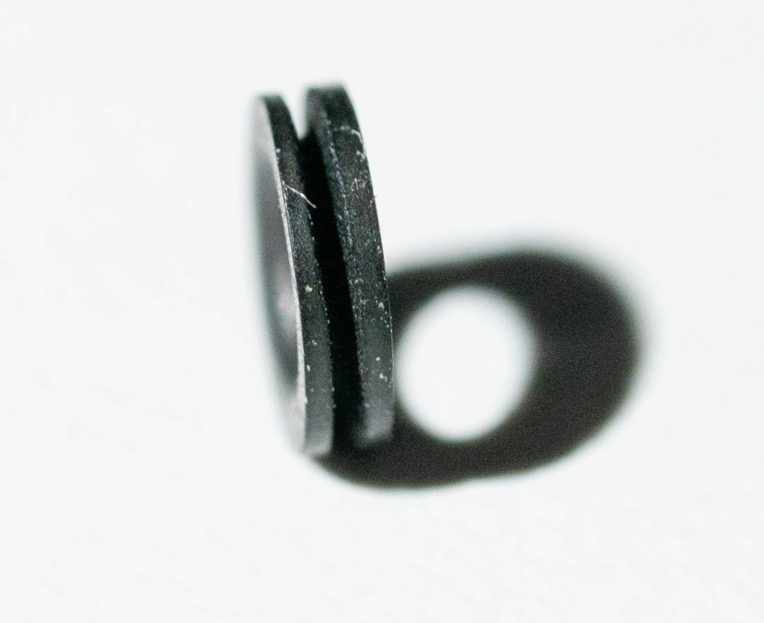

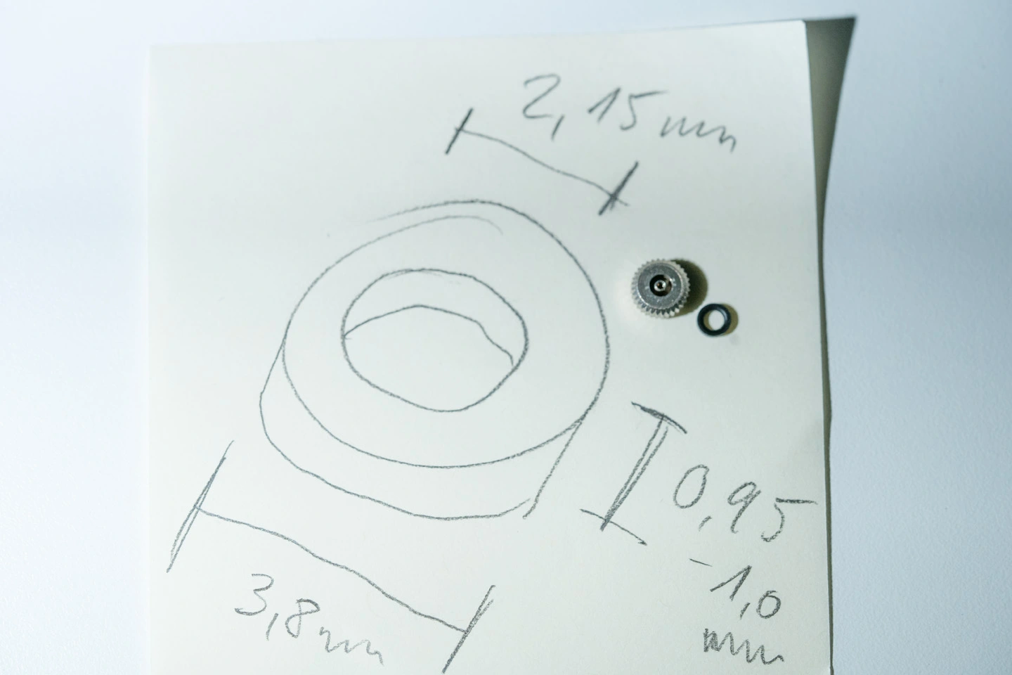

I replaced the gasket of the vintage crown 42057. The original gasket looked like this, see the photo. And it had a tiny steel ring inside the gasket, which remained now in the crown. I actually replaced it by a round gasket. It pushed the steel ring to the side. This replacement one has the dimensions: outside 3,75mm, inside 2.15, thickness 0.8mm. Same I used on vintage Speedmaster crowns.
