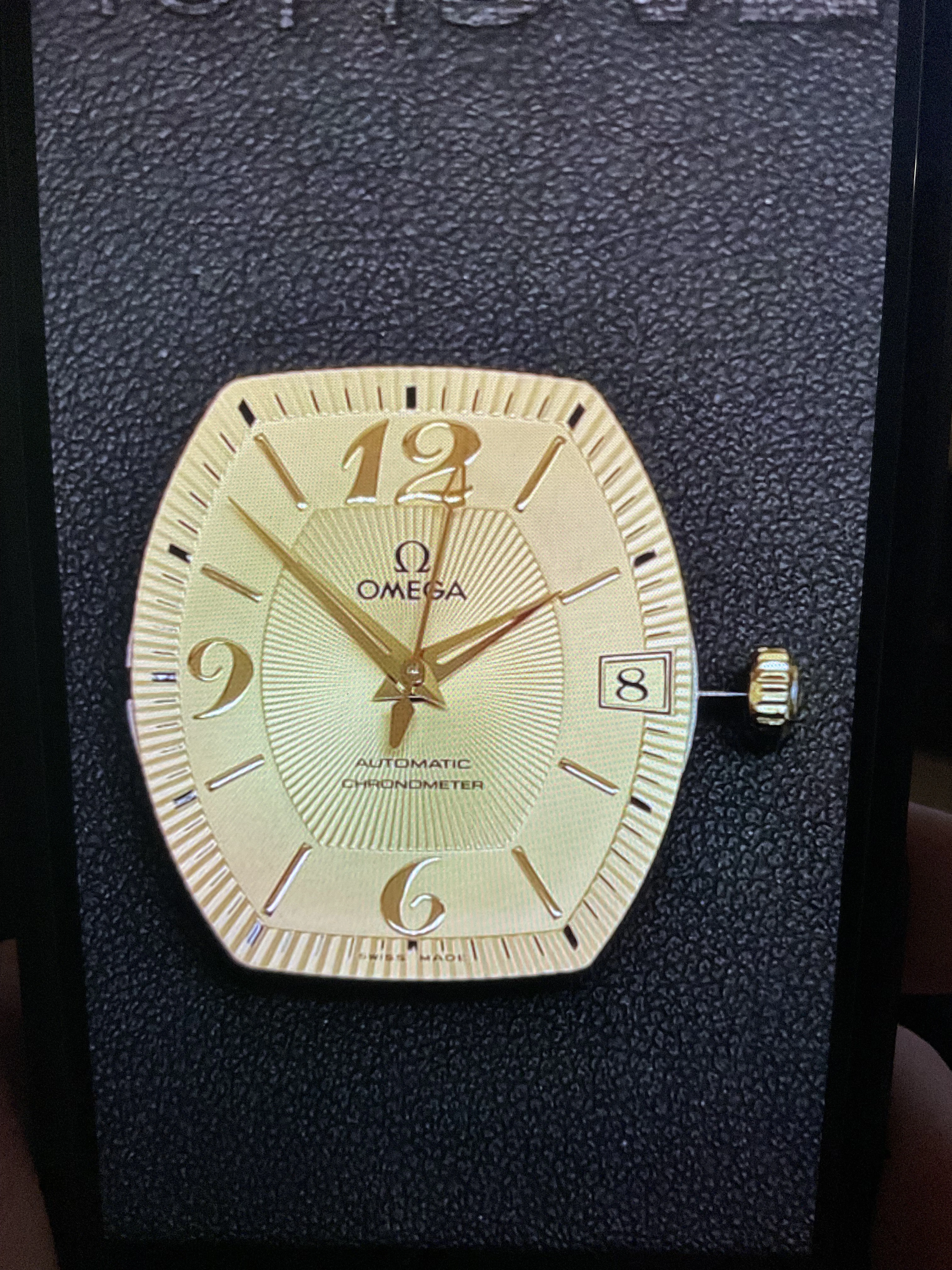

Just a quick question as some of you may have tried or have actually done this..
I’m looking for a complete case for movement I have a presage tonneau which was saved from the melting pot the movement dial hands are like new from day one but unfortunately the case was worth more melted then actually worth as a watch. obviously isn’t going to be the 18ct one lol but maybe a stainless steel one with a funky contrasting gold dial lol ?
Can an omega service centre supply a replacement case ?

That's probably a big ask for an Omega service centre. If they were willing to provide a new case it might have to match the movement and dial of the original watch, i.e. an 18kt case. That just wouldn't be cost effective. In fact a replacement steel case isn't going to be very cost effective either. It's a shame someone gutted the watch and sold the case for scrap. This wasn't a great collectible piece but it was a nice watch before the scavenger got to it.

I doubt Omega would create a franken.
Best outcome is that you have a chronometer movement that should be worth a few $$$.

That is a really great dial, I wonder if you could find a steel version of the same watch in need of some TLC and do that swap, then have a spare movement 😀
Any idea what reference that is from?

The movement caliberof the OP watch is not noted. The dial is indicitive of a ladies style. The smaller 18mm movements even the 684 chronometer do not have much value.
The 56x automatic movements (and related.) are probably some of the best mass produced movements ever made (and probably will be since there is no longer a need for such things.) Cases though remain a bottleneck. Back in the day before quartz and timex, a lot of swiss movements were sold in the rough. These then cased locally. Sometimes under license.

It remains in Omega's best interest to sell you a new watch from the latest catalog. There is no real value in the vintage stuff other than reputation and prestige.
So that leaves, what the rest of us do, which is to check online sites like eBay daily if not hourly for empty watch cases what are compatible with the movements.

1 nit, AFAIK, the 684 isn't a chronometer, the 685 is!
Rest, I agree with, the 550 family/601 family are amazing watch movements, and the 684 is a great miniaturization of them.
Round cases are particularly easier, anyone with a lathe and some talent can knock out the inside of a case reasonably easily (plus some additional work for lugs, but I'm less concerned about that!). Rectangular/odd shaped cases are challenging thanks to the crystal though, oddball/non-round crystals are the bane of my watchmaking existence 😀
Dial is nice yes and it’s obviously fully working condition which is why I purchased it. Hahaha yes that’s the idea but it’s then always down to cost and actually finding one

EDIT: I THINK i found the model, a 4603 perhaps? https://www.omegawatches.com/en-us/watch-omega-de-ville-prestige-tonneau-4603
Looks like the stainless version is a 4803: https://www.omegawatches.com/en-us/watch-omega-de-ville-prestige-tonneau-4803
Or maybe the 4503? : https://www.omegawatches.com/en-us/watch-omega-de-ville-prestige-co-axial-45033100
That said, I can't find any that need TLC online, so that might be a hunt...
Yes I think it’s the top one I believe they only made 1 18ct model with the 18 ct bracelet also
Would omega know? 😄😉 guessing they’d want to fit it. I paid £200 so I don’t believe it’s overly priced
Yes definitely a shame that it got scrapped but unfortunately that’s the gold industry for you. I do believe they tried to sell for a few months at spot gold price but had no interest. I know it’s not very collectible as of yet but it’s unique and has a great cal and wasn’t a bad price so I had to. Even if I can get a case for 350 400 ish maybe even cheaper for under £600 a complete watch you think that’s not a bad cost completed ?

Yes I did have the idea if a case pop up I can retro fit it or even just selling on dial and hands and buying a vintage chronometer and see if can swap out the movement and using a vintage dial kinda like sheep in Wolf’s clothing 🤣
But where will you find one? These aren't exactly common. Were you to find a watchmaker with a parts account who would take on the rebuild job, and that is not a given, you will quickly discover that a new case in steel would be 4 figures GBP. In gold approaching 5 figures. I think you have an expensive small paperweight there personally.
I wonder if we know each other, I am in the UK jewellery trade and interact with some of the refiners, manufacturers and pawnbrokers/goldbuyers.

hahaha yes but a nice little paper weight at that. Yes it may become expensive
But is just a little project I’ll have sitting about and see if anything pops up I probably have more of a chance of something with a damaged movement on a completely different watch but with the same movement I can use
This isn’t full time just a hobby and I’m not linked to any jewellery trade or others you’ve mentioned
If that is the watch (and from what I can see it is), the watch reference would be 46031101.
The case is still available and is part number 055BA1681220, but it's not cheap. About $5,800 US.
That is actually less than I would have thought for a solid 18K case.
Haha Thankyou, definitely won’t be buying that any time soon lol but I appreciate your research Thankyou. , I’d rather look at getting myself a speedmaster
