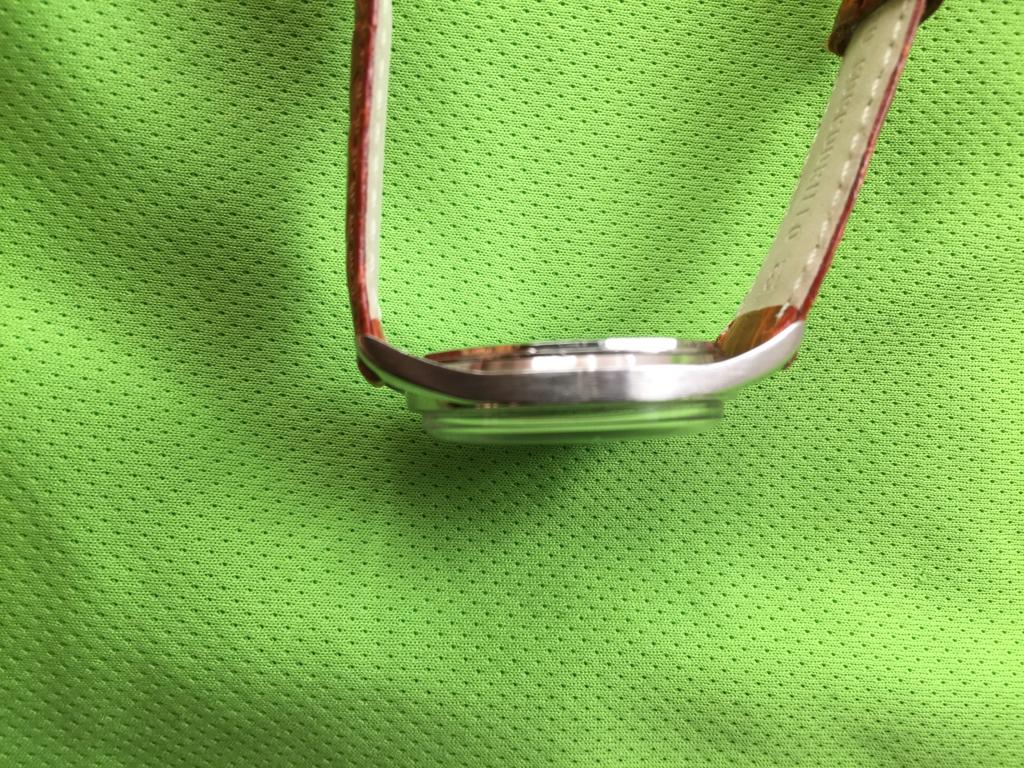

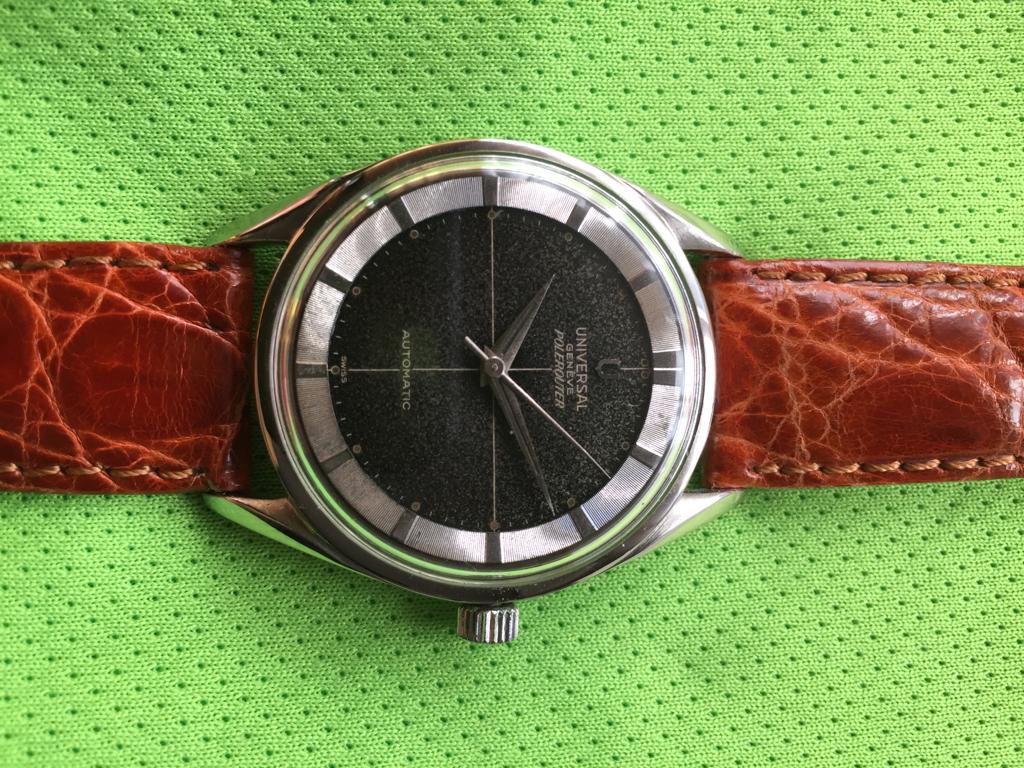

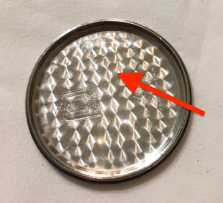

I suppose it depends on whether 'not bad' is what you are looking for and whether it's in budget.

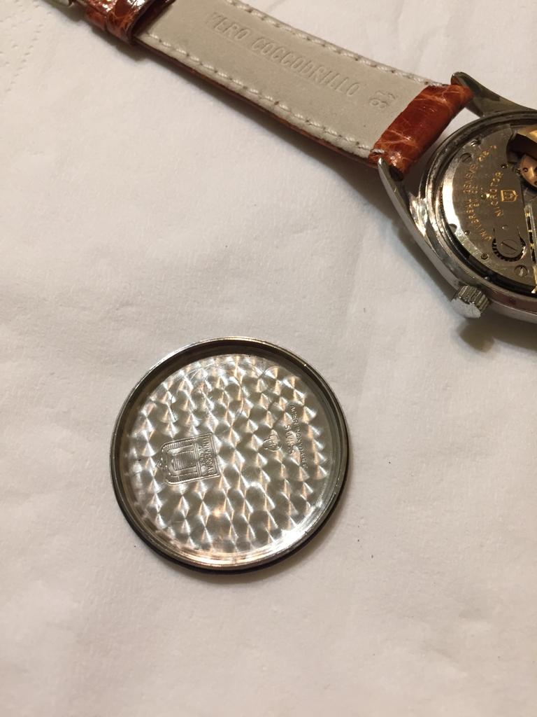

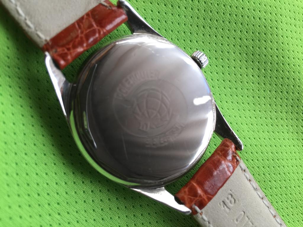

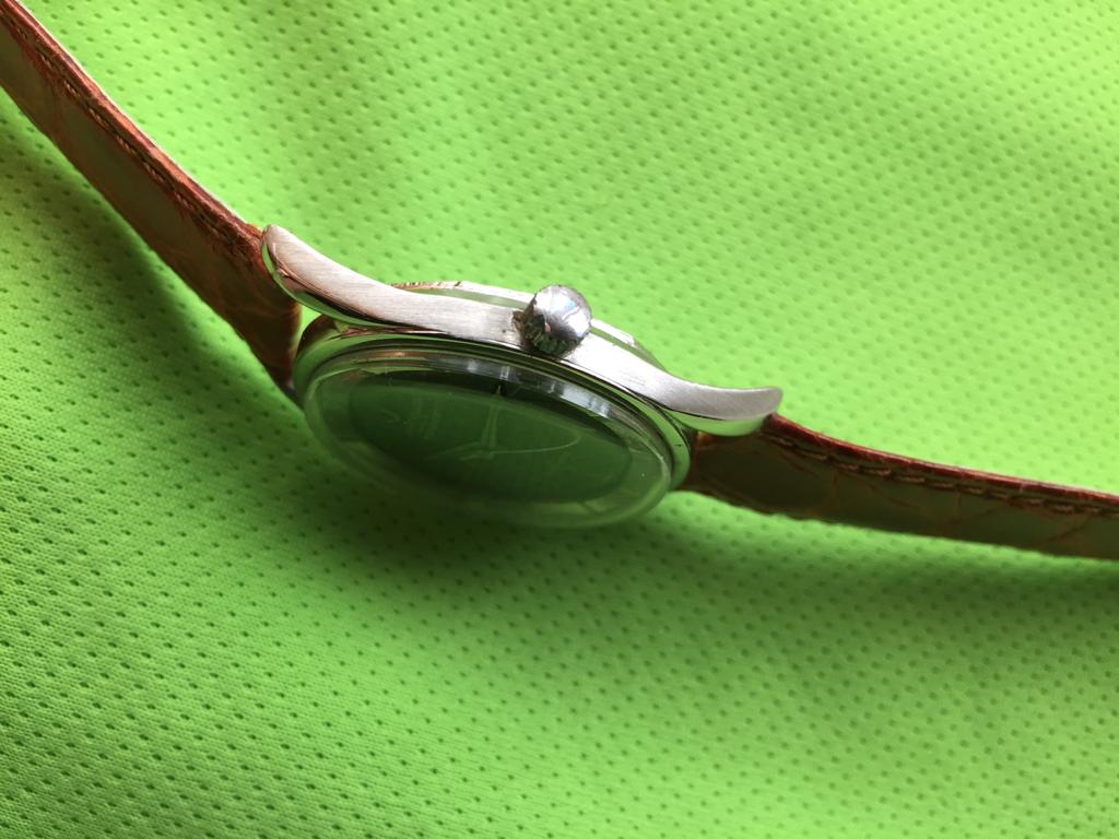

Horribly polished case back - I presume the serial and case ref are no longer visible (looks like a 20368-1). Lugs look well polished too.
Pretty heavy patina on the dial but not unattractive. Crown looks to have been replaced.

right comments, I do not mind the patina of the dial
obviously the caseback is not the top and the crown is to be replaced but the cost is really low.
But since I care a lot about your opinion, if you think it's better to give up, I'll follow the advice

The case backs were not deeply etched so it’s pretty special to find one that’s legible and crisp. The crown does not even appear to be a UG service part. Case has been highly polished. Dial has nice patina. I find that SS models can rock patina better than gold ones. As Mazoue said, the devil is in the movement with the micro rotor. These are a royal pain to repair.

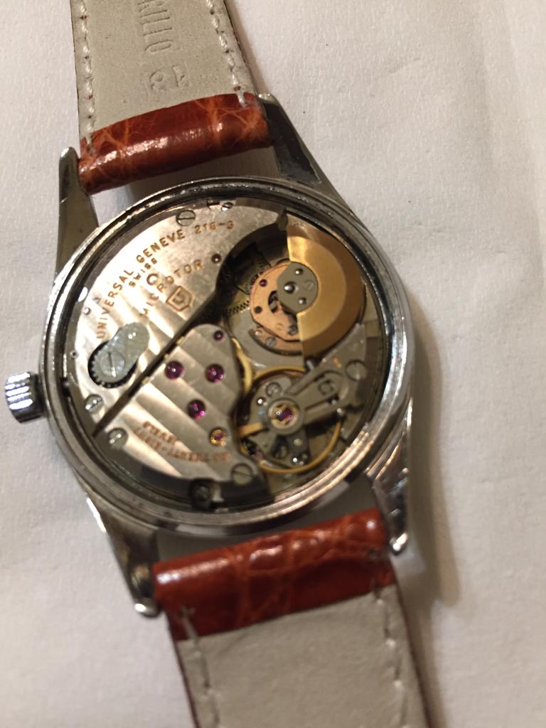

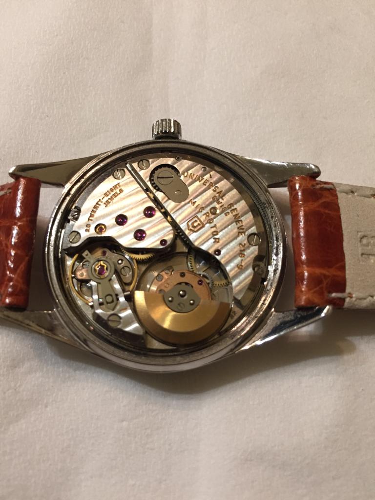

There is nothing there that would worry me unduly. It looks complete and original to my untrained eye.
There is little or no sign of rubbing on the rotor itself.
You can see the tell-tale circular signs of rubbing on the inside of the case back but you seem to find that on a significant proportion of these and it doesn't always indicate a problem. I guess there must have been very little tolerance within the case design.
Whilst I agree with @Larry S that the microtors are not always to fix, there is no shortage of donor watches and so I don't think that they should ever be hugely expensive to repair.

It looks ok, but not perfect - as everyone seems to agree.
I like the dial, the ageing is uniform across it.
If running, the movement looks like it should probably be OK.
The main cost with repairing a microtor movement in my experience is the rotor itself (especially a cal 69 or 1-69), and the balance.
The dial, case, and movement look all correct for a 20368-1, and there is no evidence of rotor rubbing on the inside of the caseback.
I don't think its a huge gamble at that price, at least I would certainly consider it if i was looking for one...
Just needs an original crown (the small domed type, also seen on 204610 and a couple others) to complete it.
1,209
3,069
Completely agree with everything you said other than the above statement.
I suspect you just had a quick glance and missed the circular marks or have I always misinterpreted these as being rotor rubbing marks?
409
1,074
Stand corrected 👍
No matching paint loss on the rotor itself, so possibly has been replaced.
